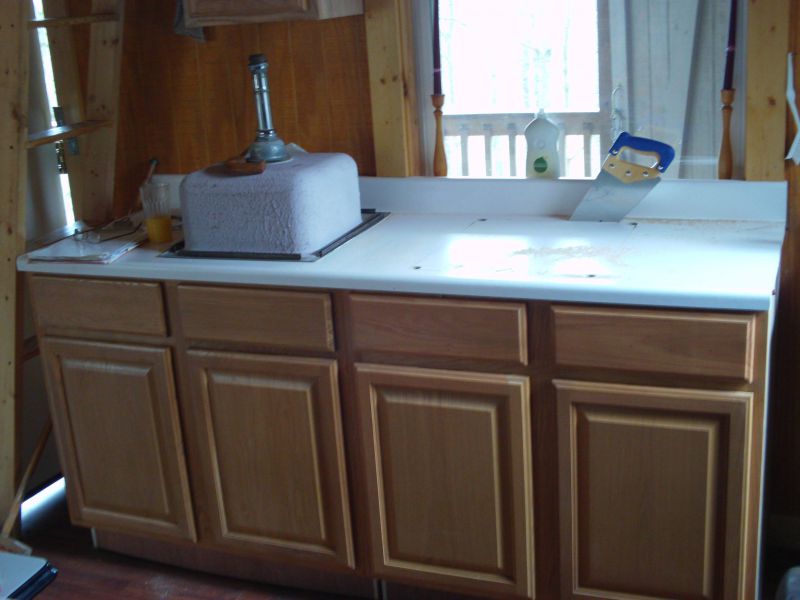

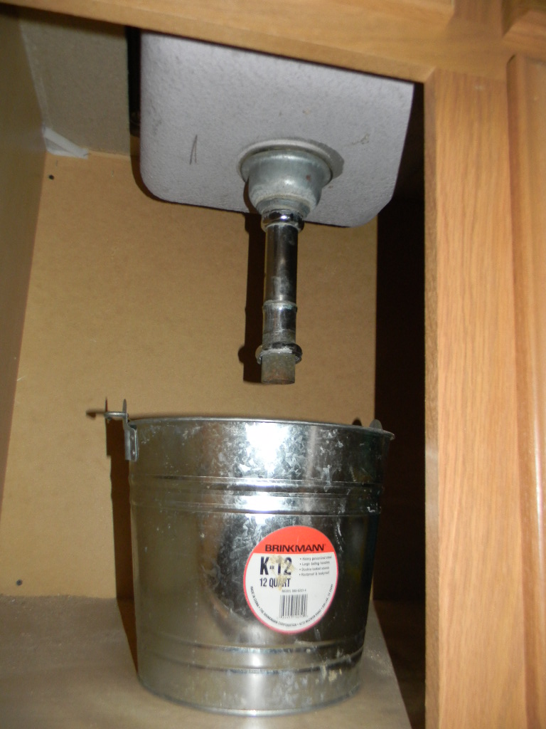

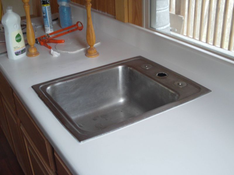

Spent a wonderful weekend upgrading the cabin. The old cart and storage cabinet had to go and make room for permanent cabinets and a countertop. Went with a white counter 'cause it is so dark inside after the leaves come out. I cut out a hole for the sink and presto! Instant transformation.
The best part is I didn't have to make any extra trips to the hardware store! Careful planning and luck.
The cabinets are good quality with plywood construction. Got 'em at Grossman's Outlet in Columbus for a lot less than the particle board cabinets offered at the big box stores.
I still have to order my rubber sink trap and plumb from it to the outdoors. Will do some more work next weekend.![New cabinets and counter in place New cabinets and counter in place](https://www.small-cabin.com/forum/shared_files/uploaded/1518/28438_1.jpg) New cabinets and counter in place
| ![Sink installed Sink installed](https://www.small-cabin.com/forum/shared_files/uploaded/1518/28438_2.jpg) Sink installed

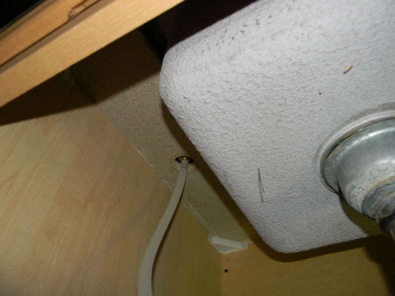

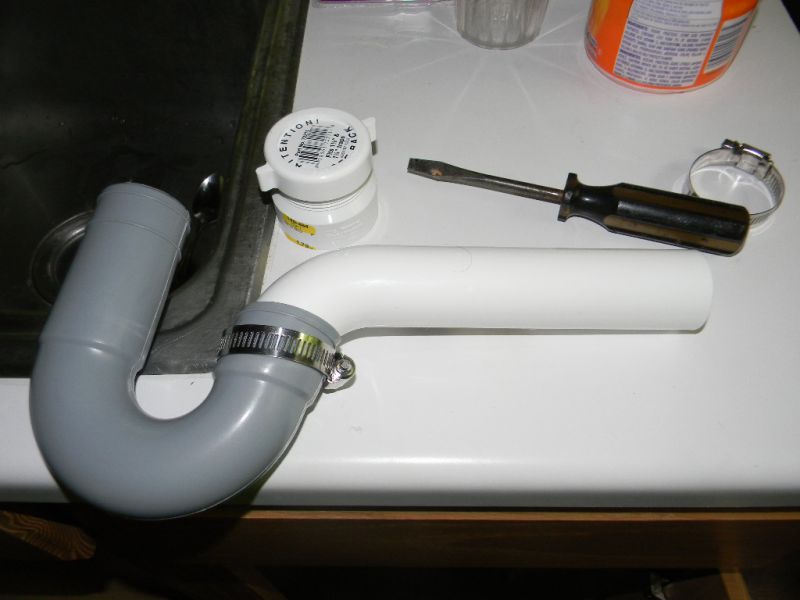

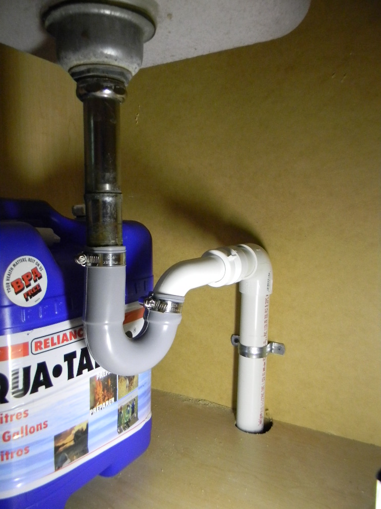

Got the sink drain connected. No more emptying buckets! I used a rubber sink trap from Fernco (thanks to a tip here) so the cabin can freeze solid without the trap splitting.
The hand pump loses its prime quickly, so no freeze damage there. The water container should flex enough not to split. My cabin shutdown procedure is now "turn off lights and close door". I'll forget and leave the lights on one of these days...![Rubber sink trap with J Rubber sink trap with J](https://www.small-cabin.com/forum/shared_files/uploaded/1518/30319_1.jpg) Rubber sink trap with J
| ![Trap installed Trap installed](https://www.small-cabin.com/forum/shared_files/uploaded/1518/30319_2.jpg) Trap installed

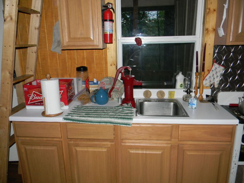

Hand pump installed for running water... Empty Bud box was merely for haulin' stuff (especially in the pre-water days at the cabin)![](http://www.small-cabin.com/forum/img/smilies/wink.gif) ![Lowe's hand pump with counter clutter Lowe's hand pump with counter clutter](https://www.small-cabin.com/forum/shared_files/uploaded/1518/30320_1.jpg) Lowe's hand pump with counter clutter
| ![](https://www.small-cabin.com/forum/img/p.gif) | ![](https://www.small-cabin.com/forum/img/p.gif) | ![](https://www.small-cabin.com/forum/img/p.gif) |

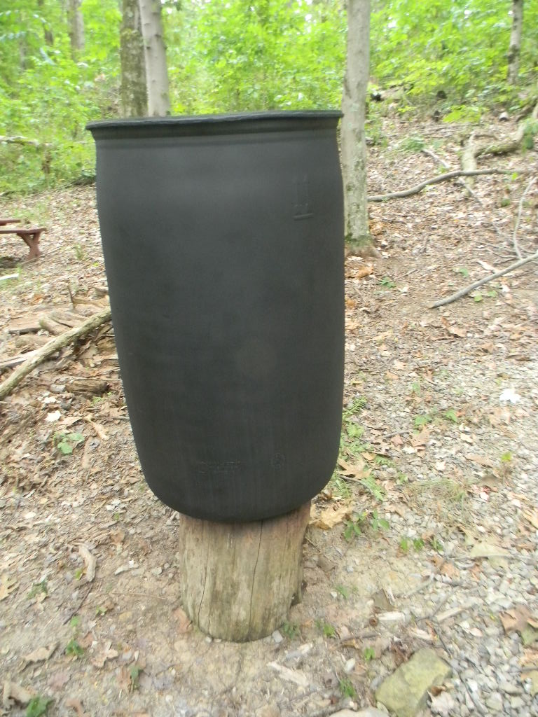

Washed then painted a white rain barrel. One can primer, three cans black spray paint. Next time I think I'll brush paint over the primer.

SE Ohio Nice sink and I relly like how your hand pump is set up. Do you have a grey water trap you drain your sink into. I looked back through your post and didn't see the drain set up anywhere.

Thanks! Right now I'm letting the water run out on the ground, using biodegradable dish soap (Walmart grocery section of all places has it). I will be burying a 55 gallon plastic drum eventually for a mini-septic (my sink supply is only 5 gallons).

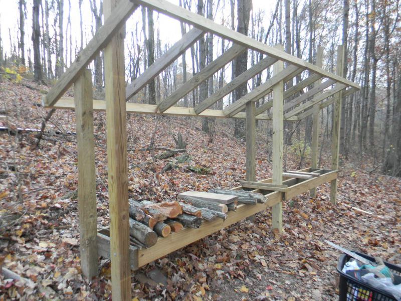

# Posted: 28 Oct 2012 16:03 - Edited by: SE Ohio

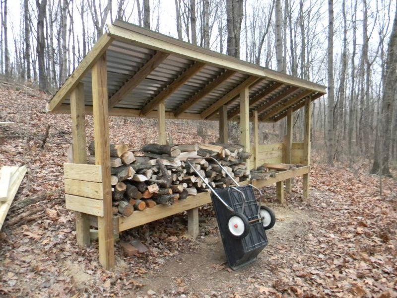

Slow progress on my firewood storage. I was entertaining two of my boys at the Lake Hope State Park ROAR (Rural Ohio Appalacia Revisited) fest this (damp) weekend.
End state, firewood will be off ground and covered. Tin roof with pressure treated framing should last a while... Hope to finish up next visit and eventually fill up.

A few days at Thanksgiving let me catch up on the wood storage project. Still needs some dividers, but will keep the wood dry. Two of my boys helped move the split wood and loaded 'er up.
Now the chainsaw needs some attention...![Teamwork Teamwork](https://www.small-cabin.com/forum/shared_files/uploaded/1518/40891_1.jpg) Teamwork

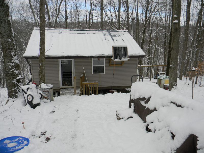

T'was a good few days at the cabin with my helper.

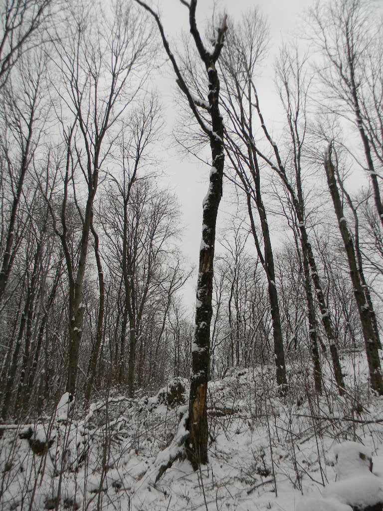

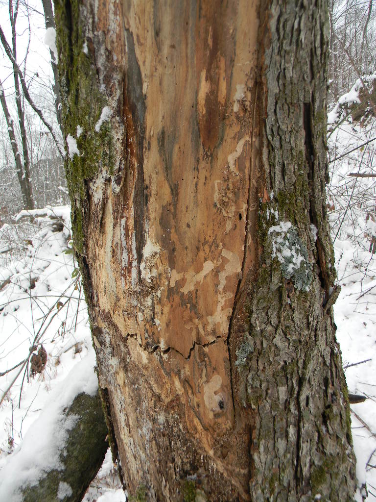

The saga of the tree: Now that my firewood shack was finished, decided it was time to get some wood for next year. I had a tall dead tree that had potential to fall and hit our parking area. Closer examination showed it not only leaning that way, but it was also cracked and ready to go any time.
I kept the mini-van parked up on the ridgetop well away from potential falling tree. Cussed at chainsaw for at least 10 minutes (must prime it more than manufacturer recommends, so it seems). Notched tree well below crack on side towards driveway and lean. Started cut on opposite side. All is going well. When saw gets two inches from notch, tree pinches bar! This is the opposite way from the lean! Arrrggh. No spare chainsaw.
Off to the shed for my long rope and come-along. Come-along is not there, presumed stolen. Sigh.
Rope is long enough to reach minivan. Tie off, get helper in van, and reverse. Timber! Tree falls correctly.
Cut log to splittable lengths. Too late I realize it is a dead elm tree. Not my favorite wood for heat. Sigh. I split it anyway.
Previous owner left me a wood sled, and we put it to good use. Fire rack is now 3/4 full, will save last 1/4 for another wood.
Drove back from cabin this morning. More snow coming down now!
All-in-all it was good to get away.![Wood sled Wood sled](https://www.small-cabin.com/forum/shared_files/uploaded/1518/43093_1.jpg) Wood sled

Dead elm tree![Dead elm tree Dead elm tree](https://www.small-cabin.com/forum/shared_files/uploaded/1518/43094_1.jpg) Dead elm tree

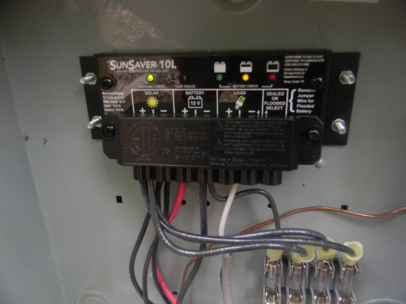

Installed new charge controller for my "Horrible Fright" 45 watt system. The Morningstar controller will allow "hands-off" charging, as the HF controller has to be turned on/off manually and I'm not there everyday... Put the charge controller in outdoor-rated electrical enclosure (~$20 at Menards, purchased circuit breaker box and removed "innards") and attached to cabin.
Of course a critical switch fell apart and I was short a few critical parts, and was about 45 minutes from a hardware store. Sigh. I finished hooking into house wiring just before dark. Still need to hook up panels, but I'm close?

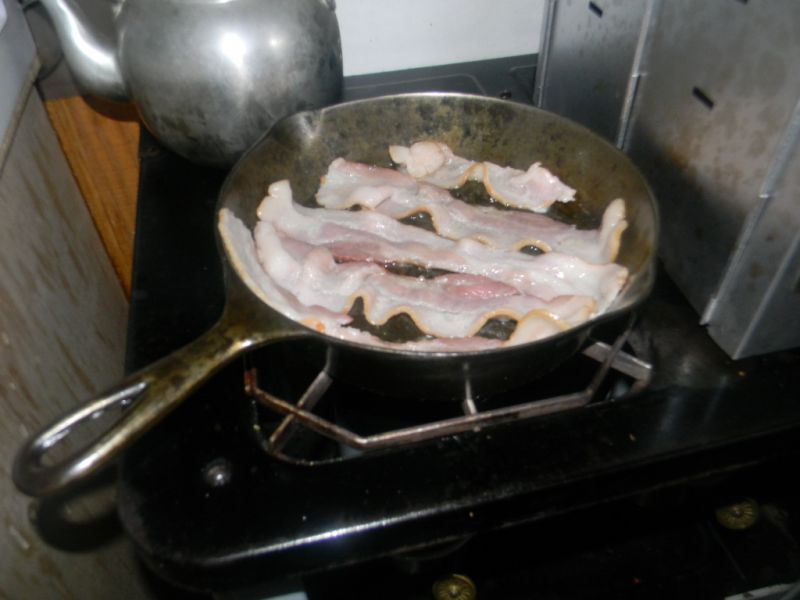

The other week I found a rusty cast iron Wapak 7 skillet by the creek. It was heavily rusted. After sanding and seasoning, I brought it to the cabin for the official "break-in". Nice light weight skillet, may go in with my canoe camping gear! It'll get good and black with age (black is beautiful)

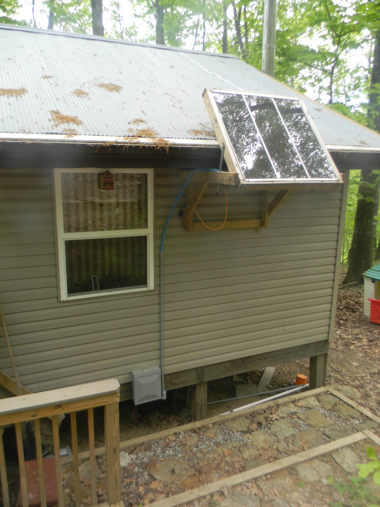

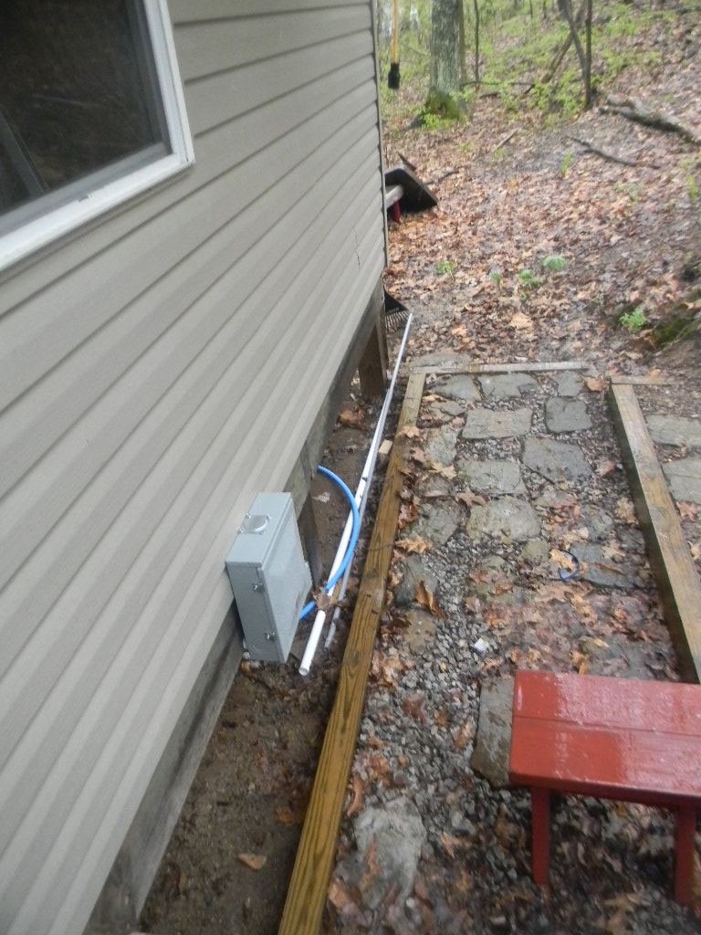

T'was a productive visit to the cabin. I've upgraded the solar charge controller and possibly my quality of life...
The old Harbor Freight solar charge controller was manual at best. It wasn't designed to be left on all the time and you are expected to turn it on when the sun comes up, off when sun sets. Since I'm a weekender, I can only charge when I'm there, and due to use I could never really get to a high charge without taking the battery home.
New charge controller is a Morningstar, and it is a "hands off" controller, no toggling required. This controller will allow me to charge the battery when I'm not there, and will not overcharge. It also will disconnect the house from the circuit if the battery gets too low, e.g. if my kids leave the lights on when we're not there.
Harbor freight solar panel wires were quite anemic, so spliced 12 gauge wires from panel to controller. Less voltage drop, so more efficient battery charging.
Upon installation, battery showed it was a little low on charge. No surprise there! It hadn't been home for a while.
Looking forward to next trip down, and no battery charge worries!![Charge controller close up showing low charge Charge controller close up showing low charge](https://www.small-cabin.com/forum/shared_files/uploaded/1518/49933_1.jpg) Charge controller close up showing low charge
| ![Wet location box and conduit Wet location box and conduit](https://www.small-cabin.com/forum/shared_files/uploaded/1518/49933_2.jpg) Wet location box and conduit

This controller has a feature to disconnect load if battery level drops too low (great if you leave on the lights). This kicked in each time I turned on the lights. I removed power from controller and retried. Same thing again. Battery voltage was fine and load was same before; controller was goofy. I removed it and exchanged it for another (Morningstar paid postage both ways). Looking forward to installing replacement and trying again...

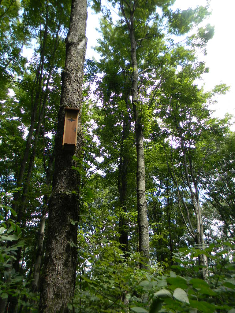

Installed some more "new technology" to aid in eliminating mosquitoes. Found a cedar bathouse at a garage sale, and let my boys create a "batman" stencil to decorate it. A sharpy transferred the shape to the bathouse. Bathouse probably isn't big enough but will do until I can find/build a larger one. Nice to have a bat- guest house...
