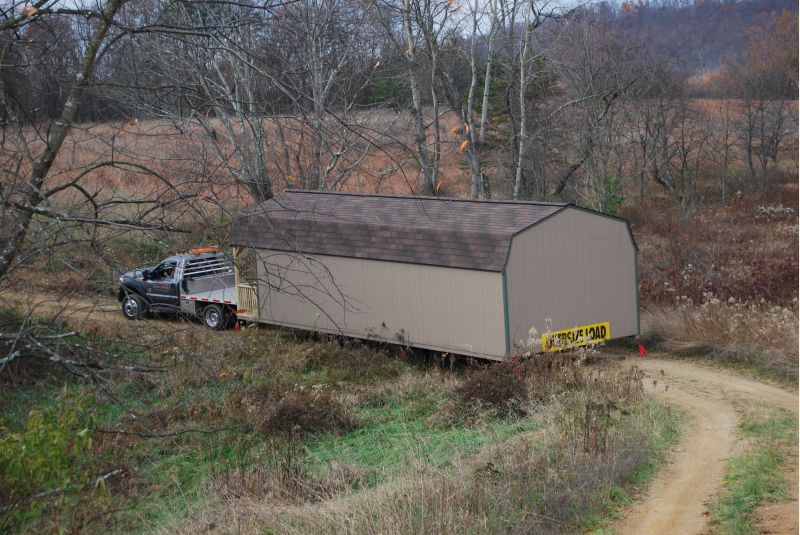

I've been monitoring this site for sometime now, reading posts and learning what I can while I figure out how to balance my desire for a cabin against the time-demands of a busy family. After much research and consideration, I realized I didn't have the time to build a cabin completely on my own, so I decided to take a short-cut and purchase a pre-built, but un-finished, camping cabin shell (basically a glorified shed). Although not as fancy or well built as some of the properties on this site, it is a perfect blend of form, function and cost for me. And it gives my family the opportunity to work together as we finish the interior ourselves, something even my 13-year old daughter got excited about when the family discussed it. Well, today, the camping cabin was delivered to Moss's Meadow. The mile-long drive back through the forest and fields was a bit hairy for the driver at a few points, but he did a great job getting it there and getting it settled. Now the fun begins!

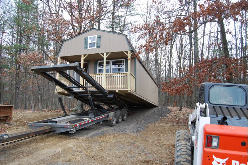

(For the record, the cabin is 14'x40' overall, and the reason there are no windows on the sides or back is because I ordered it that way. At the time I wasn't certain how the interior would lay out, so putting the side windows in as part of the interior build-out gives me maximum flexibility with interior walls and such).

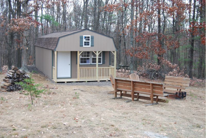

A couple pictures for reference:![Some parts of the road were a bit narrow for the load... Some parts of the road were a bit narrow for the load...](https://www.small-cabin.com/forum/shared_files/uploaded/1536/19190_1.jpg) Some parts of the road were a bit narrow for the load...
| ![The cabin in its permanent location. The cabin in its permanent location.](https://www.small-cabin.com/forum/shared_files/uploaded/1536/19190_2.jpg) The cabin in its permanent location.

dear PA_Bound i personally think u did a real good job on how u figured out a short cut way to get a place up fairly quickly.nothing wrong with that.good for u.Looks grand.thank u for sharing.
# Posted: 12 Nov 2011 18:23
Hey PA_Bound...CONGRATULATIONS!!!! Let the good times roll (and be happy as heck that your 13 year old daughter is happy...hopefully she'll remain just as excited when she's 16!!!!) Also good thinking on the windows/lack of-brilliant! Think carefully about your layout and put them where you want. Keep sharing! Cheers :)

Sweet! Agree good thinking on the windows, put em' where ya want 'em.. Congrats and many happy days!

That looks great! I wouldn't have wanted to be the person driving it in though. *S* I love the layout too.

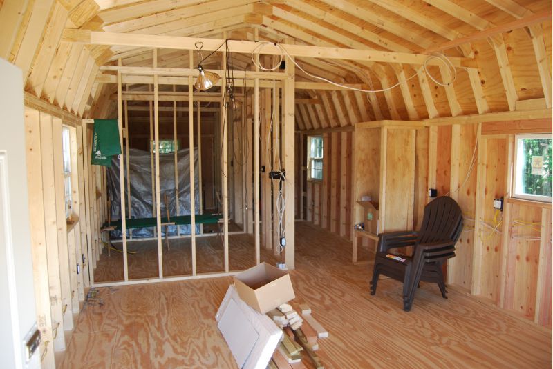

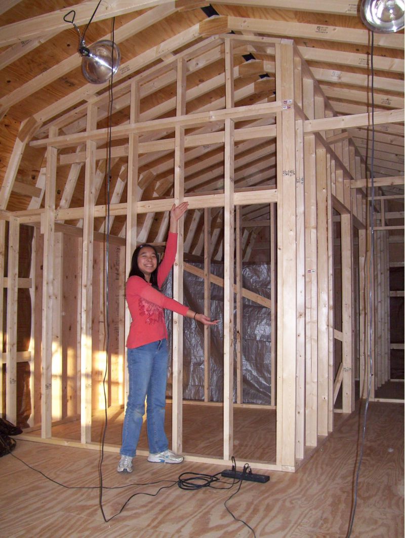

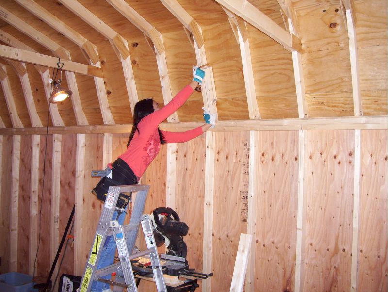

I thought I would post an update picture, just for the on-going record. Progress has been a bit slow, but after a few day-trips we have the framing for the two bedrooms and bathroom about 90% complete. Hopefully on the next trip we can finish this framing, and finalize the location for the remaining four windows- which we'll install the trip after that. The lack of snow has certainly been helpful (otherwise we would never get even this far), but a few more degrees in temperature would be nice also.![Bad habits start at an early age (no, I didn't tell my daughter to lean off the ladder that far!) Bad habits start at an early age (no, I didn't tell my daughter to lean off the ladder that far!)](https://www.small-cabin.com/forum/shared_files/uploaded/1536/26190_2.jpg) Bad habits start at an early age (no, I didn't tell my daughter to lean off the ladder that far!)
| ![After a few days of work... After a few days of work...](https://www.small-cabin.com/forum/shared_files/uploaded/1536/26190_3.jpg) After a few days of work...

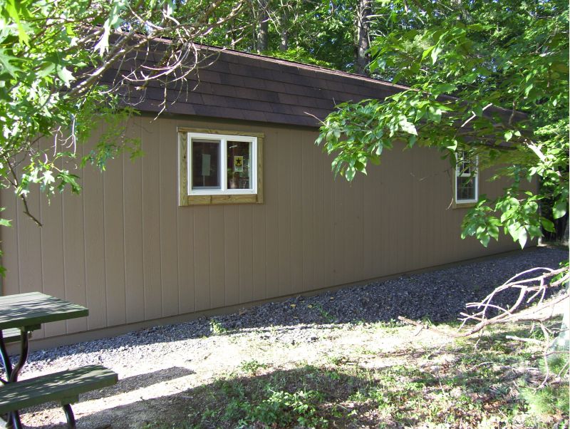

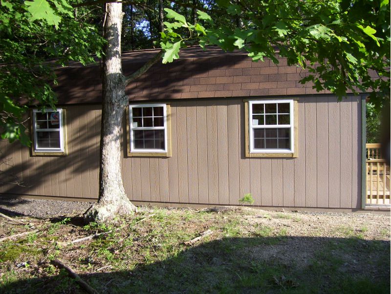

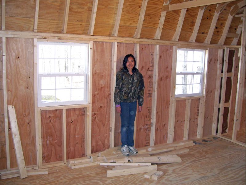

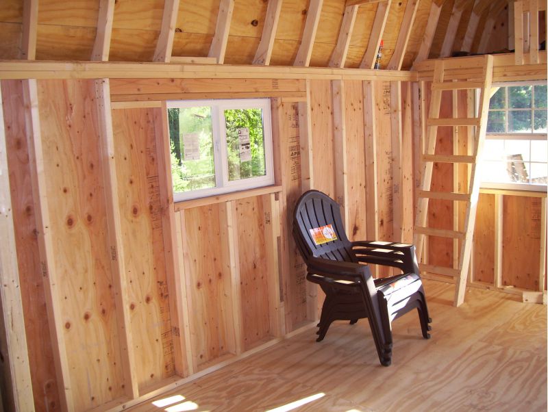

But since my last posting my daughter and I have have had a couple Saturdays (including yesterday) to work on installing windows. If you'll remember, we purchased the shell without many windows, giving us the freedom to put as many as we want, where we wanted, after we figured out the layout. With >90% of the interior framing done, we've installed and trimmed out the exterior of six new windows. We have one more to go (in the bathroom), but not sure exactly where to put it yet so were holding back installing that one. Attached are a few pictures.
Next steps (late-June/July)- paint the exterior window trim (and add a little more caulking to one window we ran short on), and begin the interior wiring.![Picture sink here, centered under window Picture sink here, centered under window](https://www.small-cabin.com/forum/shared_files/uploaded/1536/31726_1.jpg) Picture sink here, centered under window

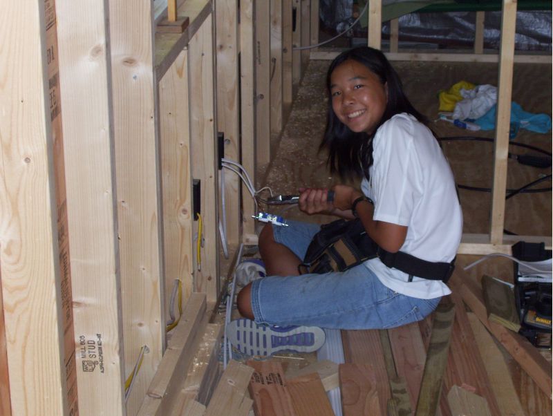

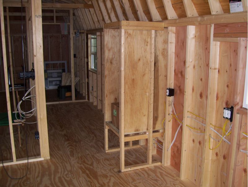

Wiring makes for boring pictures, but here are a few...![Wires pulled... Wires pulled...](https://www.small-cabin.com/forum/shared_files/uploaded/1536/37963_1.jpg) Wires pulled...
| ![My daughter wired all the outlets, and most switches (and did a fine job!) My daughter wired all the outlets, and most switches (and did a fine job!)](https://www.small-cabin.com/forum/shared_files/uploaded/1536/37963_2.jpg) My daughter wired all the outlets, and most switches (and did a fine job!)

Oh, and in case you are wondering what the weird closet/box is in the first picture, that is where the propane refrigerator will go. I bought a frige that was ripped from a parted-out camping trailer. As they need to be vented, I built a cabinet that will be vented to the outside. Here's a better picture.

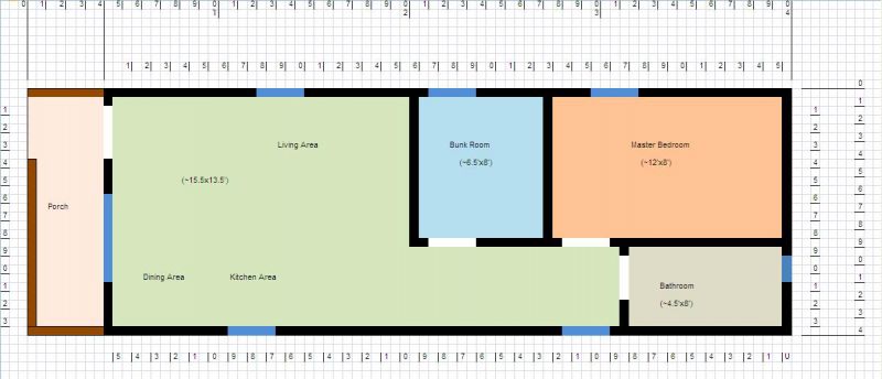

@Rickant... sorry for the delay responding. The floor plan I used is actually earlier in this thread (see the Nov. 15th 2011 post, above). I ended up following that design, although I did change/add windows- not all of which are reflected.
