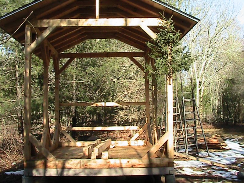

Here we are inspecting the structure and planning the construction of the loft

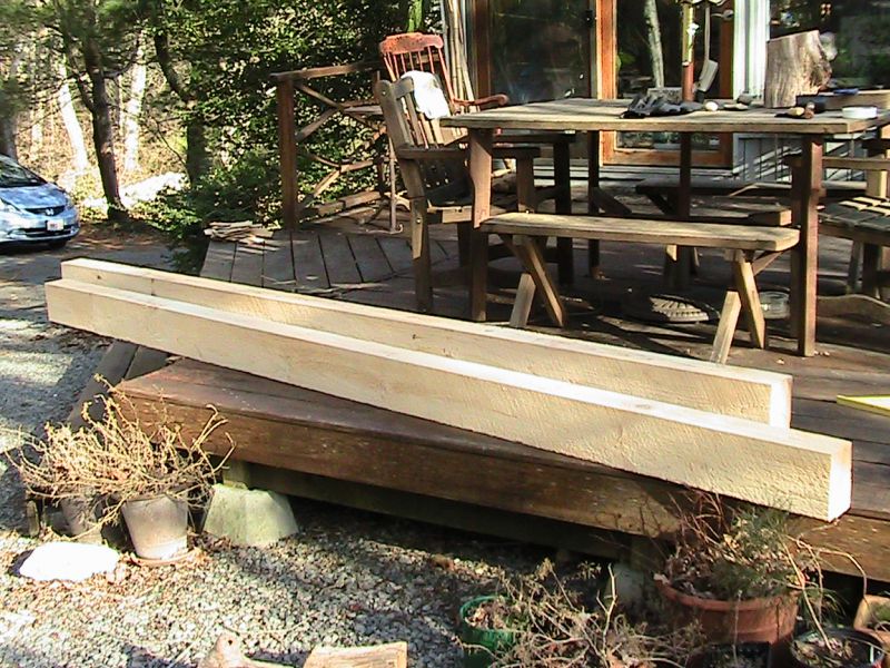

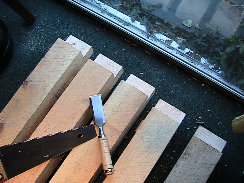

Here are two ten foot 4x6 beams I got from my local sawmill for building the loft. The price? $11 each!
Beams from the sawmill

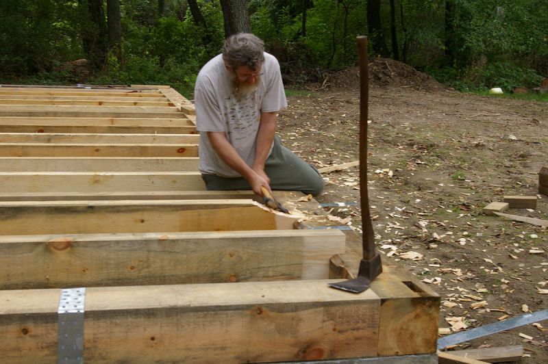

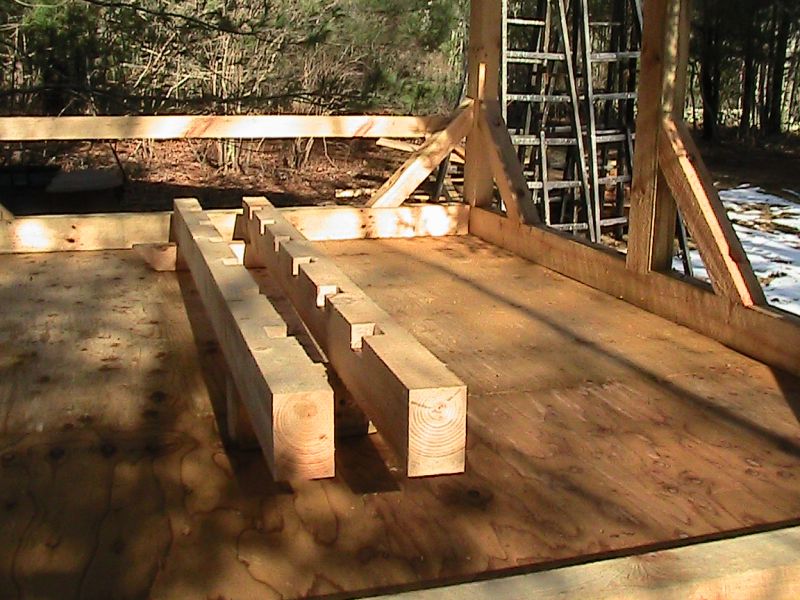

# Posted: 24 Jan 2012 12:24pm - Edited by: fthurber

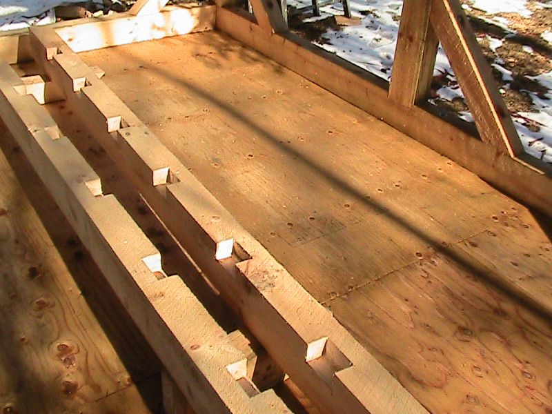

Things are going slow but steady. Here are the half-lap joints I am doing for the sleeping loft.
fpw
# Posted: 24 Jan 2012 03:09pm - Edited by: fpw
Nice. You might consider cutting a 45 degree taper on the underside of your joists. If you go with 90 degree cutout, often you will get splitting where the tenon meets the bulk of the wood.
How are you going to tie your beams into the frame?
fthurber
# Posted: 25 Jan 2012 03:51pm
Quoting: fpw
Wow, interesting idea. I have not seen this before but it sort of makes sense since this will not makeit any weaker. Can you send more information?
I was thinking of a "haunched" half-lap, but that would weaken my 4x6 tie beams (plate/girt thingies).

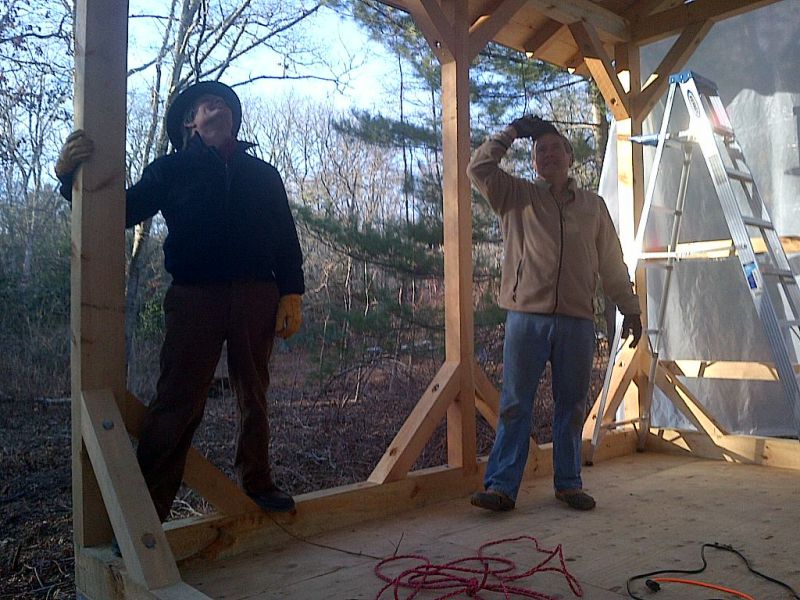

fthurber
# Posted: 27 Jan 2012 02:23pm
I have changed my name to "fthurber"; no more squid; this is not a fishing forum after all...
Anyway, my son and I are going to try mounting those mortised beams this weekend. I realize that the half-lapped 4x4 are vulnerable to splitting, but they will not get too much load,... I hope. Maybe I can put a 2x2 oak ledge below them or metal braces (ick).

fpw
# Posted: 28 Jan 2012 11:08am - Edited by: fpw
Here is a photo of a guy putting a curve on the bottom a joist. You can do the same thing with a 45 degree angle. In this case he is working in place. When done, he just rolls the joist.
fthurber
# Posted: 31 Jan 2012 03:38pm
Hmmm interesting. What is the theory about why this would prevent splitting? Is it the pressure of the 90 degree cut against the plate / girt?
I should have done haunched half-laps...
fpw
# Posted: 1 Feb 2012 08:54pm
Timbers will check at the 90s. Won't affect strength, but if you cut a curve the check won't start there and it will look better.
Good luck raising your loft. I am interested in seeing how you attach those timbers.

# Posted: 5 Feb 2012 06:05pm - Edited by: fthurber

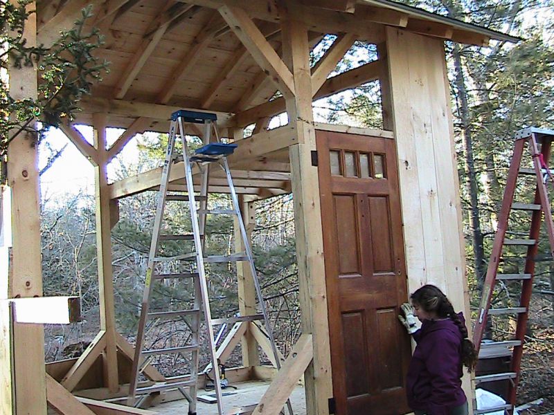

We finished the loft rafters, hung the door, and got some ship lap siding up this weekend.
We did not taper the lap joints because we are pressed for time...our next project will be a proper timber frame barn.
My wife admires her work on the door

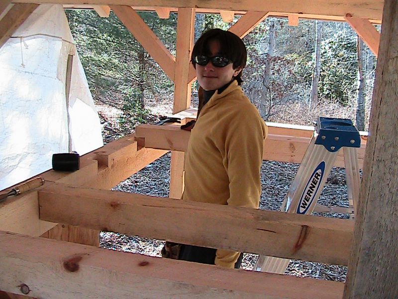

My son finished the lap joints for the rafters

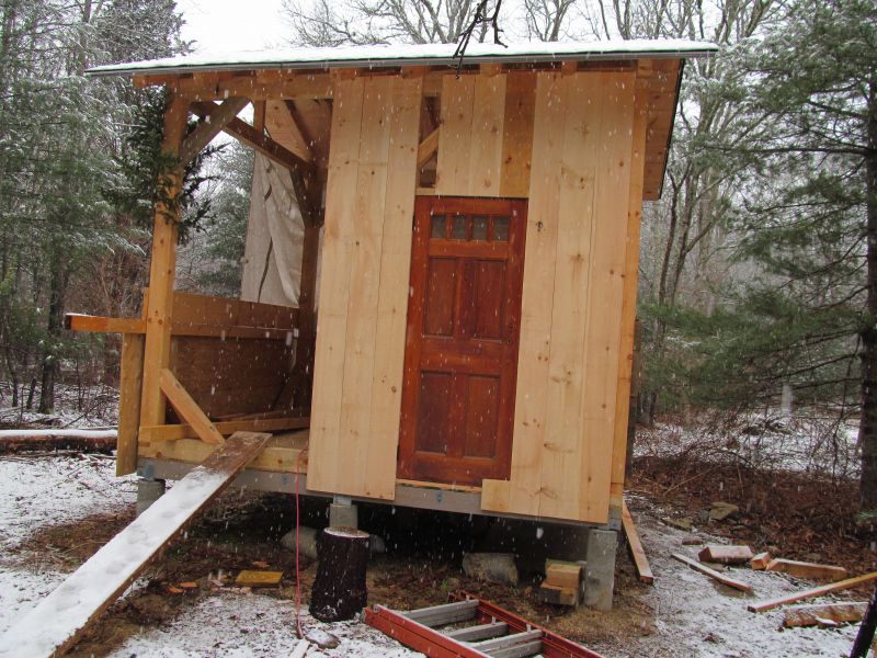

# Posted: 11 Feb 2012 11:13pm - Edited by: fthurber
A shot of the cabin in the snow

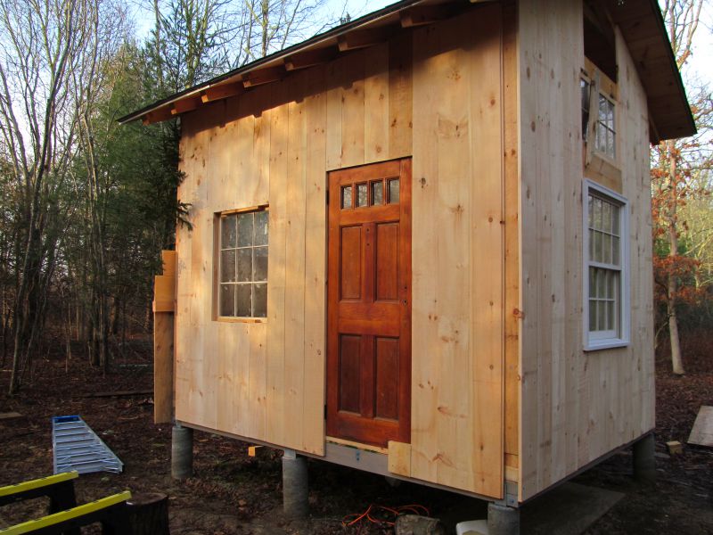

fthurber
# Posted: 12 Feb 2012 09:17pm - Edited by: fthurber

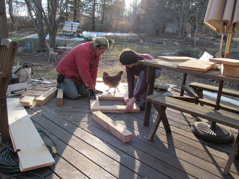

Here we bundled up against the wicked cold building a back door to the cabin and one of my wife's chickens decide to help.
Our chick helper
Our chick helper

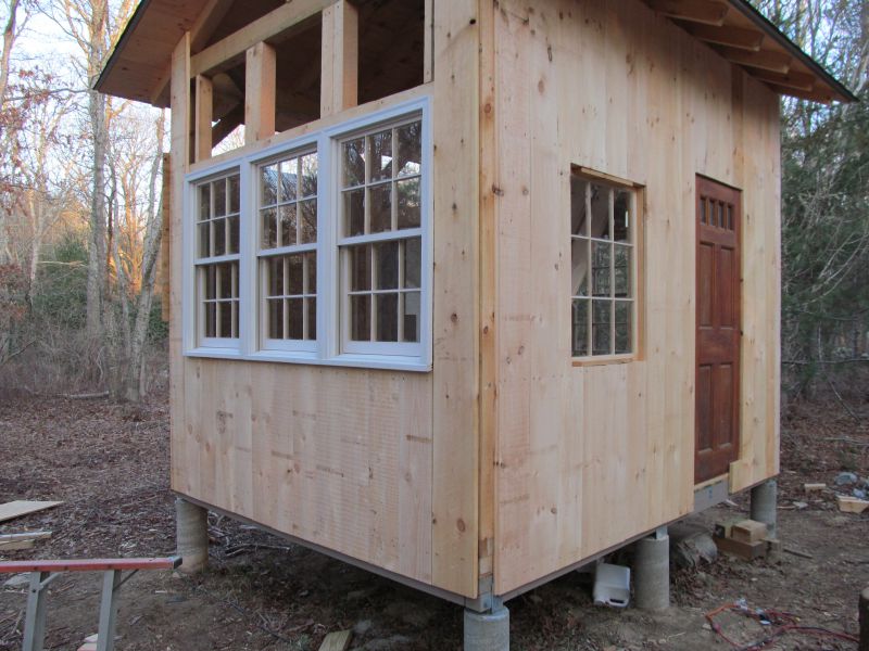

fthurber

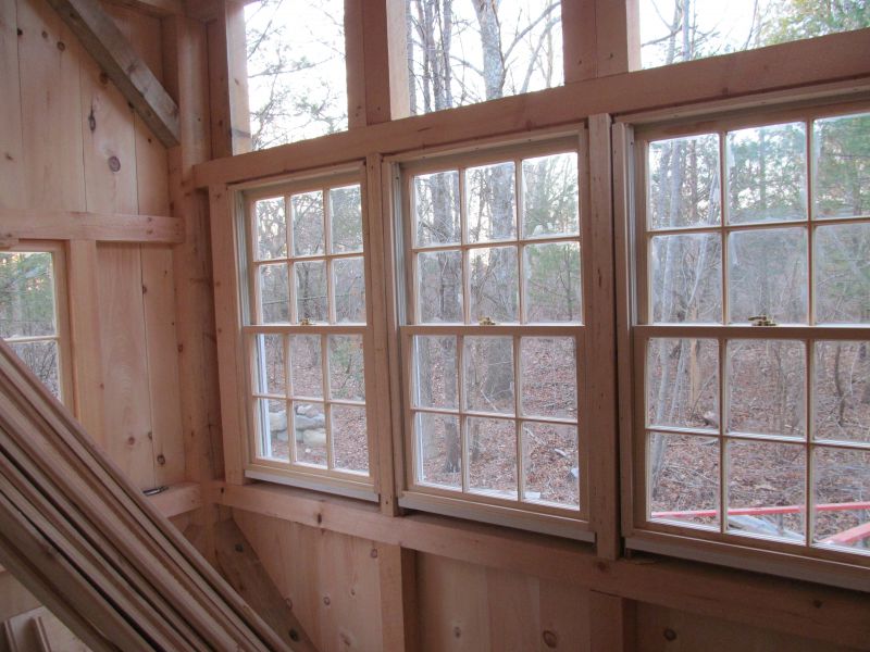

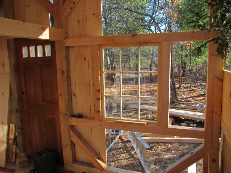

# Posted: 19 Feb 2012 09:29am - Edited by: fthurber

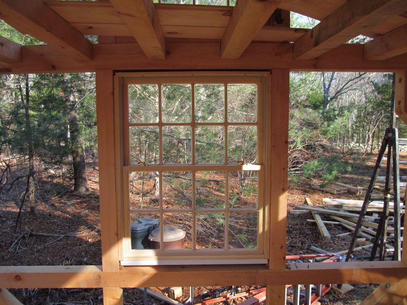

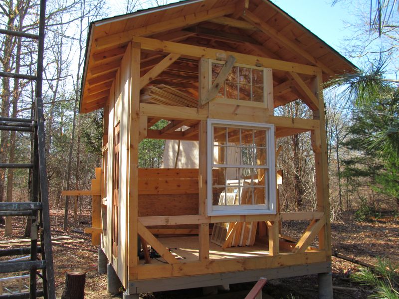

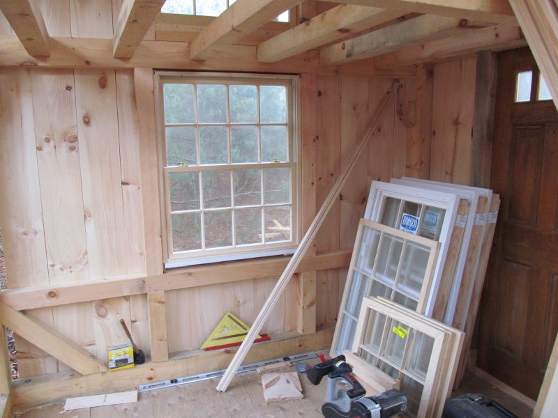

We got three windows up along with their 4x4 framework.
The north side with a large double-hung and smaller hinged windows
Double-hung from the inside
Fixed east window
Fixed east window
Sap is running
Sap is running

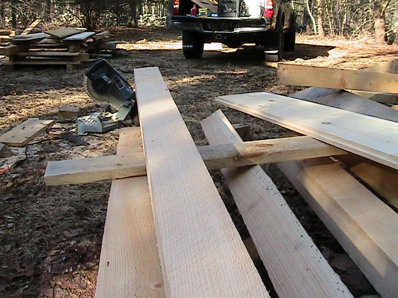

I worked on the ship-lap siding today; it was so hard to fit it together. Our local sawmill has not done any ship lap in a long time so the stuff that was left was warped and knotty; very difficult to work with
fthurber
# Posted: 23 Feb 2012 07:02pm - Edited by: fthurber
We have started to do the siding with ship lap pine
Exterior
Exterior
Interior
Interior
fthurber
# Posted: 28 Feb 2012 08:50pm - Edited by: fthurber
The south side windows are going in
Lower windows
Lower windows
The inside
The inside
