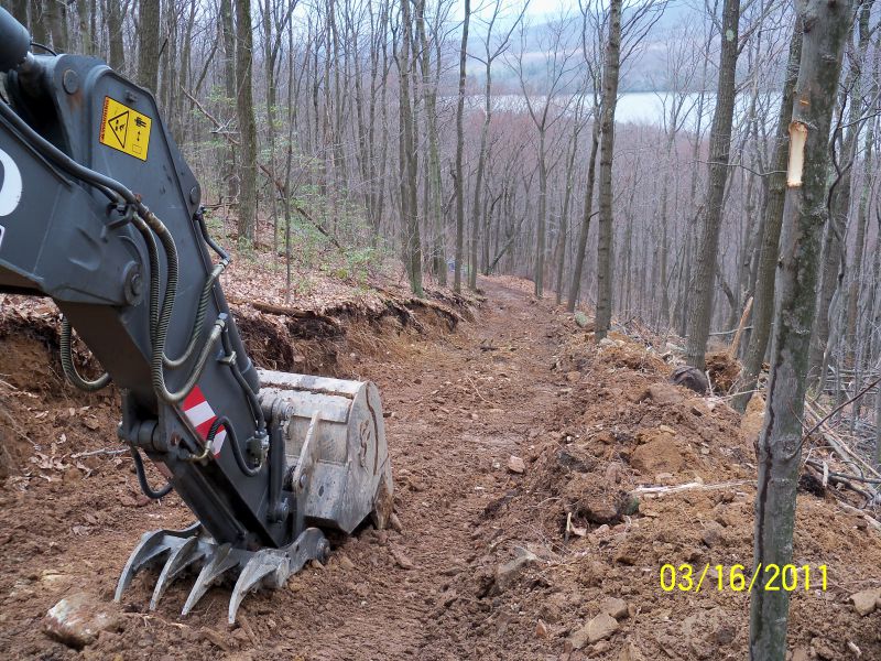

In the summer of 2010 I tried to rent an excavator to extend the logging trail up to the top of the mountain, but I ended up stuck with a raggedy old D6 bulldozer that was not nearly big enough for the task. To make a long story short, not only was I unable to extend my road, but I was lucky I didn't end up killing myself on that old thing.
Fast forward to March of 2011 when I did manage to rent a 40K pound excavator for two weeks. I managed to extend the road about 1200 feet in length, covering about a 250 elevation change. Being able to drive a vehicle to the top of our mountain for the first time was a big accomplishment. Although the road is very steep and will always require a four wheel drive, at least we can drive our camp jeep up there now.

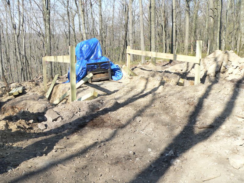

Well I did get started on my building, and like any project some things went as expected and some did not.
On of the things that did not go a planned was boring the holes for the piers. I rented an auger attachment for my skid loader and planned on using that to bore the 14 holes for the building and deck. I got an 18" bit for the auger and if things had gone well I would have ended up with 14 nice 18" diameter round holes. Instead, due the large amount of rock in the ground, the first hole ended up being about 36" in diameter by the time that I hit the four foot depth mark that I was shooting for. The second hole, well that didn't go nearly so well. By the time I quit the second hole was about 5' in diameter, and only about 2' deep. Needless to say the auger wasn't going to work, and renting it was a waste of time and money.
Next I moved on to renting a mini-excavator. The excavator was the ticket, as I was able to dig up the rocks that the auger would not handle. The use of the excavator required digging two trenches for the 10 piers that will support my building, instead of individual holes though, since the holes needed to be so close to one another that they ended up connecting to one another and a trench was the best way to go. Since we no longer had nice round 18" holes to use to form up our concrete, I ended up having to build and set 14 concrete forms ( 5 each in two trenches, and 1 each in four holes).
Next came having to haul 42 eighty pound bags of of concrete along with water to the top of the mountain and then mix them. I invested in an electric concrete mixer from Lowes, and man what a blessing that thing was to have. Not only did it save the back breaking work of mixing all that concrete, but it was much faster as well.
Anyway my step-dad and I got the concrete poured and today 4-16-2012 I got the four corner piers set and backfilled.
Next up is setting and backfilling the remaining 6 building piers, and then the 4 deck piers.
Even though the excavator worked to dig down for the footers, we still needed to dodge some underground boulders which is why the footers aren't in nice straight lines the way I would have preferred them to be.
We also had to use some inventive ways to get materials to the top of the mountain.

Well my step-father and I went back up to camp and finished getting the piers for the building and porch in the ground. We also got almost all of the backfilling done and some additional site work done around the building as well.
Trollbridge- Thanks for the encouragement, it feels great to have that dirty part of the job done.
Here's some pics from the most recent trip up.

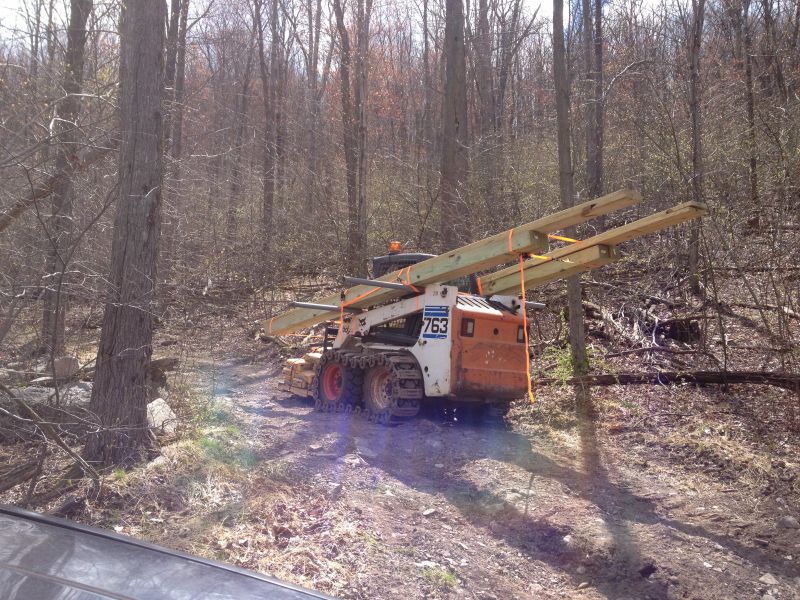

Your thread is going to be such a fun one to watch...I love the picture of your post strapped to the skid steer!!! And all the rocks that gave you problems...sometime in your "spare moments" HA HA...collect the larger flatter pieces and you will be able to use them for stoops, walkways or a patio or retaining wall or raised garden or flower beds or...............okay enough already- but seriously you do have an abundance of a pretty handy resource right there so next time you want to curse the stuff instead think of all the handy uses it could have!

Trollbridge- I'm with you on the use of the all the rock that we have available. I used many of the big ones to build a retaining wall in front of the building where the road comes up the mountain in front of it. I've said many times if I only had a rock crusher I could stone my entire road for free and that would be awesome.
Yes getting the 20' long 2x10's and 16' long 6x6's up on the skid steer was an adventure. It takes so long to get to the top I like to try to maximize each trip up and down.

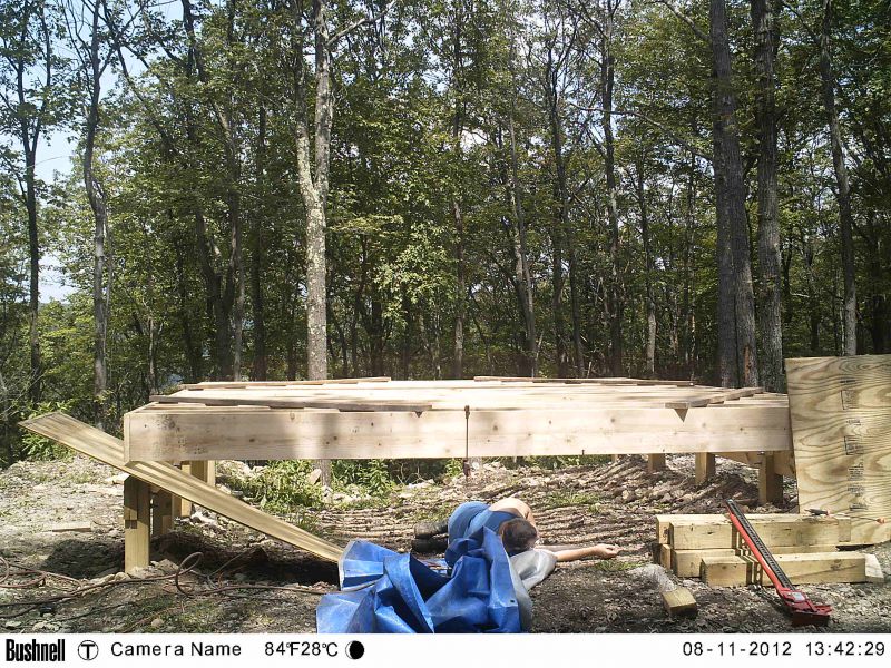

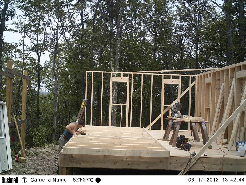

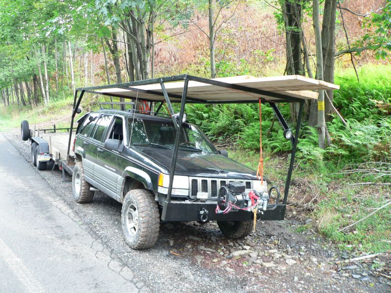

Time for an update. We got the Jeep back up to camp and managed to get the flooring materials to the top of the mountain.
We got the floor framed, insulated and sheathed on the top and bottom. Unfortunately on the weekend that we were doing the floor a rock hit the bottom of my radiator and broke the plastic pipe connection off of the bottom of the radiator. We ended up having to swap the radiator out up on top of the mountain. What poor set up for a heavy duty pickup with an "Off Road" package.
Anyway in the time since we got the floor done, we got the first floor walls framed and the Smart Side panels up as well. We had to erect a temporary plastic roof to try to protect the plywood on the first floor.
Now I'm starting to work on making the roof trusses for the gambrel roof. I want to build the trusses in halves at home, then when I get them to the top of the mountain, finish assembling them before setting them.
On a down note someone stole the ladder for our deer stand that we had constructed out of 2x4's last fall. I suspect they didn't take it too far away due to its' weight and length, but for now with all the foliage, I haven't been able to locate it.
Here's some pics of our most recent progress---
