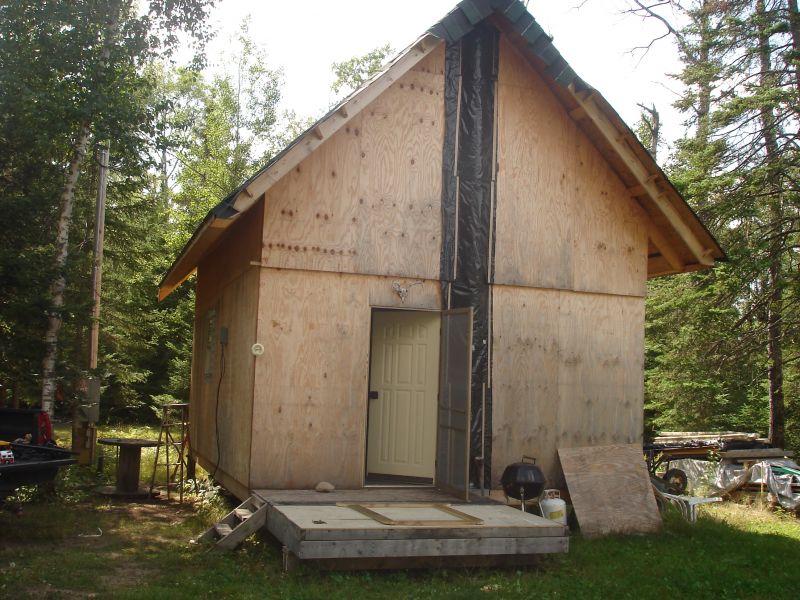

Cabin under construction

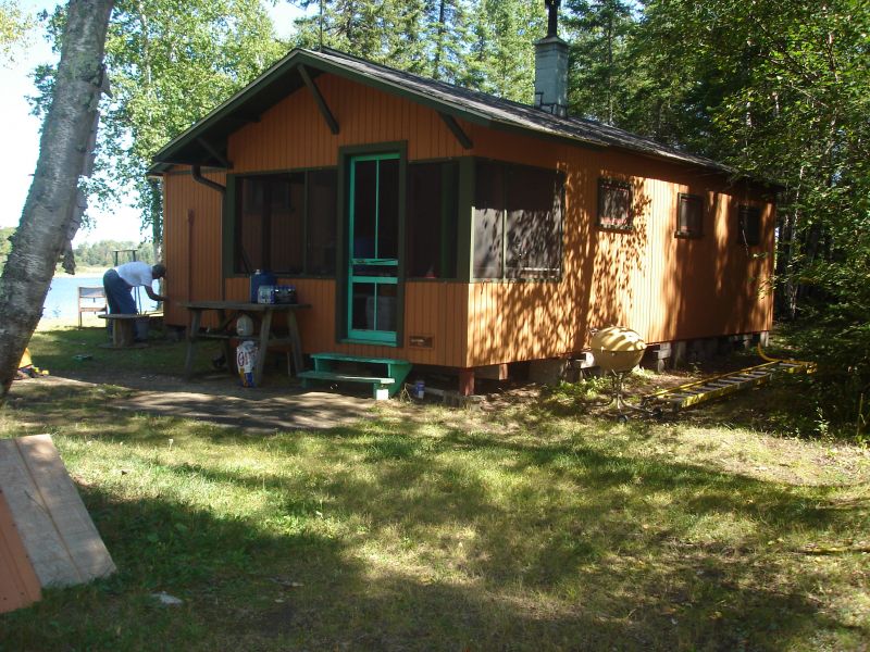

Neighboring cabin I bought

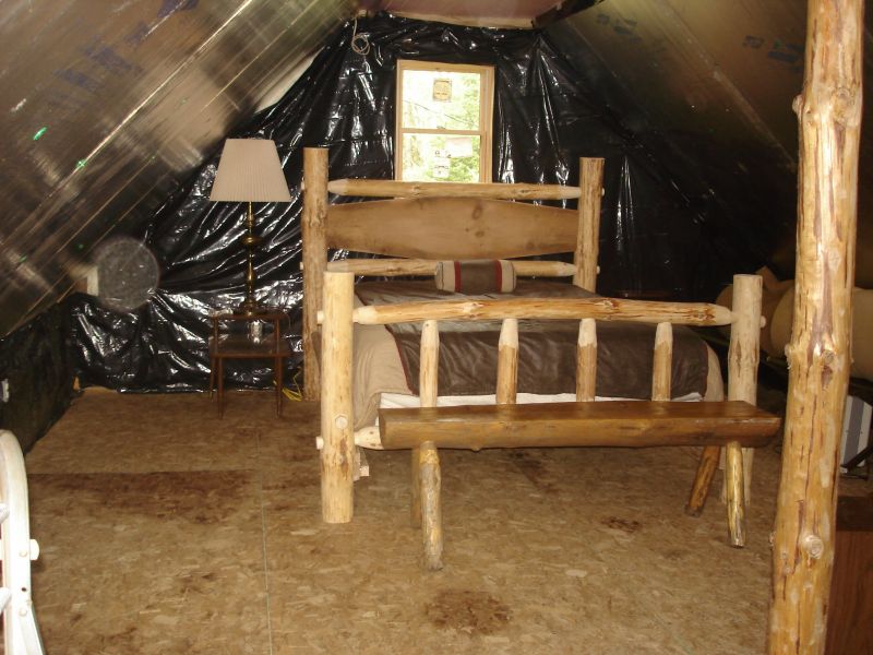

Loft of cabin under construction

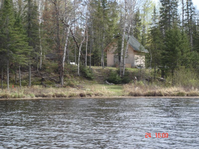

View of wild rice
View of wild rice

That is a beautiful location. Can I ask about your new cabin...How wide is it, how tall are the sidewalls and what is the roof pitch? It looks similar in size to what I'm planning...about 16x20 with 10' sidewalls and 13.5:12 roof.

The cabin as is is 16' wide by 20' long. The interior sidewalls are 10' total = 8' ceiling height on the main level, 2' sidewall in the loft. The pitch is 12/12 which puts the rafter cross ties at about 8' (maybe less, I don't remember exactly) and leaves enough space above for enough insulation. The rafters are 2x10's, and spaces are filled with fiberglass with air vents under the roof decking. I then sheeted the interior with 1" foil faced high density foam panels. In the future I will be adding a 24' x28' addition perpendicular to what you see. I had to use a considerable portion of the existing space for a staircase which will eventually serve the loft bedroom and a sitting loft over the future living room space. The black strip down the middle of the temporary front wall in the picture is a hand carved totem pole supporting the ridge. I've reconsidered its location and it will eventually be moved to the new addition where it will again support the ridge beam. This is all bigger than a "small cabin", but since I purchased the adjoining property, this one will become a rental so I can afford the whole package until I decide on a future direction. Other questions? just ask. Thanks.

Thanks for the info and photo, it really helps me to picture what mine will look like. Do you have any photos of the totem?

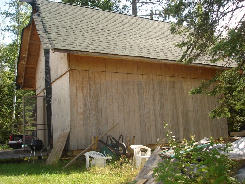

Don't think I took any pictures of the totem. I just ordered a digital camera so I'll be able to share more pictures soon. The totem is not professional quality, but it means a lot to me. My friend and I salvaged a couple of white pine logs after a major timber blowdown in northern Minnesota. He carved one totem for his cabin (a reconstructed 1900 Finish dovetail log house), and did one for me. Both of the poles are personalized to represent our lives. For example, mine contains figures depicting fish from my lake, a man holding a hammer and chisel, animals, children, and a man holding an empty bowl. The empty bowl is a joke because he and I tried in vain to harvest and process wild rice before I figured it out. As soon as the snow is gone, and as soon as I can get some muscle up there, I'm going to move the totem, and when I do, I'll take some pictures. I've attached two pictures of my cabin showing the roof pitch. You mentioned a 13.5/12 pitch. Mine is 12/12 and I can't imagine working on anything steeper. Just a thought. Good luck.
side of cabin
side of cabin
roof pitch
roof pitch

BTW, your neighboring cabin looks almost identical to mine in size, shape even the finish and colour.

islandguy - do you have any pictures of your cabin to post? Mine is 24'x24' with a 6'x12 screened porch. Enough for two small bedrooms, a living/dining room and small kitchen. This year I plan to add a front deck and expand my storage shed to add a sauna/changing room, and an area for canning and food preparation. Thanks for your input.
