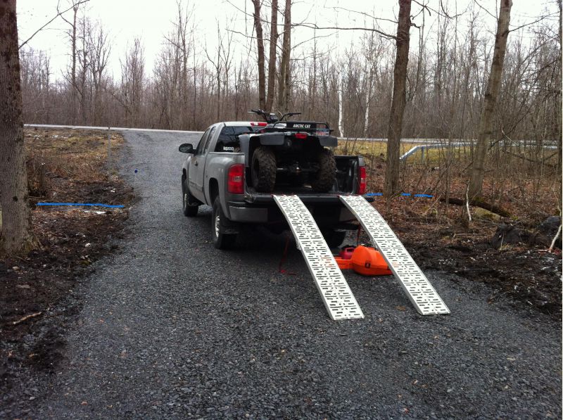

Doesn't look like much yet, but coming from what was completely wooded, to having a trail wide enough to navigate with my truck or ATV... I've got a lot done.
This is my gravel road onto the property mainly for parking

Good looking trail you got started there, I can see the huskavarna has been busy!!!! are you planning on putting gravel on the whole road or just the entrance?? it looks pretty wet/damp as well, you gotta worry about flooding??
keep up the good work!

Just gravel on the entrance for the first few years, but eventually just past the wet spot. The ground the rest of the way in is firm during all the seasons. I uploaded a new pic below and this shows a little creek runoff that is what is causing the dampness in the area you see. My trail climbs in elevation after the creek runoff, and is on plenty high ground with no worries of flooding. I do have a pipe to go in there already where it will intersect my trail though, and will take care of that in a week or so, or maybe in the spring depending on whether or not this weather holds out for me. Trying to get as much work done as I can before we get 3 feet of snow....
The blue line represents the creek runoff

very nice.. did you do the gravel driveway yourself? what tools? how much gravel did you use?

Unfortunately I do not own any heavy equipment, so to answer your question, no. The driveway is 105 ft long, has driveway fabric down, a driveway pipe, and 5 loads of gravel. Compacted in place by heavy equipment after being put in place.

I have to wait til spring to do any water work... I'll go look at your pics though. The pipe works wonderfully though because if you look at the pic of my truck on the gravel, in front of my truck on the left side of the pic you can see the water flowing under the driveway... this is the same creek runoff that I am dealing with further up the road. Ive added a pic of the runoff under the driveway and how effective the pipe is...

Cabingirl, in the area of your road that is very moist, have them put down a piece of driveway fabric before covering it with stone. It prevents the water from leaching up through the top of the road and kind of forces it down, and away. Also prevents your stone from being pushed down into the ground as you drive over it more and more. That is what I did on my gravel drive under my truck. That area was as wet as the other area that needs fixing, until they did this method. Solid now....
