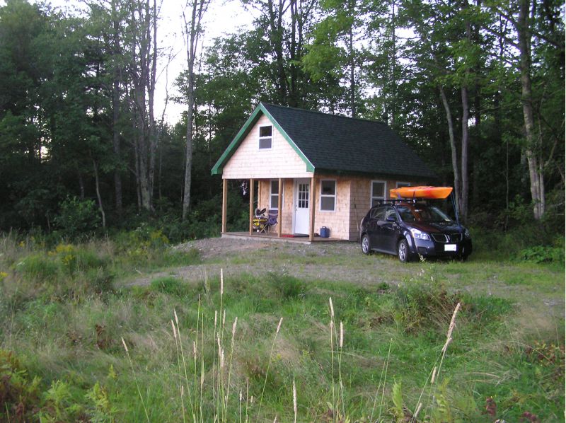

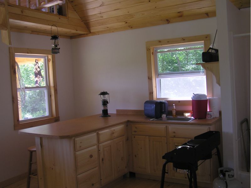

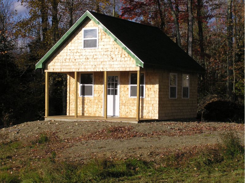

Thought I would share some pics of the little place I recently built on some land from the family farm where I grew up. I've had the land since 1993 and finally decided to do something with it. It is in Swanville, Maine on 8 1/2 acres. The footprint is 16' x 20' including the 6' porch on the front. There is a loft over the porch with folding pull-up stairs to access. The foundation is a concrete slab. Drains for a sink and a shower were installed under the cement. The toilet is an outhouse. I am using Coleman lanterns and LED lanterns for light and cooking with a propane stove. Heat is a vented 18,000 BTU propane wall heater. I built it all myself using all new materials. The cost including all permits, foundation and materials was $9000. Next summers project will be installing a small solar electric power system to run a small television and maybe a very small refrigerator.

Kitchen area
Kitchen area

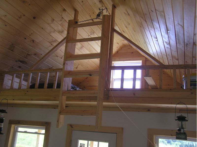

Loft and folding stairs

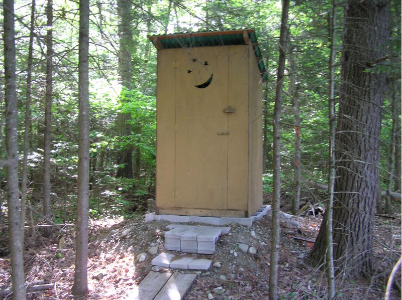

Looks great, very professional! Are you planning on a rainwater collection system or do you use a well with a hand/electric pump or haul in water? What do your gray water drains run to? Would like to see photos of your outhouse if you have any.

I am trying to keep it all very simple. I don't go there a lot and have been taking water in 5 gallon water containers. I have a gray water system design but have not built yet - and may not. The drain pipe right now goes to an upside down 5 gallon bucket buried in the gravel pad on which the slab foundation sits. I typically put less than 5 gallons of water down the drain when I go there on a weekend, so, unless the code enforcement officer says something, I'm not inclined to spend the $2000 it will take to build that system. The outhouse was sited and designed by a soil scientist and I built per plan so that is all legal.
Outhouse
Outhouse

I just purchased a small cabin with an almost exact loft. I removed the stairs as they took up too much room in the main area and am planning on building a ladder. Your ladder design is exactly what I am looking to build, including using the ladder as part of the railing for the loft when it is up.

I would also be interested in your ladder specs. We have a 16 x 20 shed with a loft and trying to fit in a ladder that doesn’t take up much real estate. Your ladder looks like it would be perfect. Please share your design. Thank you.

I would also be grateful if you could share your ladder design with me. This is exactly what I have been thinking of for my Tiny Casita. I have 2 lofts, one for sleeping and one for storage. Using this type of ladder will allow me to keep the floor plan open, without the impact of 2 sets of stairs on the space.

I like the design/shape, love the overhang porch. I get critics telling me I should of closed mine in for more floor space, but I like the covered porch. Your workmanship is great.
