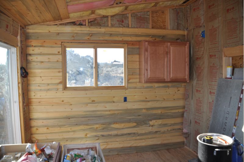

 Tori had mentioned that she did not want to step over the pile of T&G that was sitting just inside the cabin entry so the first order of business was to make that pile go away...the wall behind the kitchen area was targeted.

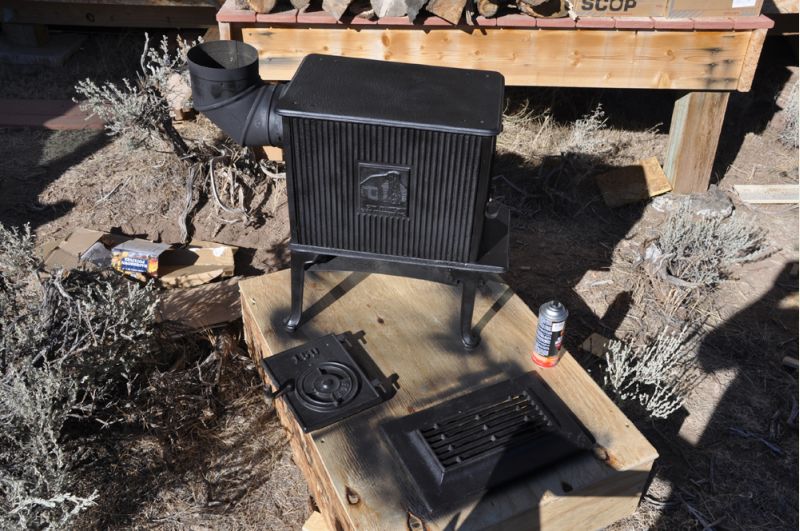

 The second order was repainting the wood stove and installing the damper and additional pipe.

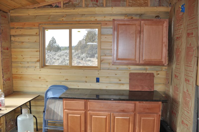

 Then I moved on to the tile...got a good chunk done and the added thermal mass felt good under our feet.  I got the tile at a great price...about 8.50 a case for 12 -13" tiles..the black granite was also a deal, close out for about 4.90 a foot.  I chose black for behind the wood stove to adsorb more low infrared.

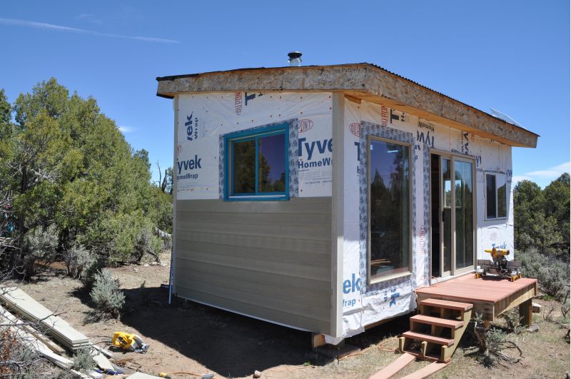

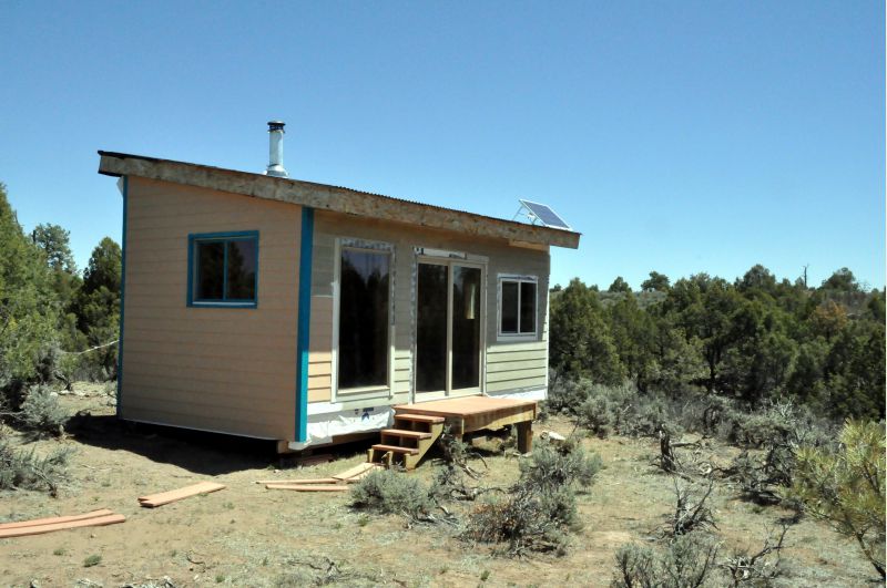

 | # Posted: 20 Jun 2011 12:22pm - Edited by: Moontreeranch Reply
 Its been a while since I've posted here, Two trips to the cabin since thanksgiving. A spring break trip, and Memorial day. The wood shed got some paint ( $5 a gal mis-tint) and the cabin got some tyvek and the start of some Hardi plank.  In side the tile set over thanksgiving got a few more added and some grout.  next time down I hope to get more hardi trim up on the front of the cabin and the last 30 sq or so of tile in.

 I go the hardi up on the west and south sides...and we did get down there back in April...The Mrs was not overly happy with the HOA beige I had started with  so we got a color that is a bit closer to the native adobe colors of the Taos Pueblo.
 I've been really busy with work this summer and hope to get back down in Oct.
