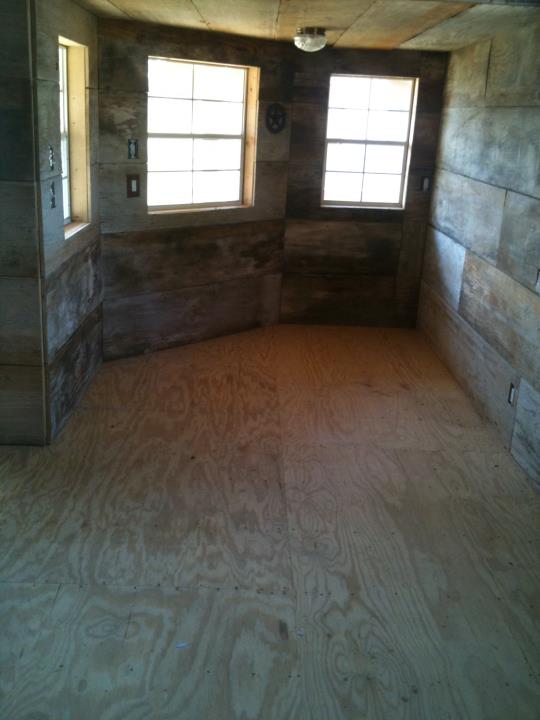

Just replied back to you on youtube buddy. Sorry it has taken so long but it is reclaimed old barn wood so I just put it up as is.

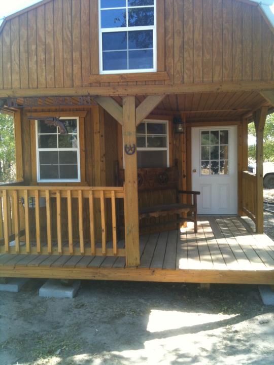

ok now here are some photos. Front view.

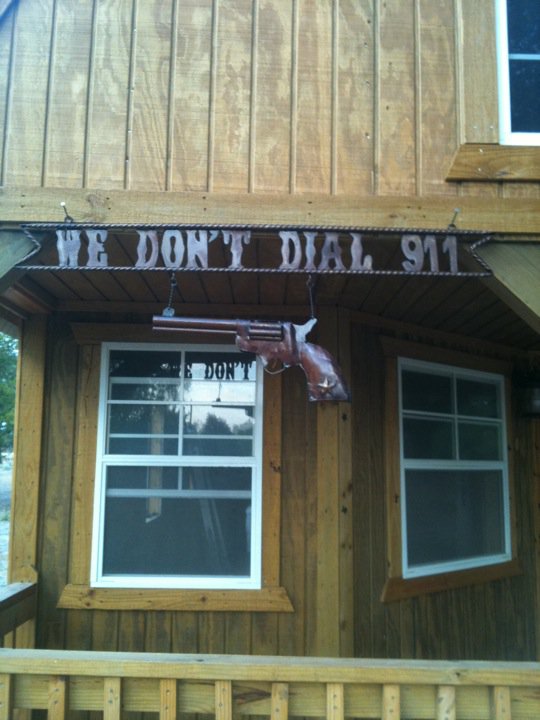

|  My "Welcome" sign lol

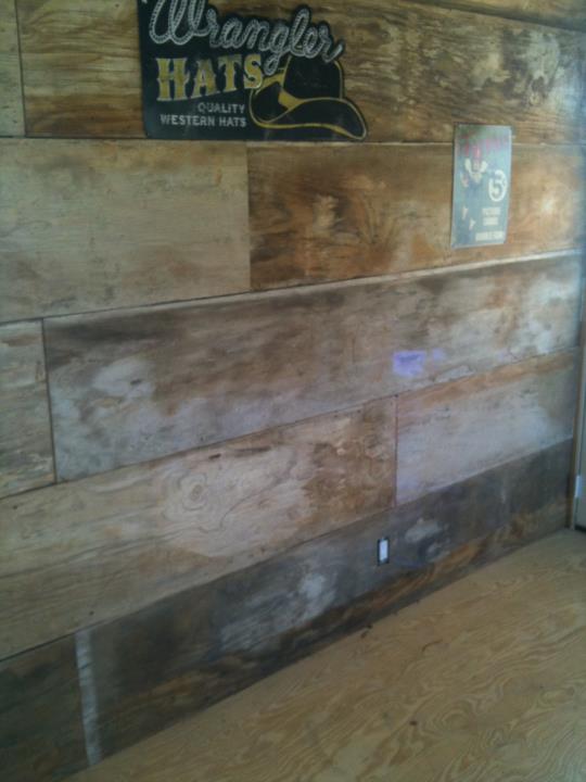

|  Interior Walls

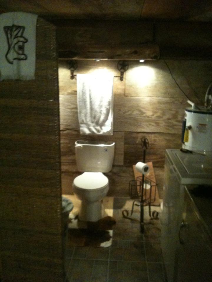

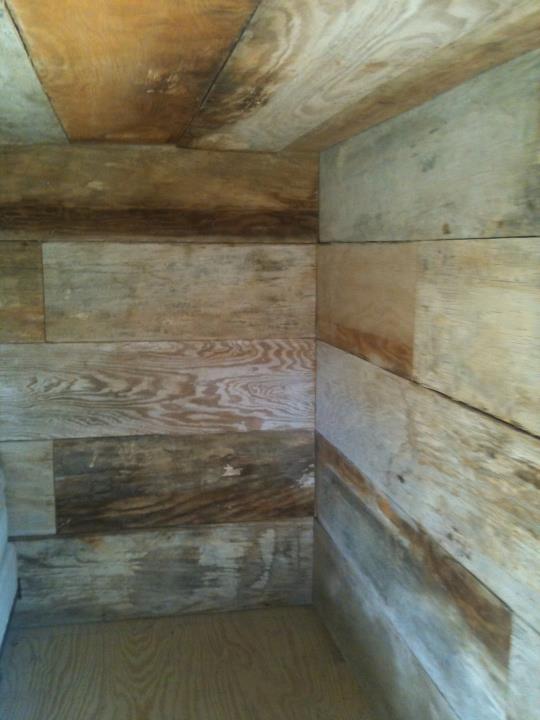

And more photos Bathroom Interior Wall

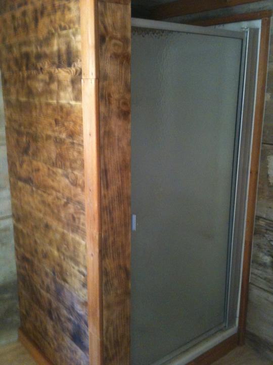

|  The custom built shower
|  Bathroom with Cedar light

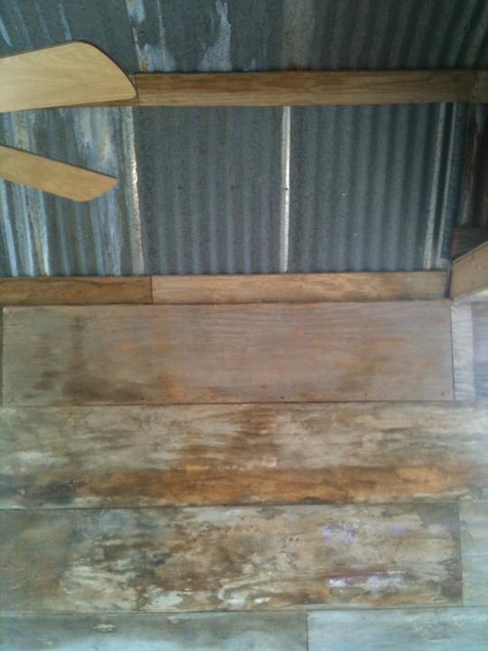

|  Ceiling.

Love the welcome sign, and all your iterior finishes look great..

Rifraf
# Posted: 15 Jan 2012 01:02pm
Hey SmallTownKid,
I was referring to the outside of your cabin, the finish looks .. newer than mine. Did you put an oil stain/sealer on it or something?
If not I guess they just do stain from the factory better out there in Texas ! :) Ill have to do mine myself.
SmallTownKid979
# Posted: 17 Jan 2012 05:47pm
Of Rifraf my bad I thought you were talking about the inside. Well I know the outside is Pine. All I did was clear coat it with semi-gloss polyurethane (The Outdoor Coating). Gave it a little more pop.

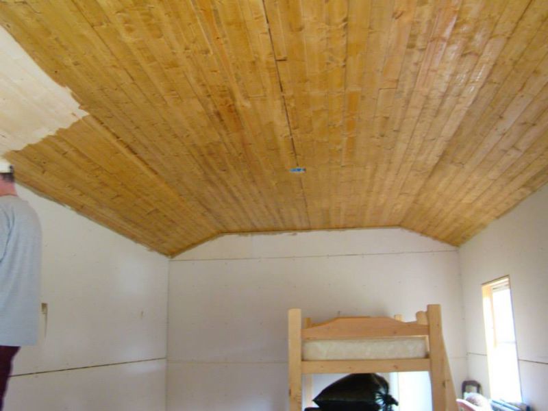

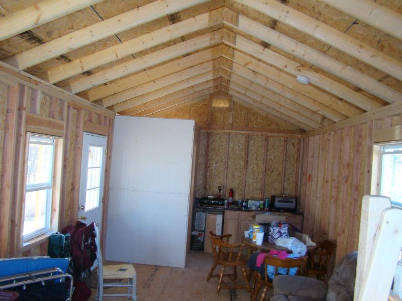

I dropped my ceiling to a coffered sort of to allow room for baffles and air space. soffit vents and gables move moisture out.
in the pics the flat was dropped just enough to have the batts below the gable vents. I scabbed 2x4's to the rafters to make the flat section. The angled sides of ceiling are whats left of the original rafters after the drop. Hope that makes sense original vault
|  dropped for air space
|  attaching flat rafter
|  dropped and insulated
