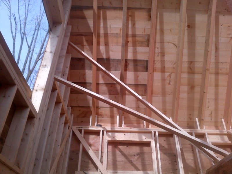

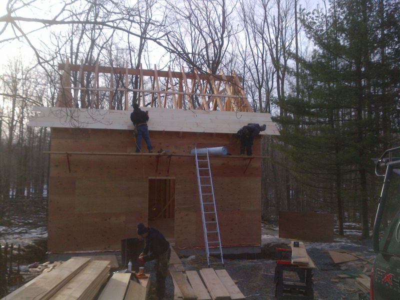

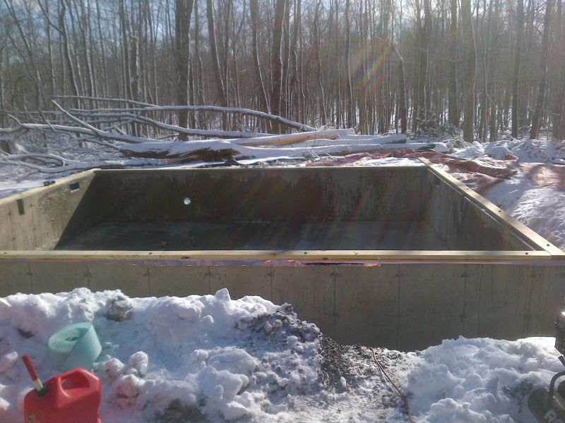

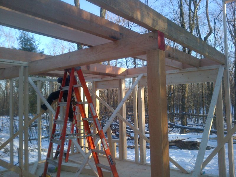

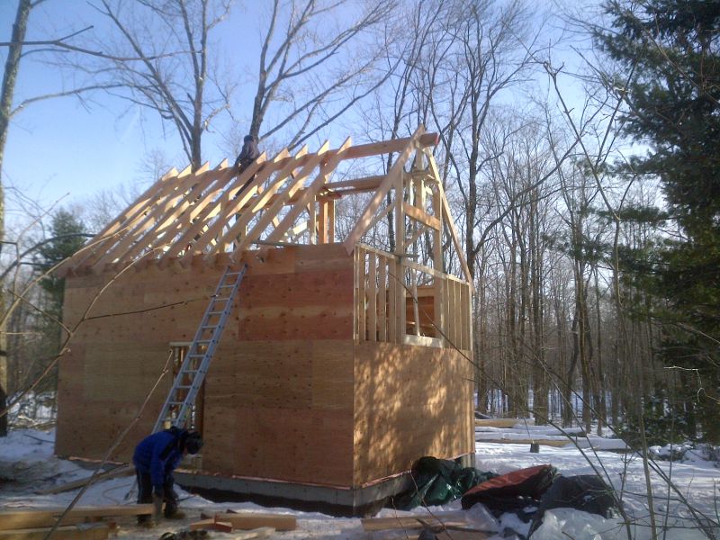

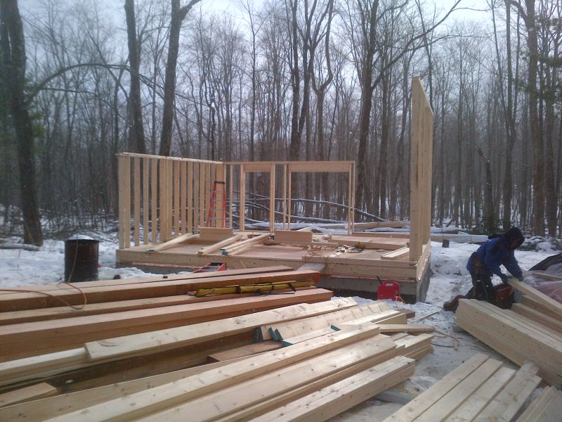

20x24 cabin Im building
bunkersnag
# Posted: 13 Feb 2012 12:34pm

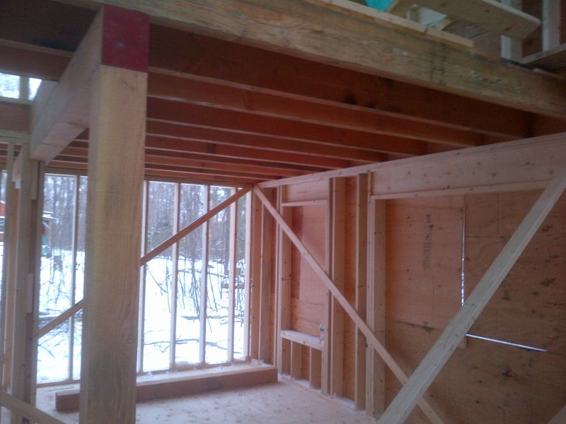

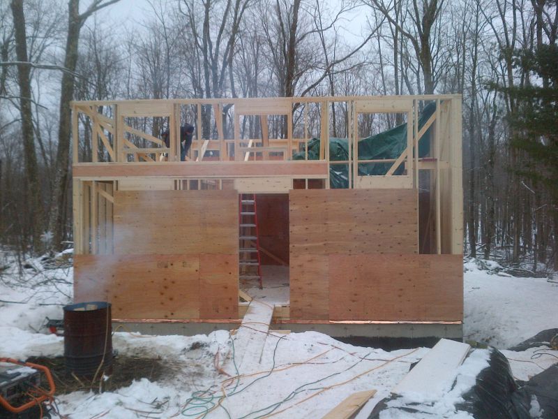

some more pics
bunkersnag
# Posted: 13 Feb 2012 12:36pm
more
bunkersnag
# Posted: 13 Feb 2012 12:39pm
more
bunkersnag
# Posted: 13 Feb 2012 12:50pm
more pics
VTweekender
# Posted: 13 Feb 2012 07:18pm
wow, beautiful cabin in a beautiful setting, congrats!

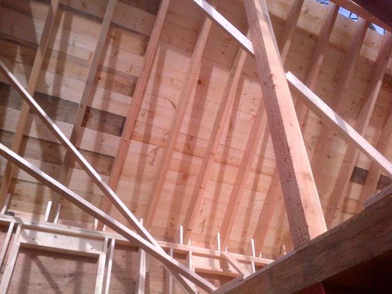

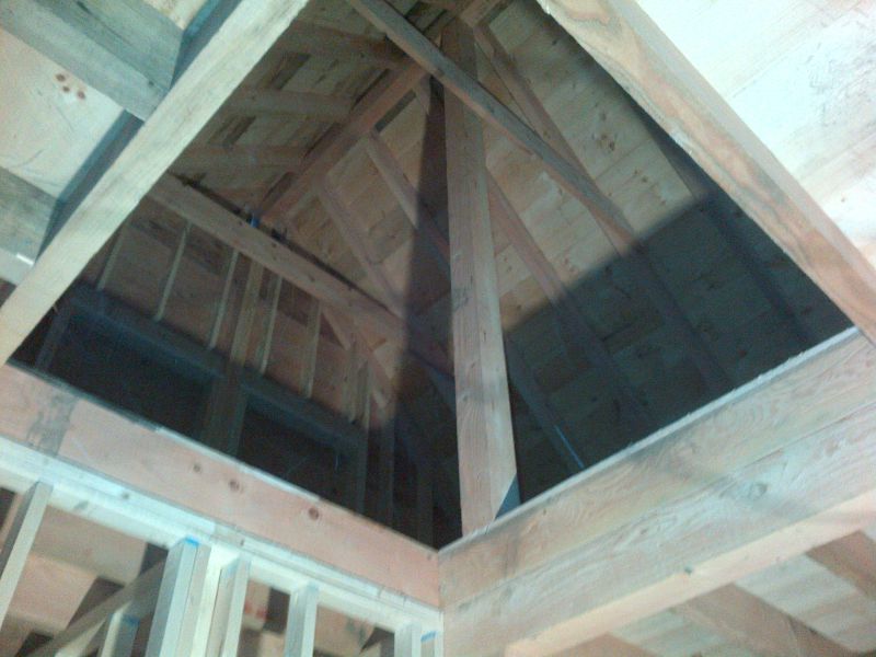

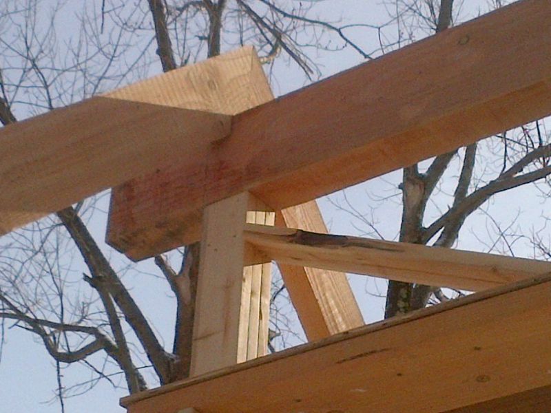

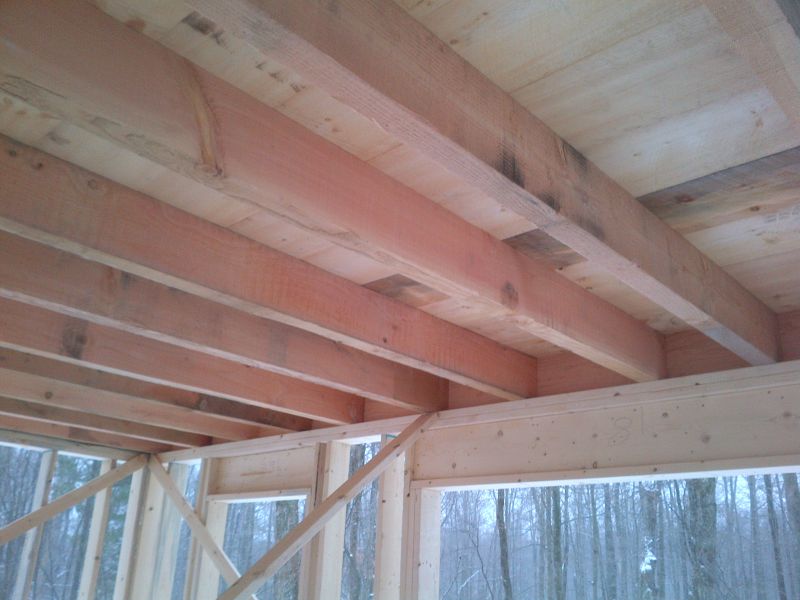

adakseabee
# Posted: 13 Feb 2012 08:31pm

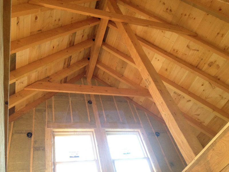

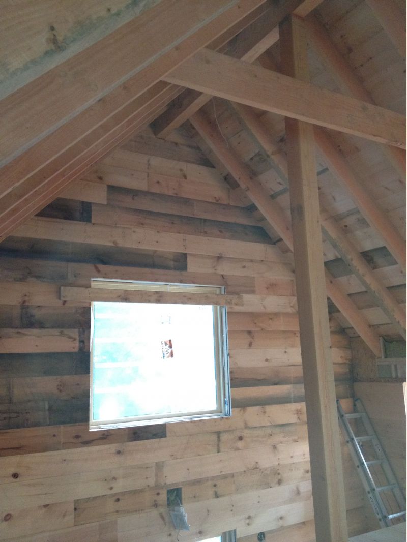

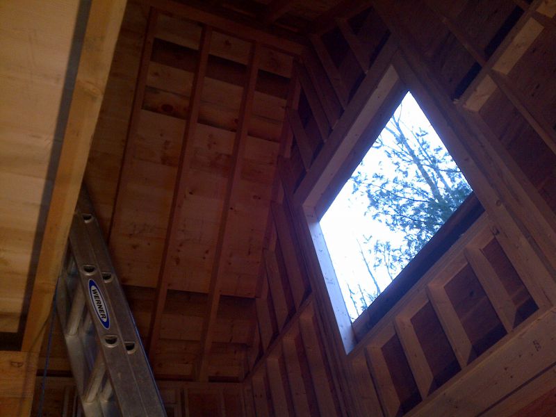

Bunkersnag, are you employing a structural ridge to support the loads of and on the roof system? I would be interested to read about your design and construction experience. This appears to be one of the more unusual cabin builds, very intriguing. Thanks for sharing your photos. Adakseabee
bunkersnag
# Posted: 13 Feb 2012 08:43pm
yes that is a 6x10 structural ridge. 3x8 roof rafters with 1x12 rough sawn shiplap as roof decking. all beams will be left exposed. I framed a 2x6 roof on top of that and filled with high R ridgid foam to achieve the r value. all beams and joists are #1 rough sawn doug fir from out west.I appreciate your comments.

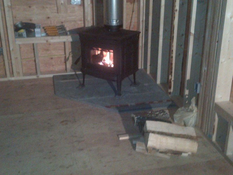

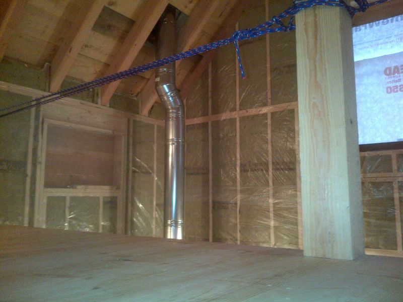

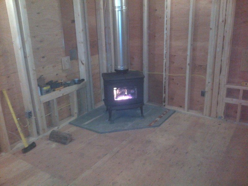

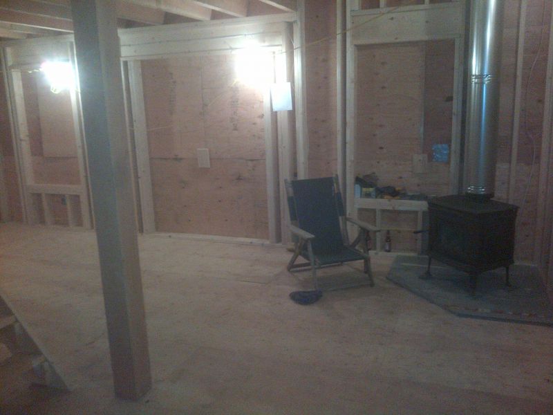

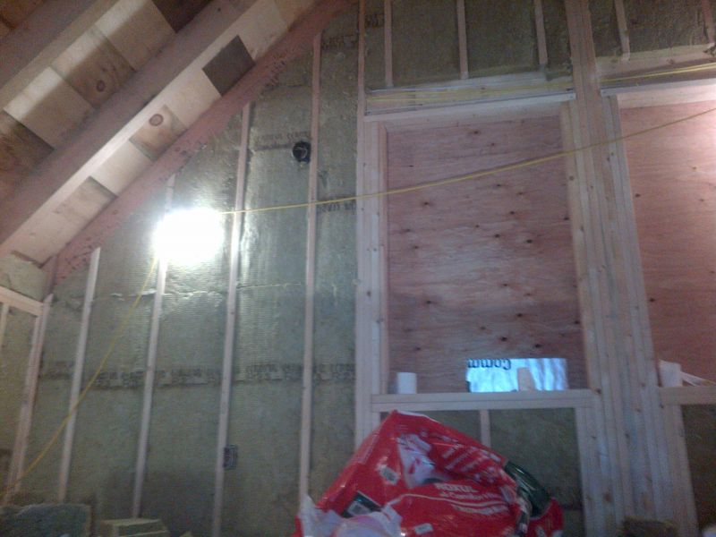

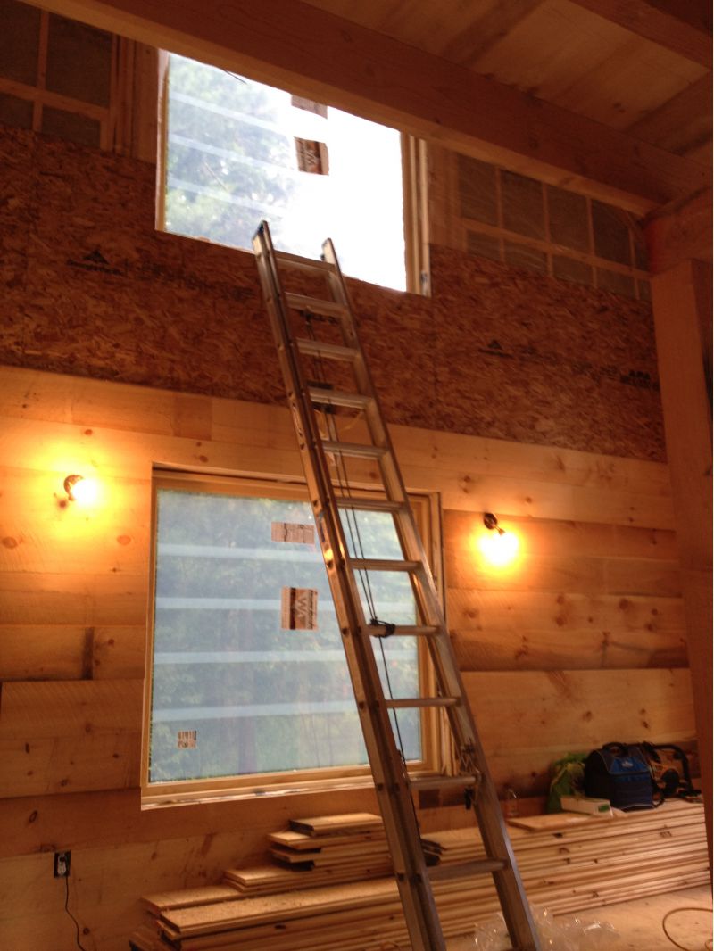

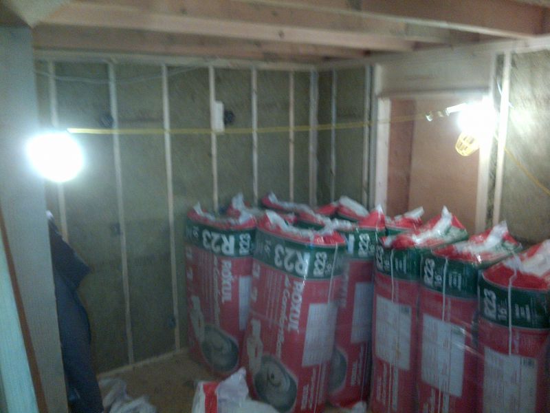

thanks guys , did some more last weekend. insulated, and installed wood stove. ready for rough sawn pine on interior. set windows and doors next week, and start the board and batten siding.
bunkersnag
# Posted: 24 Feb 2012 09:51pm
more photos
bunkersnag
# Posted: 24 Feb 2012 09:52pm

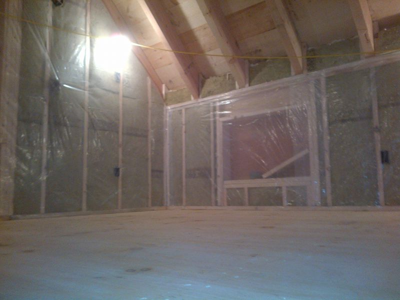

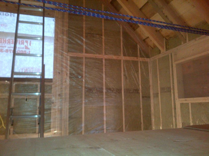

insulation
bunkersnag
# Posted: 24 Feb 2012 09:55pm
roxul r-23, with poly vapor barrier over it.
bunkersnag
windows and doors next week.

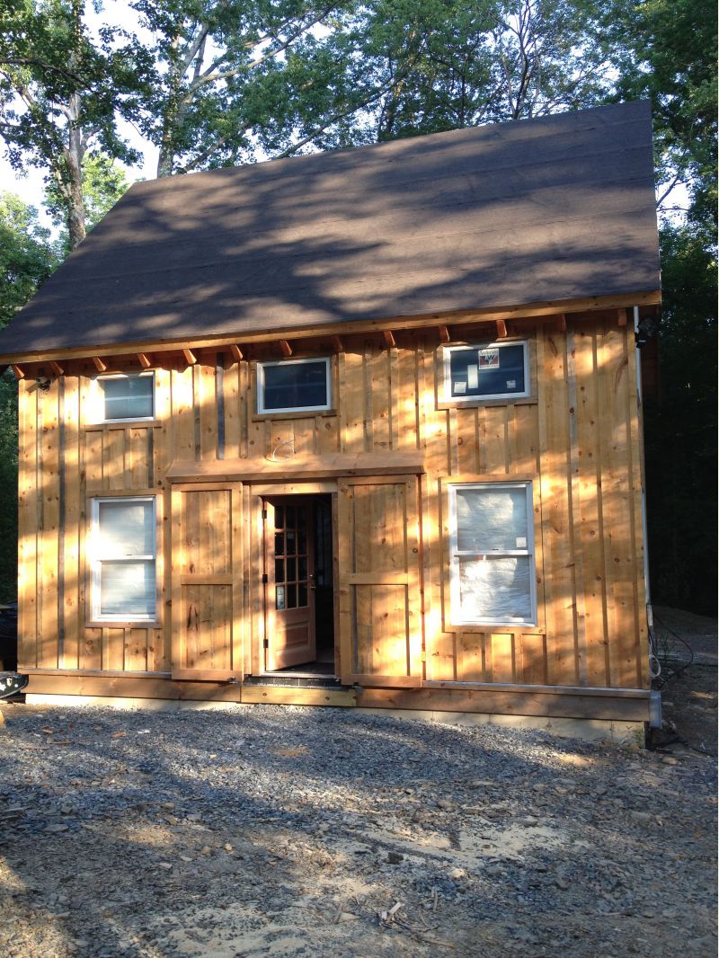

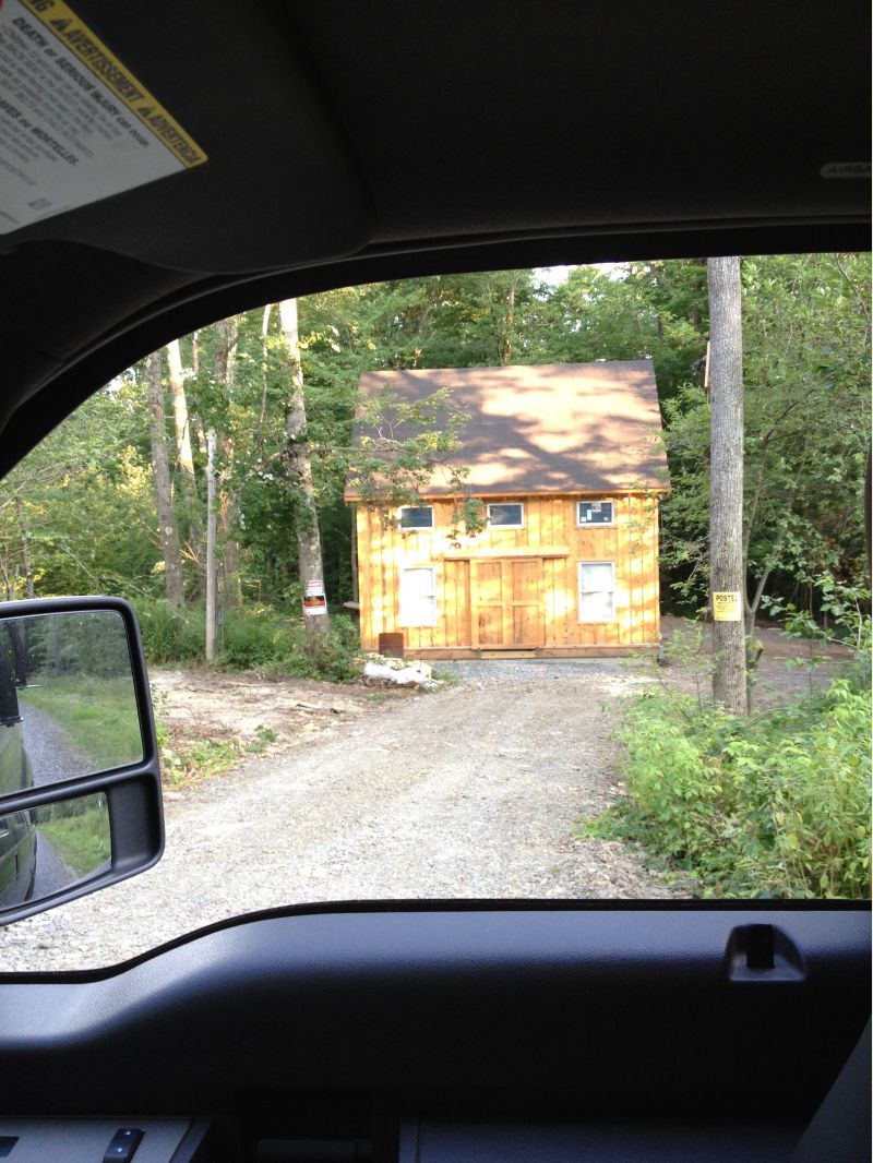

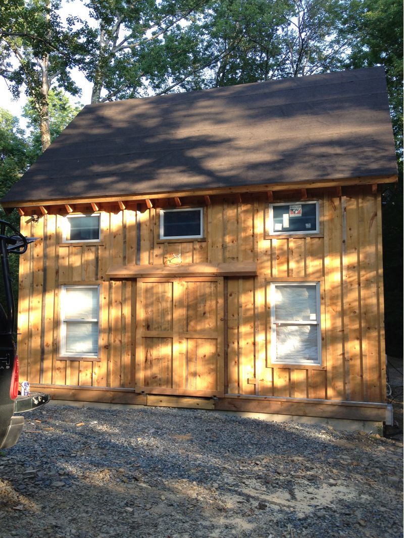

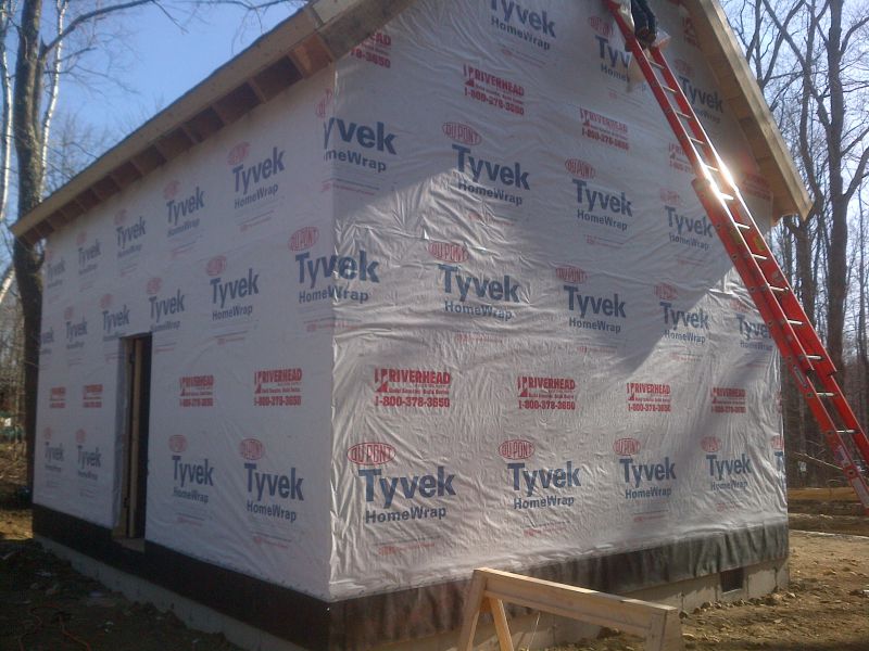

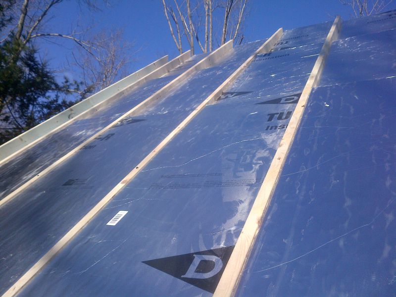

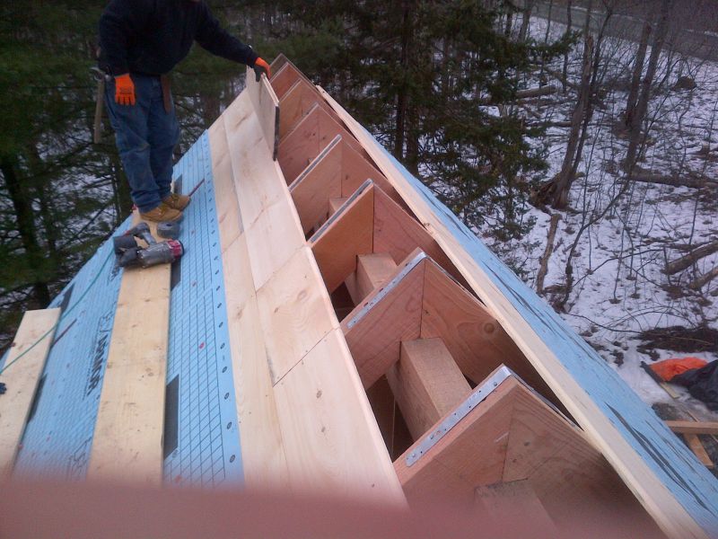

# Posted: 29 Jul 2012 09:11pm
updates to my cabin
bunkersnag
# Posted: 29 Jul 2012 09:13pm
more pics
bunkersnag
# Posted: 29 Jul 2012 09:14pm
metal roof next week

beachman
# Posted: 1 Aug 2012 08:46pm
What a cool cabin. I love the front doors with the barn doors overlaid. What a great loft too. I also did the metal roof and am quite happy with it. I had to use a structural ridge through the loft to support the roof - I like the way you did this. Beautiful!
bunkersnag
# Posted: 1 Aug 2012 09:30pm
thanks, I am going to start the roof this weekend, should be fun on 12/12 pitch.
# Posted: 2 Aug 2012 09:52am
Got roof jacks? It seems so many want 12/12 these days. I long for the 4/12 roofs where I could lay down and take a nap.
