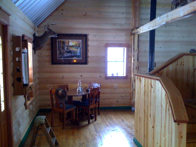

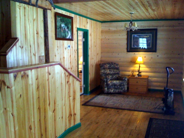

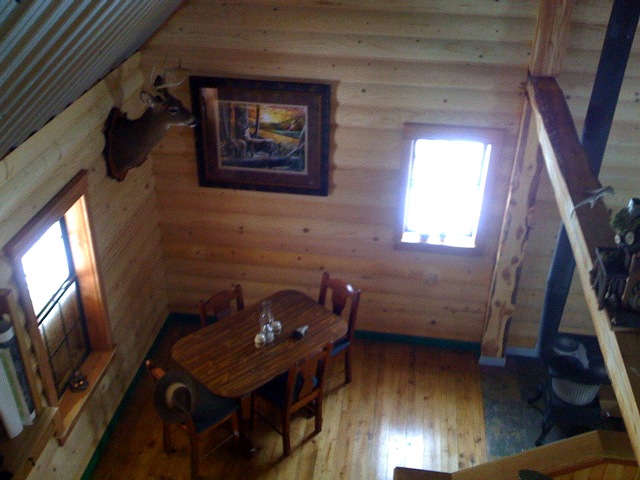

Thought I would share a few photos of my hunting cabin. This was a
great project, and I love staying at the cabin.

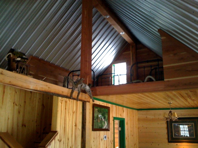

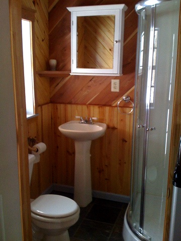

Here are a few more photos. cabin is 20x30 all solar with 8 185 watt
panels and 4000 watt converter. has all the comfort of home, and
all the peace and quite of the outdoors.

WOW!!!! You call that a hunting cabin?!?!?!?!?! It is amazing! It looks like you could easily live there. It is beautiful! Congratulations!!!

Welcome! Very nice and cozy place! I love your floors. Did you do all the work yourself? Congrats!

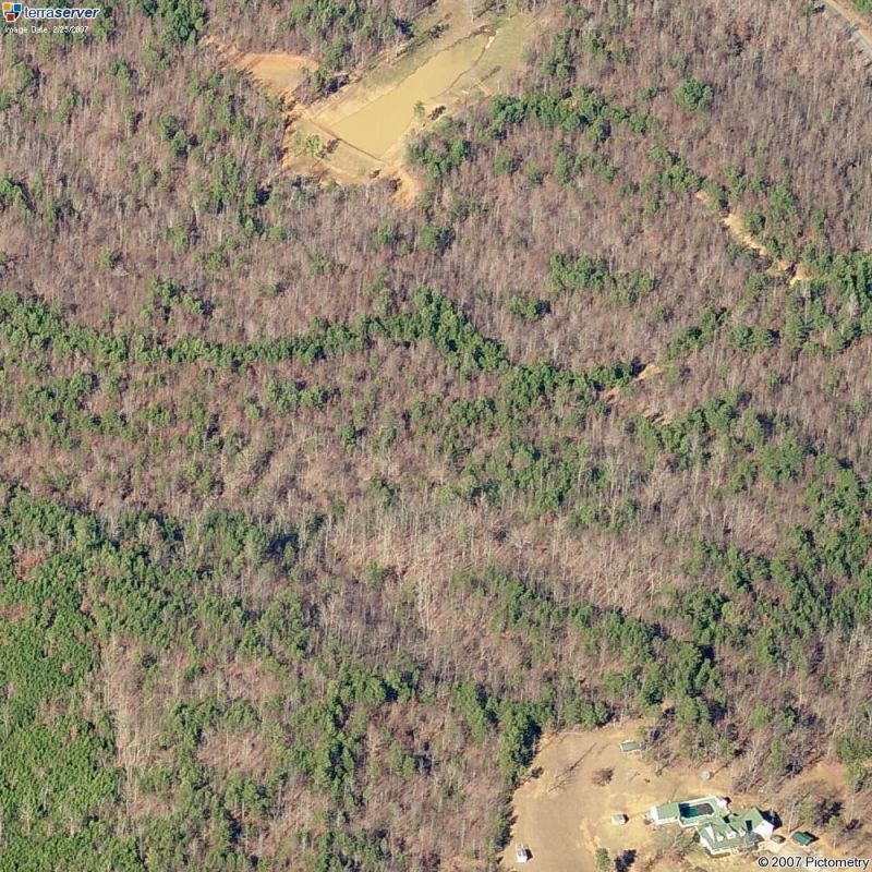

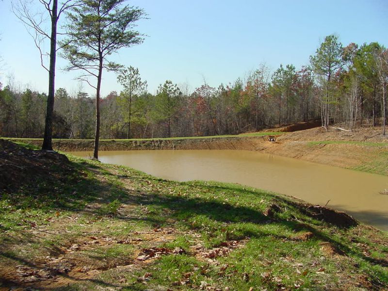

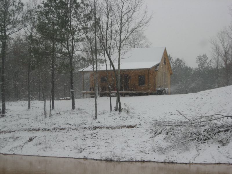

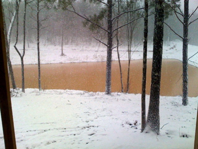

Here is a Photo taken durring snow!! Also Pond that I built.

Wow. Thanks for sending the outside pics - Neat cabin. Alabama lets you "build a pond"?
hankr
# Posted: 5 Mar 2012 03:59pm - Edited by: hankr
My house is in the lower right in this photo, cabin is about 1/2 mile
from main house. no problems building ponds as long as they are under 10 acres. then you must have them engineered.

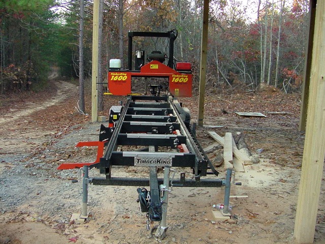

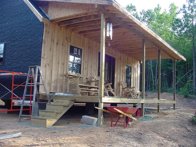

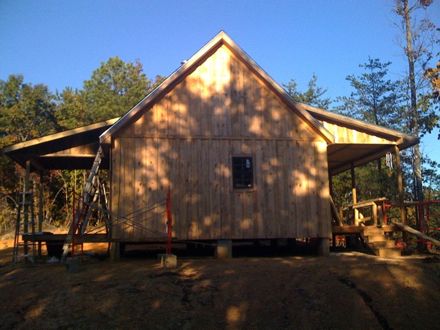

All of the wood used in the framing, and outside bat and board was
cut by me on a Timberking 1600 mill. cedar in loft area and trim was also cut on the mill. Had to let it dry for about 6 months.

# Posted: 19 Mar 2012 02:00pm

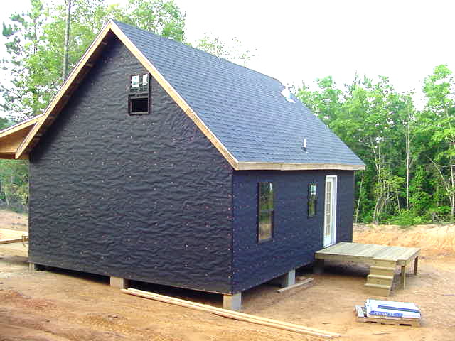

Here are a few construction photos. most of the work was done by
me and a finish carpenter. I installed the solar panels and wired the
inverter and charge controller.
Xantrex XW4024
Xantrex XW60 charge controller
250 amp E-Panel
8 Mitsubishi PV-UD185MF5 185 watt Panels
Xantrex auto start for generator
Xantrex Remote System control Panel
8 300 amp hour AGM batteries 6V wired for 24 volts
I mounted the panels on an old C-band sat. mount that I converted
Each mount holds 4 panels and can be moved using the old Sat. positioner.

Really nice looking place you have there. I'm confused about the roof. From the interior it looks like metal but then I see shingles in the construction photos. Do you have both? And wow about the snow- I doubt you get much snow down there.

Yes it is metal roof on the inside, I used it because it was easy to
install, and I did not want to use Drywall or wood. We average 2-3
inches of snow each winter, with a 4-6 inch snow every 2-3 years.
# Posted: 22 Mar 2012 06:48am
very nice hunting camp--wha type wood for you B & B siding???
hankr
# Posted: 22 Mar 2012 10:14am
It is southern pine, it had to dry about 4 months before I cut it
on the mill. softwood unlike oak. Drying time is important to
control shrinkage.
