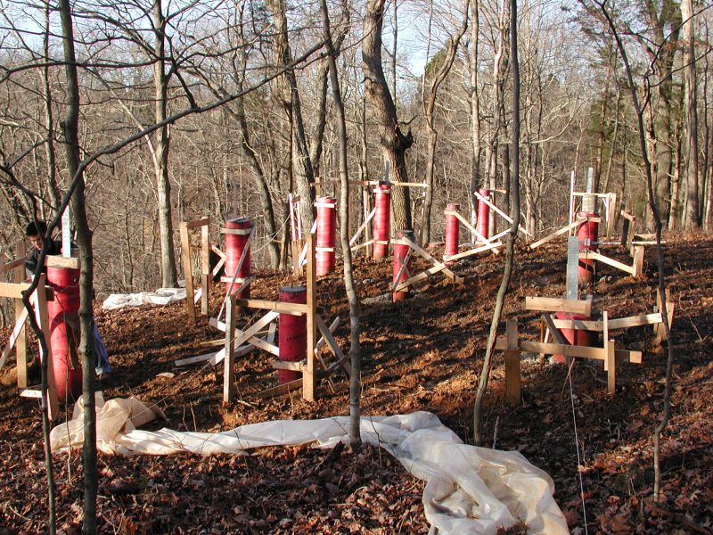

danielgraff
# Posted: 23 May 2012 02:41pm
Thanks for the feedback.
MJW: Yep the solar is going to tricky, might have to make a small (okay, large) clearing

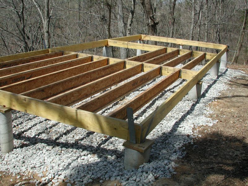

OLDBUDDY: Not really up on a hill, we enter the property and drive up a slight grade for a few hundred yards. One side slopes up and the other starts down and then really starts falling off. At the bottom of the cliff is a large creek. We are in Adams Co. around the Miller's Amish community. Kind of odd, if we head south west away form our property we never see Amish. If we head North you have to take ever sharp turn in the road with care as not to hit a horse and buggy. When I wrote that I have not been documenting the process. I was joking a little, I have taken a few dozen photos. But not as many as I wish I had. (I found more today, see attached)
SOONYB: The foot print is 37'x14.5" divided into three equal "bays" the two end bays have the lofts and the middle bay just has a tall ceiling. To answer your question the lofts are 12'-4" x 14'-6"
Best, Dan My site, view, and the beginning of the foundation (Jan. '05)
|  Beginning of the foundation (Jan. '05)
|  Foundation (Jan. 05)
|  First floor framing

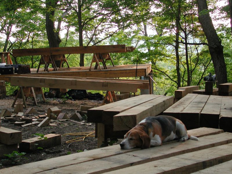

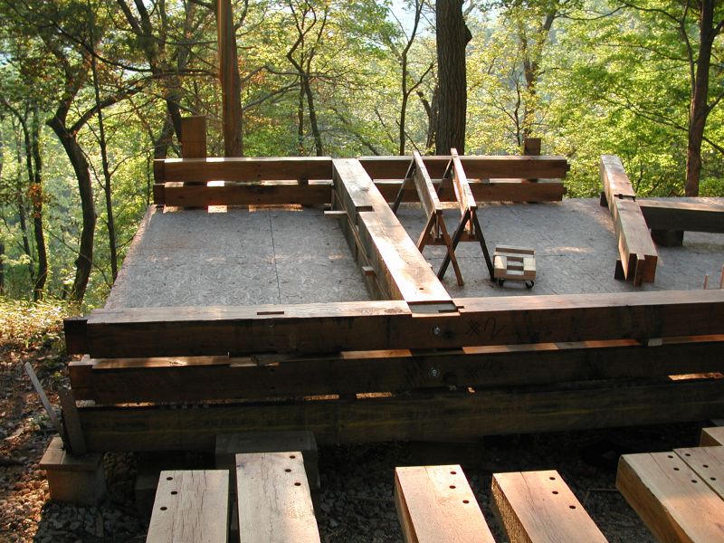

danielgraff
# Posted: 23 May 2012 02:47pm

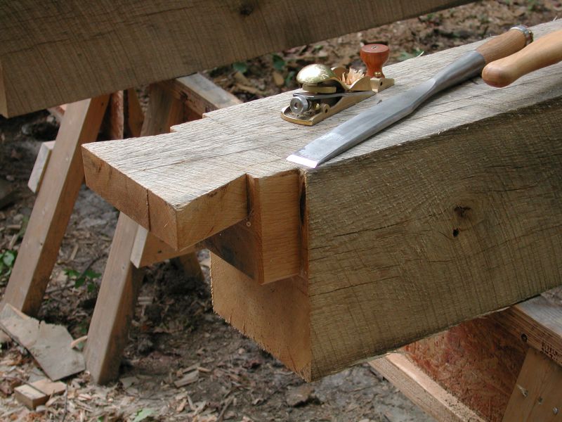

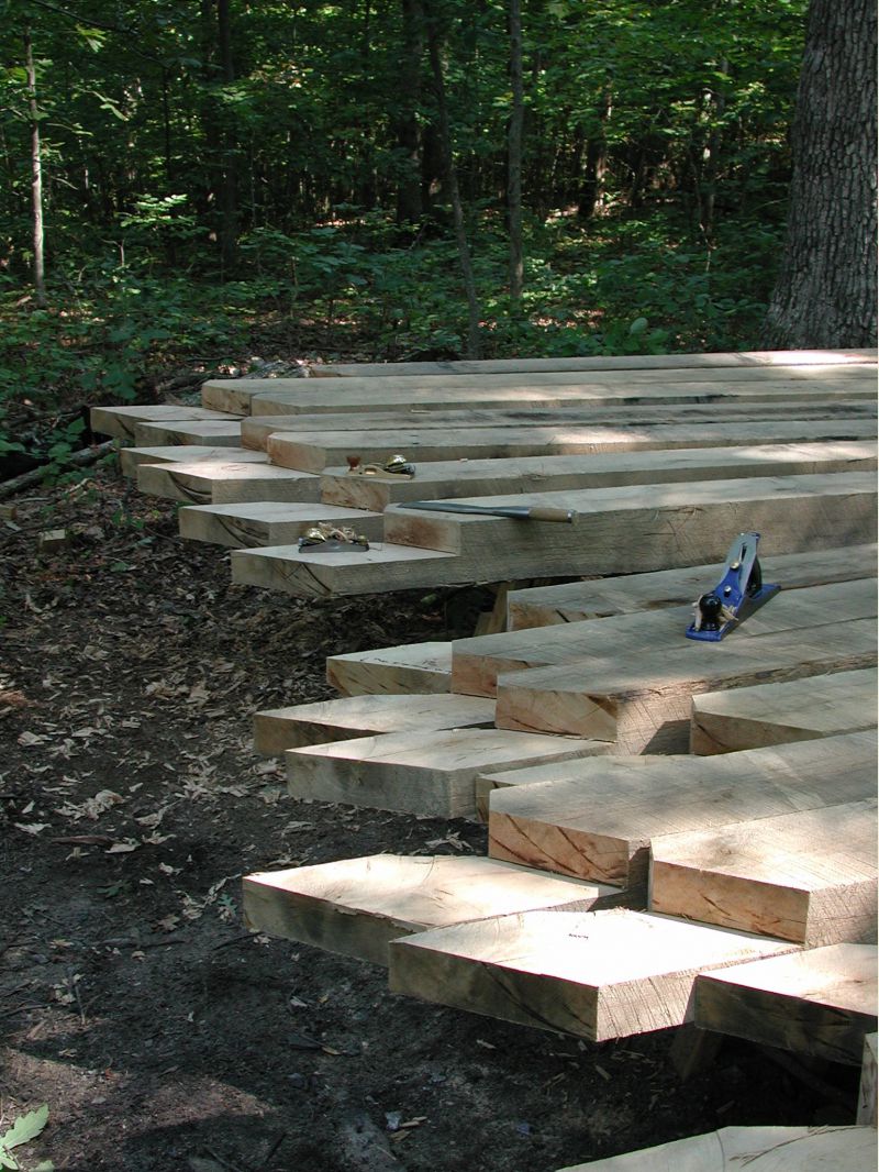

And a few more photos. These are from the spring and summer of 2005 just a few timbers
|  shouldered dove tail
|  Rafters with lap joint
|  Bents assembled waiting to be raised

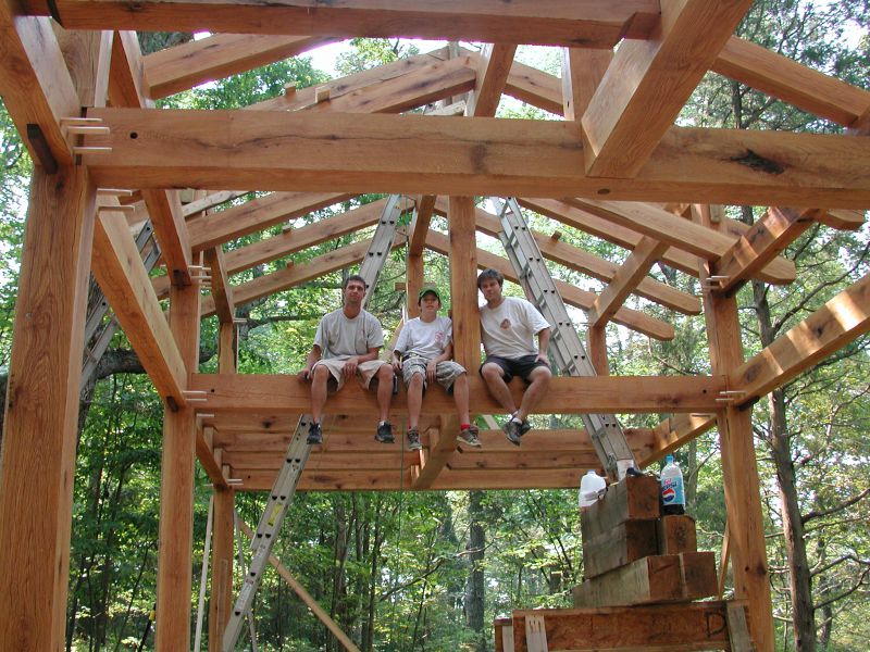

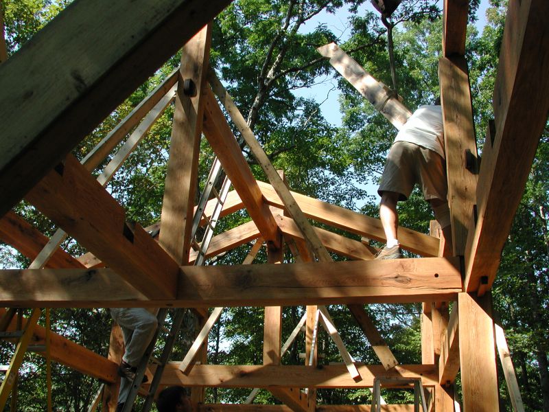

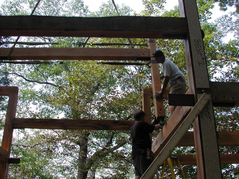

danielgraff
# Posted: 23 May 2012 03:01pm
And finally the raising...
The frame raising was on September 8, 2005. We started at 6:00am and were finished by 3:00pm. It went pretty smoothly and almost everything fit perfectly. With the exception of a few mortises that had to be sweetened up with a few chisel swipes.
The only "holly cow" event was a 6"x8"x12' long rafter slipping out of it's sling and falling from about 35 up. We used a boom truck to aid in the raising. The operator, who owns a tree service company, was great. He picked and placed my timbers with precision.
Best, Dan Raising the mid bay Ridge and columns
|  Setting rafters, 6"x8"
|  Final frame assembly

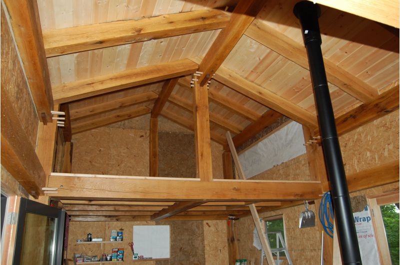

fpw
# Posted: 24 May 2012 02:10pm - Edited by: fpw
Barr chiesel, eh? Nice.
Looks like you splined the plates into the posts. Where the plates squared off? How much shoulder did you cut into the post?
danielgraff
# Posted: 24 May 2012 02:16pm
fpw Yep, worth every penny!
