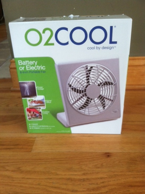

I just picked up the 8" O2 fan at Wally for 11 bucks on sale. Uses approx 4.5 watts on low and 5.5w on high. Using on low is plenty of fan for me. Comes with an AC adapter only. I'm using it with a 12v car adapter that I have with my small solar charged system.

Yes the 8" I bought holds 8 D Cells for 12v which is why I was interested in this fan...not all of their fans are 12v. Also the 8 Batteries which are located in the base act as ballast without the weight of the batteries it will tip over easily. I don't believe mine has a thermostat. I'm going to pick up another.

Bunch of different models. I bought another 8" and saw a 5" electric or usb powered one. I bought the 5" as well for it's usb capability. I think they make it for office use. Kill O Watt measured 1.5w. Under $10
