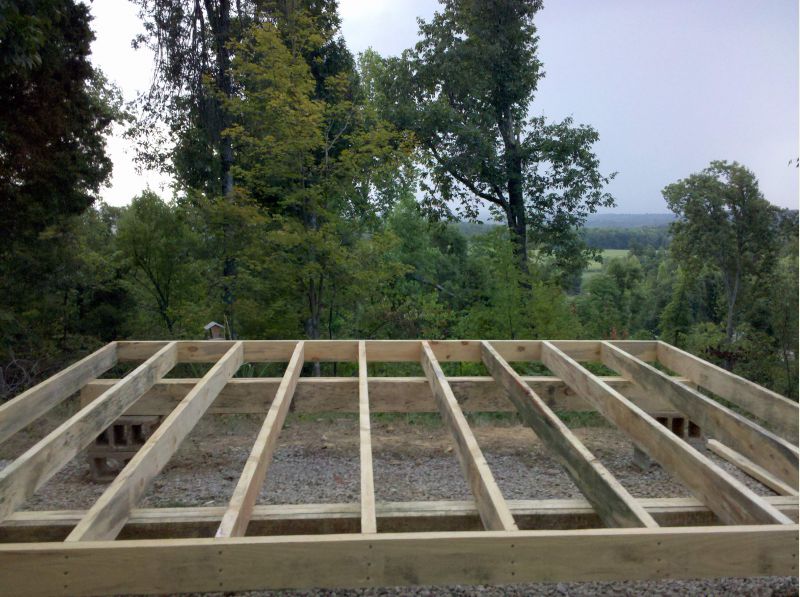

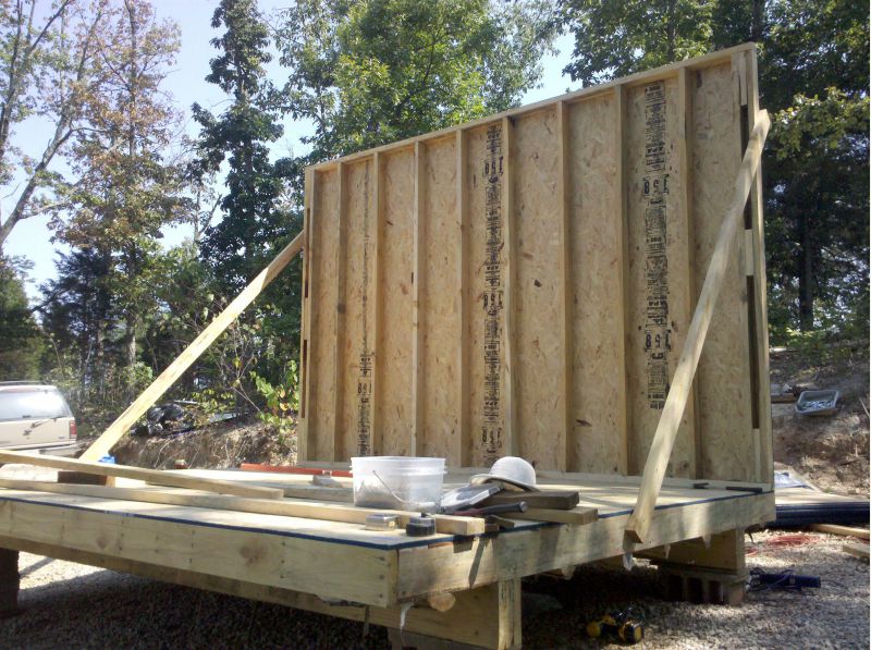

Nine months after buying our property our small cabin has at last been started. We have changed our minds a few times on the spot to build on, the size of cabin, and the layout... but at least we have finally begun, lol. This is stage one which will be a 10x12 "shed" and the first of three. We decided to keep each on beams so they can be moved if the need should ever arise. Sheds will be off-grid, with a self contained travel trailer on-site which is hooked to electric and dump station located about ten minutes away. Already having fun collecting materials from Craigslist and the challenge of building debt free.

Looking close at your pic I would have just 1 concern though, it looks like you don't have a ton of tree cover from wind. Your cabin being perched up on 2 loose blocks like it is, will go off its perch in a big gust of wind, the 70-80 mph type gust, which happens. I would take a step in preventing that of happening by attaching a cable at least in each corner of the joists to a drove in the ground rod, drive it in the ground at an angle and deep. Like you would anchor a tent, but with heavier anchors, the anchor rods 2 or 3 ft and strong cable or even chain.
Kev
exsailor
# Posted: 20 Jul 2012 03:51pm - Edited by: exsailor
Looking at the cinder blocks, I think I see a problem. Shouldn't the blocks be oriented with the open cells up? That I believe is where they are the strongest. In a regular foundation that is the way they are oriented.
# Posted: 20 Jul 2012 05:32pm
He's got a point. I've seen heavy cabins crush cement block that arn't stacked like there supposed to be.

Thanks everyone for the encouragement. As far as the foundation... well you have to understand my hubby was a builder for many years and just follows his own ideas, lol! He says a 10x12 will be no problem as far as load on the foundation. After the building is done he will place more block which will stack up to cabin itself and provide more stability, also plans to put in anchor rods and bolt to the skids to help as far as safety. There is a hill and some woods to the back of cabin which really helps as far as breaking the wind force. Our RV sat on the same site for several months and even in some really bad storms with tornadoes nearby we had no problems. If we had more money we'd build much differently, I'm sure but with his business bottoming out, my health problems, and having 3-4 grands pretty much full-time for nearly four years... well we've had to pinch pennies really hard. We're headed into our later years and this should last us as long as we'll need it and if not, well look out nursing home here we may come, LOL. This site has been such an encouragement and has helped us to believe "Yes, we can do this". Ugh, I hate even using that phrase anymore, LOL! Our sub floor is now down and one wall up, with a second ready to raise. It's 10ft. and a bit more than the two of us can handle, will have to call in a strong nephew probably. So loving this!!!

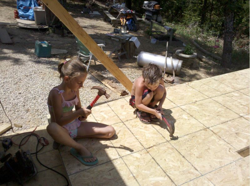

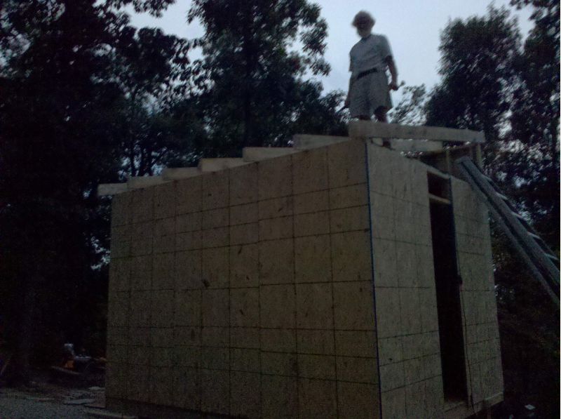

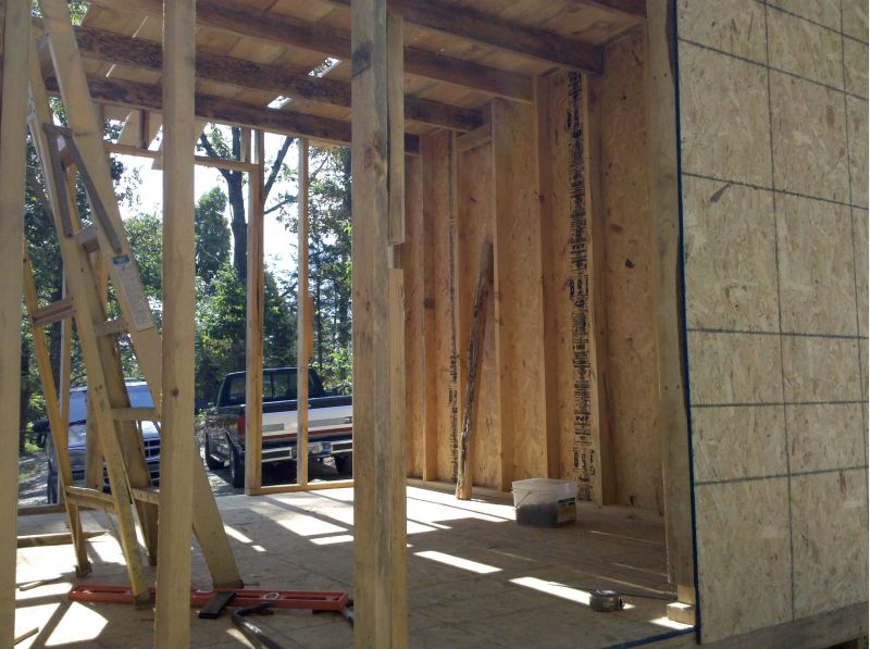

Well, twelve days into our build, (several of those days with no work done due to weather or travel) and we have all walls up, ceiling in place, and rafters nailed and waiting for sheathing! There are just a couple of last minute spots to finish and then window and door can be installed. This first "shed" will eventually serve as kitchen/dining and is very rustic. We are using rough lumber from the Amish mill. Hopefully, by the end of next week the inside will be done (enough) to start moving things into. Thanks, Old Old Buddy for the encouragement, and we are enjoying the building together. The "sheds" will be side by side and will be attached at seams in a way they can be taken apart if needed at a later date. We know this is quite unconventional but we are hoping to avoid a lot of hassles by going with 10x12 sheds on skids. We shall see how this works. Maybe we are a bit crazy... but building totally debt free while on a tiny budget sometimes a little craziness, LOL! view from kitchen window
|  putting down ceiling boards over ceiling joists
|  two of our grands helping nail OSB to wall sections
|  rafters done as dark arrived

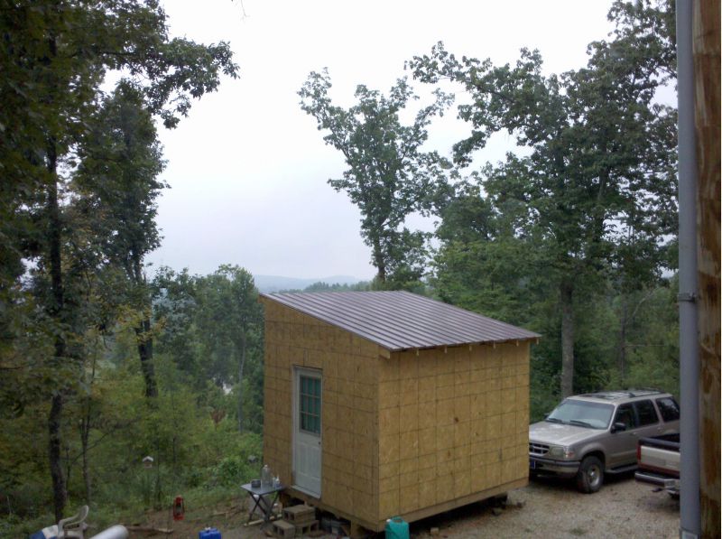

We have the first section of our little cabin under roof. Now just to get the inside walls finished and the outside done. Hoping to get the next section dried in before cold weather arrives.
