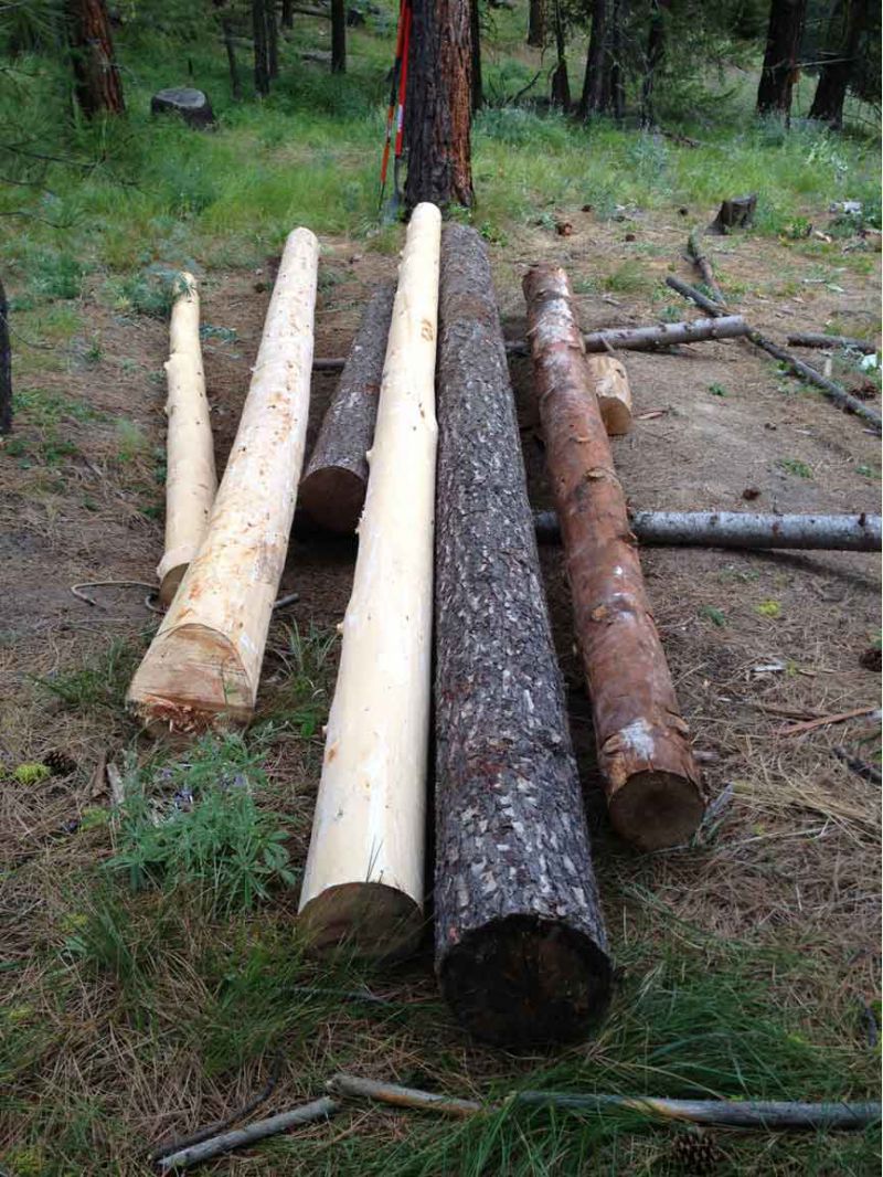

Many trees let loose of their bark easily when first cut, and then as it dries the bark gets glued on. With a freshly cut DougFir you can peel big sheets of bark off with a wrecking bar (flatbar). I don't know within how many days you have to peel them (the easy way). But I did try after 3 weeks and the bark was stuck on like glue.
Also its easiest in the springtime into early summer when the sap is running. I peeled a log July 15 like this. I cut the bark lengthwise with a utility knife then pried off big sheets of bark 5 feet long and 1/4 way around the log. It was "easy" and sloppy/sticky wet too.
In the pic, these are all Douglas Fir. The white logs were peeled immediately July 15. The other logs were felled in December when the sap was no longer running. The rightmost one peeled within minutes (in December) and the peeling (with a drawknife) was difficult.
And then the other logs with dried-on bark,,, are going to be difficult too.
The white logs in this pic were peeled without even scratching the wood, it was so easy. But 3 weeks later the white wood was all spotted on the topsides (looks like a mold or algae). They were left outside in the sun.
Some folks say to stack the logs in the shade. Or spread hay over your pile to keep the sun off. Doug Fir logs. White logs peeled July 15, minutes after felling, bark came off in sheets.

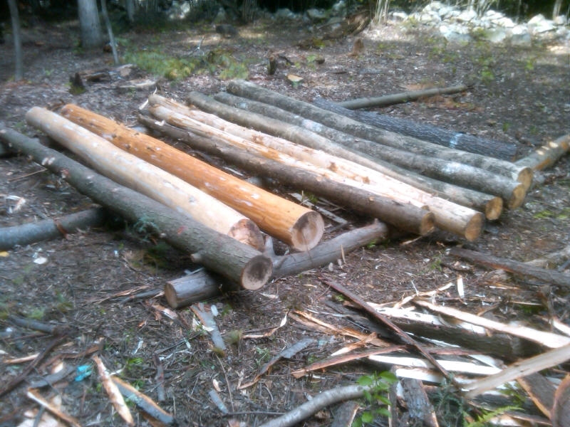

More progress this weekend. Not as much as would like but progress. More satisfying is how much I learn each time. Unfortunately, chainsaw died on me Sat evening and had to bring it in for repair as I know next to nothing about small (or large) engines. But finished felling one tree with saw and then cut it up with an axe and then spent rest of time peeling. Cabin_weekend_8191.jpg
exsailor
# Posted: 21 Aug 2012 03:06pm - Edited by: exsailor
You have a great start. You are all ready a step a head your logs are on sacrificial logs, continue to keep them of the ground. Spray or mop them with a borate solution. That will keep the bugs at bay. Don't cover your logs with a tarp, it blocks air circulation, but suspending a tarp roof over them works. If that is not possible leave them uncovered, off the ground and with enough space between them to allow them to air dry.
