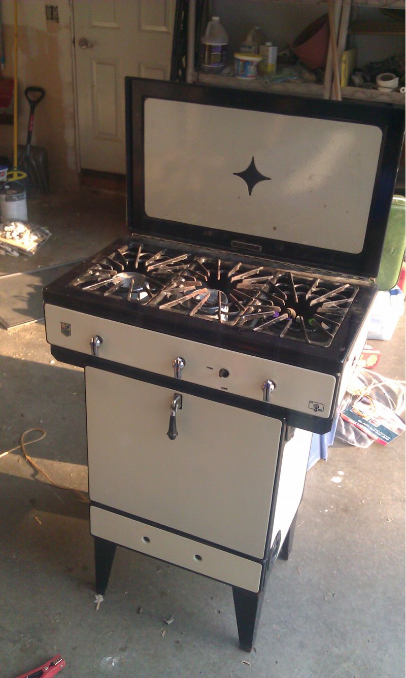

While wandering through antique stores with my wife, we found this little 1920s apartment gas stove. The stove is very sound, in very good shape and we gave 125 bucks for it.
I will have the propane guys swap out the orifices and we now have a much more permanent set up for the Stump Ranch. We should be able to retire the well used Coleman stove to outdoor coffee making duty.
Additionally, I will get a propane tank and haul it out to the cabin, which is much cheaper than buying those little propane containers. This will also give me a source of propane to install some lighting.

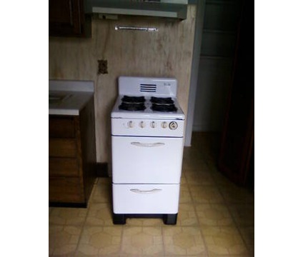

I picked up a small propane stove a few weeks ago that should be perfect for our cabin. This it bu ours has a window in the oven. Only $50 but now I have to get the gas line in.

Storogoth Good afternoon: I am a newbie here and while searching for info on this Vesta stove i came across your post back in 2012. I am hoping you will be able to give me some info on the operation of this stove as i just got this and I am in the process of cleaning it up. So if you would get back to me,,,much appreciated.
# Posted: 1 Nov 2020 20:42 - Edited by: gcrank1
Did you get any info/tips to getting these old stoves hooked up and working? We just got a 1930's (?) Windsor Desoto range that was on natural gas when last used 40ish years ago. The couple that had it always thought it would be nice for a cabin. That never happened for them but it is in ours now while I sort it out for cylinder LP. I aint a 'gas man' any more than I am an electrician, but as a farm boy and an old mechanic Ive messed around with lots o' stuff. Mine has no integral regulator, I suspect that most are like that. LP stuff pretty much runs on 11" WC (water column), that is what the typical bbq rig regulator runs at (the typical ones, NOT the big boss hog monsters). That should feed the stove fine BUT, you must use the far smaller LP orifaces, the NG ones are huge because NG is at a lower pressure. Do Not even try 'em. There are charts online of the BTU's for the burners for either gas. Some smaller LP stoves may have a 'soft' burner with a smaller dia burner head that runs about 3000-5000 btu which will require a smaller orifice than the others. Some may also have a larger dia burner head for the big pots, 10000-12000 btu or so, thus a larger orifice than the more general burner head of about 7500 btu. The fittings should be done with the Yellow/Gas teflon tape, NOT the white/plumbing teflon tape. All supply lines should be rigid with a shut off valve on the supply side of the 'flex pipe', if used to the appliance. The piping needs to be big enough to flow the gas needed for all the burners on And the length of the run from the tank. Basically, use code for the hook up even if it is diy and not inspected. Its a safety thing. So, with adequate, and safe, piping from a regulator (a must have, Never run off a tank without a regulator!) and the right size orifices and some adjusting of the air intake to get a nice blue flame with maybe only a lick of yellow at the tips you should be 'cookin with gas'. Btw, it can be hard to impossible to find orifices for old stuff. Not that big a deal IF you need a larger one for NG, you just drill 'em out incrementally with 'number drills' but most of us are LP and need smaller. There are plugs made to do that, you drill the orifice body for the plug and drill the plug to the size you need. Some gas co. folks will do this for you. Ive done some by carefully peening the orifice mostly closed and drilling to the size I need. As to pilot lights, at least for the top burners, they are adjustable and can be turned off (typically a tiny screw somewhere at the base of the pilot line from the manifold), or maybe better yet, remove that line and plug it off with a pipe plug (save the assembly to go with the antique stove, pls). You can easily light the top burners with a match or bbq lighter (my fav). The oven may need it's pilot to open the gas safety valve which lets the larger volume of gas in for bake/broil. We dont bake/broil at the cabin so my oven control is blanked off. The oven makes a fine place for us to store the cookware. Aint sayin everybody should be doin this stuff, just that its worked for me. Know your limitations.

Thanks gcrank1,Fanman: Thanks for all the info and help. The stove was completly disassembled,,reassembled and cleaned. It works great. It has a pilot light in the oven,,which confused me a little as the old one didn't and so has a safety valve with a thermal interlok. Anyway all works great with a barbecue regulator,,so thanks for the info.
