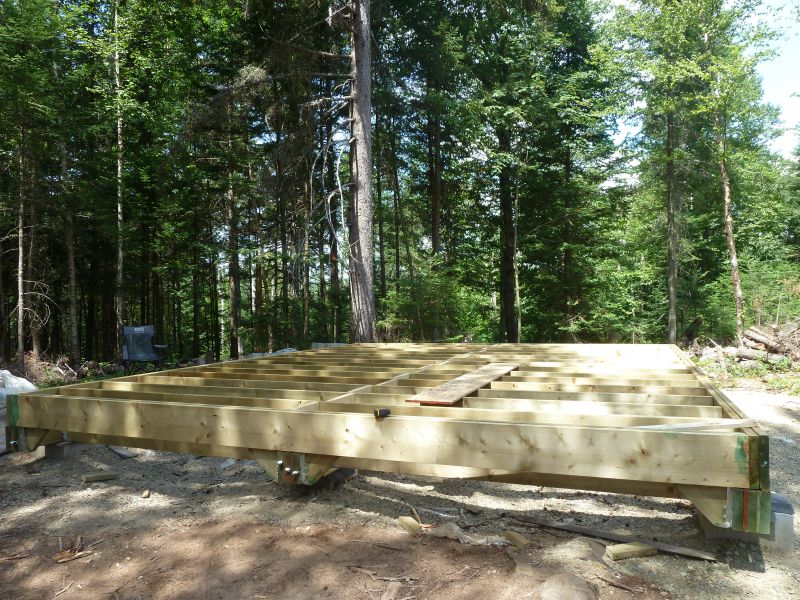

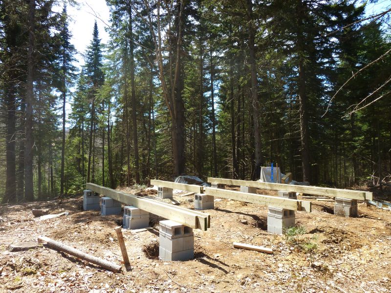

Starting beams
Starting beams
Floor (east)
Floor (east)
Corner detail
Corner detail
Floor Frame
Floor Frame

Someone correct me if I'm wrong, but those upper cinder blocks should have their holes pointed up, they're meant be be used that way for strength, not on their side.
WeekEndHack
# Posted: 5 Sep 2012 08:32pm
bobbotron, good call. The top blocks were actually leaned on their side temporirly as I didn't want rain and stuff getting into the cores b4 filling w/concrete.
Piers are filled and go down 28-36 inches, bottom 6" is packed w/gravel then 3" crushed stone along w/ short pieces of rebar thrown into each core. Still above recommended frost depth of 48", though its on a hill, great drainage, and with decks all around I'm hoping 'float' will be minimized. Also added in extra piers down each side (11 total), each covering 16" square to increase bearing area. Still concerns me a bit though.
thx for the feedback. One of the things I'm wrestling with right now is whether to throw in the insulation and get the floor on, which is the stage I'm at, as it would force me into getting a roof on it b4 the snow flies. 10ft walls planned, 12/12 roof, and working alone, every other weekend. Pretty sure I'm gonna do it though.
S
johng
# Posted: 5 Sep 2012 08:55pm
Use Roxul insulation in your floors. It will prevent a lot of problems with insulating floors.

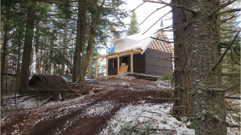

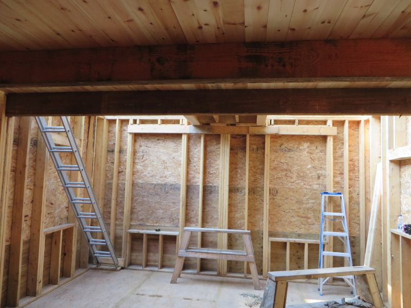

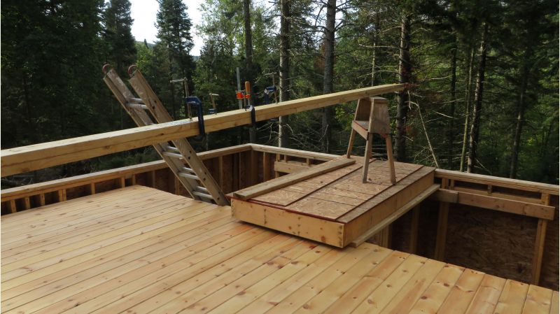

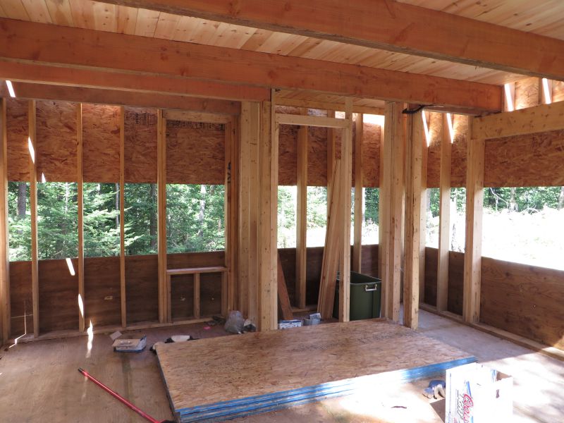

To quickly summarize, 2013 was very busy ... working mostly weekends as time permitted. Was able to get the loft up, a dormer added in to provide more loft space, and a porch. I'm pleased with the progress all in all but, wow, it takes time!
I'm at the point of putting side walls on the dormer after which I'll do my tin/or shingle roof (the snow interfered w/my plans to get roof complete). Would prefer tin, but am not 100% about it as I have no exp but have done lots of shingles...and really need to get this done!
Anyways just waiting on the last foot or so of snow to melt, hopeful to get started in a week or so. Few pics ...
interior
interior
ridge beam
ridge beam

cabin
cabin

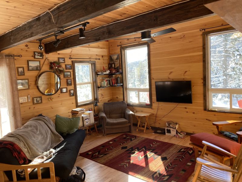

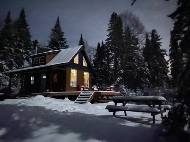

It’s been a long time since I logged into the site and thought I better post few pics of final build for posterity. Hopefully may inspire someone or provide some ideas as I know for me I couldn’t have done without the knowledge I found here.. I’m planning a small kitchen extension in Spring so you may see me around a bit more..
WeekEndHack
# Posted: 19 Jan 2021 12:21am
Pics
Interior
Interior

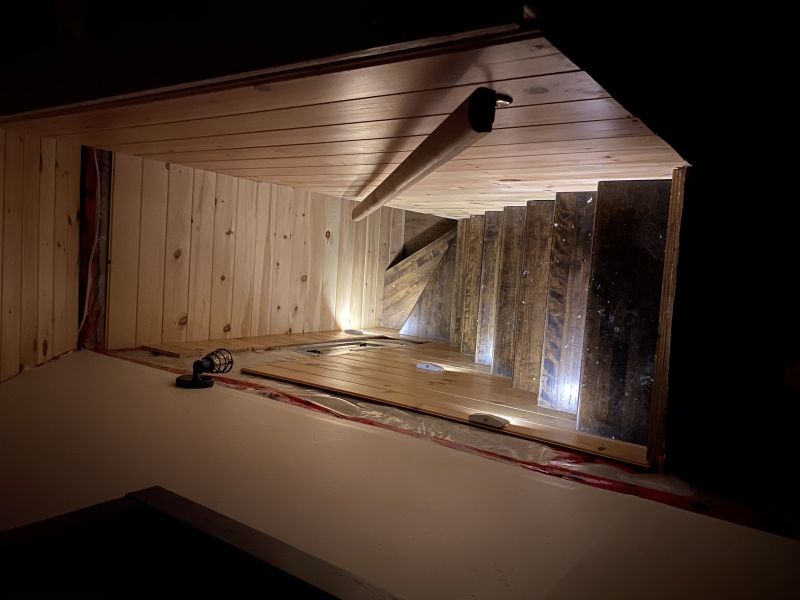

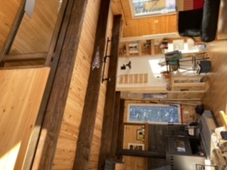

I went with corner wrap around stairs as they seemed most functional/easy and took up least space. Didn’t wanna climb a ladder. In the loft I have a dormer along one side where I installed the bed, kind of galley style. Loft is 12x16, cabin is 16x20. I wanted that high ceiling cathedral look to make place feel bigger. Put in glass railing to further open it up. Put cubboards around the dead space on gable side opposite bed, still need to finish..don’t have any shots of loft on new phone but will take some next weekend and post
Stairwell
Stairwell
Bar area, corner stairs behind

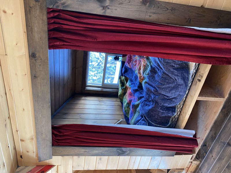

# Posted: 6 Mar 2021 09:39am
Few more pics
Loft
Loft
BlazeKing
BlazeKing
Loft  bed
Loft bed
