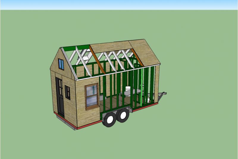

 | # Posted: 15 Oct 2012 01:41pm Reply
 GomerPile, I was wondering if I might be able to come and check out your XS house maybe in the next couple of weeks. Making a little progress on the design (photo attached), I have the house mostly framed out just missing the loft. My e-mail address is andersongpage@gmail.com if that might work out
