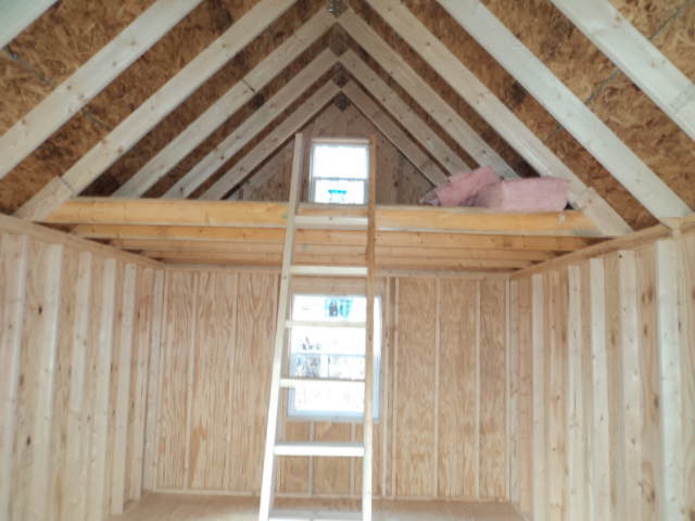

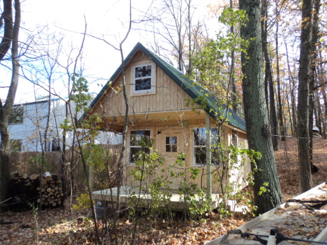

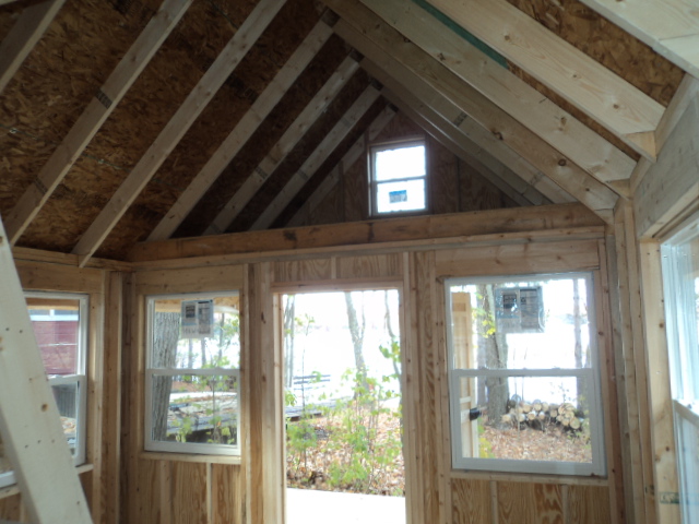

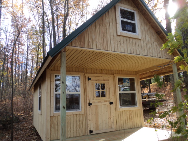

 This is now the third one I've built like this this year. It's just little. Inside is only 12' x 18' then a six foot covered porch, lft on each end. It's on 6x8 treated skids, leveled with cement block. Menards windows and a steel roof. Trego WI.

 I got ten thousand for it. Yes, I can build up to 16' x 30' on treated skids, then I need frost posts, unless the ground has bedrock close to the surface. It took four days with my daughter to help. It's hard to build too far away. This one was 75 miles from Duluth and the fuel money adds up. I should keep it under 100 from home.
