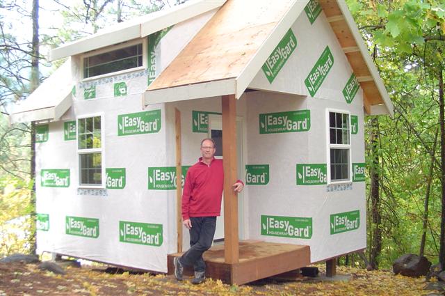

Had decided to build a cabin for occasional use in washington state. After checking with county for permits, I found that a legal survey and permit would be required for anything over 200 sq. feet. As I had only planned on a small cabin, I decided on a 12x16 which put me under the 200 sq. foot requirement and saved the cost of a permit and survey. That alone saved me around $3000.00. I knew where the lot lines were from the next door neighbors surveys (not recorded) and from measurments I had made from corner stakes. So far construction has been about $2600.00 which includes 2x6 framing, steel door, new and salvaged vinyl windows, wall sheeting(osb) and roof sheeting(1/2" ply). Hoping to be under $5000 total.
ready for roofing
ready for roofing

Nice cabin, interesting design.
Thanks for sharing.
Do you have/planning to have a loft inside the cabin?
I assume you will do some sort of siding...

Impressive design. A covered porch is a must in the northwest and the shed dormer adds character as well as light. Please keep posting pics.

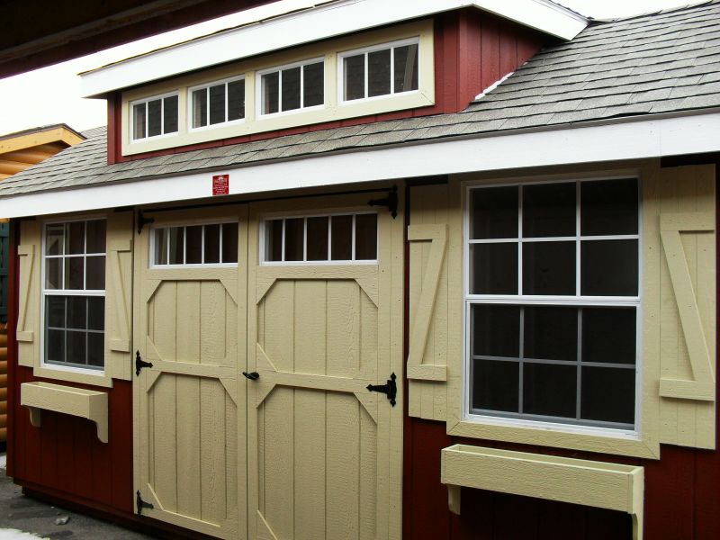

WOW nice going fish! I was looking at a similar Mennonite built shed yesterday - the dormer adds great roof height inside - and if you're lofting whoever's sleeping up there has a window view. Not to mention better lighting.
Shed with Dormer
Shed with Dormer

any progress on your cabin?? do you have a floorplan drawing or dimension sketch?? looks larger than 200s.f. which is why i ask and also do you plan a loft?? great design.

I wish bigfish would come back and tell us more about his cabin! I really like the design...

I really like the design too.
Somehow missed seeing this one.
Just the floor plan would be great.
Interior pix would be oustanding
Quoting: cbc58
Unless bigfish is taller than (say) 7 ft, it appears within 200 sf to me.
Wish you'd update us bigfish.
