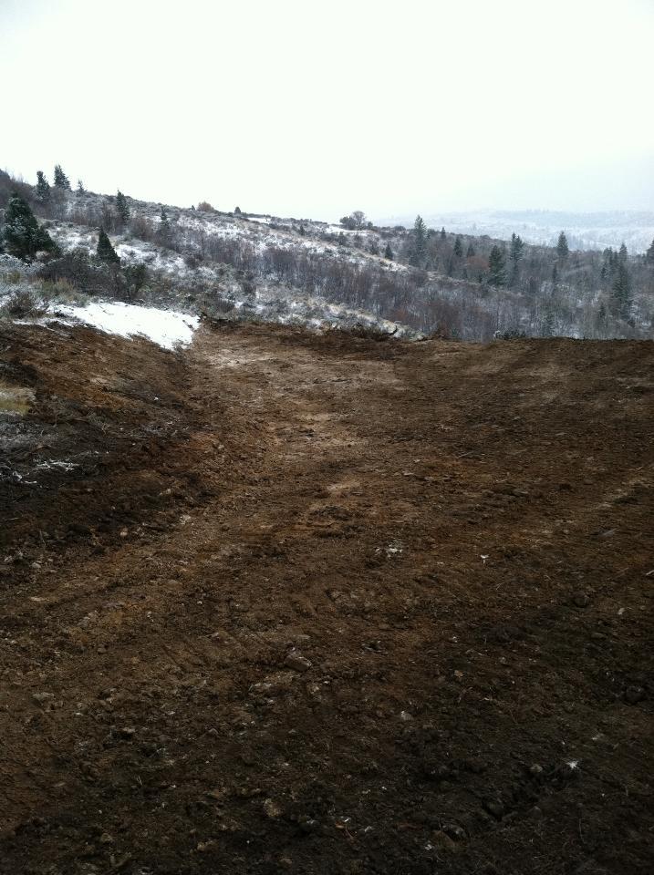

after bulldozer

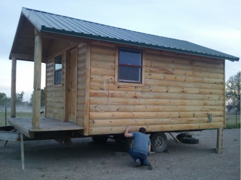

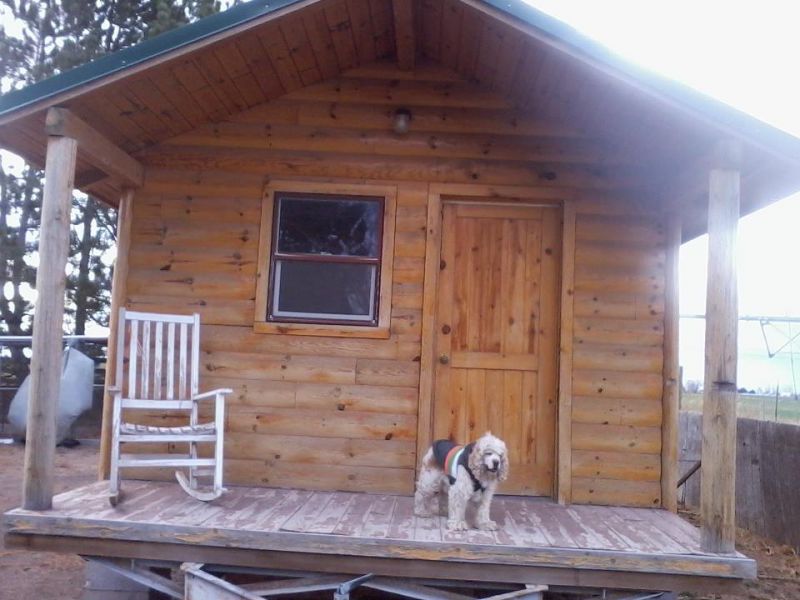

I wanted to build my own cabin but found this one allready built on a mobile home chassis

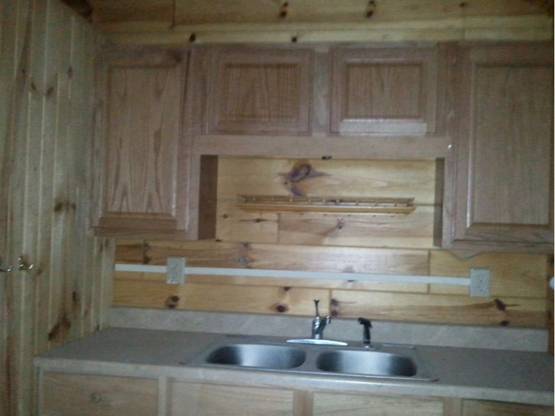

# Posted: 15 Nov 2012 12:28am

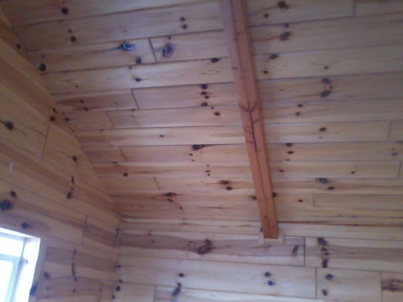

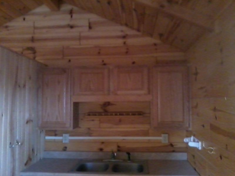

inside view of cabin on wheels

Mike, those are called "Park Models" and are tax exempt. They are considered RV's or was that one a home built Park Model? Either way, if its on a rolling chassis and has a title, you may be tax exempt. In my state, we have a timber tax or tax exemptions on land,. I almost went that route. If I did, my cabin on my 20 acres would cost me $32 a yr in taxes.

purchased park model cabin as it was good deal compared to building it myself and can remodel inside to better fit my needs.planning on getting a composting toilet like the natures head model, has anyone out there had any experience with them?

here is the cabin waiting for spring

I need some help on refinishing log siding as the sealer is starting to peel in spots(varnish?) I really do not want to strip entire finish but rather touch up yearly

The original owner or Mnaufacturer should tell you what finish was applied to the outsede walls. then it just a matter of patching. The manufacturer may even have maintenance instructions availalble. that is where I would start.

I cant find any info on original builder but it has a shiny finish that is starting to peel in places so i am thinking it is just a varnish finish

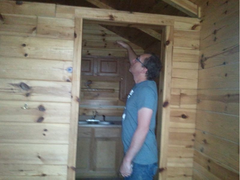

Hi and welcome to the forum. Ours is 12X16 with a bumpout of 8X16 which we use as a bunkroom. Your cabin looks a lot bigger inside than ours. What is the purpose of the wall in front of the kitchen?

# Posted: 22 Nov 2012 01:35pm
I plan on taking the wall out and putting in a loft. The wall divides the bed room/greatroom from the bathroom but I will take out wall and bathroom and install composting toilet in space by shower. I have a woodstove/parlor stove but not sure I will need it maybe just a big buddy heater?

It probably is varnish, but maybe shellac. Pick a small spot and lightly sand the surface and paint a little varnish over it. I would check out a woodworking forum to find out how to treat an unknown surface. I figure without seeing it you will have to sand the bare spot and feather back into the good finish. Then paint all of the prepared surfaces, with whatever surface coating you find it is to blend the old and new together again.
