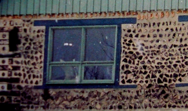

If you are not familiar with stack wall construction, split logs about 2 feet in length are mortared into a wall so the butt ends stick out both on the outside and the inside. Makes for a very interesting wall inside and out and very deep window sills just like a castle that a person can curl up in, read a book with a beverage of choice and drift away to sleep.

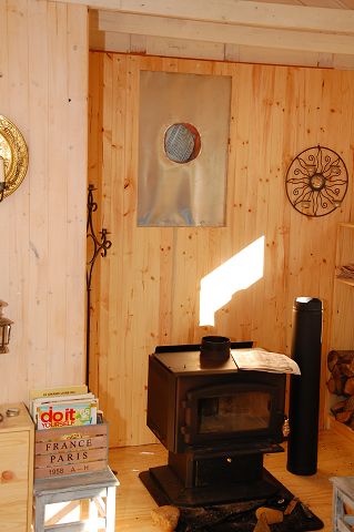

We decided it was time to replace the chimney stack because we know its not done right and its looking in bad shape and so its been sorta worrysome and lately we were getting lots of smoke in the cabin when the fireplace door was open. We decided to do it right and replace the single-wall stuff outdoors with the correct double-wall insulated stuff.
R took down the outdoor pipping and to our horror the elbow section was 2/3 full of ash. No freaking wonder we got smoke! We will have to replace pretty much everything, as we can't re-use the "through the wall" pipe because it doesn't match up with the new piping. We are going to buy a kit at the hardware store that sells for about $300 which includes all the necessary parts (through the wall pipe, T connector, brackets, cap) except for the actual outdoor chimney pipes, which you buy separately according to the length you need. It is not going to be cheap but if you're gonna do it you might as well do it right, plus the new pipes are nice and shiny! R is optimistic that this can be done in a day. I hope so, winter is coming, and there is already snow on the ground at the cabin.
If anyone has to do this job the company the makes the piples often puts out good information and diagrams along with its product, and the kit is a good option as well because you don't have to buy everything separately, and if you add up the cost of all the parts its more advantageous to buy the kit.

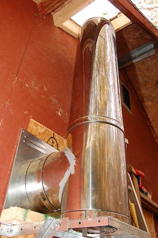

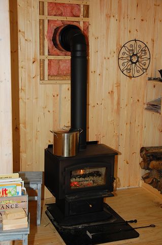

# Posted: 8 Nov 2010 11:10
Good Day fellow cabiners.
R successfully replaced the chimney stack. As I mentioned before, to our horror the old one was not the appropriate material and was full of soot. We bought the appropriate outdoor chimney pipes at a local large-surface hardware store. We started wit the "kit" for a through-the-wall installation which included the part that goes through the wall, the outside elbow with the bottom cleanout feature, brackets, and a roof cap, and then bought sufficient lengths of pipe to go up past the peak of the roof and the proper skirting that goes around the piple on the roof.
These insulated pipes are designed to fit close to the outside wall. We were fortunate that there was just enough space on the eave of the roof to allow the pipe to fit through, otherwise extra framing would have been necessary.
We were really fortunate in that we found mature knowledgeable person at the hardware store to get good advice. R explained the old setup to him and he just shook his head in disapproval.
These materials are not inexpensive, but they should last forever, and I strongly recommend using the right stuff for safety and longevity. Kits are the most cost-effective way to get the required parts if they are available to you.
We made our first fire with this new pipe and were amazed at the better draw up the chimney. No more smoke issues. It's also nice to know everything is clean and works the way it should and will not have to be redone in our lifetime.
starting point, take down the old stuff
build framing inside the wall to secure "through the wall" pipe
start stacking the lengths

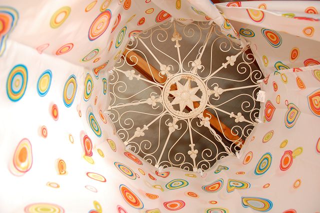

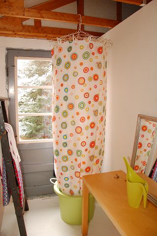

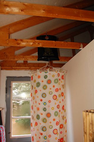

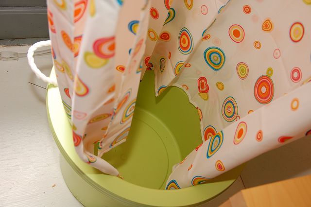

Hi again, I thought I should share our new indoor shower set up. I am really happy with how it is working. Instead of using an upside down umbrella I found a decorative wall plate at Homesense for $19.99. It is about 20 to 24 inches accross, and is much sturdier. You can find them in decor stores, Just get one that is at least as large as your shoulders, or whatever other widest part of your body, and attach 3 separate chains (I counted 12 links each) at 3 equi-distaint points onto the ring, with the other end of the chains attached to a centre link, and then hang from the centre link on a beam or to the ceiling by way of a hook. The shower curtain attaches to it with just regular shower curtain hooks or loops. Make sure it is at the right height to allow the curtain to be at least a few inches into utility big. The large utility bin is widely available in hardware stores and garden centres.
The camp shower bag is hung up high and works like a charm. Also found some cheeful shower curtains for $5.99 at a dollar store. You will need two shower curtains because one is not enough to go all the way around, and you want some overlap at the opening to keep the water in. I used material shower curtains made of polyester because I don't like the smell of vinyl and it gets damaged in the cold. Also, the material curtains can be laundered. Metail chain is also required. I got white chain.
this is how it works: At my first opportunity getting to the cabin I fill a big pot with stream water and sit it on the woodstove for a supply of hot water. The water usually reaches boiling point. I fetch a pail of cold water at the stream, and fill half the bag with cold and half with hot to get a comfortable temperature. Climb up and hang the bag from a sturdy hook from hardware store that attaches with two screws right into the 2x4. get into the stall and enjoy a hot shower. When done, empty the water manually outdoors and rinse. There is enough water in that bag for 2 to 3 people to shower. I bought soap bars at the drug store that are 100% vegetable based. One bar is actually shampoo.
It is not perfect, it is a tight fit in there, but considering you can have a refreshing shower without any plumbing I think its pretty darn outstanding.
supplies:
metal chain: $5.00
studry hook: $1.69
round metal decorative piece: $20.00
plastic bin: $10.00
Shower curtains: 6.00 each= $12.00
Shower curtain hooks: $1.00
shower bag: about $10.00
Total cost: appr. $60.00
shower, full view.
shower, full view.
metal wall decoration. $19.99

plastic bin
plastic bin
shower bag up high
shower bag up high

We learned something else about the chimney install: heat resistant caulking comes in different colours, but any Red caulking is always the heat resistant kind. So when you caulk the seams outside on the chimney stack you should use the red coloured heat-resistant caulking if your chimney is going to be inspected, since inspectors know right away that it is the heat resistant kind. That's IF you ever do get it inspected, so if there is such a chance, use the red stuff.
# Posted: 15 Nov 2010 20:27
Quoting: RnR
