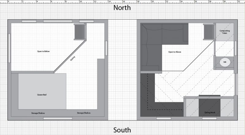

So this is kind of a brain dump. I have been designing tiny cabins for my own amusement for the last two years, ever since I start to believe that another great depression was inevitable and I felt that I didn't want to have to move back in with my parents or in-laws when the SHTF. What am I to do if I live in an apartment? Why, buy a tiny piece of land and build a tiny cabin!
I'm mostly in the planning stages of situation, as I have not purchased the land. I have found what I want, I'm just saving up the money for it. I don't want a bank loan, so the seller will do financial with $1500 down on 3 acres for $5000. The reason this land is so cheap is because it isn't technically "build-able" (100ftx1400ft, strange size) but I can do under 200 sq ft in my state without a permit, so I'm hoping to avoid any paperwork. I really just don't want to do anything on the property that requires local government involvement, so it will be totally off-grid.
So, I have been designing with that 200 sq ft in mind with a 14'x14' cabin design. I've also been thinking about needing to house other members of my family in a BOL scenario, so I've also created designs that have alternate floor plans for different residents.
Since I'm thinking that I may have to house a contingent of family members, I'm toying with the idea of building a sort of "family camp" set up. Mini Cabins for family groups, with a dining hall, kitchen and bath house as separate buildings as to avoid building codes.
Each cabin will have its own composting toilet inside, but the bath house will be for bathing to save on space in individual cabins. If time and money run out before SHTF, the composting toilets in each cabin might need to be reduced to a portable set up that can be dumped into an outhouse. I plan to have a couple of outhouses too, not a septic system, but these wouldn't be in use at all unless totally necessary, as in the case of a total financial or societal collapse where I needed to house and care for lots of family and friends. In that instance, regulations be damned! But until then, no one wants to use an outhouse.
To start, I hope to purchase my land before year's end, and then start purchasing and storing all of the various tools and building supplies I will need to make an individual cabin for my husband and I, plus the bath house and a storage cabin that can be converted into another individual cabin when the need arises. I want all of the cabins to be of the same general design so it is easier and easier to build the more I make.

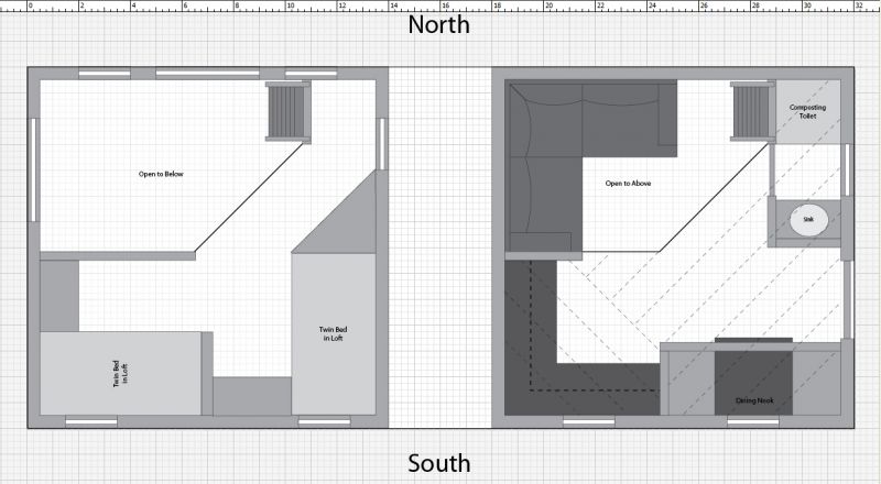

Attached here is the couple's cabin design and the singles. Each includes a dining nook, mini built-in couch with storage, small kitchen/storage area, half bathroom and sleeping loft. I'm also working on a design for my parents and in-laws that eliminates the couch and replaces with a bed so no need to climb the ladder. Most of the storage will be built-in, so I can get the maximum space without actual furniture.
Each cabin can accommodate two singles or a couple comfortably (I think) and more could be added, but they would feel crowded. But if it is the only safe place you have, can you really complain? Couple's Cabin
|  Single's Cabin

Hi Renee and welcome to the forum. Back to the cabin.....I would consider a 12:12 pitch roof so that you can utilize a loft with as much headroom as possible. I don't believe you need to count the square footage of the loft since most of the space isn't livable. You might check that out but the loft leaves a lot of storage space to store "stuff."
I'm anxious to see some photos of your "startup." Old Buddy and I have put a ton of pics on our thread because I like going back about three years to when we first started going to the property. Building this small cabin has been one of the most enjoyable things I have ever done. I have a feeling of complete tranquility while I'm there, whether I'm working or just "laying around." We have talked to a LOT OF FINE PEOPLE ON HERE! Stick around......I think you'll enjoy it

I'm actually wanting to do a lean-to roof, oriented for solar panels, so the window on the north of the loft can be long. More sunlight, but not direct light to the loft. I'm designing the cabins oriented according to the lay of the land and sun. The road runs on the East border, so the doors is there. Small windows on the south for dining and cooking, while minimizing glare in the living area. I'm also thinking of protection, thus the big windows are high up with no line of sight to living quarters and the smaller windows at ground level will be too small to crawl through if broken into.
If you are familiar with the book "Compact Cabins" by Gerald Rowan, the profile will be similar to the Endless Mountains Micro Cabin on page 16.

I have the book you mentioned and have enjoyed looking through all the designs. Thank you for posting your plans. I really like the angle on the loft edge in your design. It adds a little bit of technical difficulty, but has a great impact on the overall design. I am sure your plan will take a future cabin builder in a direction they had not thought of before. You have designed an excellent use of space and I will enjoy watching your plan come to reality in the months ahead. Thanks for posting.
