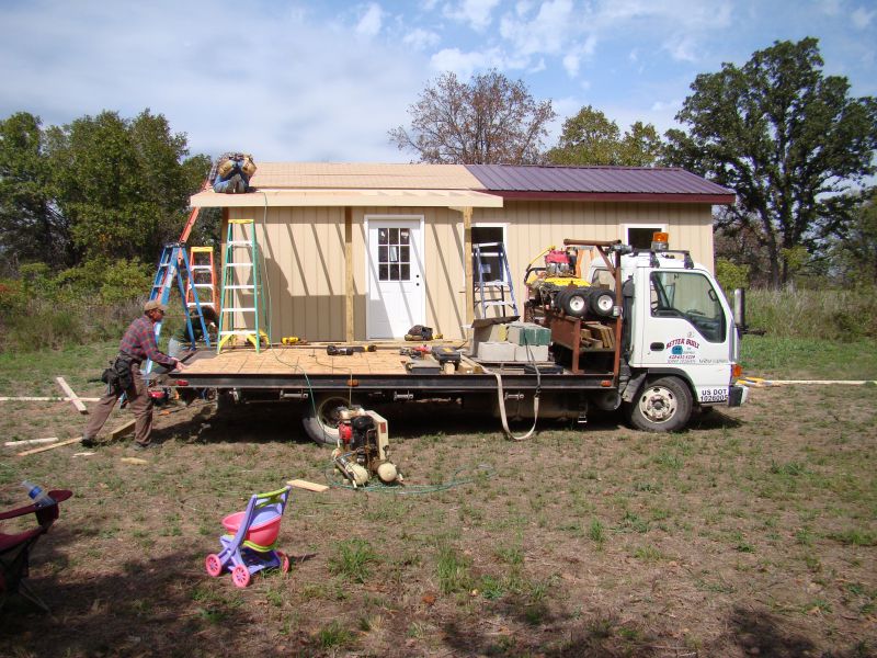

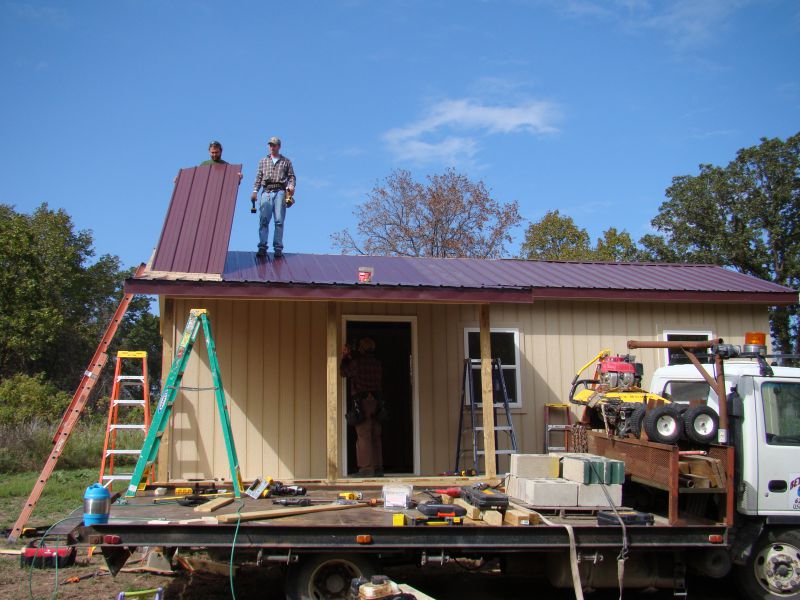

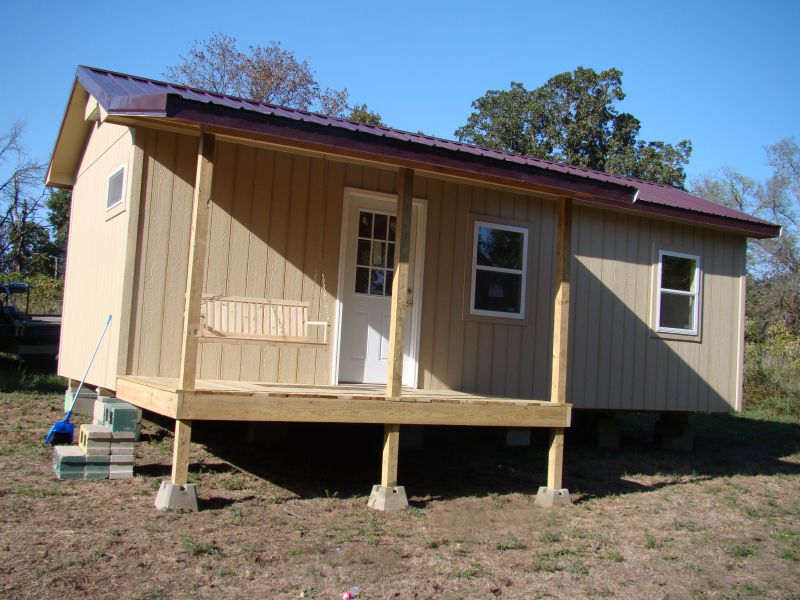

well we finally have our cabin in after having the property for three years. I had planned on building it myself for the last two years but trying to find the time and manpower to do it quickly to limit exposure to weather just never seemed to be available, so much to my wifes encouragement (tired of me delaying) We hired out the construction of the shell so we can finish it at our own pace. Glad I did the labor spent was worth it to have something in place now. I would pass on you can have a nice cabin from a prebuilt cabin/shed if you find a company that will work with you to build it the way you want not cutting any corners after all you are the customer you should not have to settle. Other than the satisfaction of building it all yourself it turned out to be a great option for anyone living a distance from your property or not having the time. I'll post more as we work to finish it. Thanks for the many ideas I picked up from here 639.JPG

Looks nice...hows it attached to the ground??

Sustainusfarm below the 2x6 floor joist frame there are 3 4x6 skids which are set on pier blocks made from cinder blocks. I saw where people were digging footings, but we don't have great frost heave here and the soil is pretty rocky. We just leveled the first cinder block of the pier shimmed the skids at each pier. It has been in place about 4 months can't see any settling yet. We can shim the skids as needed is the plan.

The cabin is 12x28 with 7x14 porch hope to keep it under 8k by finishing all of the inside myself. The biggest single expense was the metal roof almost 1000, but longterm i think it will pay for itself

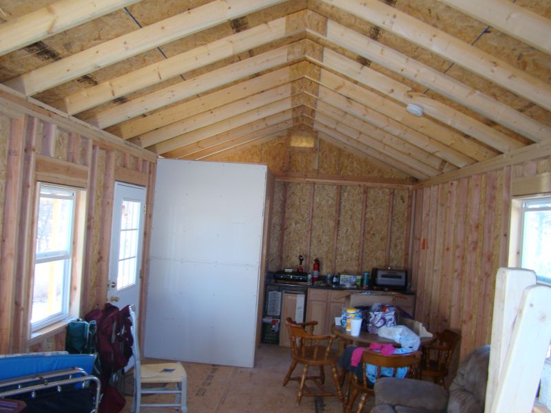

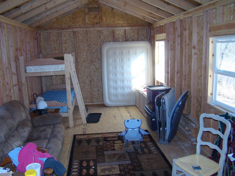

the cabin is starting to take shape, it is nice to get some pieces in to see the full scale instead of on paper. It is a 12x28. It will have a double bed accross from the bunks. It is very addicting, spend one day there then start planning when we can return. Hopefully we can pick up some speed when the weather warms more consistant in a couple of months

Love that front porch swing!
