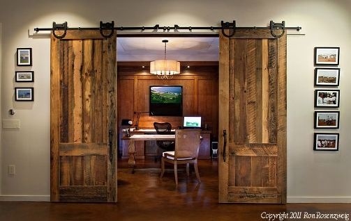

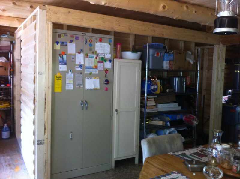

# Posted: 13 Jan 2013 07:58pm
Very nice wood! How are you hanging the door?
We are adding a sliding barn door to our pantry this summer(ran out of time last summer). Bought the hanging system at Tractor Supply. It's not fancy. It's the same kit farmers use to hang barn doors. There are some really nice kits Online but they can be expensive.

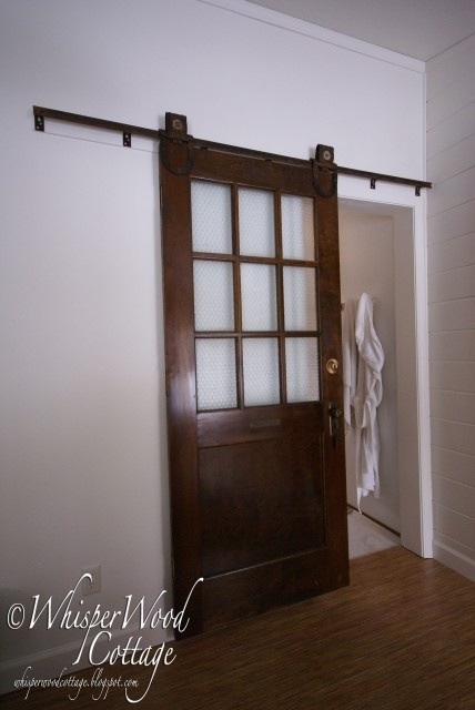

# Posted: 13 Jan 2013 08:04pm
Had to go over to my phone for photos.
Pantry
Pantry
Idea door
Idea door
Like this one for the bathroom
