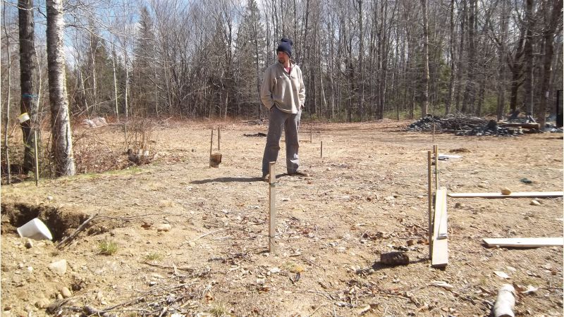

 | # Posted: 21 Apr 2013 08:26pm Reply
 Did the basic layout today. Holy hannah, a lot more complicated than playing with rectangles ...
 |  Pondering a problem - root cellar was too close to the well head for my liking.
