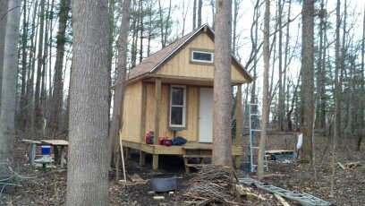

I am just about finished with my cabin project and wanted to share a few pics. I've lurked on this site for awhile now and learned a lot from other's posts. Thank you to those before me who have posted their expierences and projects.
The cabin is 10x20 with a loft over the porch and another across the rear. I built it deep in the woods on my farm. It required carrying everything in by hand, but the work was worth the effort as it is very secluded.

Hi RichD ! Great little cabin !! How much room do you have in the loft ?

The walls are 8' except the front wall, I dropped it down to 7' for more headroom in the front loft. The front loft is 5x10 and the rear is 6x10 and I built it at 7' off the floor.

Good idea dropping the ceiling height !! Can you stand up straight in the lofts ?

I can, but only dead center (I'm 6'01), my kids can move around with no problems. I will be sleeping on the main level and the kids can have the lofts. I'll try to snap a few inside pics this weekend.

What kind of foundation did you use? Looks like wood piers

Yes, 6x6 PT posts, set in concrete. The water table is very high here and the cabin is built about fifty feet from the marsh edge. I wanted to be high enough to not worry about flood tides and avoid moisture under cabin.
