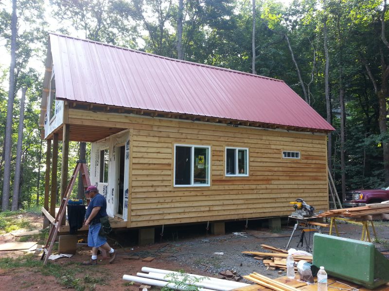

# Posted: 25 Jul 2013 02:08pm

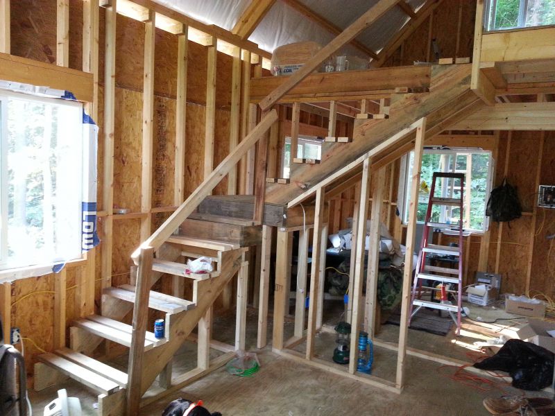

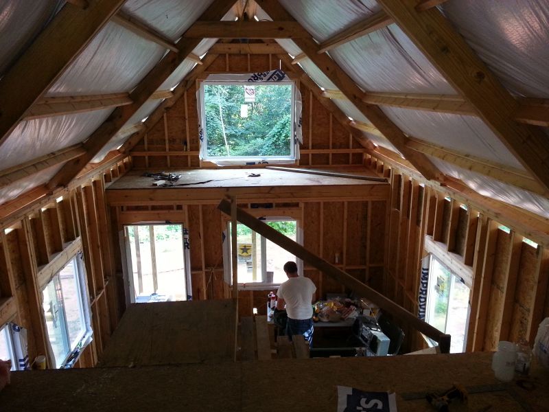

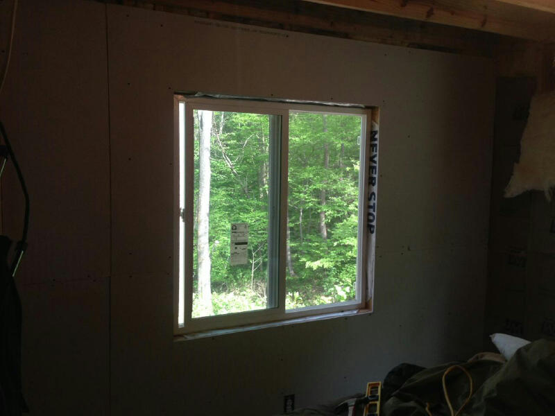

# Posted: 26 Jul 2013 10:24am
|  Pearl is ready to be there.

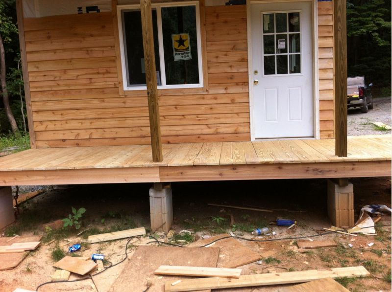

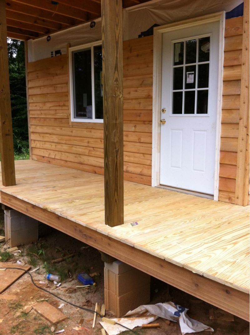

# Posted: 4 Aug 2013 10:01pm
4 AUG 13 Working on front porch. Front Porch AUG 2013
|  Front porch
|  Front porch

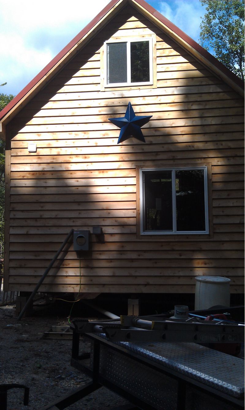

# Posted: 26 Aug 2013 08:12pm

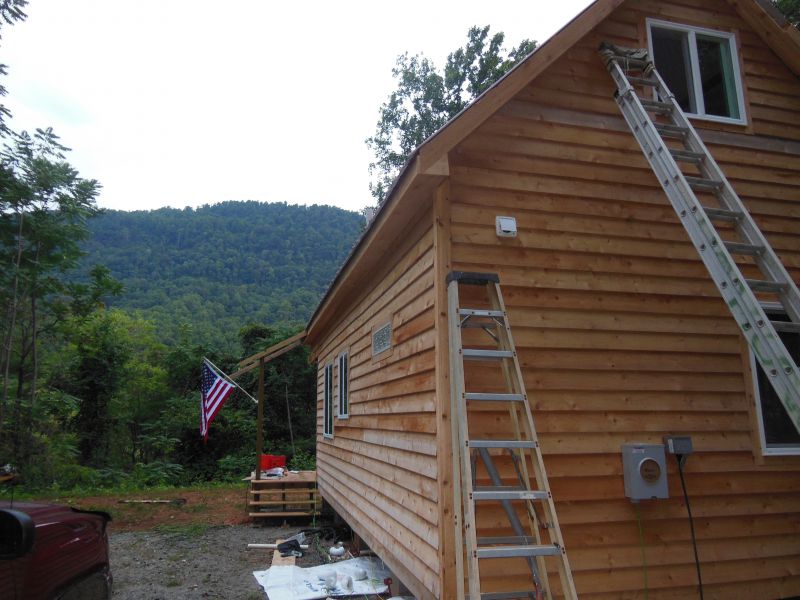

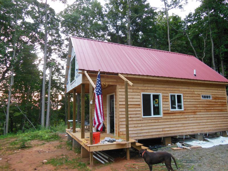

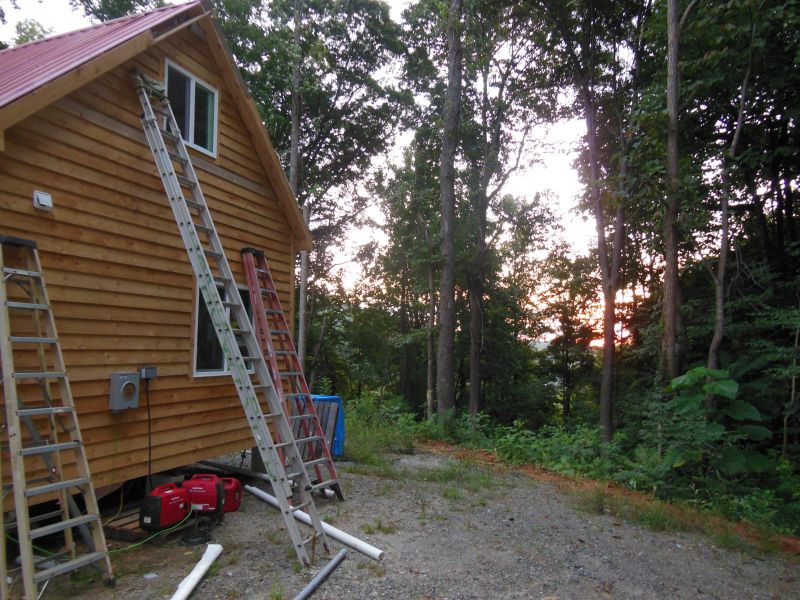

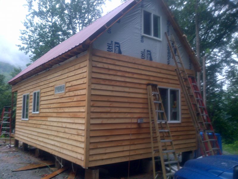

A weekend w/o Rain. 62 in the am and the sun coming up the valley. AUG_2013_1.JPG
# Posted: 26 Aug 2013 08:27pm
Nice work. I really like the siding.

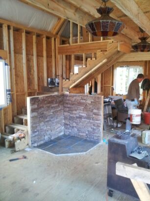

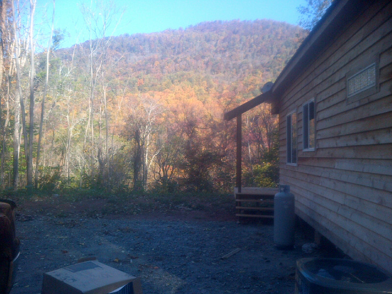

# Posted: 6 Nov 2013 11:44am
1st weekend in NOV, work finished rock fireplace wall and got tile down, leave change was in full swing. It was very hard to come back home. Fireplace.jpg

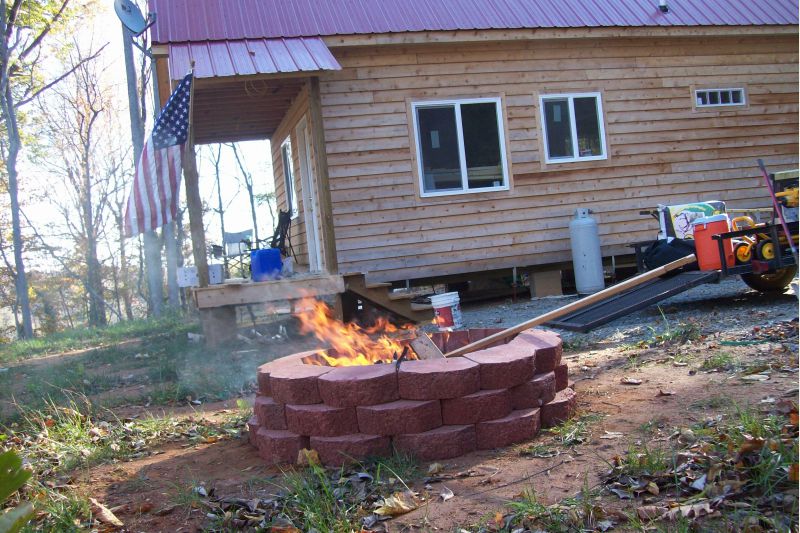

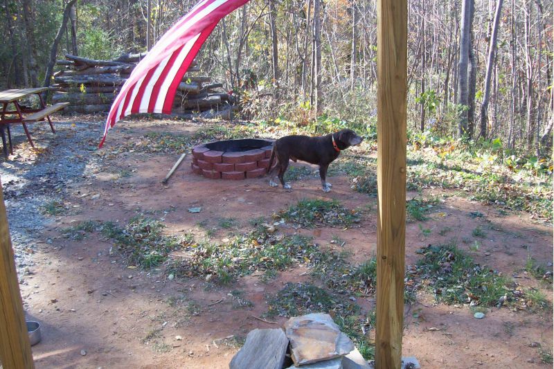

# Posted: 14 Nov 2013 09:18am

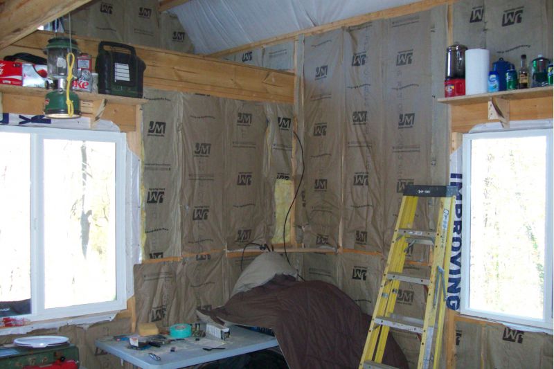

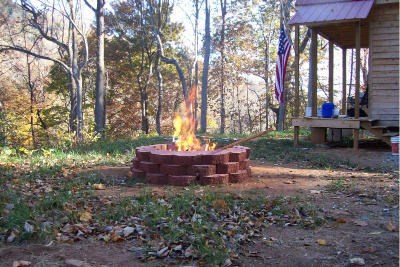

NOV 2013. Had a couple days to spare, Covered drain line, Insulation installed and firepit put in. A small winter blast came through. All we had was a Lil buddy propane heater, temps in the low 20s at night. Which makes it hard to get moving in am. Coffee sure does help. 101_0003.JPG

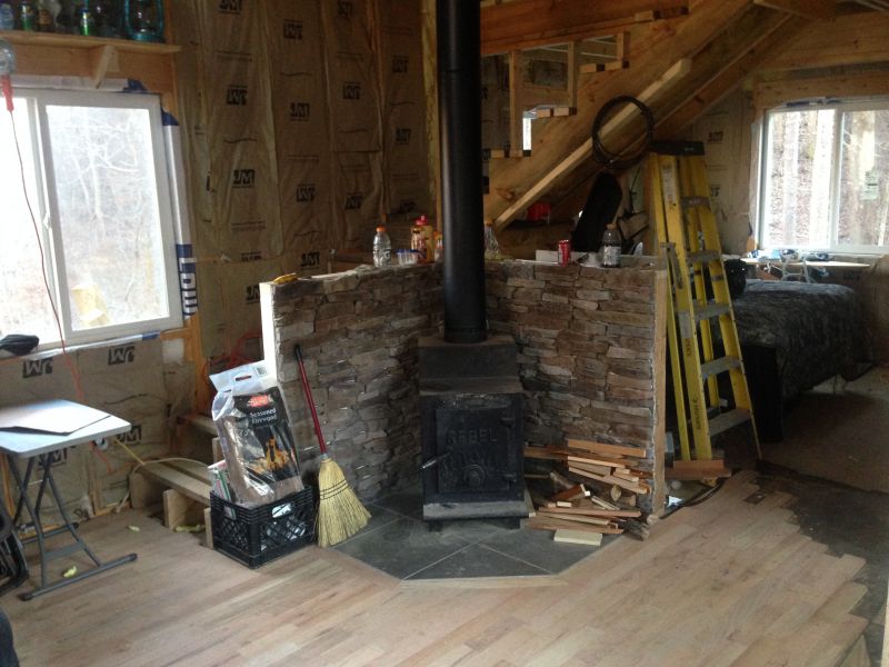

# Posted: 10 Dec 2013 06:33pm

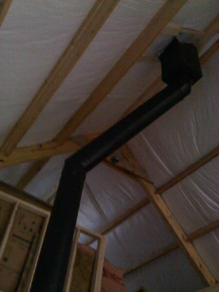

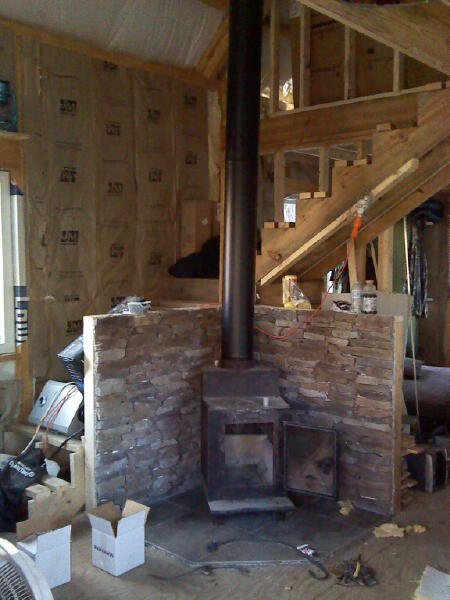

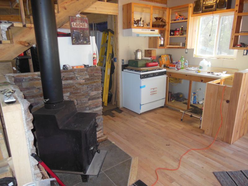

Sarg68
# Posted: 13 Dec 2013 07:28pm
Stove installed is a great feeling isn't it? Now you can also get rid of all your wood scraps and will be motivated to cut in downed trees at your place. Add that you what you already have to do huh? Place looks great, keep the pictures coming. Sarg68

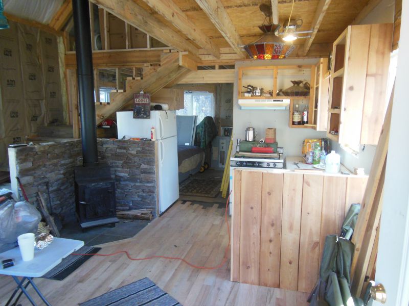

# Posted: 16 Dec 2013 08:54am - Edited by: SFCLYNCH

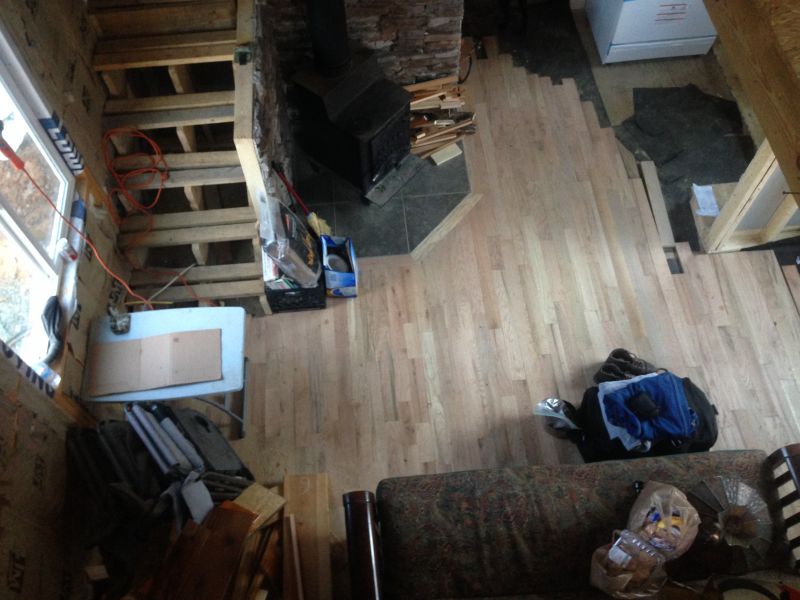

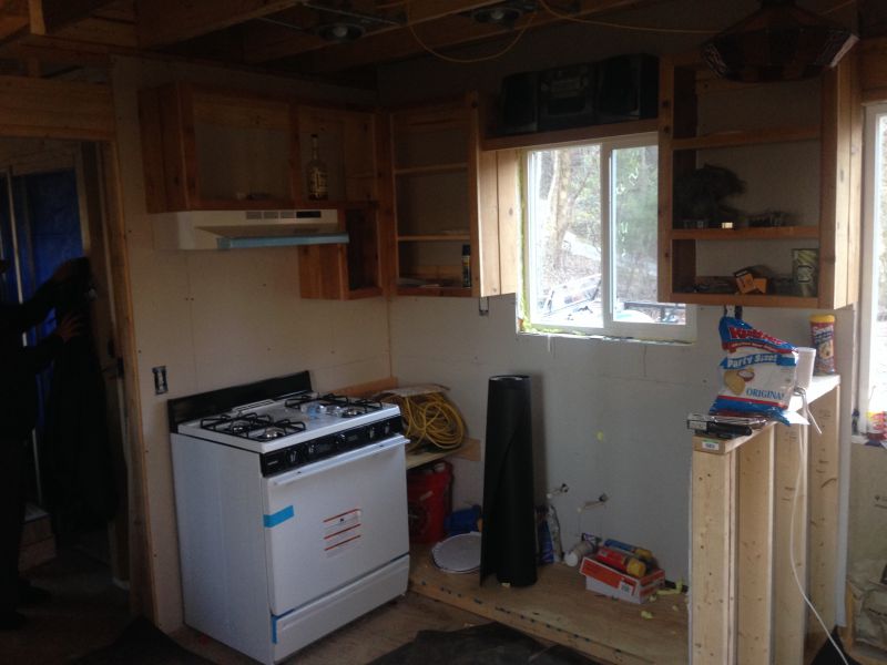

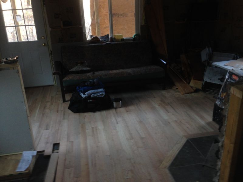

DEC 2013 Started Hardwood floors and kitchen cabinets. The wood stove worked Great with it being in the upper 20s. DEC_2013_Hardwoods_3.jpg

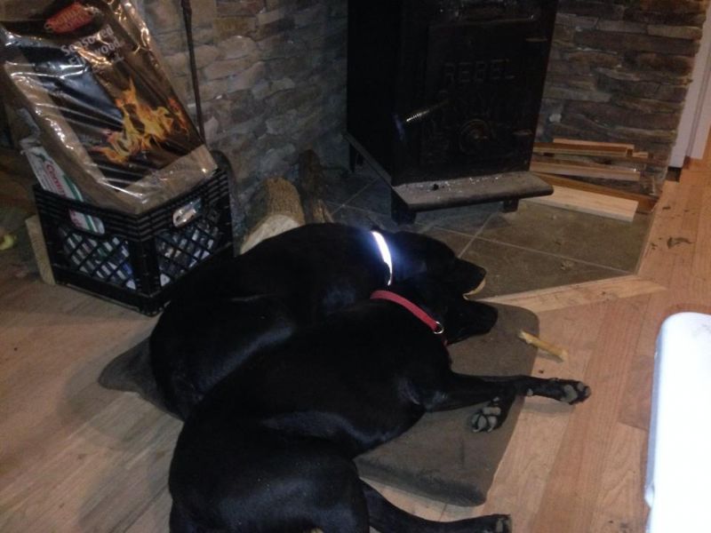

# Posted: 30 Dec 2013 08:12pm

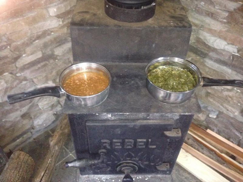

26-27 DEC 2013, Dogs by the woodstove , cut wood, and Ribs on grill w beans and greens on woodstove. Good couple days. 1510519_102011569664.jpg

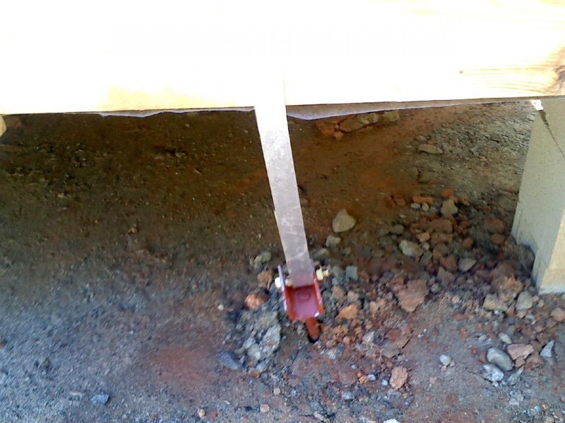

Very nice! Would you explain how you did the foundation? Thanks
SFCLYNCH
# Posted: 31 Dec 2013 08:01pm
On 4x8 skids and straped down with auger screws 36'' down. pilars of concrete blocks, solid 4'' on bottom then (2x) 6'' the toped w 4'' solid buried 6'' for 1st one and Thanks for looking CD.
ChuckDynasty
# Posted: 31 Dec 2013 08:47pm
Ok thanks I see it now. I pretty much know what I want to do except for the foundation and I think this would work very well for me on a smaller structure. Looks like you have 10' walls as well which is what I want. Are the blocks dry stacked and do you have any picks of how you strapped it down, I can't picture that. Nice to see Pearl has a companion to lay with by the stove. Lucky dogs!
SFCLYNCH
# Posted: 31 Dec 2013 09:13pm - Edited by: SFCLYNCH
Straps are nailed 10 ft up cabin and then tightened. Blocks can be dry or rebar and concrete filled also layed like brick ..up to your preference. This was our best bet with the county codes and inspectors. They were very helpful in Polk county NC.

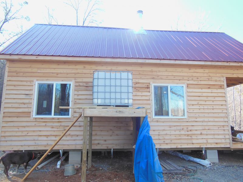

# Posted: 19 Jan 2014 07:33pm

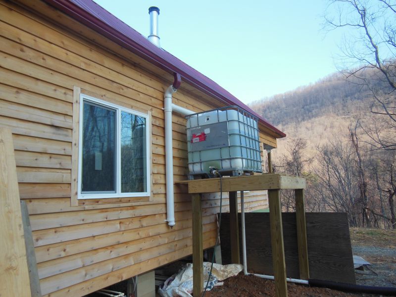

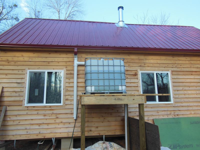

JAN 2014 Floors, Cabinets, and water tower work. Temp in the low teens at night. DSCN0612_JAN_14.JPG
Bret
# Posted: 20 Jan 2014 07:36am
Very interested in your water system. I have the same water tote. I'm in KY. Our weather is about the same. Any thoughts on freezing in the winter? Your cabing looks great. Ours is dried in waiting for warmer weather. Looking forward to your progress. Bret
SFCLYNCH
# Posted: 20 Jan 2014 07:49am
Going to cover in black plastic for non algae growth , and cover with heavy insulation leaving a 8-10'' air pocket on top for ice swell (overflow) if it does freeze it wont bust container. It will be totally enclosed. I have watched a lot of you tube for water harvesting for the ideas. This site had given me all the inspiration / knowledge to do this project. Thanks for looking.

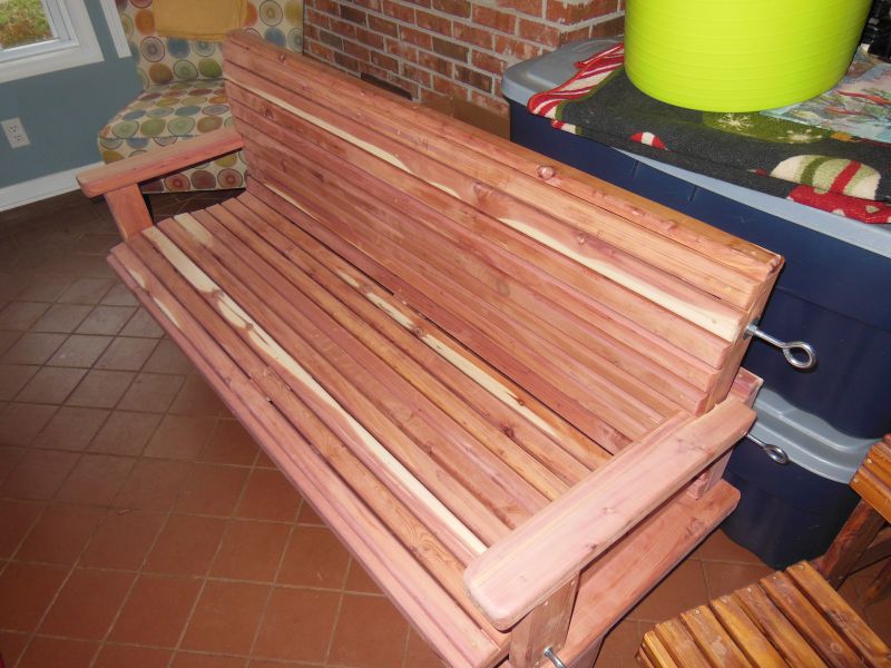

# Posted: 17 Mar 2014 07:26pm
Cedar Swing, Gutters and 1st flush diverter hooked up. 1.5 day of light rain almost filled tank. MAR_2014_6.JPG

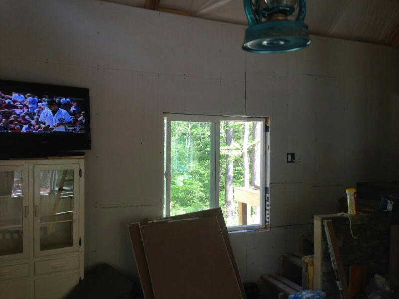

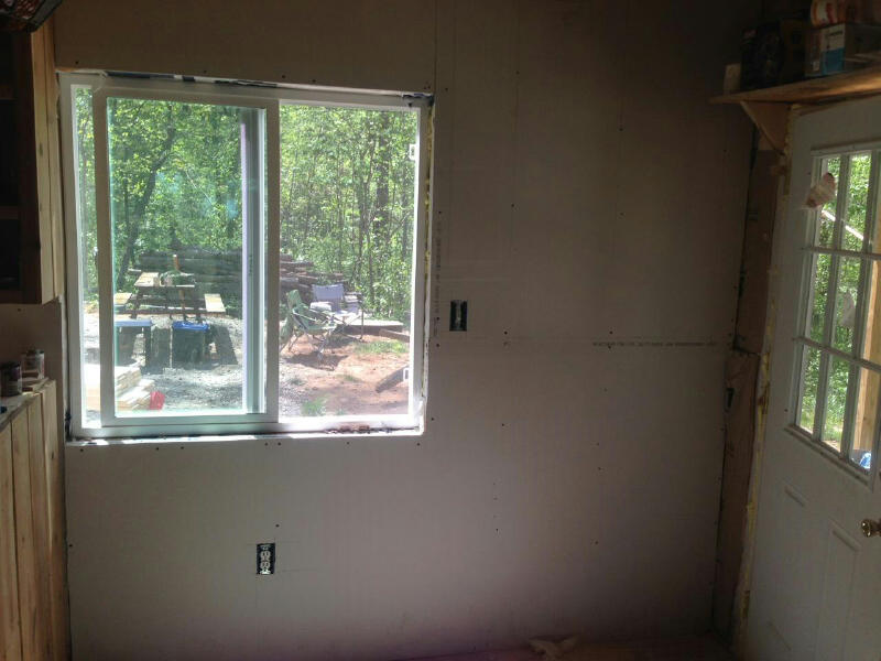

# Posted: 29 Apr 2014 01:08pm

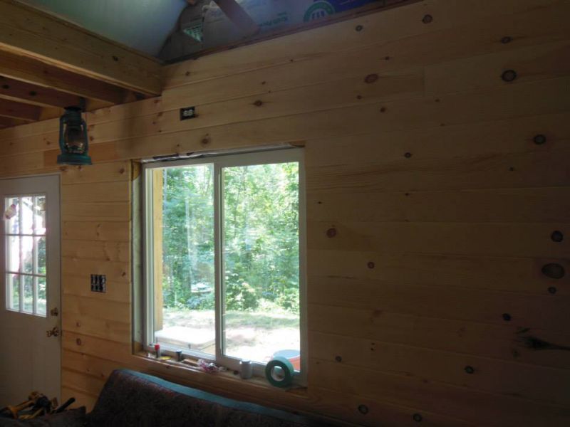

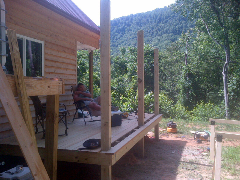

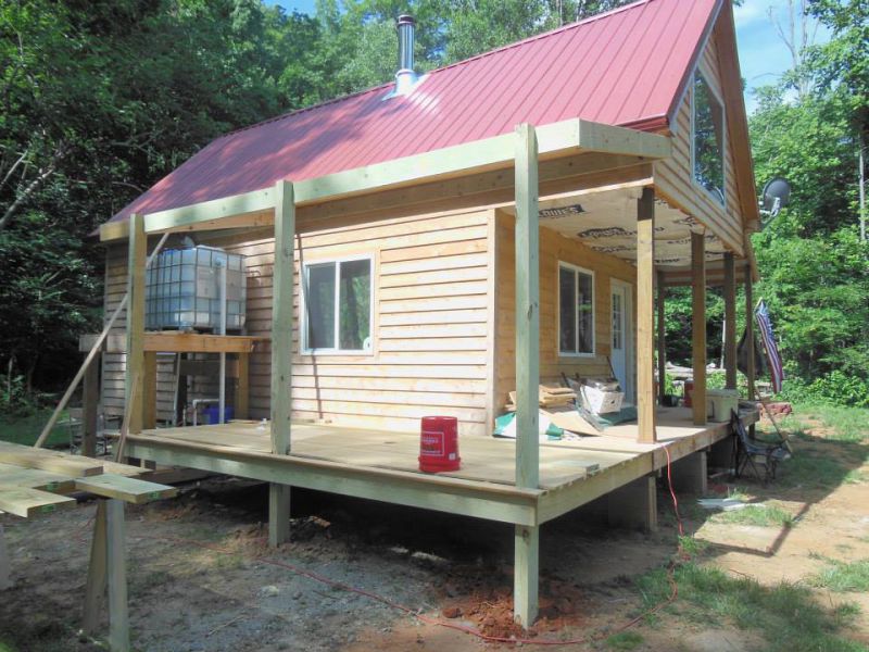

# Posted: 24 Jun 2014 11:59am - Edited by: SFCLYNCH

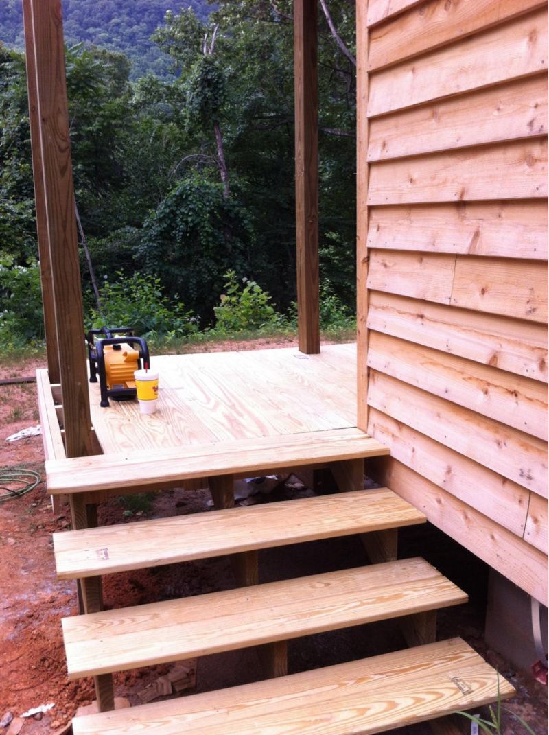

JUN 2014 Deck build. Added a 160 SQ ft. Tin roof next weekend. Its going to be nice with extra shade and to grill outside when bad weather, also listening to rain hitting tin. DECK_JUL_2014.jpg
