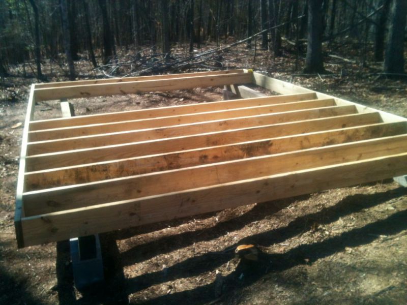

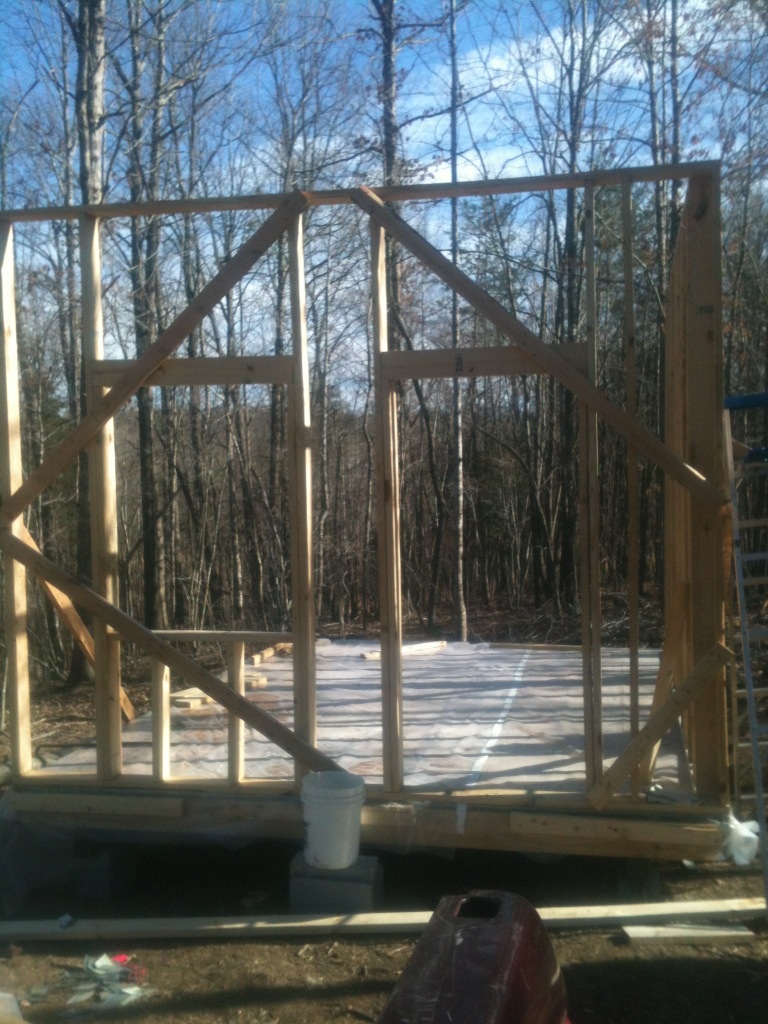

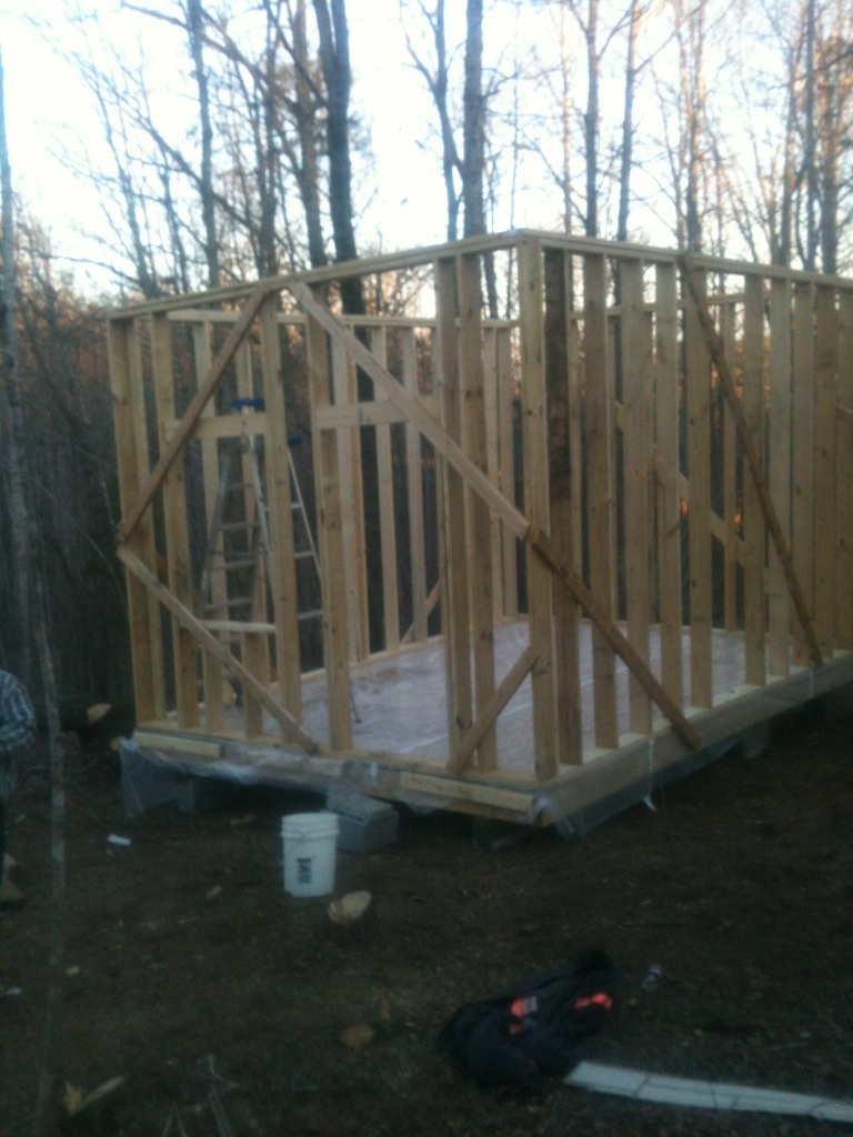

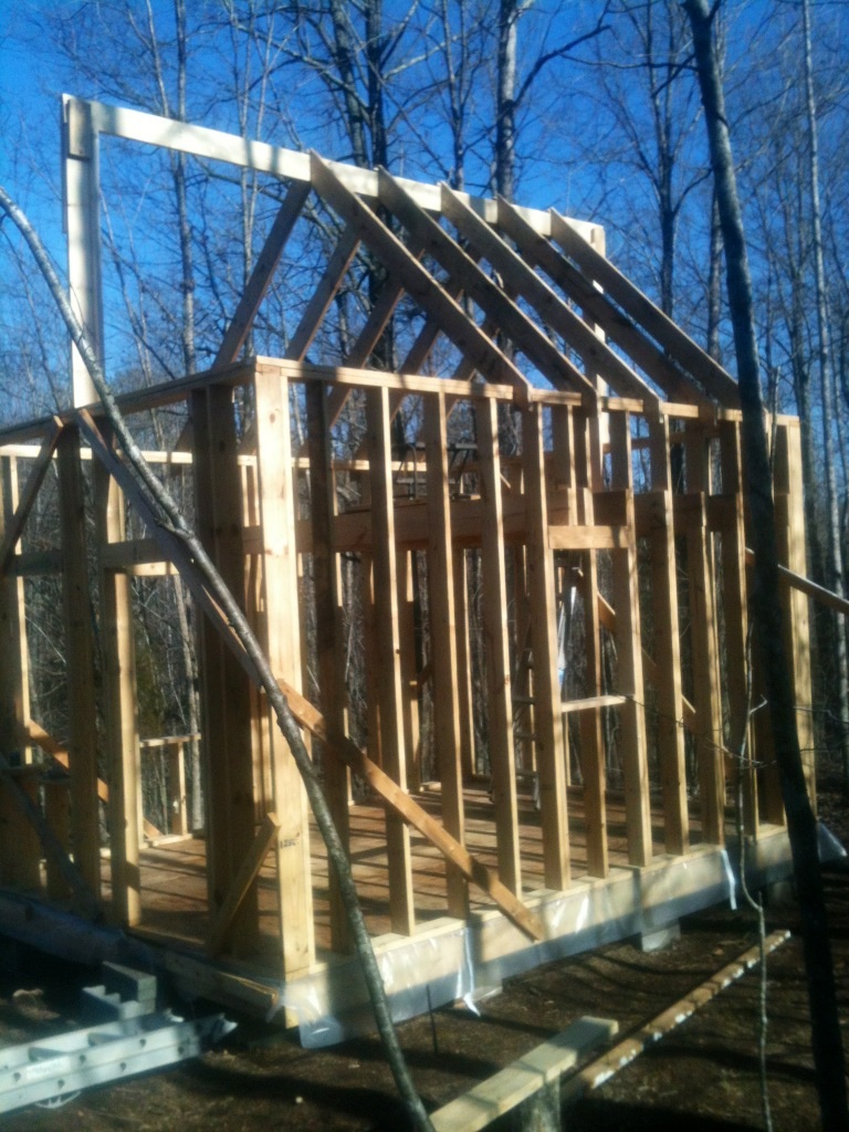

 Just got started on a 12x16 cabin project.I work in the waste disposal industry and wanted to build a cabin using as much salvaged and reclaimed materials as possible.so far the only lumber I have purchased for this project are the 4x6 skids the cabin is built on. The floor is 2x8 joist on 16 inch centers covered n 3/4 osb with a layer of 5/8 ply over that.the walls are 2x6 still need to finish framing windows and installing studs above headers.
| vacabin Member
 | # Posted: 28 Mar 2013 08:29am - Edited by: vacabin Reply
 Wall framing
| trollbridge Member
 | # Posted: 28 Mar 2013 08:42am Reply
 Welcome!

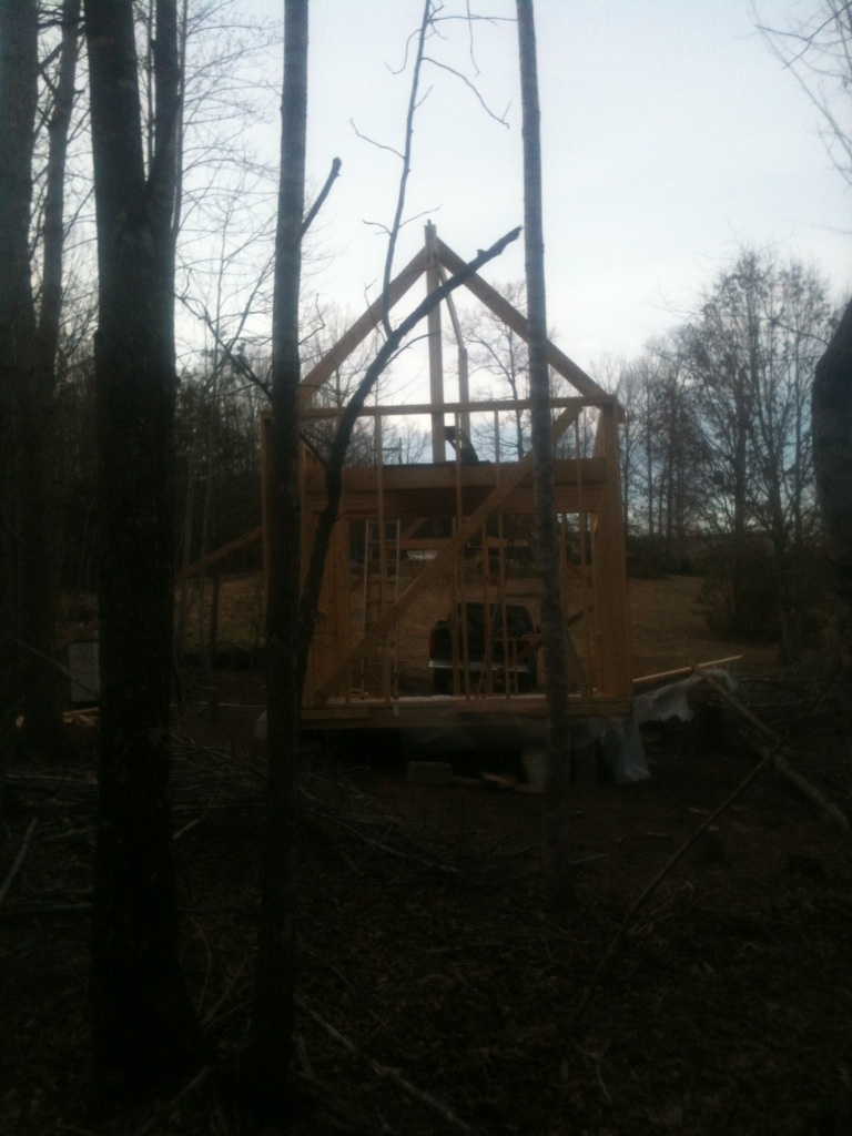

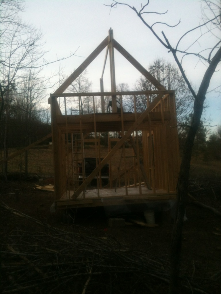

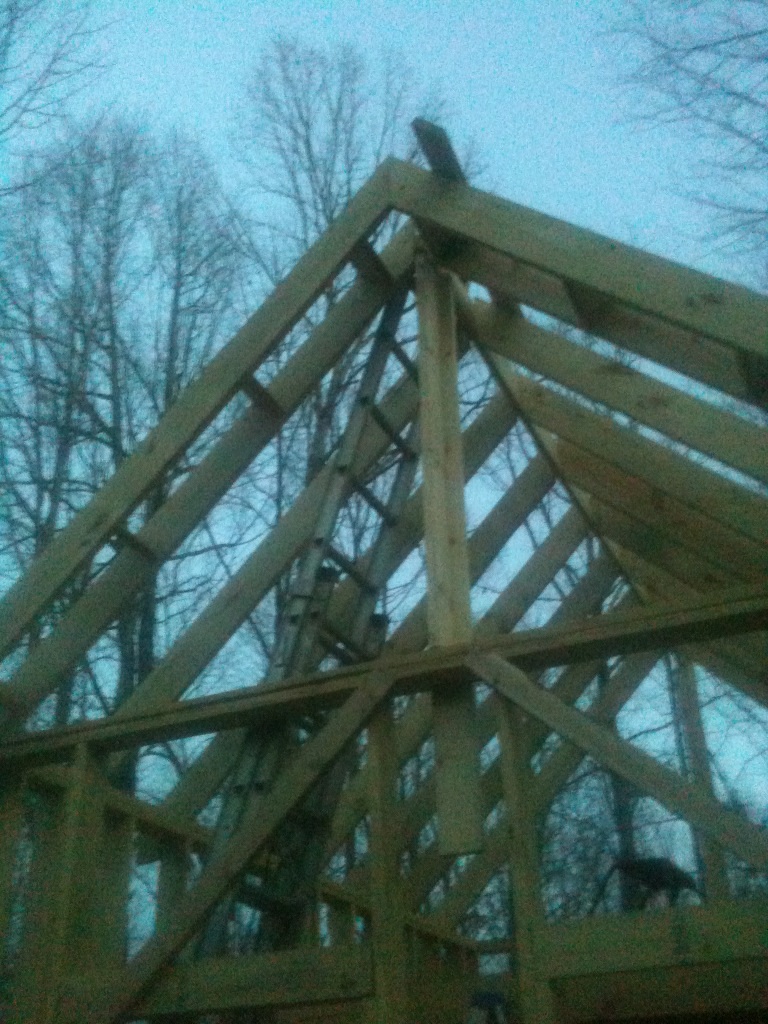

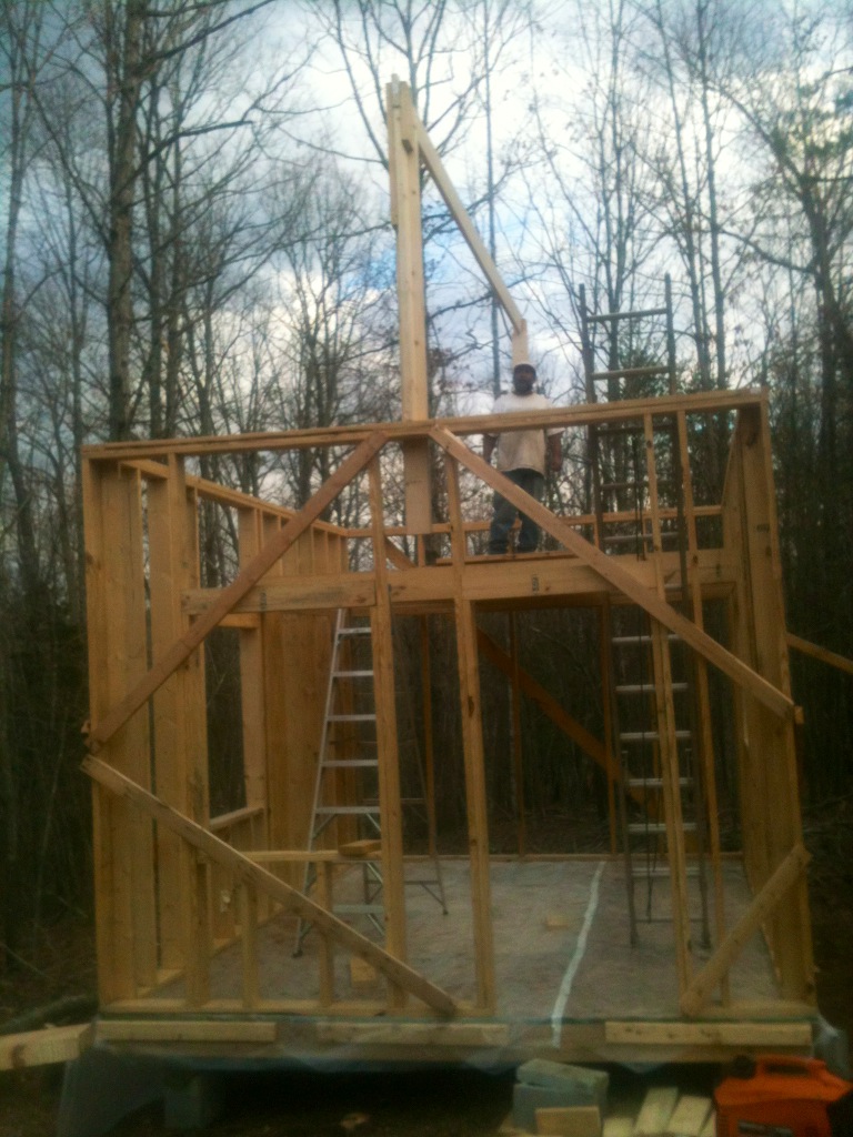

 Here is a pic of recent progress.Got floor joist for loft installed and got ridge board up, hope to have rafters installed by the weekend.Thats one of my friends standing in loft he and my father have been a tremendous help with this project.I was standing on a berm of dirt when i took the picture cellphone wasnt level cabin is though.

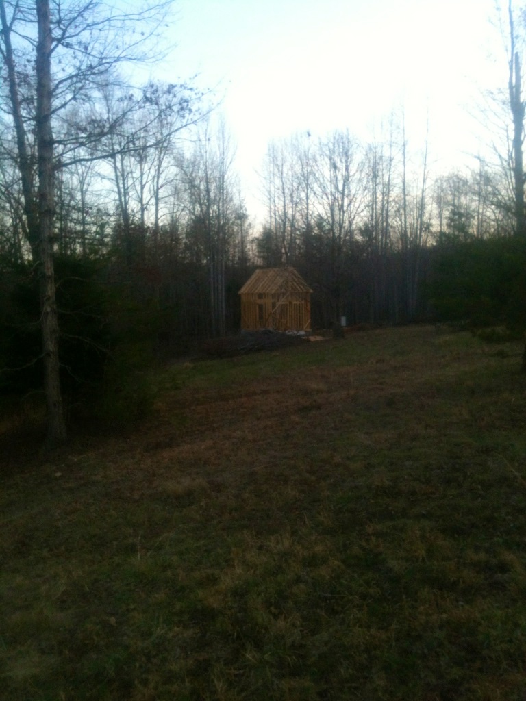

| vacabin Member

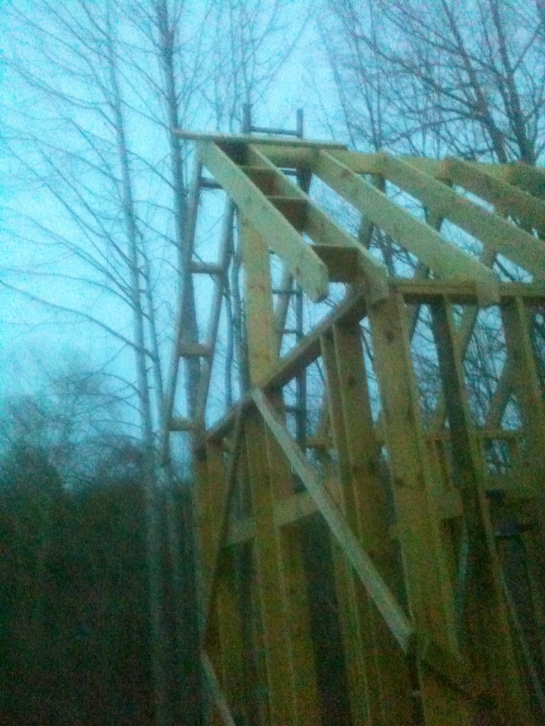

 | # Posted: 4 Apr 2013 06:31am Reply
 Started installing rafters yesterday. This was my first time cutting rafters with a lot of measuring and remeasuring everything fit perfect.

 How did you frame up the loft? Planning something similiar. Thanks.

 Press for the loft floor joist I sistered 2x6 jack studs to the 2x6 wall studs and nailed the 2x10 floor joist to the 2x6 wall stud with the jack stud underneath.

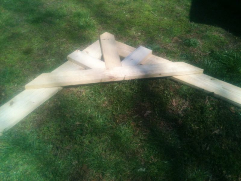

 Got a few more rafters installed this weekend also starting working on a design for the fly rafters
| vacabin Member
 | # Posted: 9 Apr 2013 07:33am - Edited by: vacabin Reply
 Got the fly rafters installed yesterday

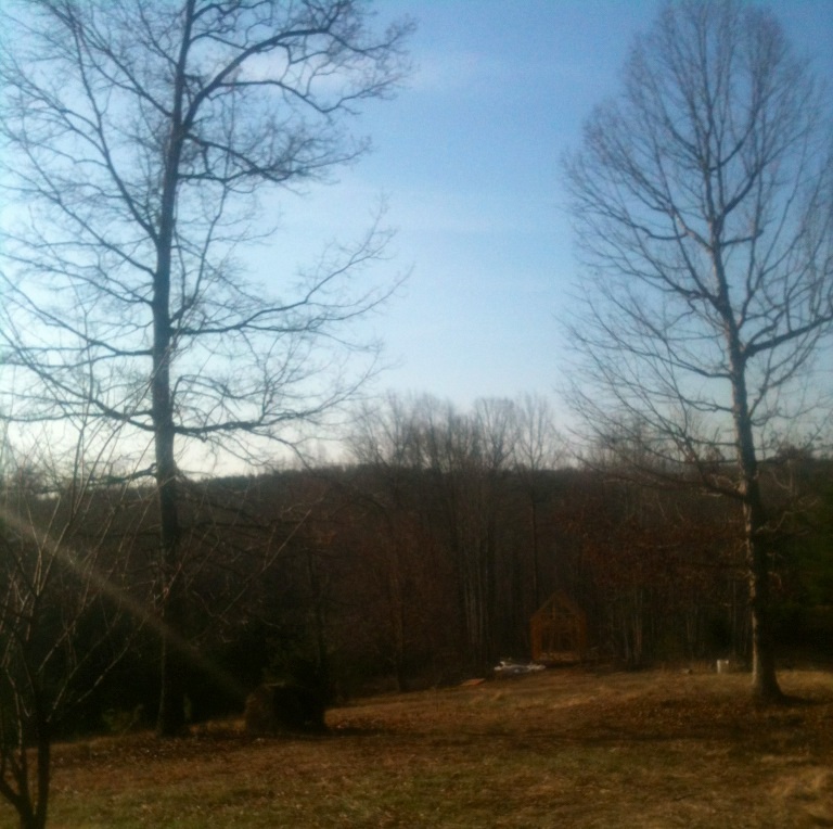

| vacabin Member
 | # Posted: 10 Apr 2013 10:44am Reply

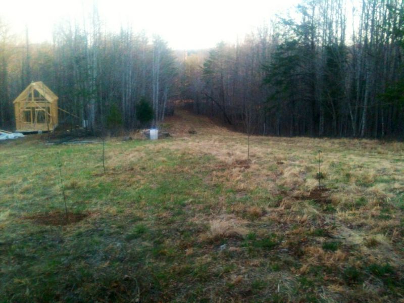

 Did a little yard work trimmed lower limbs on trees in front and field and me and my oldest daughter planted some apple trees.

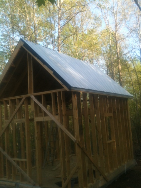

| vacabin Member
 | # Posted: 16 Apr 2013 08:20am Reply

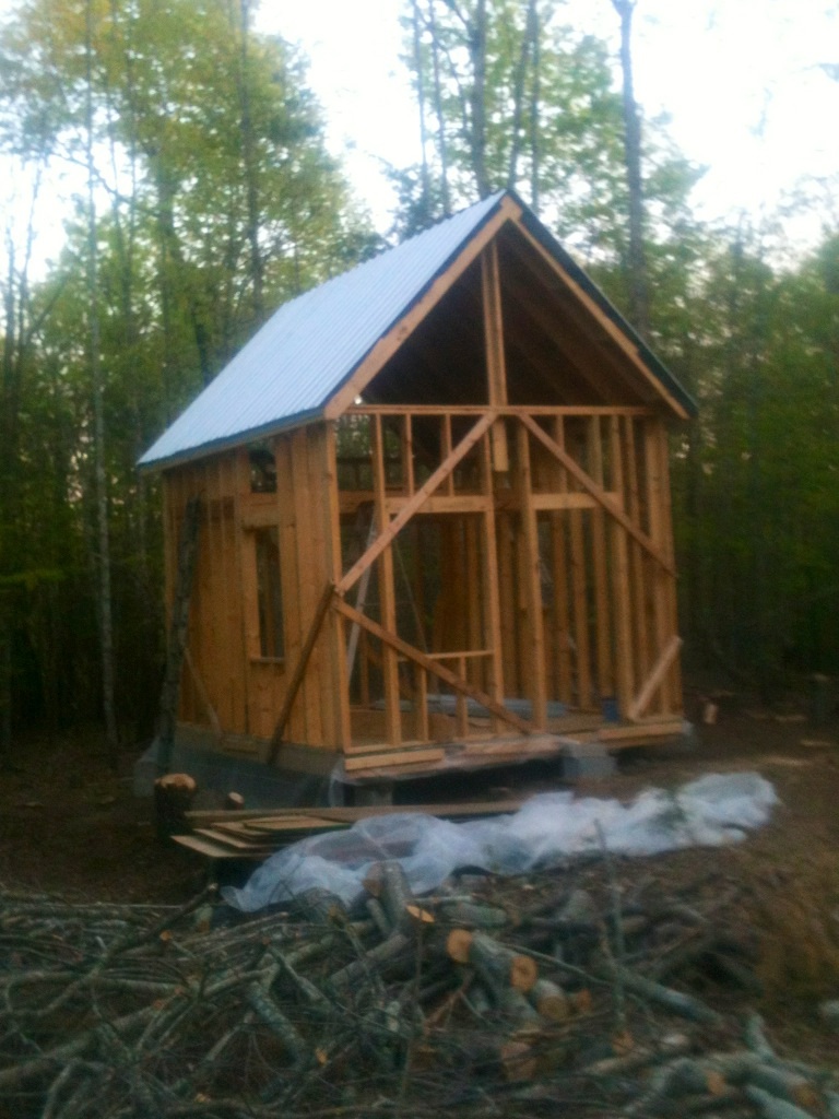

 Finally finished getting all of the roof sheathing installed.This will be my first time installing a metal roof any tips or tricks for installing metal roofing you guys have learned along the way would be greatly appreciated.
| vacabin Member
 | # Posted: 24 Apr 2013 02:43pm Reply
 Got some of the metal roof installed

 Got roof on just need to install ridge and gable trim. Also got a window for gable end.
| ErinsMom Member
 | # Posted: 28 Apr 2013 06:46am Reply
 Looks really great; love the look of the stained glass window.

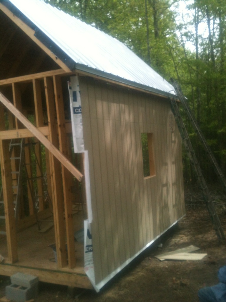

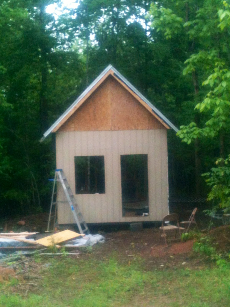

 Started putting up siding decided to go with lp smart side
| vacabin Member
 | # Posted: 11 May 2013 01:39am Reply
 More siding installed
| ErinsMom Member
 | # Posted: 11 May 2013 08:50am Reply
 looking good.

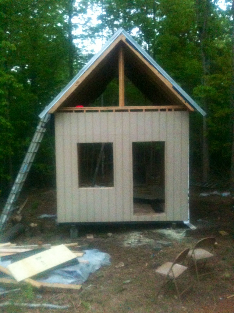

| vacabin Member
 | # Posted: 20 May 2013 01:52pm Reply

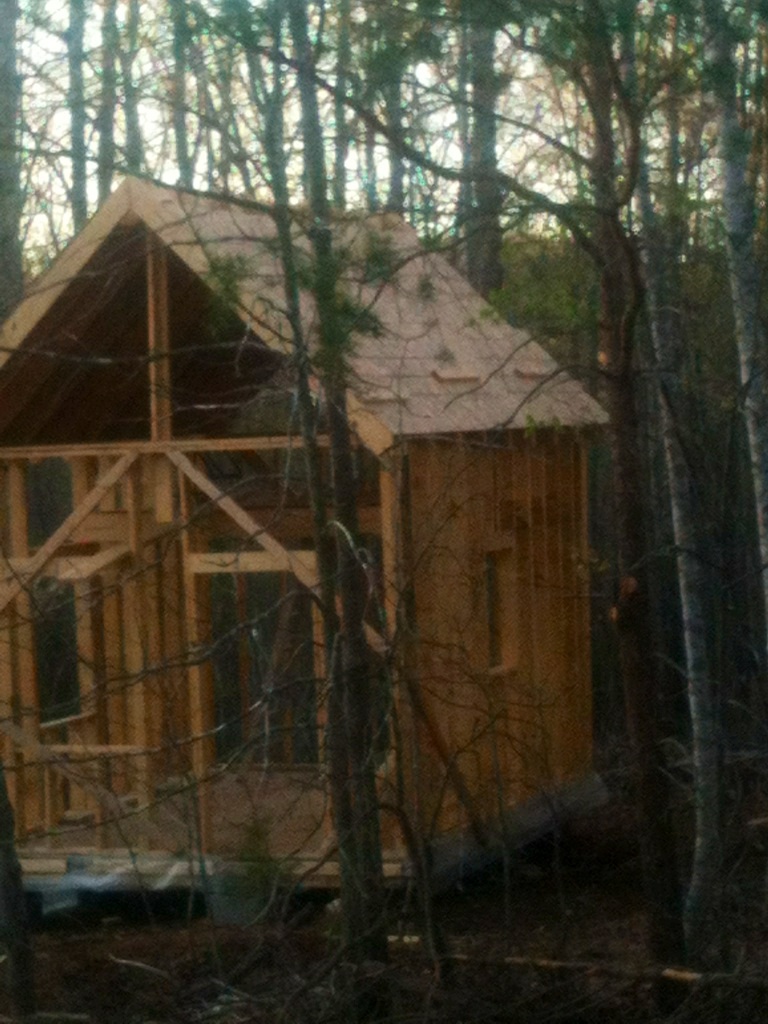

 Had a chance to put sheathing up on gable end.Going to install architectual shingles over sheathing going for a cedar shakes look.

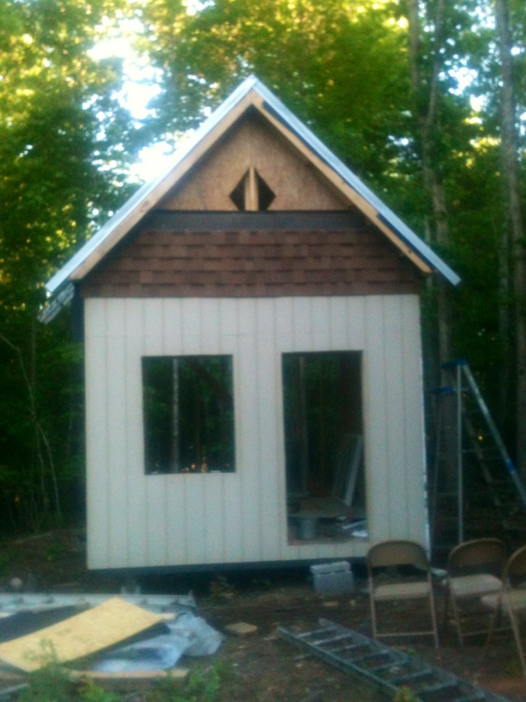

 | # Posted: 24 May 2013 07:22pm Reply
 Started installing shingles in gable end scored these from lowes for $5 a bundle.
