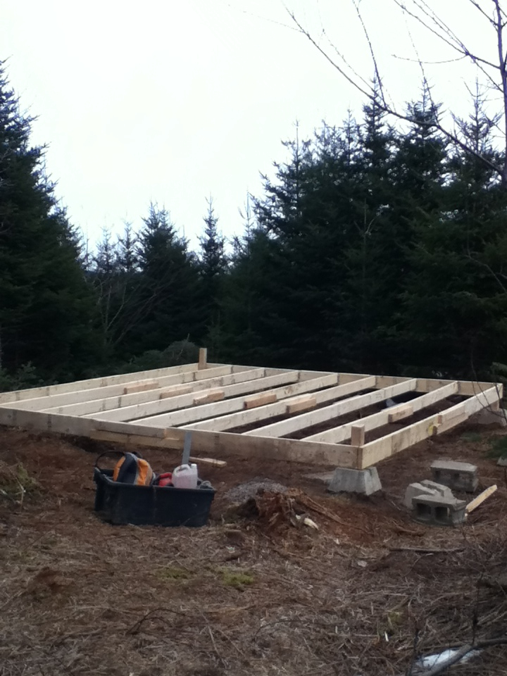

Hello folks. My name is Aaron29 and I hail from Nova Scotia.I am a AVID fisherman/hunter.I recently purchased a huge chunk of land that includes a beautiful trout lake.I am currently building a 16'x16' cabin about 200' away from the lake.Just did the foundation and floor joists yesterday. I have lurked here for quite a long time as I wanted to wait to post until I actually had something to post....
Im sure I will have alot of questions.First one..Trying to save money I bought untreated 2x10 and 2x6 spruce boards.Anyone have any inexpensive/homemade concoctions to weather treat the wood?

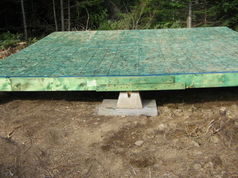

Here she is.Cant wait till the 2x4's get up there.
Yesterday we installed the joist braces,installed the side/center supports,pentoxed the flooring and drank a 8pack of Bud on the floor! it's n ice to see it started and full steam ahead! 046.JPG

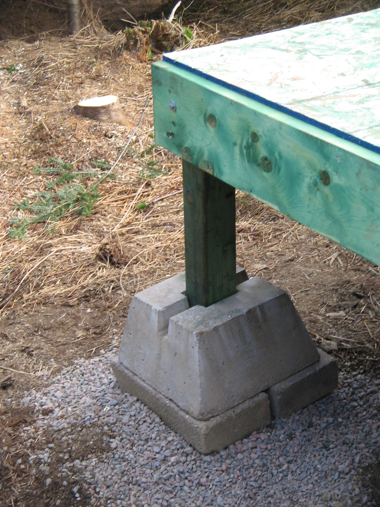

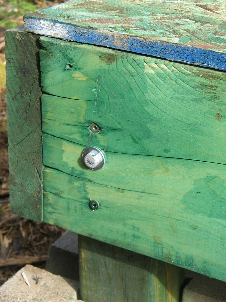

# Posted: 18 Apr 2013 08:39pm - Edited by: toyota_mdt_tech
Aaron, that rim joist is "bolted" to the 4X4 post. Which is fine to hold it in place, but I think the load should be put on the concrete pad directly instead of through the bolt. That rim joist will carry the entire load of the floor, walls and roof. Cut a chunk of 2X4 or 2X6 and cut it to fit between the rim joist and the concrete pad real tight. That way, the load is not on the bolts. Otherwise, you'd want the rim joist setting on top of the 4X4 instead of on the side. If you put in the pieces, paint them green too.
Aaron29
# Posted: 18 Apr 2013 08:56pm - Edited by: Aaron29
Ahhh Gotchya!

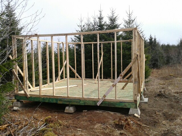

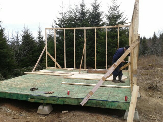

# Posted: 23 Apr 2013 06:14pm
well I hauled 57 of the 100 2x4's up to the site thismoring and built and raised 2 walls....here is where she stands today!!Im excited!

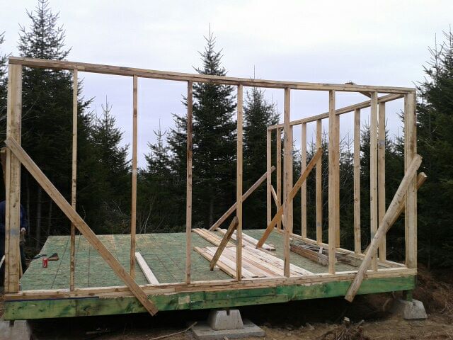

# Posted: 27 Apr 2013 05:41pm

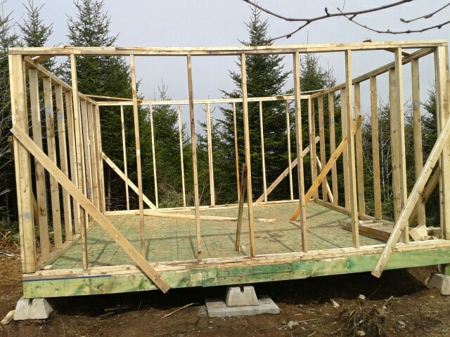

Not much of a update but what the heck...im excited..
WALLS ARE UP!!
gunslinger22
# Posted: 28 Apr 2013 12:01pm
It might be that I just can't see it but make sure you've got your third stud in each corner for nailing whatever wallboard you are using.
Aaron29
# Posted: 28 Apr 2013 12:30pm
Ah yes Gunslinger,the third studs are there!!
