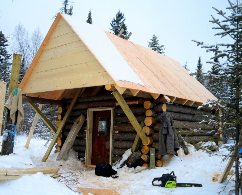

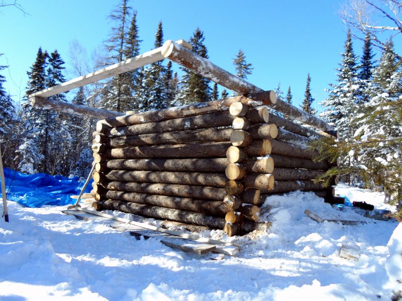

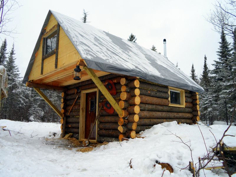

Hello Everyone!
I'm new to this online community but I've really enjoyed looking through all of your projects while I worked away one mine. So here it is...
Cozy Bush Cabin- Youtube (Click the link to check out the video tour)
I built this bush cabin in Northern Ontario, as a church youth group project. It was a great learning experience for me and my youth! I constructed it in my spare time, and it took 8 months to complete. And it didn't cost over $500 to build!
Cabin details: - I have no previous experience in construction, only a passion to learn and build. - Keep in mind this is a bush cabin and I wasn't building it to code or anything. - I built the cabin right on the ground, and although there has been lots of flooding in the area this spring, the cabin has been bone dry. Also there has been no signs of shifting. - The cabin is 10'x10'. While the roof section is 12'x16' - It has 52 logs, approximately 25 inches in circumference at the base. I left them with the bark on. - It only cost me $15 worth of gas, and $30 worth of oil to build the entire cabin with my chainsaw. - The floor is set on 9 patio stones, with 2"x4"s for support, and 2.25" thick rough-cut Poplar floor boards on top. - I made square notches in the logs, which I found to be a sturdy way to fit the logs together. - We didn't use any machinery (except for a chainsaw). Just good ol' fashioned man power. - I used a heavy-duty tarp to cover the roof. - To fill the gaps between the logs I used brown-coloured insulation. Not the best way to fill the gaps, but it's certainly cheap, quick, and efficient.
I guess I'm gonna need to get a Photobucket account to display my pics, but in the meantime, you can just click on the Youtube link. Enjoy!

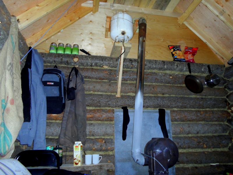

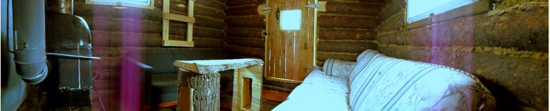

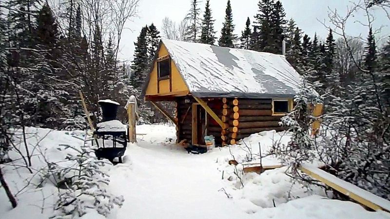

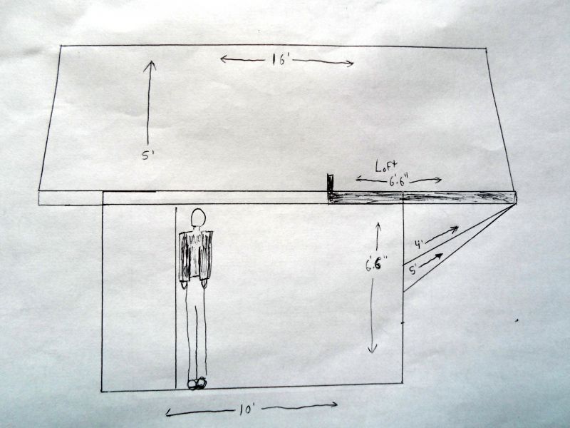

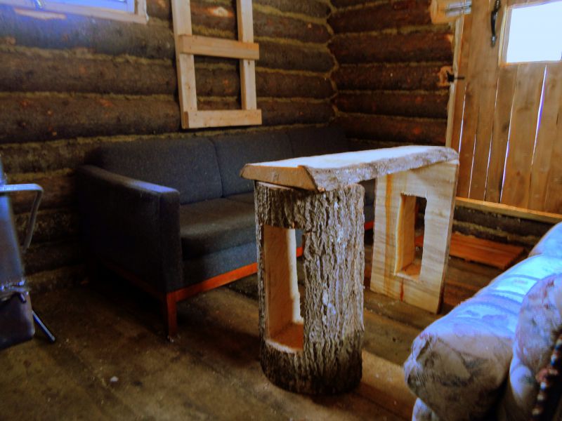

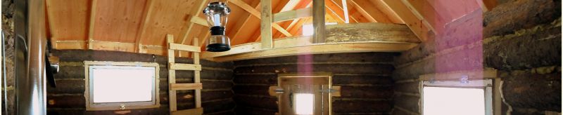

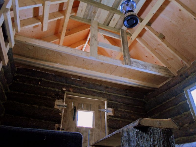

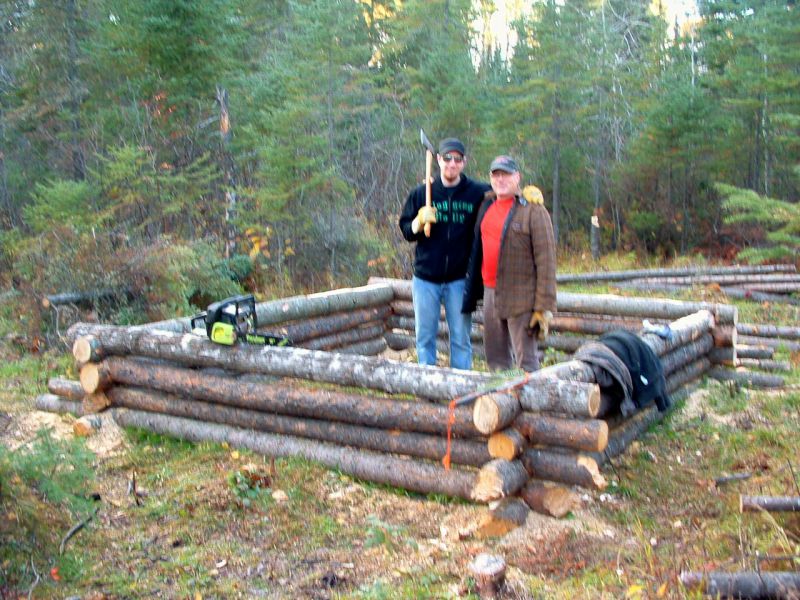

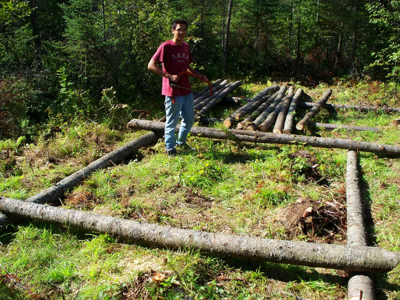

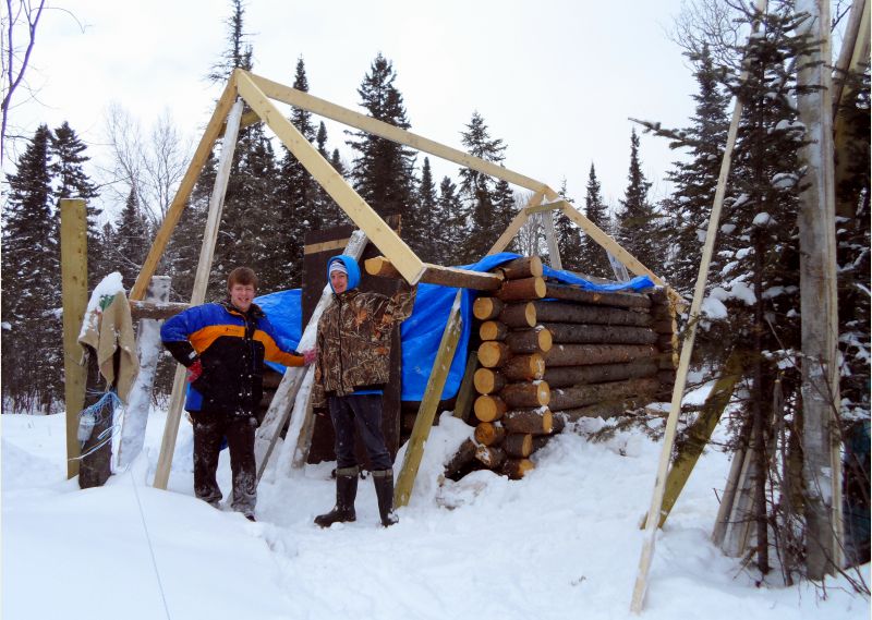

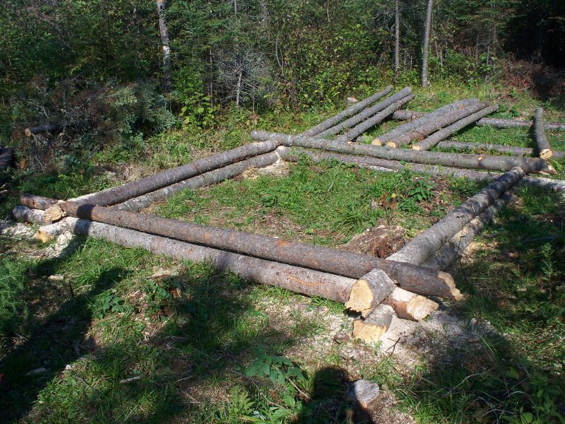

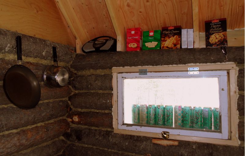

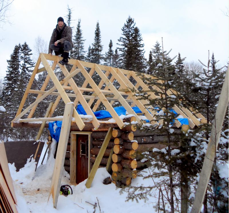

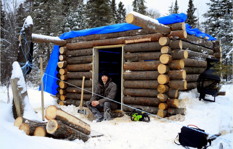

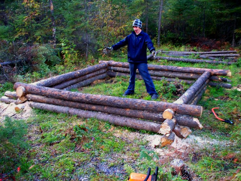

Here's some pics finally!
Click this link to view the Youtube Video Tour of my Cozy Bush Cabin Concept
|  Progress 1
|  Progress 2
|  Progress 3
OutsideFun1
# Posted: 4 May 2013 12:15pm - Edited by: OutsideFun1
Reply Quote
pics Progress 4
|  Progress 5
|  Progress 6
|  Progress 7
OutsideFun1
# Posted: 4 May 2013 12:18pm - Edited by: OutsideFun1
Reply Quote
pics Progress 8
|  Progress 9
|  Progress 10
|  Progress 11

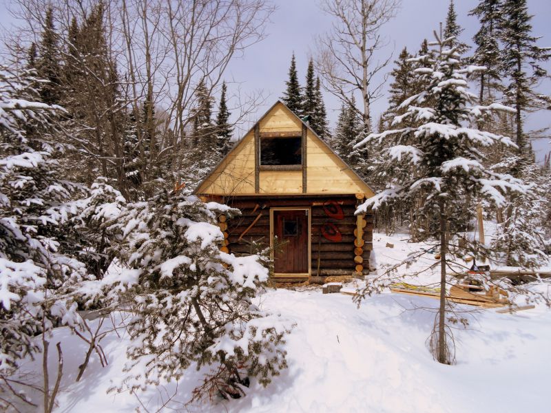

OutsideFun1
# Posted: 4 May 2013 12:24pm - Edited by: OutsideFun1
Reply Quote
pics Progress 12
|  Progress 13
|  Progress 14
|  Interior 1
OutsideFun1
# Posted: 4 May 2013 12:31pm - Edited by: OutsideFun1
Reply Quote
pics Interior 2
|  Interior 3
|  Interior 4
|  Interior 5
OutsideFun1
# Posted: 4 May 2013 12:34pm - Edited by: OutsideFun1
Reply Quote
pics Interior 6
|  Interior 7
|  Interior 8
10sne1
