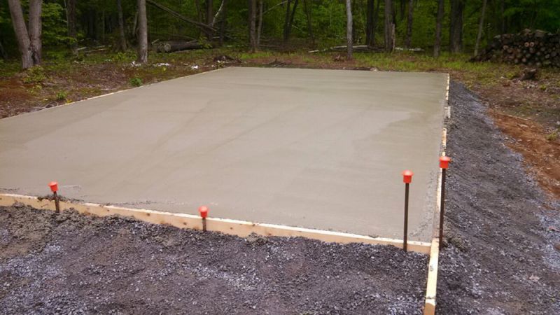

Here is the foundation poured
Cement poured
Cement poured

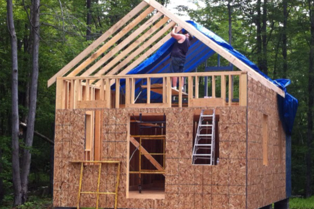

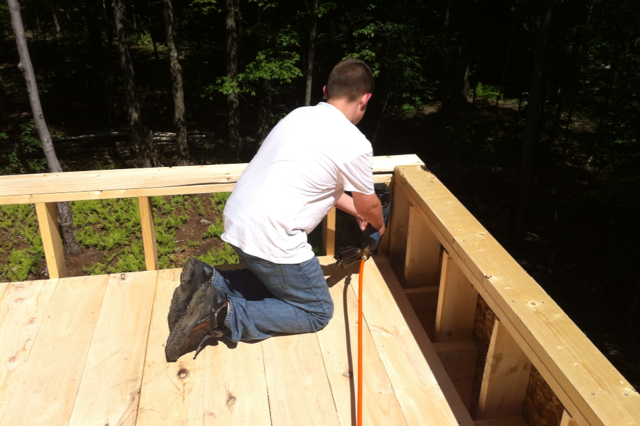

# Posted: 14 Jul 2013 09:07
Here are a few pics of the progress we made the first week.. dealt with a lot of rain....

Fast forward two days

My son nailing down loft flooring

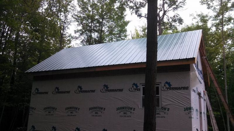

Here is where we are currently... ridge vent going on tomorrow. Still waiting for the two front windows that were special ordered... scheduled delivery for the 19th.... still have to frame the porch.
Back at it after a week of no work due to rain...
Metal almost complete
Ridge vent left to do

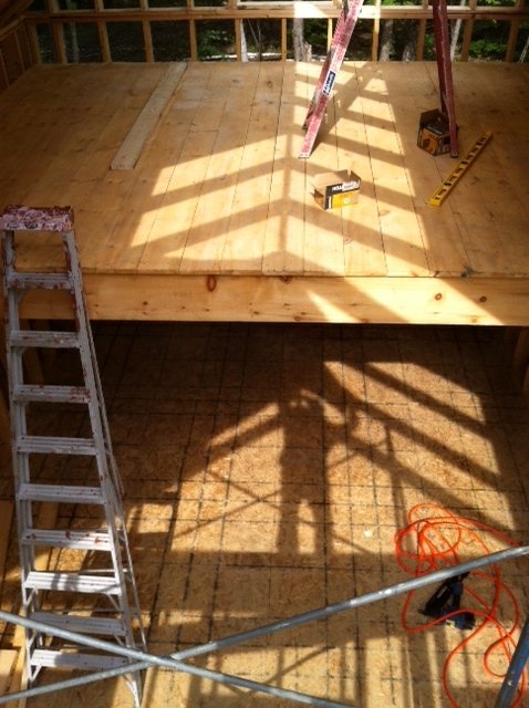

Forgot.. my view of the loft photo.. here it is.. loft is framed with 2x12 rough sawn pine and covered with 1x8 rough sawn pine flooring
View of loft
View of loft

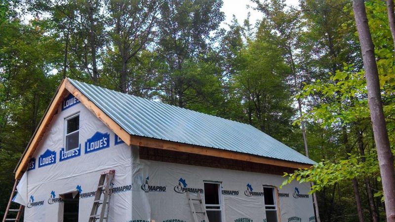

# Posted: 20 Jul 2013 07:27
This is where it buttoned up a few days ago... I've since put up the styrofoam roof ventilation baffles....
Will finish boxing in and ventilating the overhangs when I can be out there to give him a hand
Cabin roof
Cabin roof
Roof from the side
Roof from the side

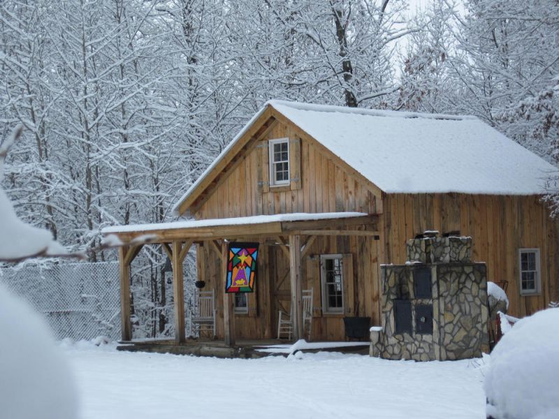

This is the style of cabin we are going for, only not as wide.. I believe this is 20' wide as it sits.. we are 16' wide. Porch roof will be attached to the cabin at a higher point than this one is though due to snow load here in northern NY.
My apologies to whom ever owns this cabin that I'm posting a pic of,,, if you want it down, I'll remove it... not sure where I found the pic, but loved the style of cabin....

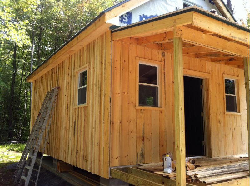

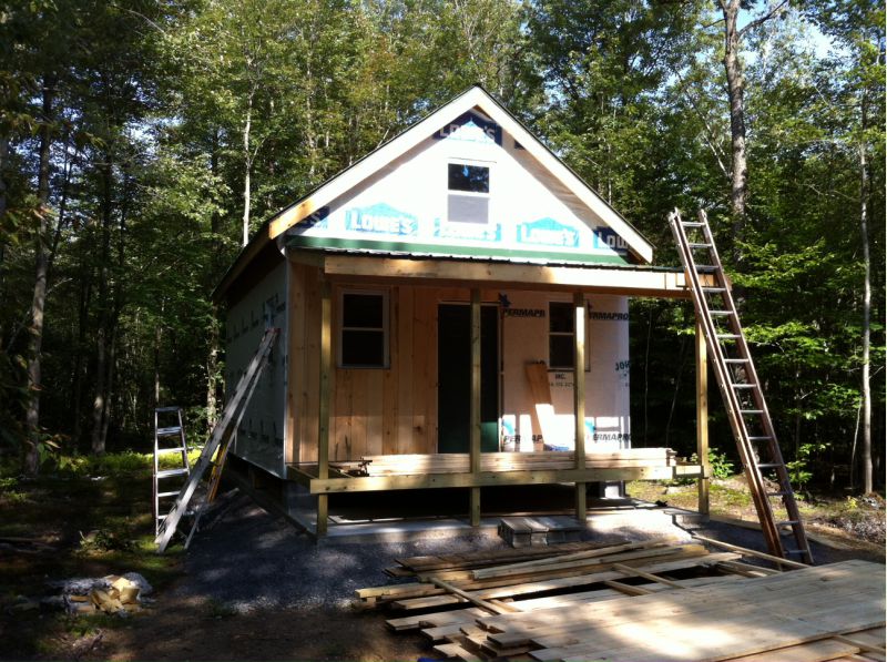

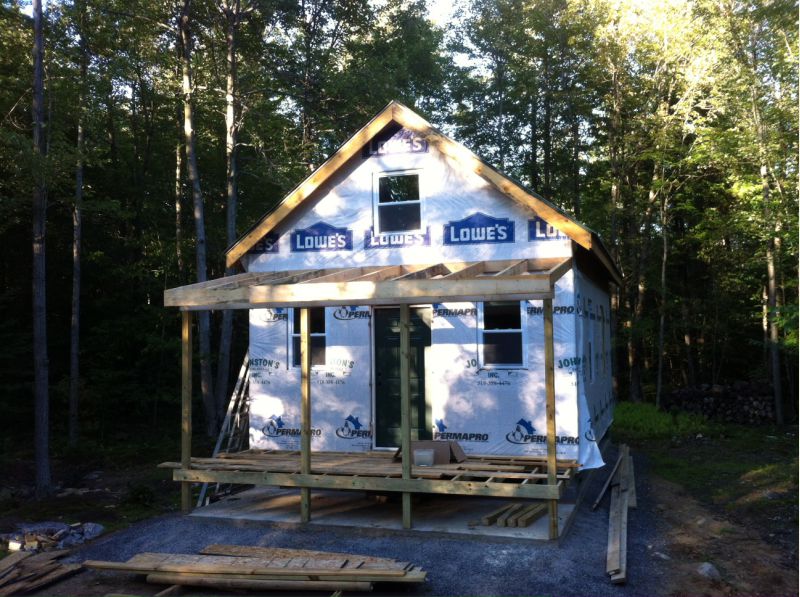

# Posted: 27 Jul 2013 10:30 - Edited by: Swamphunter
Here is where we are after a day of framing for the porch. I also did the rest of the roof insulation and then cleaned up all the saw dust and garbage both inside and out... this picture was taken before I accomplished the exterior cleaning.... Im kind of a neat freak and hate a messy build site. I burn off the scrap cut-offs that are too small for use and haul off whatever I can't burn. It doesnt appear it here when you look at the door, however the head room where you'd step off the porch onto the stairs is 6'7", as my brother is 6'5 and I wanted to have clearance for him....

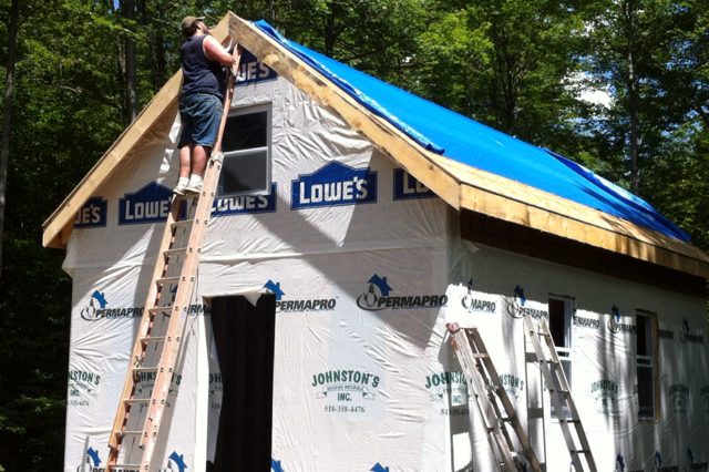

# Posted: 31 Jul 2013 18:49 - Edited by: Swamphunter
Update on progress.. I insulated the front gable, the ridge vent and ridge cap in place and also the porch roof is on. Started on the siding and ended there for the night.....

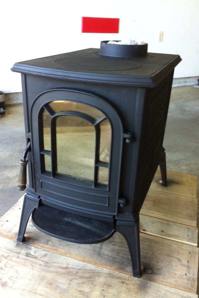

Waiting for the rest of the siding from the Amish man that is cutting the board and battens. Also the cedar for the decking. His sawmill broke down and although I couldn't work on cabin, I spent the time looking for a wood stove. I picked up this nice Vermont Castings model Aspen and it is in excellent condition. I brought it home, took it apart, cleaned it and replaced two gaskets that were bad. Good as new. Had it inspected at the same time and its ready for install!

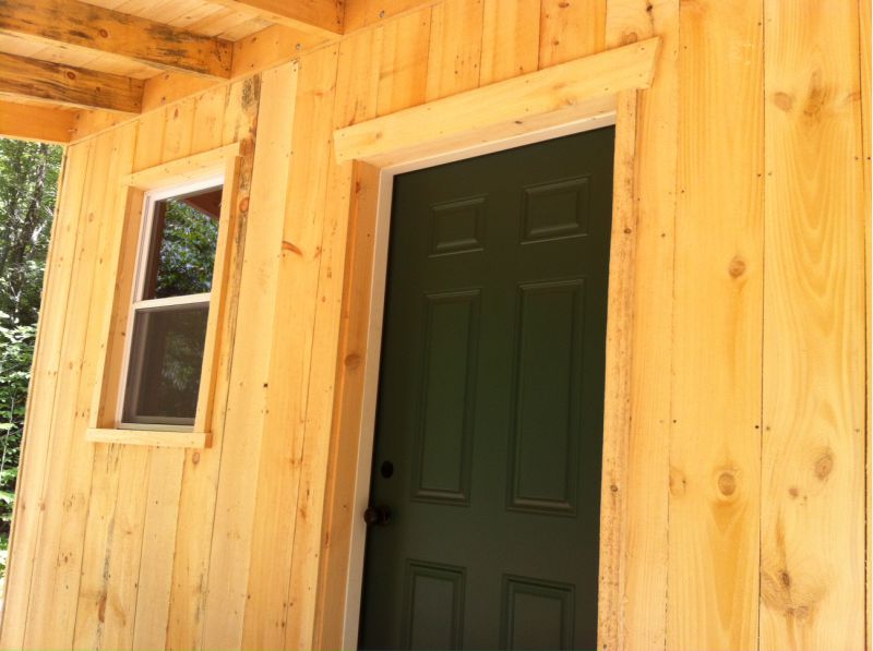

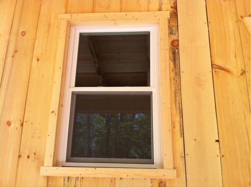

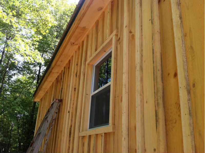

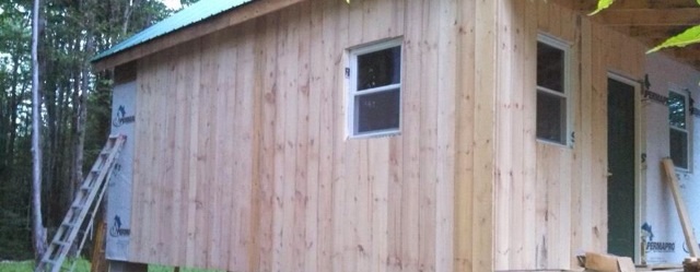

# Posted: 20 Aug 2013 11:57 - Edited by: Swamphunter
We did some more boards, added some batten and boxed in the soffit.... also cased in the windows and door, installed the door knob and the dead bolt... these pics dont show it, but the boards over the porch on the front gable are on too along with most of the soffit.... I am installing soffit venting my next day off work....
Battens and soffit
Battens and soffit
Door casing
Door casing
Window casing
Window casing
