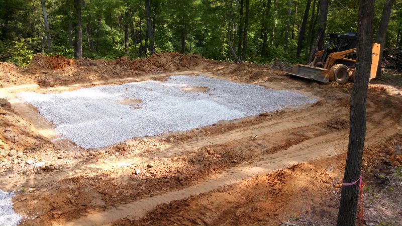

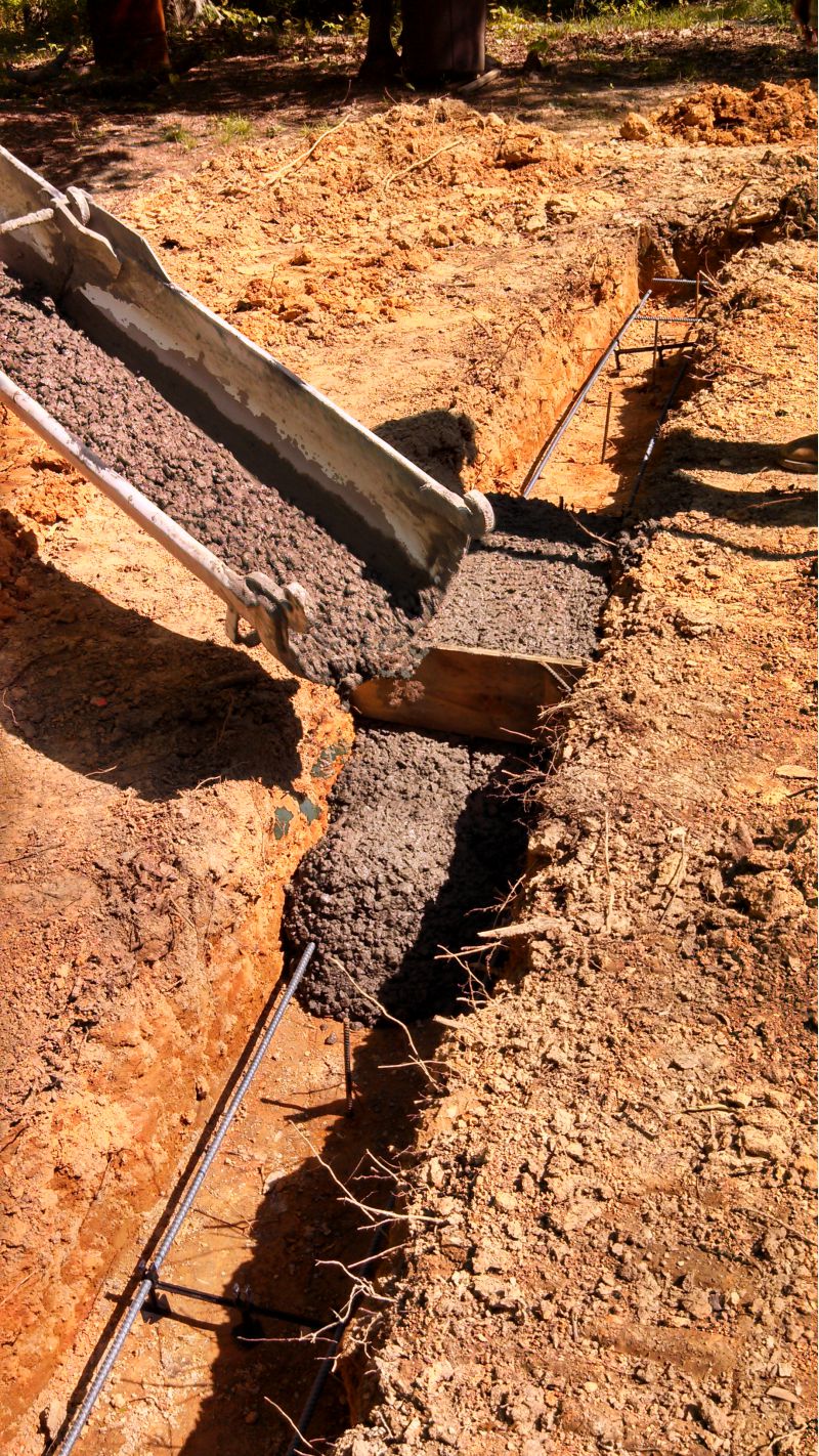

I don't know if this qualifies as a "small" cabin but I have received a lot of inspiration from this site so I thought I'd share. Wife and I are building a 24 x 28 one bedroom on 5 wooded acres. Planning on a 12 x 12 loft/storage area. Main level will be a bedroom, utility, and bath under the loft plus living/kitchen/dining with cathedral ceiling. Planning on a 12/12 pitch outside and a 9/12 pitch inside with scissor trusses all the way throughout. A friend of mine who is a builder is helping me, (more like I am helping him), get a start on my cabin. We rented a small excavator and dug the footers last Sunday, 05-12-13. I took off an afternoon of work last Thursday and helped him pour the footers. We drove up today 05-19-13 and dug out the crawl space. We had to do a step down in the footer on about half the foundation because the back half drops off down hill.. Gonna go three blocks high on the front portion and 4 on the back part. I'm gonna try to attach a pic of the progress as of today. Footers_dug.jpg

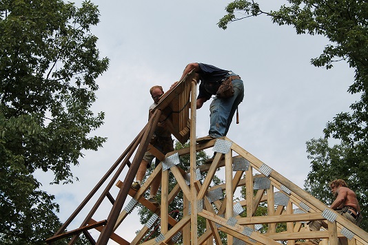

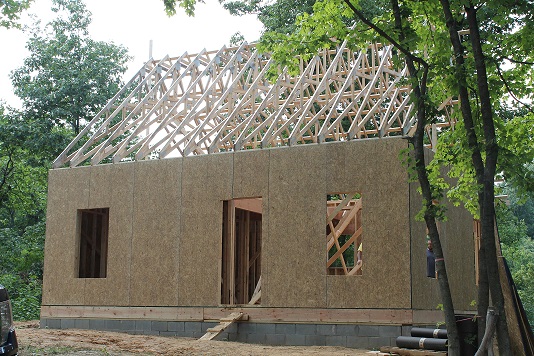

Build update: I'll try a pic that shows where we are as of yesterday, 08-17-13. One shows the trusses with purlins 24" on center. The plan is to put the osb on top of the purlins, 30 felt, then the metal. Cabin_081713.jpg

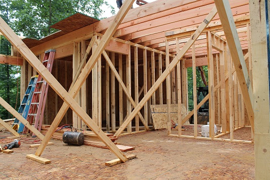

grover
# Posted: 18 Aug 2013 10:36pm
Here are a few pictures from last Saturday when the floor was completed and walls were raised.
