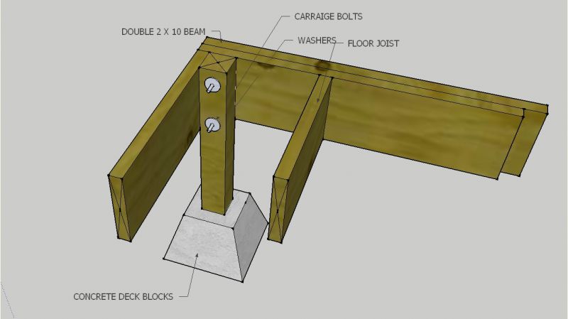

Hi, I am a new member to the site but have researched it for the past year. My wife gave me the green light to start our cabin project next week in northern Minnesota. My question is the on the beam...we are 'building a 14' x 16' with a 6' covered porch on the front. because or soil conditions and donated items, I am hoping to use deck blocks or Dek piers to support the beams approximately 18" above the ground. My fear is the beam sitting on the top of the post would cause the structure to be "Tippy" I had thought on making the rim to act as the beam...I drew it up in sketch up and am looking for any comments you may have. Thanks!

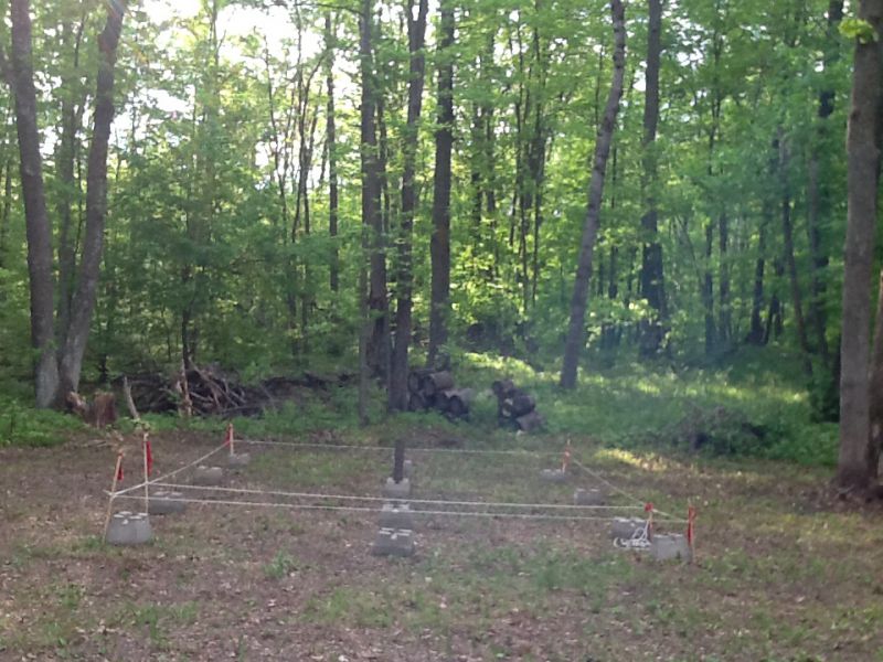

By the way, here is the rough stake of our future cabin...

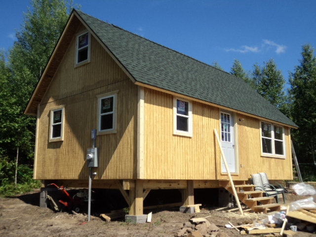

The beam should be under the floor joists. Put extra cross planks to keep it strait or 45 deg. bracing. I'll try to find a picture.
Ok, this picture is of a bigger cabin, but you get the idea, also with beams under a foot or so from the rim joist, the floor is sturdier.
In the picture you provided there would be too much weight on just bolts.
beams and blocking
beams and blocking

Thanks Owen, That was my fear. what you recommend makes more sense...I could probably save a lot of time and effort by purchasing the one in your photo. It appears your photo has 6 x 6 post, I am trying to still use the deck blocks that accept a 4 x 4, do you think I will still be okay?

# Posted: 20 Jun 2013 06:38pm
You might be able to see, I use three 4'' block, two wide and a single on top.
