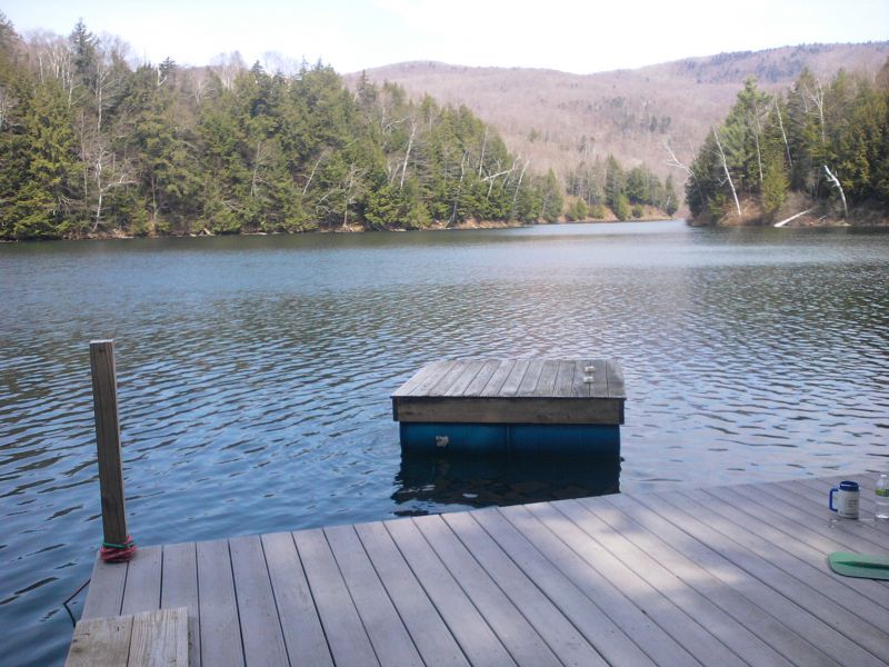

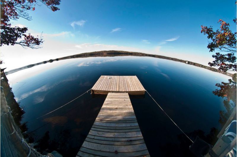

Here is my floating dock... 12'x10' with a 12'x4' ramp. Built with marine Styrofoam I got from an old government wharf.
Going to be adding a 3' by 16' addition on the side to dock a pontoon boat. Will be using barrels for this part. Fisheye shot of the dock
|  Dock during construction

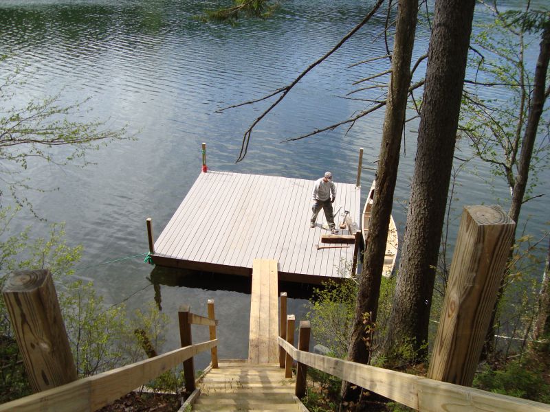

A floating dock was the first thing we put in at our place. Went for 16 x 16 for stability and lots of room. Here are a few pictures. Happy to answer questions. P1010135.JPG

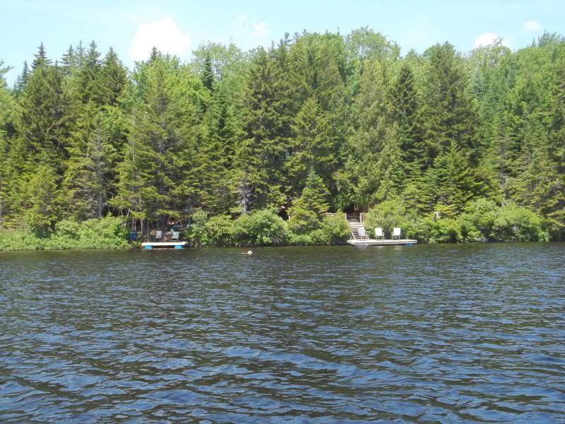

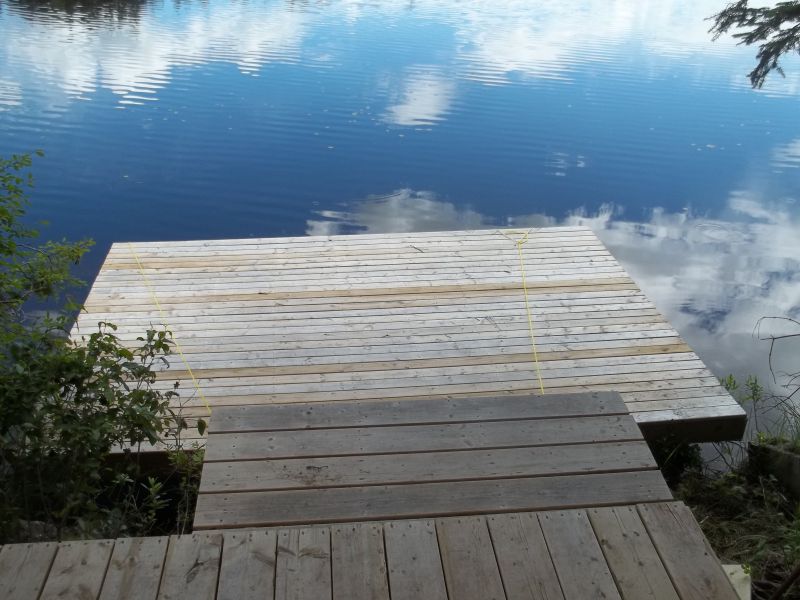

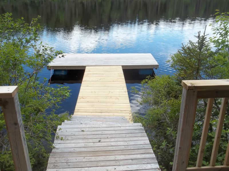

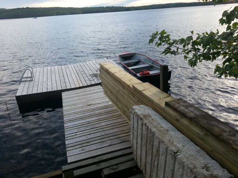

Great pics of docks guys - nothing like a dock at the lake eh? I finally got mine sorted out with some pics. On the main dock I maind concrete anchors using old tires - a little plywood in the bottom with an eye hook extending above the concrete - have four and criss-crossed the wiring for added stability - they held perfectly thru Hurricane Arthur. Well worth the time and effort. Pics are main dock, boat launch dock and then a shot from looking back in at them from the lake. 100_1622.JPG

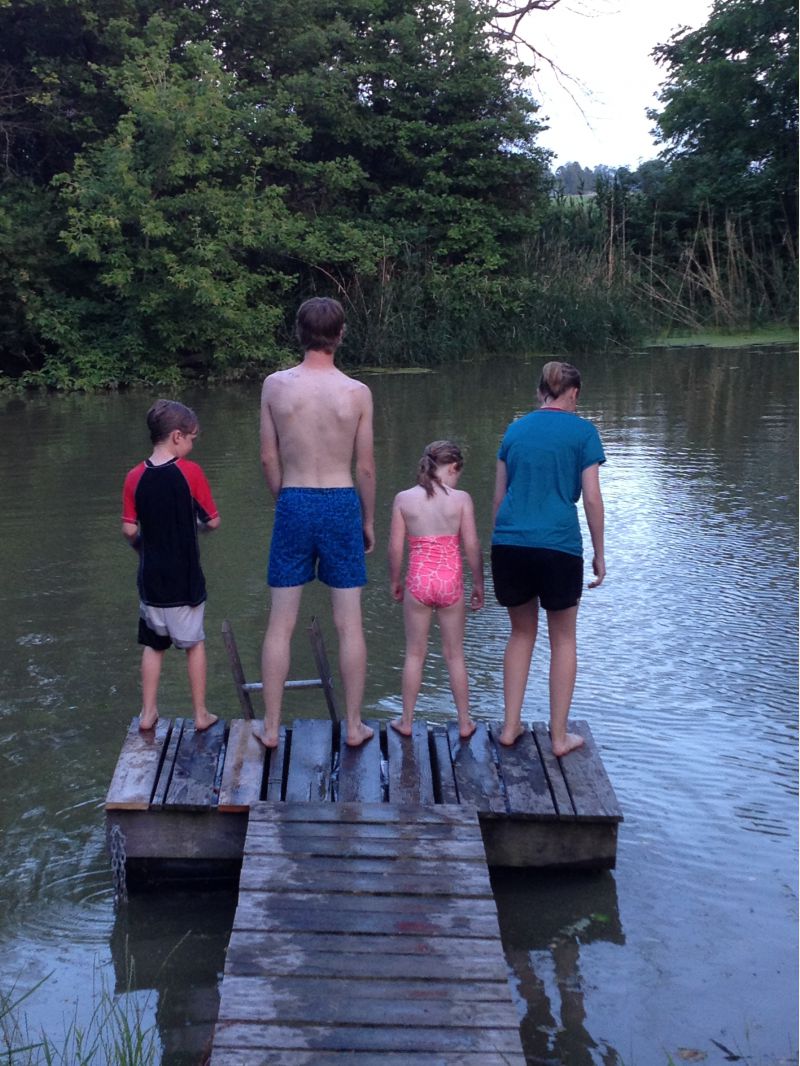

Simple 3 barrel dock, it is now 7 years old and going strong .
