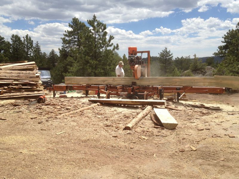

# Posted: 28 Jun 2013 06:53pm
Owen - My father was kind enough to lend me (permanently) his mill, so I now have an aging Woodmizer Lt40. Better yet, he delivered it from Michigan.

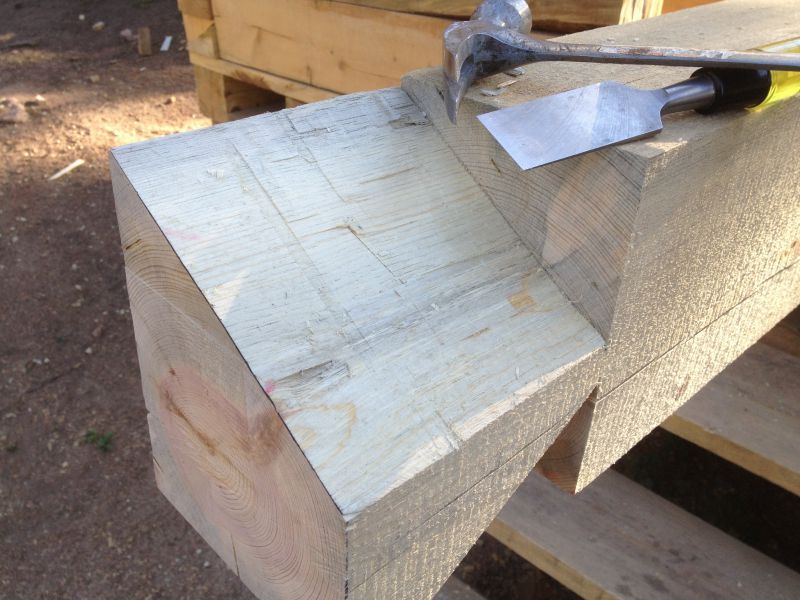

# Posted: 29 Jun 2013 01:10am
Neb, the walls are squared up logs, 6" thick and 8" tall, joined at the corners with half dove tail joints. I cut my floor (someday will be subfloor) planks a full inch and a half thick.

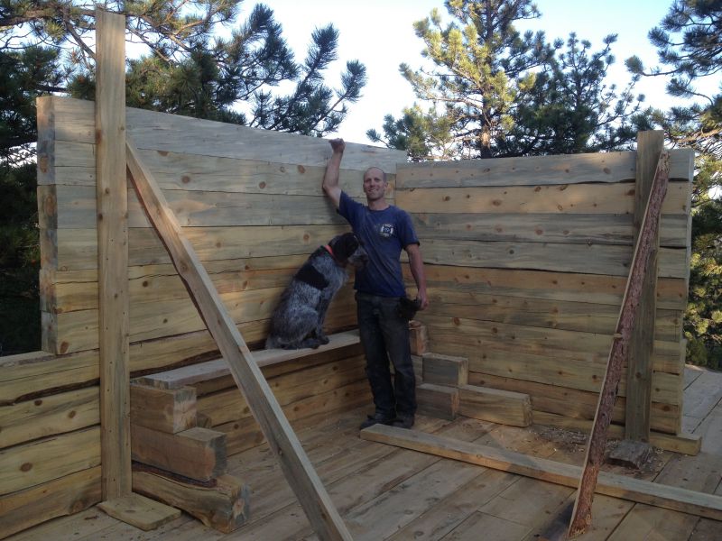

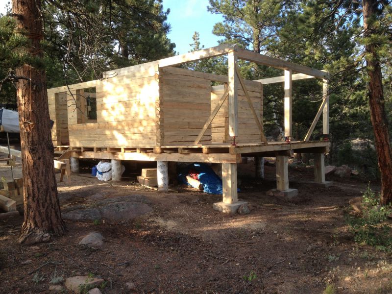

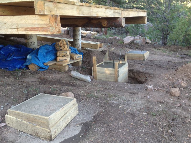

# Posted: 6 Jul 2013 12:44am
I've made a little progress since my original post. Walls are getting taller and the concrete pads are in place for the porch support posts. image.jpg

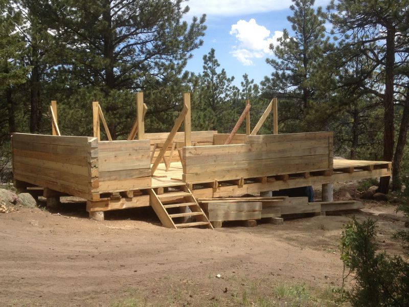

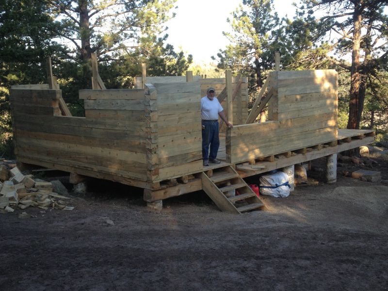

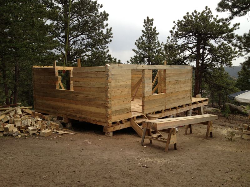

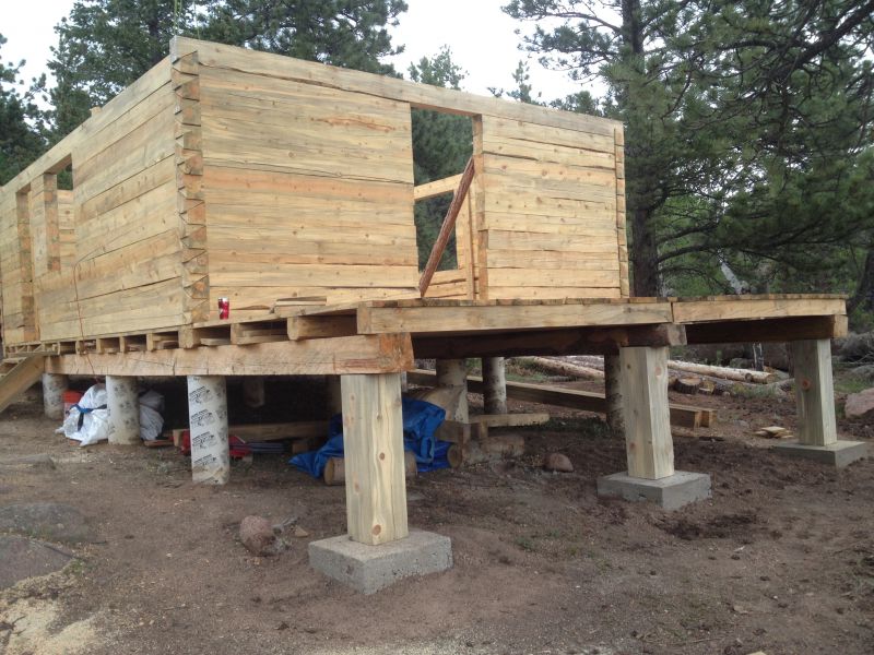

# Posted: 10 Jul 2013 11:20am
Windows roughed in, walls tied together. Next week should see some real progress. image.jpg

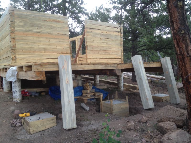

# Posted: 21 Jul 2013 09:46pm
Little progress this week but it sure was fun having the kids with me for four days. Deck supported, loft structure in place. Soon I'll be working on the roof, I hope. porch supports
|  start of loft
