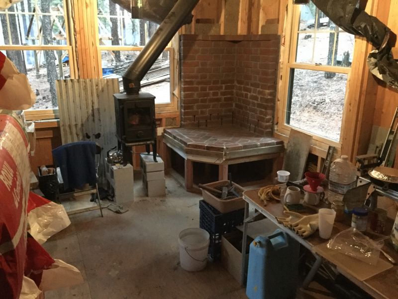

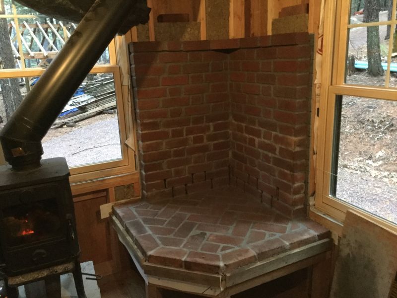

Another update- finished the brick surround, and discovered a problem. The brick, when dry, is discolored and whitish from minerals in the brick that come to the surface. This brick was outside for decades exposed to the elements, and I have learned since that this often causes the brick to get a lot of mineral content in it. The solution is to use acid to cut the calcite, or efflorescence, or whatever it is. They say start with a mild acid and work your way up if necessary. So I'm going to try distilled vinegar first, then toilet bowl cleaner, and if that doesn't work I'll resort to muriatic acid. Hope I don't have to resort to that stuff- it's nasty- I think it's hydrochloric acid.
The brick is wet in the photos so you can't really see the discoloration.
Anyone have experience cleaning masonry with acids?

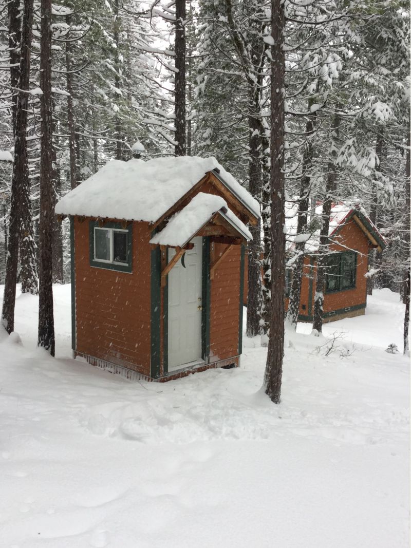

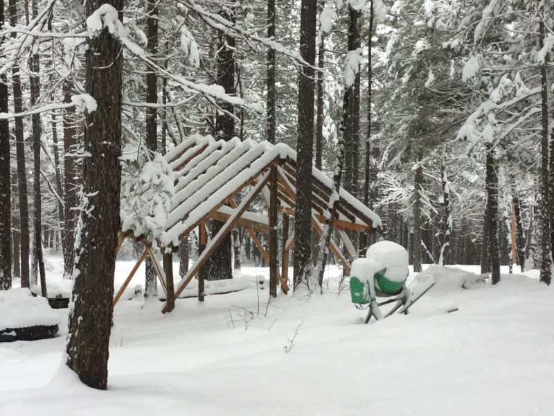

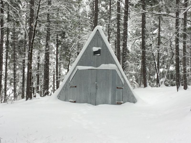

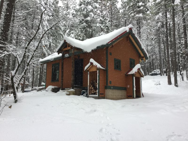

Just saw this about the brick issue I have used muriatic acid a bit and it will take the surface completely off of concrete if your not careful and it will" smoke" and If your in California causes cancer you could also try TSP first I believe the discoloration is from the lyme coming through so maybe even lyme away would work.But sometimes the inconsistencies in things is what makes them so special, I like it the way it is my 2!
# Posted: 14 Jan 2017 10:49pm
Reply Quote
Thanks Patrick. I finished it recently. I used vinegar, and a bit of toilet bowl cleaner, which used to be phosphoric acid but they reformulated it with some other acids and maybe a touch of muriatic in it. One problem was that I didn't clean the mortar off the surface well enough- should have brushed it, not just sponge it- beginners mistake. But the acids I used took that off and most of the lime or calcite or whatever it was that was discoloring it. Don't have a follow up photo but I'm satisfied. Probably one of those things that I would have ignored later but I had to get it right when I did it. Anyway all's well that ends well and I didn't have to use muriatic. Thanks for the input.
