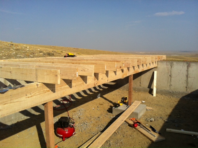

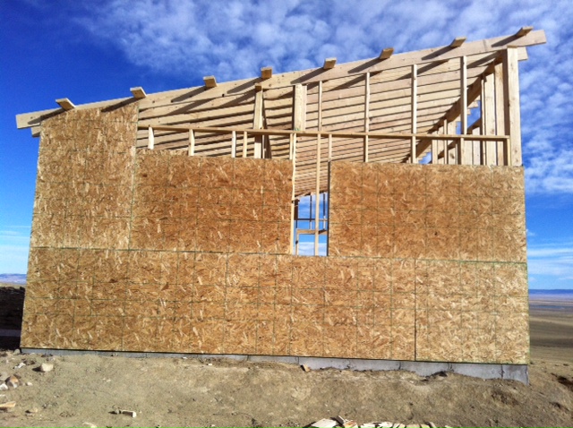

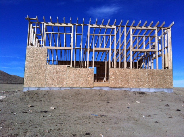

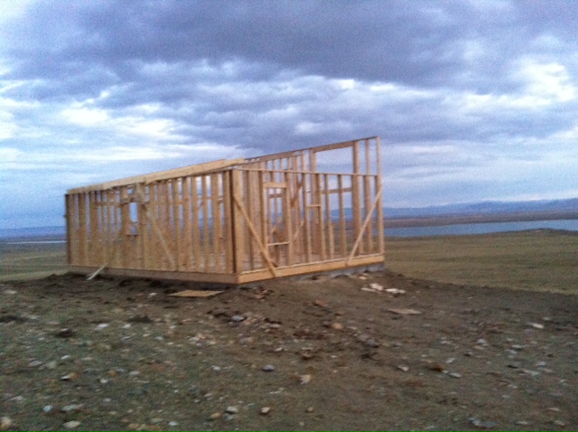

feeling brave enough to share some photos of the last year of construction. we've done everything ourselves except pour the foundation. I have serious pond/tree envy from some of your projects, but the high plains have beauty too! crawlspace
|  framing
|  sheathing
|  more sheathing

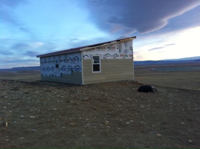

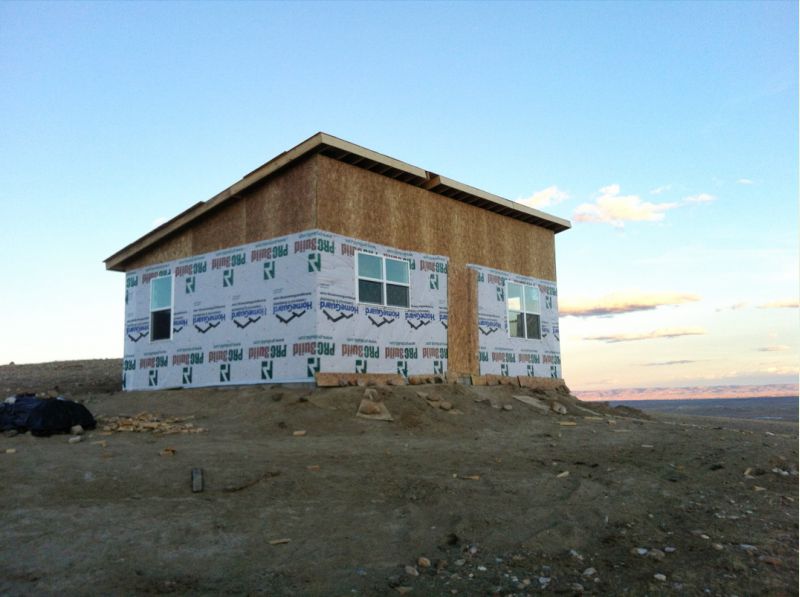

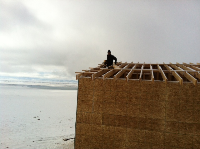

winter came fast and hard but some of the nicest construction I did was decking the roof on a perfectly calm 23 degree day. winter roof
|  view
|  house wrap is awful
|  siding finally

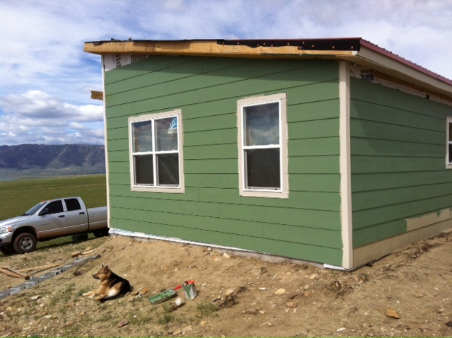

WY_mark
# Posted: 23 Jul 2013 11:07pm

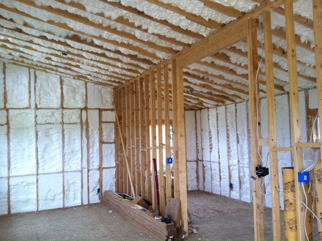

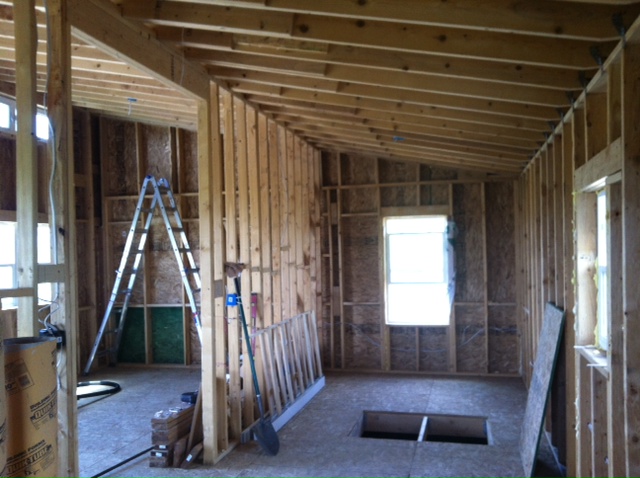

real progress happened starting spring (which is MAy at this altitude) inside view sans bathroom framing
|  siding, paint and a truck I wish was mine
|  spray foam
|  spring flowers

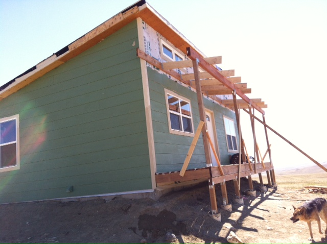

WY_mark
# Posted: 23 Jul 2013 11:08pm
took FOREVER for the ground to thaw for footings for the porch and a no wind day to get the beam up. going back next weekend to frame the rest of it in.

Did you do the spray foam yourself as well? I'm interested in doing something similar for insulation but don't know the first thing about doing it yourself. Rental equipment, clean up, etc.?

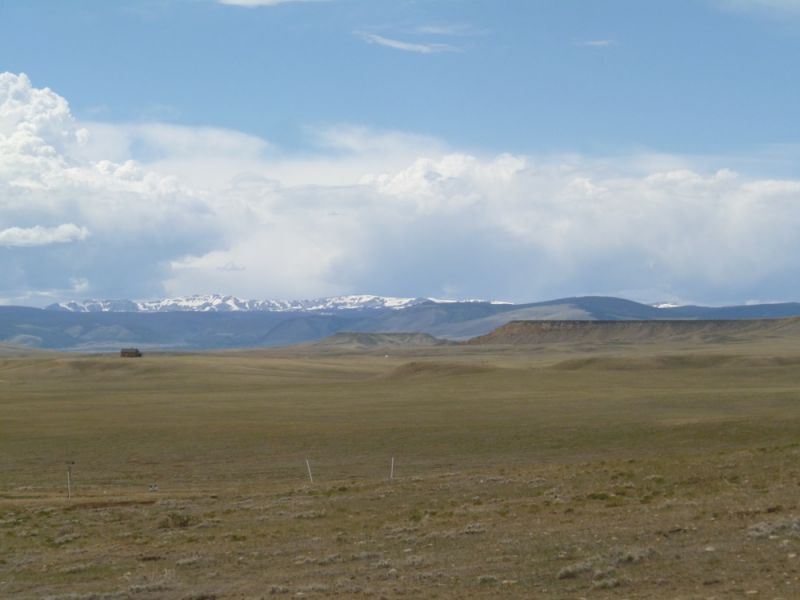

Wow. Looks like you can see forever.
WY_mark
# Posted: 24 Jul 2013 10:32am
we can see forever, literally into colorado to Long's peak (60 miles away), I love the crystal clear skies.

I did not spray foam it myself. After much research it looks like almost the same cost to have it done as to do it myself, largely because everyone says you basically waste the first tank learning how to do it. We paid $2600 for 4 guys to come in and do it in 6 hours, most of which was cleanup. They used open cell foam and we got 5" in the ceiling and 3.5" in the walls, but really the walls got mostly filled so 5" there too. The sound dampening on a windy day is fabulous. I figured doing it myself would probably cost $3k. If you google eco foam and tiger foam you can find spray kits, but honestly after my research and seeing these guys work while I played with the dog I'd never do it myself.
