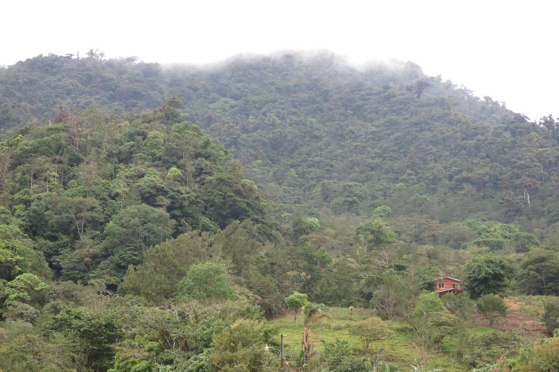

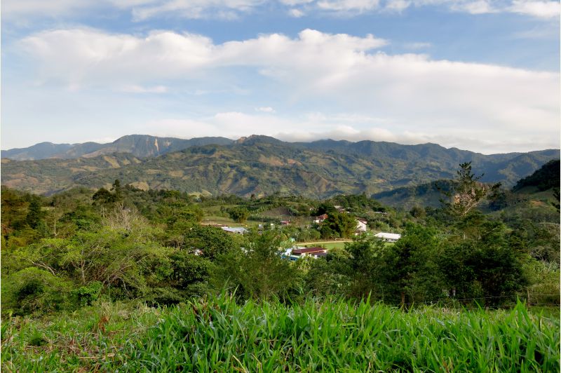

 Here's my deal: I've purchased a piece of land in a small mountain village in Costa Rica where I used to do bird research and am looking to build a cabin there this coming winter.
 From what I can tell, I am allowed to build anything under 30 square meters (~323 sq ft) without the hassle of construction permits, insurance, etc.
 The property is at about 1,100 m elevation (3,600 ft) and so it doesn't get terribly hot or cold. No need for insulation. It is a very humid place however and it can rain for weeks at a time, so I was thinking of building with wood on top of concrete piers to get air moving around the whole structure. Nearly all other houses in the village (all locals, no other foreigners) are concrete block houses built on concrete slabs - but I think this is more due to tradition and simplicity. I prefer the aesthetics of wood.
 Here are a couple photos - one taken where the cabin will sit and one of the view down to the village.
 So - thinking of a 16'x20' type design with a half-loft. It's a bit tough planning from afar since I don't know exactly what materials are available and how much they cost. The plan is to go down in January, find out about the materials and talk design with some local builders, but do most of the work myself in March and April.
 Anybody care to give some thoughts on designing in a place where I don't have to worry about snow load, could definitely utilize a lot of rainwater, and possibly wind/solar? I'm interested in being off the grid though would have to bring most components down there with me as they likely aren't available in country.
