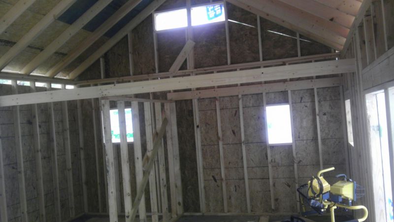

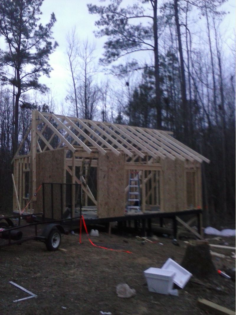

# Posted: 18 Feb 2014 08:13am
looking like a cabin now---good job!!
eddienlinda
# Posted: 18 Feb 2014 09:51am
Very nice work indeed.....

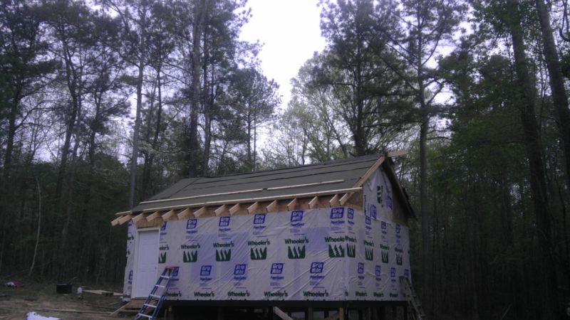

Trying to decide on what to use for siding...ideas welcomed BTW red metal roof...pics soon
# Posted: 19 Feb 2014 10:32pm
Go green on the roof, I did it to hide my place. I didnt want to be found.
Siding, with OSB already on there, wrap it with some Tyvek and use planks. In fact, Hardi board cement. Great for forest fires and the planks are so easy to work with vs a 4X8 sheet. The cement board id a bear to cut, use a diamond blade and wear a mask, do not breathe in the dust (silicosis disease)
http://www.jameshardie.com/homeowner/products_siding_hardieplankLapSiding.py
I helped a buddy install the Rustic Cedar and he bought hsi with a line on it, the line was for reference to set the next plank on to keep it square.
It looks nice when installed and painted.
# Posted: 20 Feb 2014 07:22am
I used GREEN metal roof....u don't want PINK metal roof after 15 years...>LOL. the green roof keeps ya under the RADAR
I went with Hemlock board and batten siding for my southern cabin ( is was custom cut in NC for me and bought of Craigs list)
I also bought the hemlock board and batten at a saw mill in the great north woods to do my northern camp...
BTW~~the wood borer bees DO NOT like Hemlock..which is great for the south

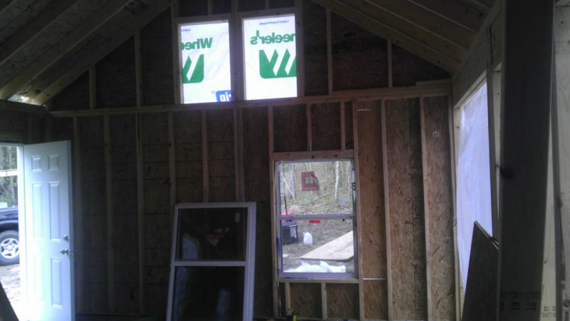

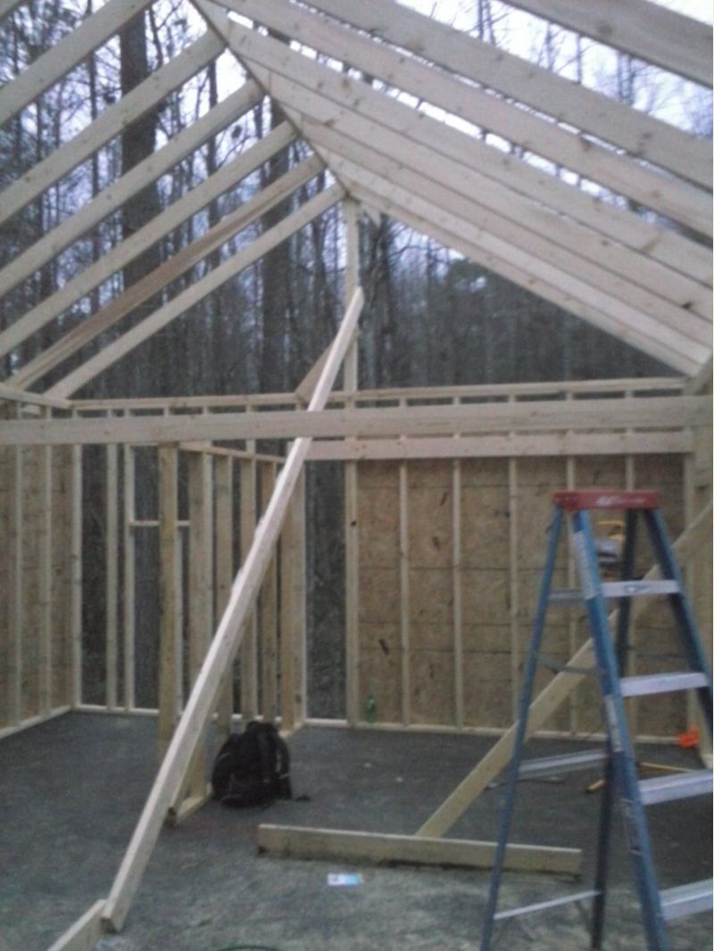

Been a while, been to busy to post, well here's were we are now, just waiting on more money to flow in...lol. the cabin is now a 16x24 with 8x24 going on back for bedrooms.
btw kitchen on right,bath on left, loft up top. made the windows small in the loft so someone would not fall to their death tying there shoes...
redbeard
# Posted: 17 Apr 2014 08:48pm
..will be t&g vaulted ceiling on this end, loft in the other,with stained glass my wife is making for these top windows

Is it my imagination or is the roof ridge line bowing down?
BaconCreek
# Posted: 15 Jan 2015 07:17pm
I think it's the color of the background and the tar paper on the roof.
