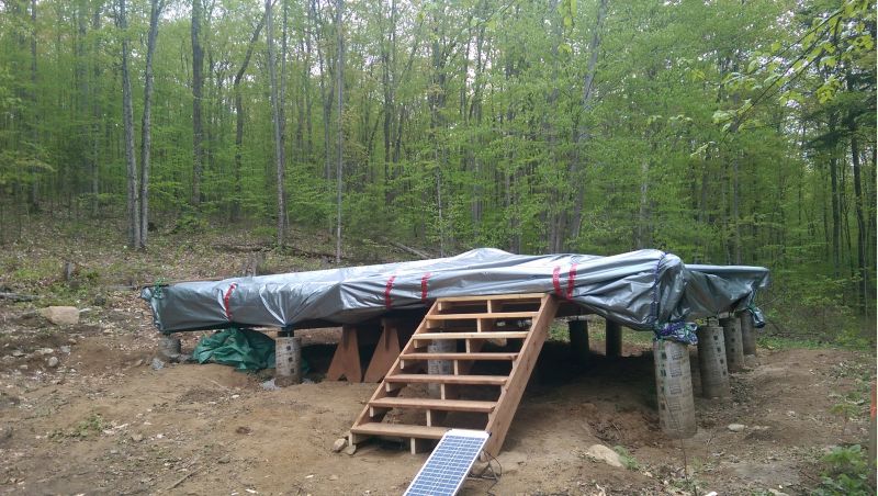

fitzpatt
# Posted: 12 Jun 2017 01:22pm
few more

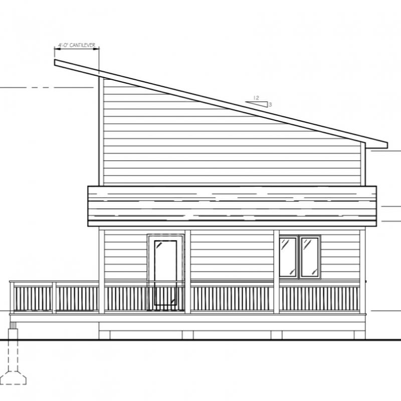

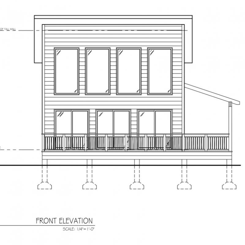

Hi Toyota, how can you tell? You are very close! The design will look more like the Mackenzie II, but bigger and with more windows. Please see below a screen capture of the front and side.

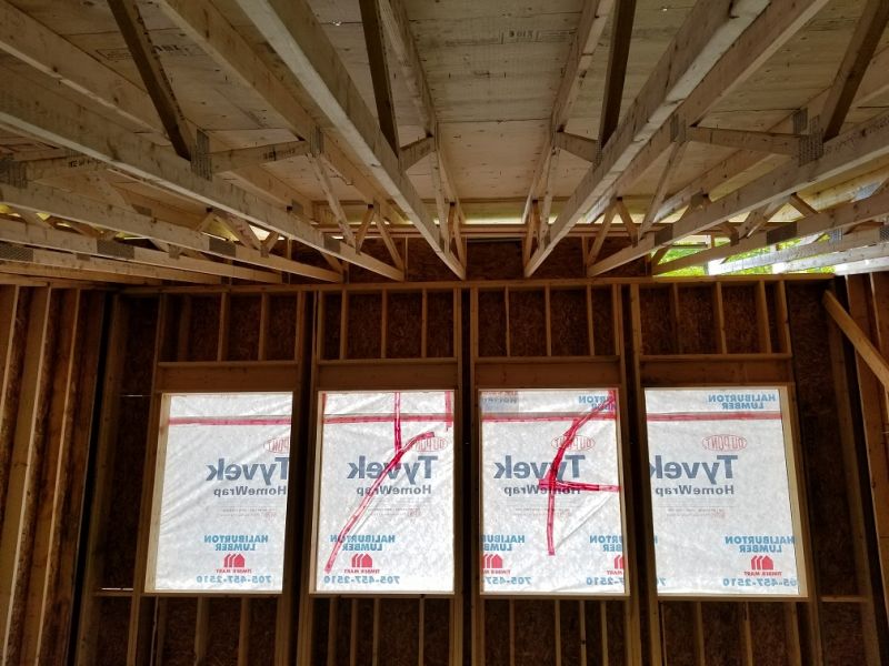

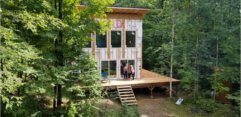

fitzpatt

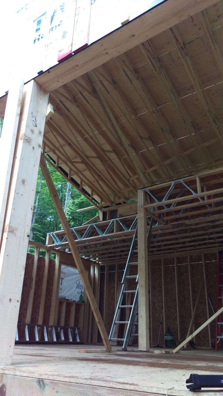

# Posted: 8 Aug 2017 09:10am

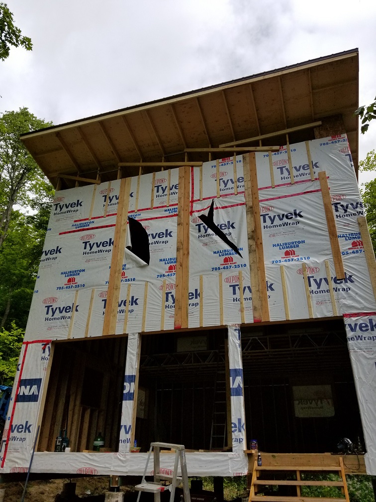

We spend a week in the woods and got a lot done. The steel roof is on and the cabin is safe from the weather for the most part. Windows and doors didn't arrive on time so we will have to wait to install those.

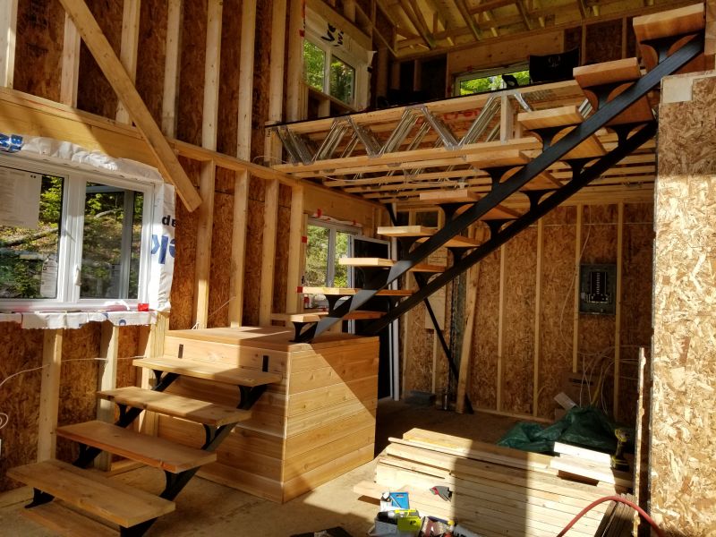

# Posted: 27 Sep 2017 11:04am
Installed stairs last week.

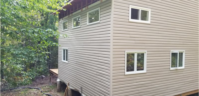

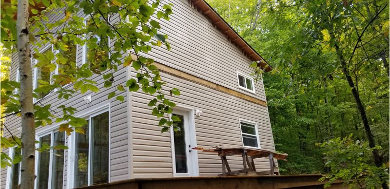

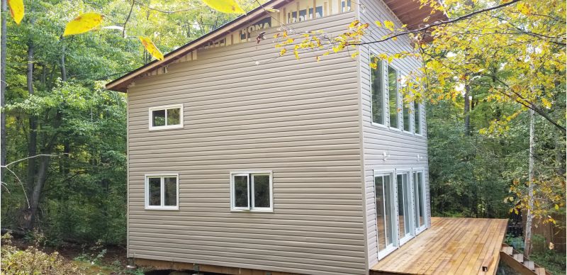

# Posted: 12 Oct 2018 08:47am
Finally got most of the siding up

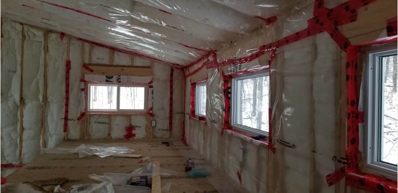

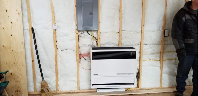

I was up at the cabin last weekend and winter has already made an apparance. Luckily I managed to have a direct vent propane heater installed along with some tanks. I also completed the roof insulation and the majority of the plastic. The next stage, before I have to return the scafolding, is to install siding on the ceiling. I planned to use 1"x6" tongue and groove pine. Have it delivered and then apply a white wash/pickeling, prior to instalation. Was wondering what experience others have has with T&G pine on the ceiling? In the bunkie we used some really cheap /narrow pine T&G on the ceiling and noticed a lot of bowing. Would appreciate hearing from others and what they have used and their experience on finishing their ceilings. Thanks!

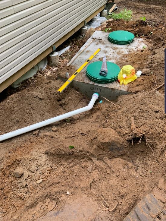

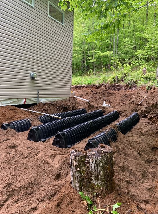

# Posted: 12 Jul 2019 10:03am
Got the septic installed! My wife is happy. Also, a bear came to visit. Best I can tell is that he can smell the mice in the tool shed

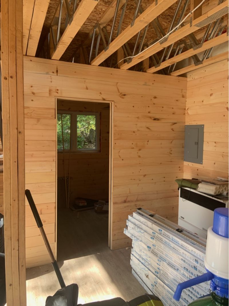

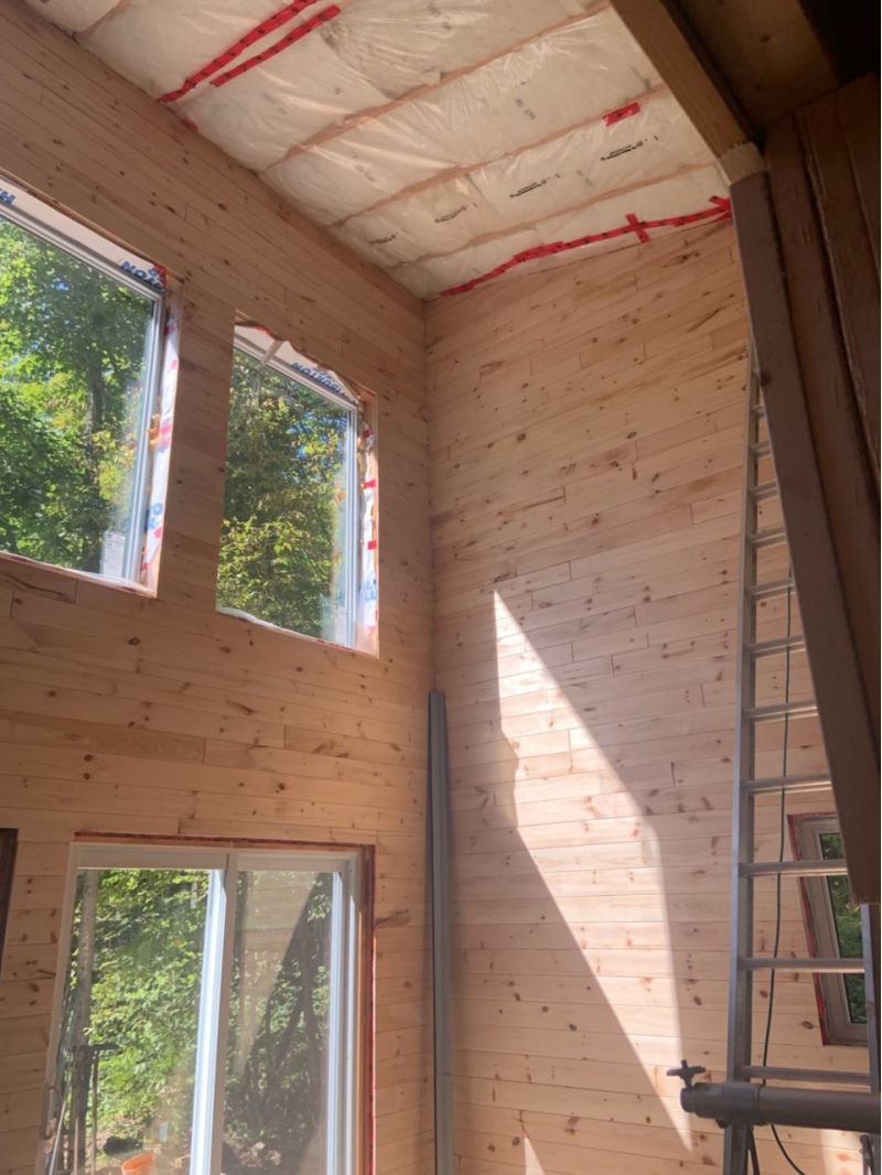

# Posted: 11 Sep 2019 03:53pm
another udpate. The interior siding is almost complete. I have hired a local to help get this finished. He does great work.
