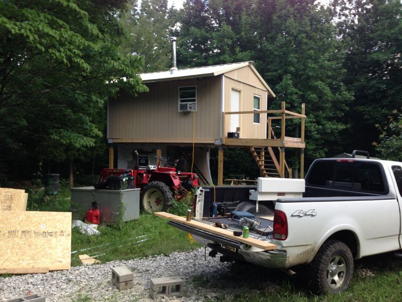

 It's a little screwy looking because I didn't originally plan on such a big 2nd story.  This isn't the best photo, but the shed is flush with the back of the 2nd story.  The posts are 6x6's resting on bedrock about 3' below the surface and set in concrete.  The a/c is running off a generator.  I still have lots of to do's.  My solar panels are currently leaning against the deck rail, I need to get them mounted on the roof.  I also really need to get the eves installed.
 I can easily expand it by enclosing more of the bottom area or attaching lean-to's to the bottom.  I'm seriously thinking about a large lean-to on one side to store the tractor and it's implements.
 One side benefit of being so high off the ground (so far) is that I haven't had any mice in it.  I've got metal sheet wrapped around all the beams/stairs; but still need to do that to the top of the shed inside/outside.

 that is cool. nice looking setup. and great tractor. an appropriate "cough mf rules cough" colour.

 The picture has me wondering what keeps the upper story from wiggling / wobbling in the breezes.  I did read 6x6, three feet  in ground, on bedrock... But what gives the tall posts lateral stability?  Maybe I can't see that in the picture.

 Lateral stability in the back comes from it being strapped/bolted to the 10' x 10' concrete block shed (I filled the corners with cement and implanted bolts in them).  It has survived some pretty strong thunderstorms, but hasn't seen tornado force winds.  The surrounding hills are a bit taller then me, so it's a little protected.  That said, when the kids really get wrestling, it did have a bit of wiggle up front where it's not on the shed.  That was before I tightened up the bolts securing it to the legs due to wood shrinkage.  I will still probably add some cross bracing just to be safe, probably a 45 degree piece to the leg about 4' long on each side.  That's on the to do list, along with installing eves, finish weatherproofing the windows, ......  It has an element of cross bracing today with the 2x12 for the stairs bolted to the front post, but it needs another cross piece tying in the other side.

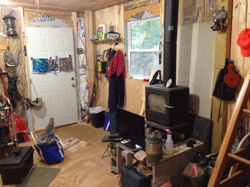

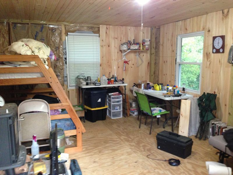

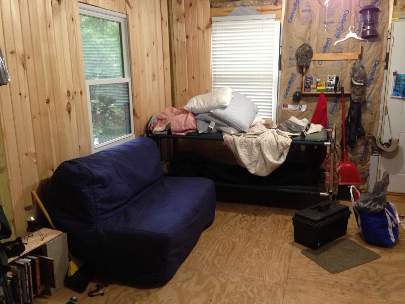

 Attached are interior pics.  I was finally forced to instal the tv/dvd to keep the kids occupied on rainy days and at night so I could get work done.  This is a summer picture, I'm not sure where the tv goes when the stove gets fired up.  The walls are about 70% paneled.  After the paneling, I'll tackle the floor.  I'm thinking a few tile by the door for wet shoes/boots; then douglas fir (or whatever I can get cheap that doesn't move too much).  Windows and stove are from Craig's list.  That can be save one a mint when you aren't picky about looks.
