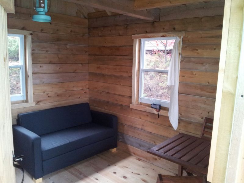

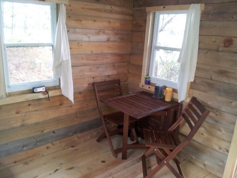

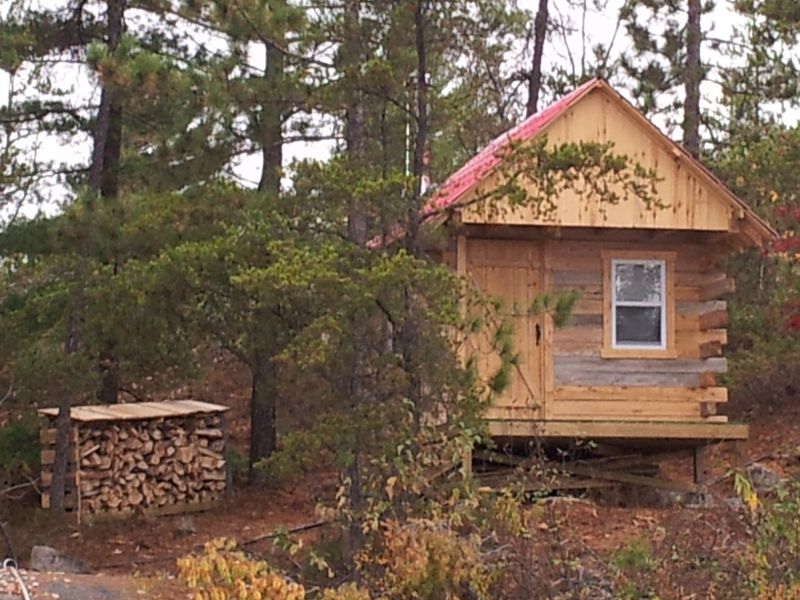

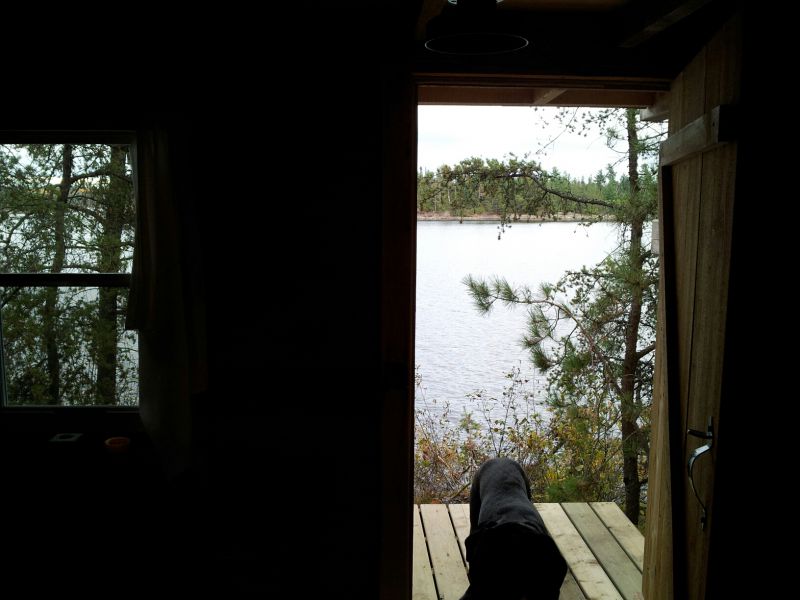

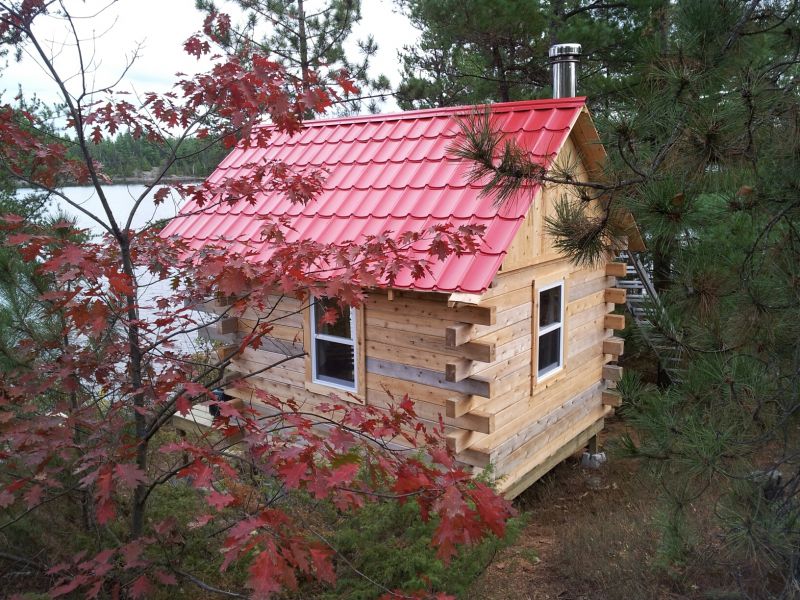

Here is a little cabin I built over the long weekend in sept..finished it up over the last few weekends...

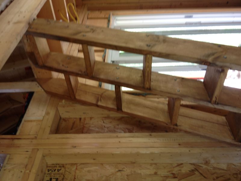

few more pics

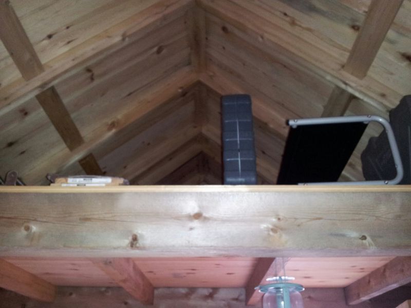

loft

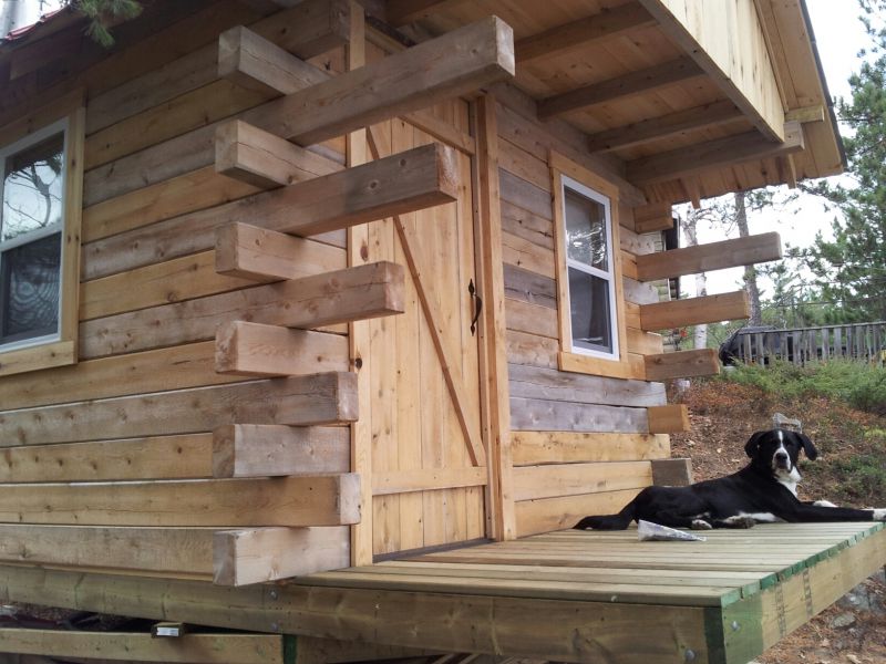

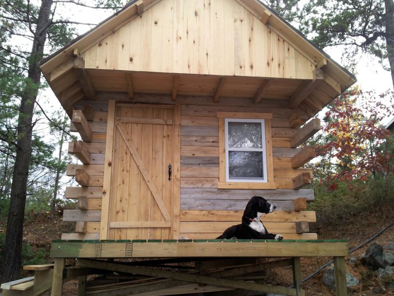

It's gorgeous. Love the red roof and the first pic.
Where is it? (so I can come and visit ;) )
Your door Z-brace is wrong
I'd cut the protruding logs in the front, just personal choice.

its in northern ontario...should the z be the other way? the angle goes the opposite way on the inside...yes I havnt decided what to do with those logs..have to decide where my stairs are going..just temp ones up right now

I really like the look of it with the overlapping logs. What size is it? I love your red roof. When we put our roof on it was a decision to make between red or green...we went with green to attempt to keep it hidden in the hills. It didn't work.....we still got broken into about three weeks ago and lost our air conditioner. I'm assuming someone stole it for scrap value. It didn't bother so much that they stole it as much as now they know where the cabin's at and "when will they be back?"
Anyway...I really like it. Old Old Buddy

Z brace should go down to the lower hinge, this way the door sags less over times under it's own weight.

The cabin is 10X10 with a 8x10 loft.

Is that the dog's house? If so you guys up north better never let American dogs know you guys treat your dogs so well. That's one fine looking dog house.
I kind of like the uneven boards on the front porch that way. It give is character.

Great little cabin. What size logs are those, 4x6? Are they spiked together? Also, I think I see some chinking or caulking between courses - what did you use?
I like the roof pattern too.

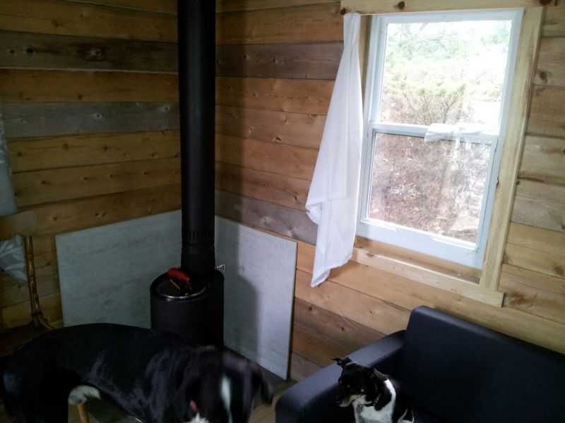

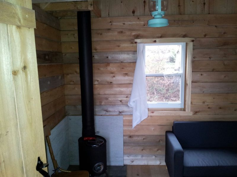

Are you going to space the cement board behind the stove out from the wall?

Correct 4x6..the logs have 7 inch structural screws where I felt needed plus every course is pl'd..I'm caulking every course on the inside with your standard beige premium caulking..not needed everywhere but for aesthetic reasons...outside I will use a permachink or sascho product..seals it up just a bit better..I've cut copper water pipe to make my spacers for the cement board just not installed as I've run out of caulking and want to do behind first..I've done one 6 hour burn and seems to stay cool enough just leaning on wall...stoves only 5-6 inches away..stove pipe is double wall no worries there..

Great cabin. What is the width of the overhang & is it not factored into the 108 sq.ft building limitation in Ontario? Is it only the footprint of 10 by 10 that is meeting the building code? Am planning to build similar plan in Ontario next year.
davey25
# Posted: 23 Oct 2013 11:29am
Im not really sure if overhangs count or not..it is about 4 feet, Im lucky there wont be any building inspectors having any looks haha
