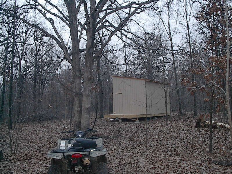

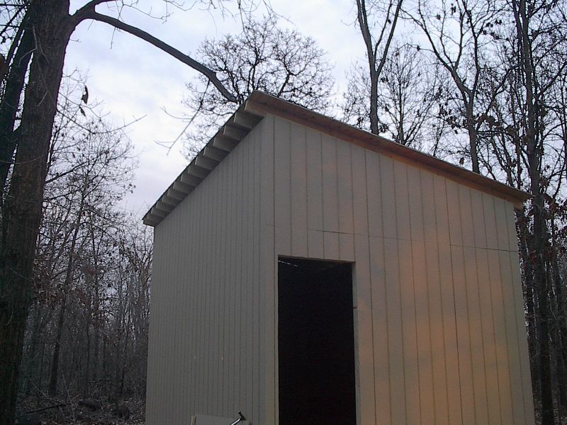

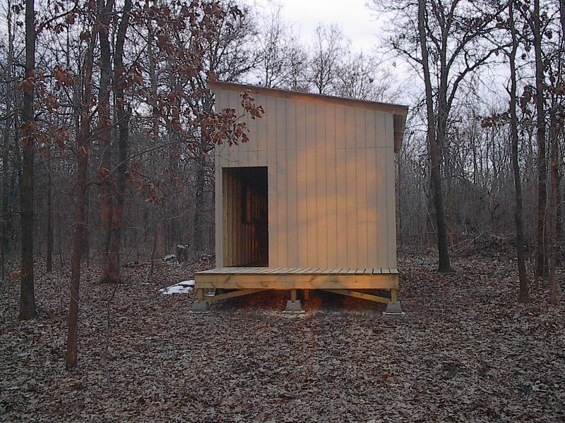

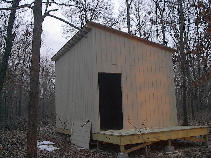

Building a new cabin in western Missouri. It's a 12 X 19 with a 5 foot deck. I will be putting a roof over the deck and I will install a loft at around 7 feet. I'm going to have a small bathroom 4x4 inside, but no running water. I will most likely use a portable toilet with a vent. I'm planning to wire it for a generator since electric is 1/8 mile away. The high side wall is 12.5 feet and low side 10.5, so I will have plently of head room for the loft. I also plan on installing a wood stove for heat. The roof shingles will be going on this week. I will send more pictures with the progress. siding_and_roof_002..jpg

keastvol, Nice work, Did you or are you planning on insulating the floor?
I notice the pier blocks under your porch, what did you do under the cabin?
Thanks for sharing, I look forward to watching your progress, your cabin is about the same size I will be building soon.
-Keith
keastvol
# Posted: 21 Feb 2010 08:10pm
I used 9 pier blocks to support the structure then I added 6 aditional 4x4 post dug to 24" and poured concrete for a total of 15 support posts. Right now I am not planning to insulate the floor, but If I need to I can still get under it to do it. It does not usually get that cold here in Missouri.

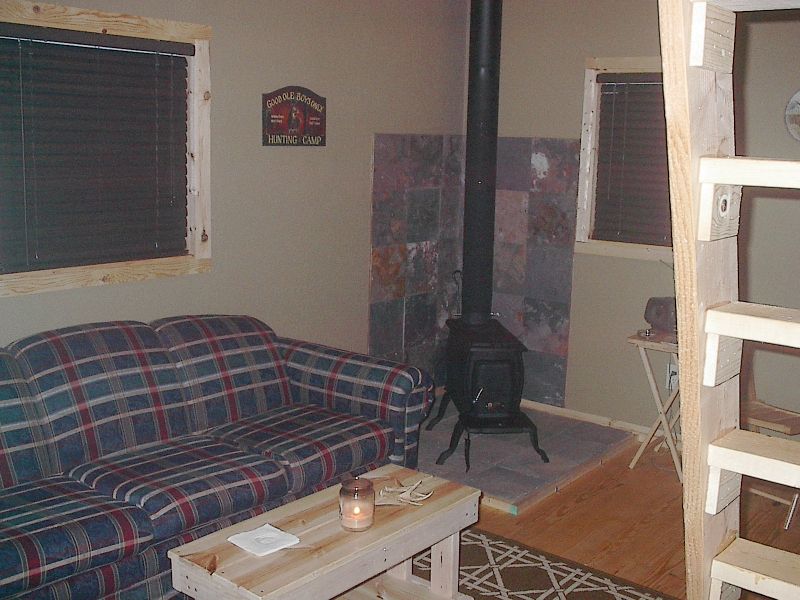

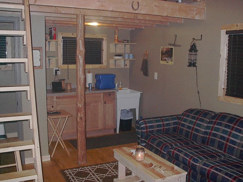

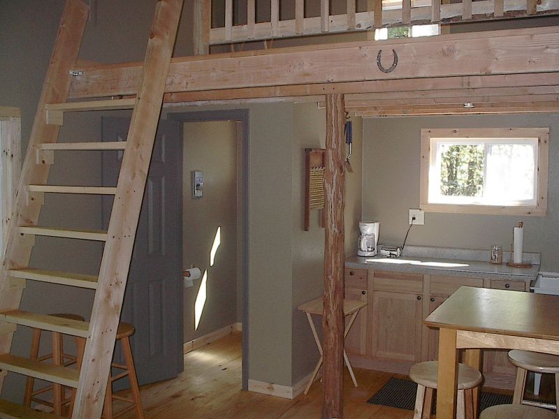

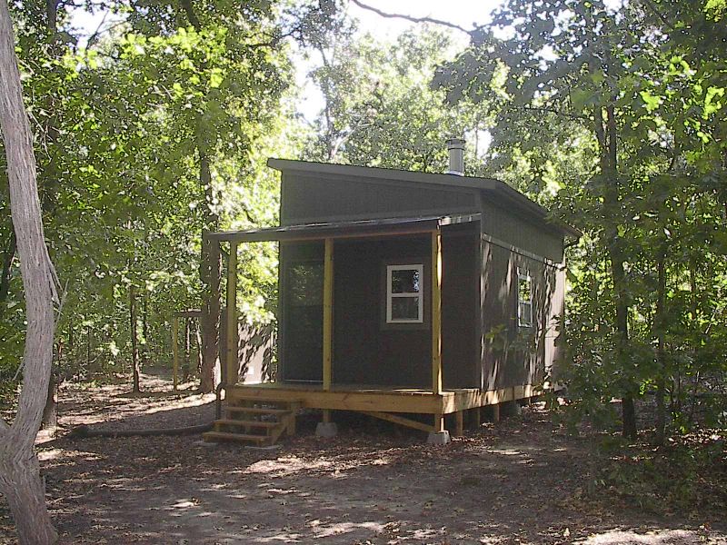

The cabin is done.
keastvol
# Posted: 17 Jan 2011 02:25pm

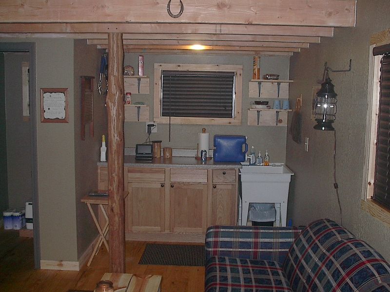

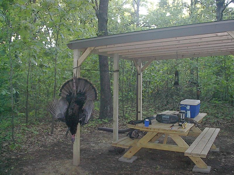

Very nice keastvol! Lovin' the porch as well as the gobbler. We usually try to go to Mo every year during the spring turkey season. You guys truly have a hunter's paradise there. Keep the pics coming.

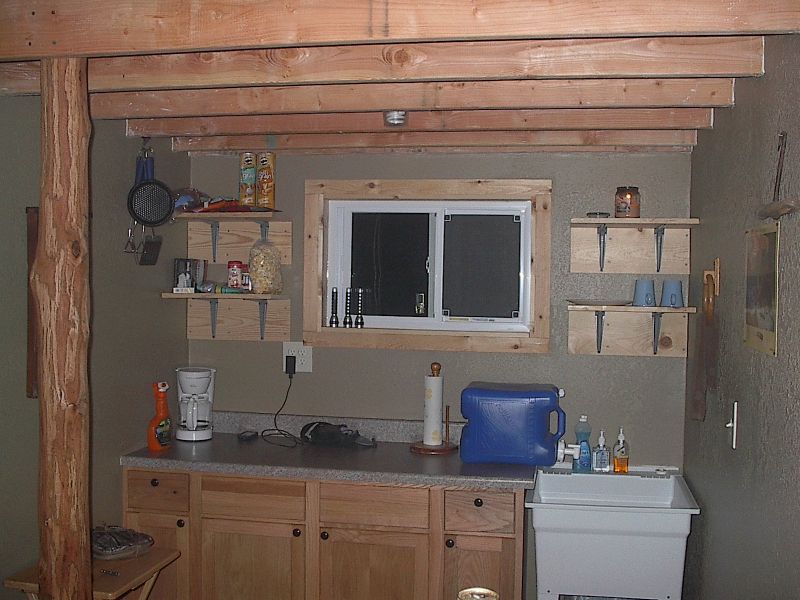

Very very nicely done. Really like the pine trim, and the utility tub on the end of the drain board is a nice touch.
Great work!

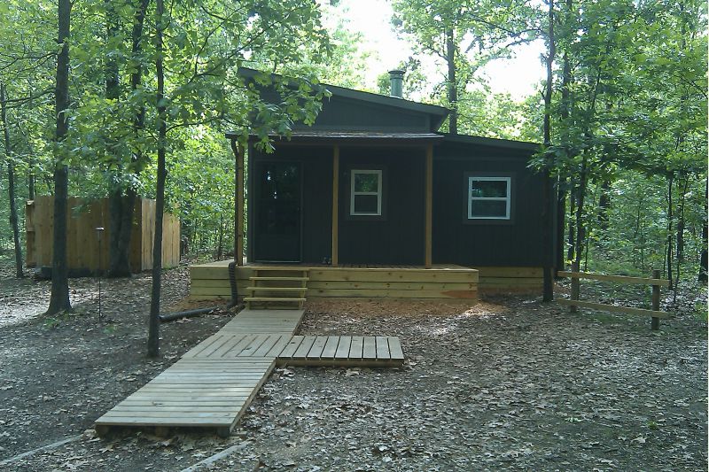

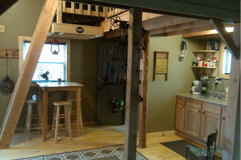

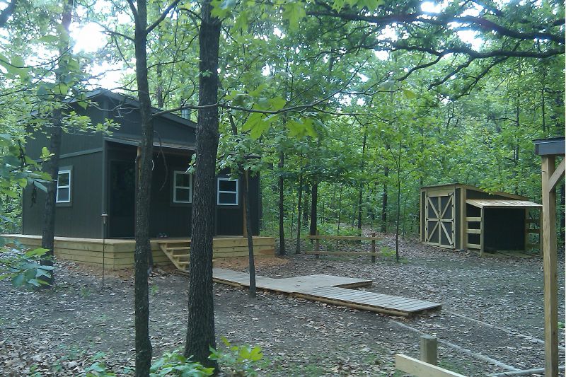

Updates to the cabin. I added a 10x10 addition and built a shed. I also enclosed the posts with 2x6 deck boards to keep the rabbits out. They were chewing on my foundation posts IMAG0217.jpg

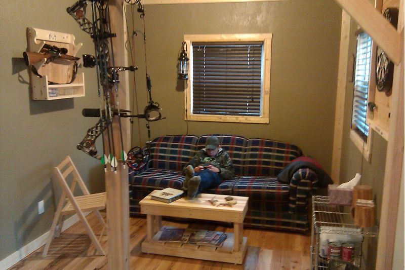

Nice Cabin! You wouldn't happen to have anymore pics of your coat rack next to the loft stairs would you? I am building one for my buddies cabin that we are building and looking for more ideas. By the way nice Z7, I have the extreme and love it. Brian
