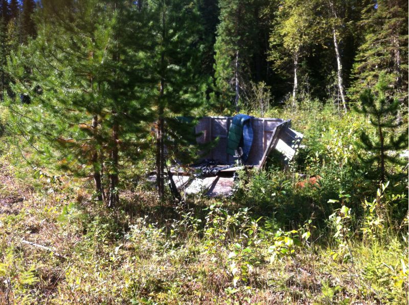

| Danielcan Member
 | # Posted: 5 Nov 2013 07:38pm Reply
 Malamute, your right, the cabin is limited by the size of the metal sheet I dig out of the slash pile. I know it's eight feet by at least six, but I'm sure it will be longer. Perhaps much longer, or I might find two. Also, I will be building this thing alone so I want manageable sized logs.
 My reasoning for notching into the top of my split foundation logs is to leave my sill logs intact (save for the small step in the side for the floor boards). That way every few years I can prop up one end of my cabin with bottle jacks and replace the foundation logs with new ones, or concret blocks. I want the sill logs to be as structurally sound as possible for that. The idea of the V notch as opposed to a fitted half circle is to facilitate drainage. Perhaps I should line the V notch with some sheet metal??
