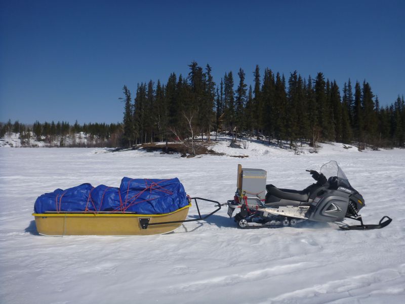

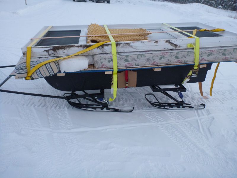

Made another trip out yesterday. I have been fretting for nearly a year about how to get the windows out without breaking them, especially the front window that is 9'3"x49". I was successful....of all the windows only 1 pane was broken...and that was when the bush pilot moved my truck to load a couple of the small windows into the plane.

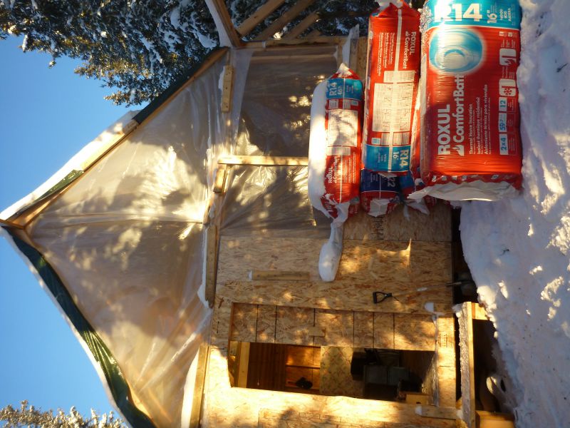

It was -25°C yesterday with a bit of a wind. (BTW, you can type a ° by holding down the ALT key and typing 0176 on the keypad). It was manageable but I was underdressed and got quite chilled by the end of the day. Without insulation the woodstove doesn't do much to add heat to the place. I started stuffing the eaves with insulation and it helped a bit....but getting some walls insulated in the next priority. I also ordered the metal for the roof today too!

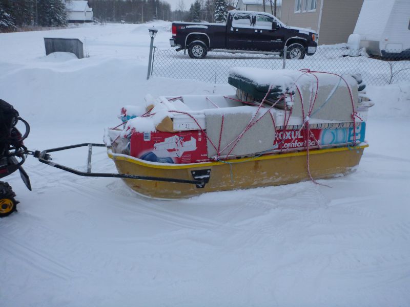

One load
One load
Last Window!
Last Window!

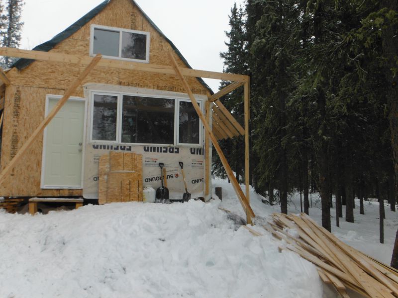

Here are a few photos a buddy took yesterday while we were working on the cabin...about another 900 lbs hauled out....door installed and front wall closed in.
Cabin Photos
I have decided I will definitely be closing up the loft and putting in a hatch (two hatches actually...one for a steep staircase and another smaller one above the woodstove (to allow heat up and to check on the woodstove). I will probably use strong magnets on the hatch panels to allow them to stick to the sloped ceiling when left open.
Next trip out I should have a few windows in. I ran into an issue this time...took off the top piece of stovepipe (above the roof line) and knocked all the snow off the roof. When I lit the fire all the smoke was dumping into the cabin. I didn't realize that the stovepipe had filled and packed full of snow. We had to pull the pipe apart, clear the snow and reassembly while the stove was smouldering....lesson learned for next time.

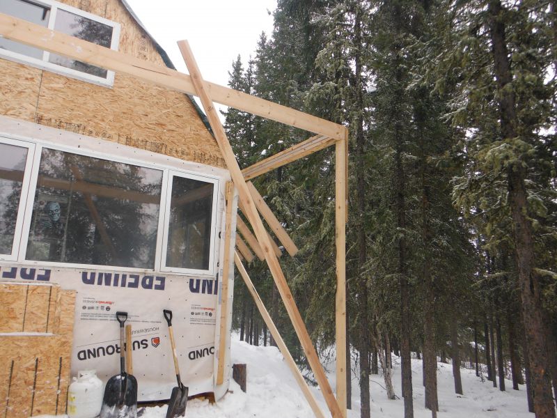

I spent another 3 nights out there this past weekend. We got the rest of the roof trusses up and got the tin on one side. Of course I booked off the entire week to go to the cabin because it is spring and should be nice warm working weather. It was windy and below -30°C on the day we put up the tin. It made for a harsh day...but the one time I hit my finger with the hammer I didn't feel it until my hand warmed up .
The 12:12 pitch also made it interesting to get the last piece of tin on....I rigged a rope harness and had a buddy belay me down from the peak screwing as I went...it actually worked quite well, but I did build a roofing ladder for the other side.

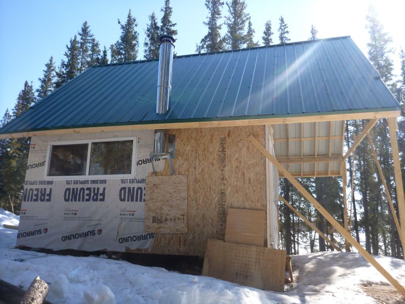

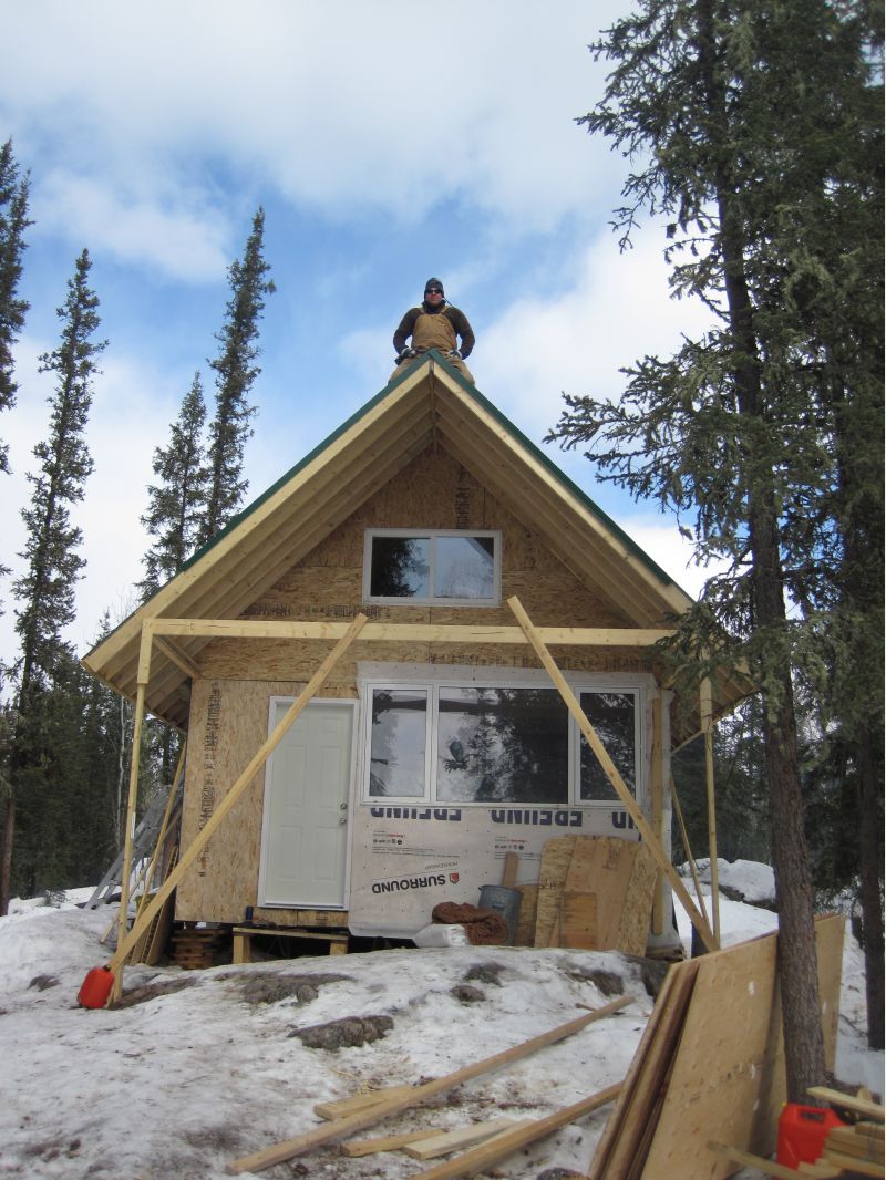

Well....today is April 13th and barring a good snowfall I think I am done for the season. I shut the camp down and put up the bear boards. Shouldn't get back there now until summer. I managed to get the roof on, but barely had enough screws..thankfully I counted partway through the day and realized I had to cut back. The trail is getting icy....melted the sliders a bit on the way out on Friday but I put bolts through the skis on the way home and it help quite a bit (scrapes the snow up).
Roof is on, new chimney is in. I also have a load of materials out there so I can do some more work this summer while I am there, though now that it is closed in the pace can slow down a bit and I can enjoy my time a little more. Not bad for 2 seasons work though. I sometimes forget that I just started shoveling snow out of here last January!

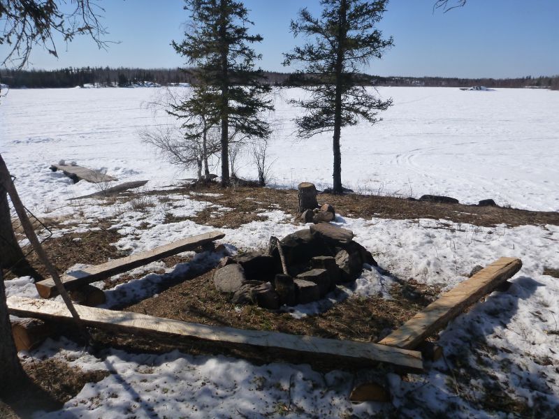

Fire Pit
Fire Pit

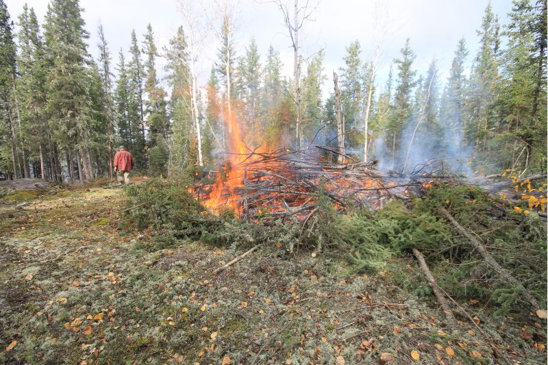

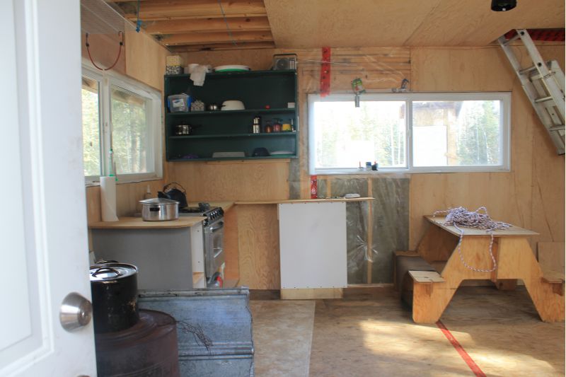

Well, I figure it is time for another update. We made it through an epic forest fire season. I have done a pile of fire abatement work and more will be done this winter. We made it out to the cabin once in the summer and again in the fall for a hunt. Outhouse was put in, the insulation inside was mostly closed off and a lot of paneling done on the inside. I am very happy with the decision to close off the loft and turn it into a complete floor....it seems to be controlling the heat much better. I will have a better sense this winter when the wood stove is going good.

Fire abatement behind the cabin...I am building a helipad too.
The inside is coming along.
