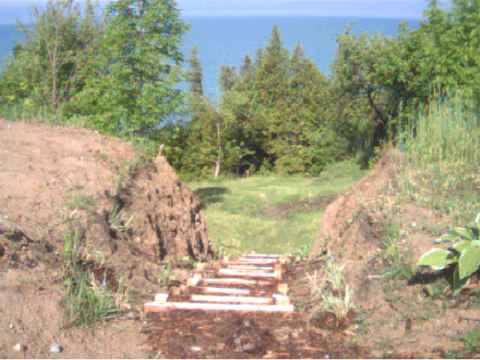

# Posted: 22 Nov 2013 06:19pm
built these years ago , not the best pic but all I have . I used a 2x10 on its edge with a 2 x 2 treated stake on each side .with gravel in the pocket created. worked for me.
