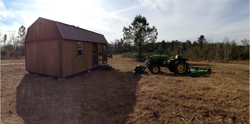

Lucky7matt
# Posted: 9 Jan 2014 09:29am

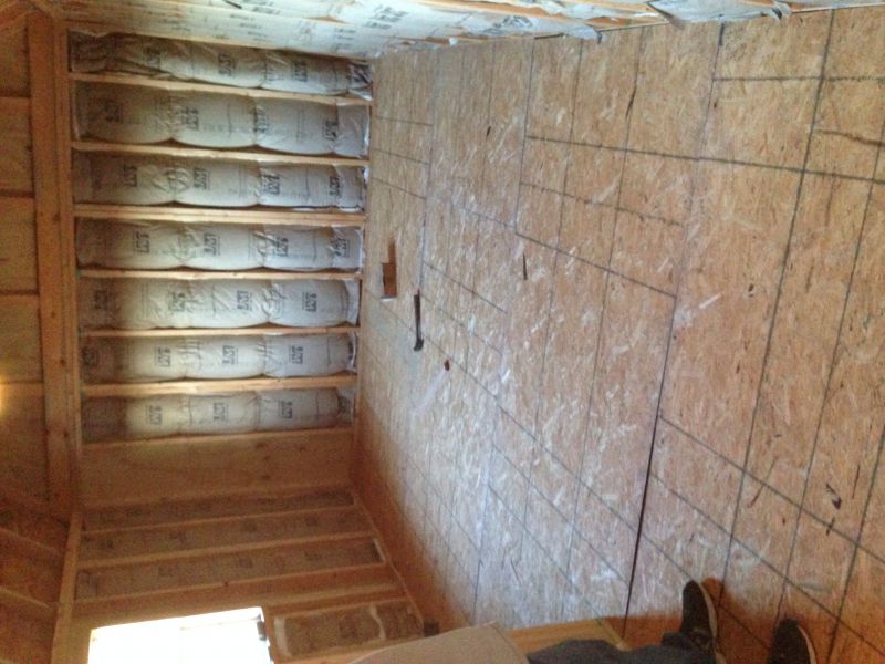

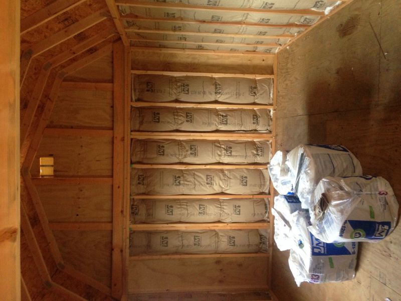

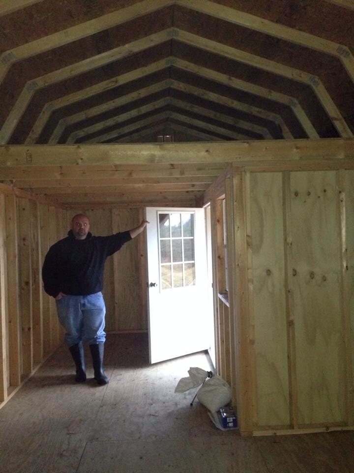

  Well I didn't build this one I bought instead. Something for me and my kids to go hang out in and enjoy the quiet on the weekends. I started insulating it. Got a little more to do. We are enjoying it so far!  image.jpg

# Posted: 9 Jan 2014 01:38pm
  Looks like a fast way to get a useable building. Unfortunately that roof wasn't designed to be insulated, so if you stuff it full and then put wall covering on it (Sheetrock, T+G) you risk condensation and mold in there. Do you plan to put in ceiling joists and ventilate the attic, or insulate the roof as is?

  I can't give you any info on the insulation. We put 3 and 1/2 inches in our ceiling but we stapled it to 2X6 rafters so it had about a 2 inch air gap as it is right now. We have a metal roof and haven't finished the ceiling but havce had no condensation issues yet. I guess if we would have stuffed six inch insulation in....we would have....maybe. Since you have 2X4 ceiling joists, you could use about 2 inches of styrofoam and that would give you the air gap you probably need. As I say....I'm not an authority on much and certainly not insulation but I just wouldn't want you to get upset ....thinking you didn't have any options.

  I didn't think about that. I am glad you mentioned it. That kind of changes thing for me I have to do some thinking now.

  I thought about using some of that styro board to put up there just to have a little something up there. Now I am not so sure. It doesn't get to terribly cold that often, but I do have a wood burner. I am not sure if I am going to put it in just yet or not. I am going to have electricity run out to it. More pictures coming soon. I just got finished browsing your post on your build looking for tips and ideas, I really enjoyed it.

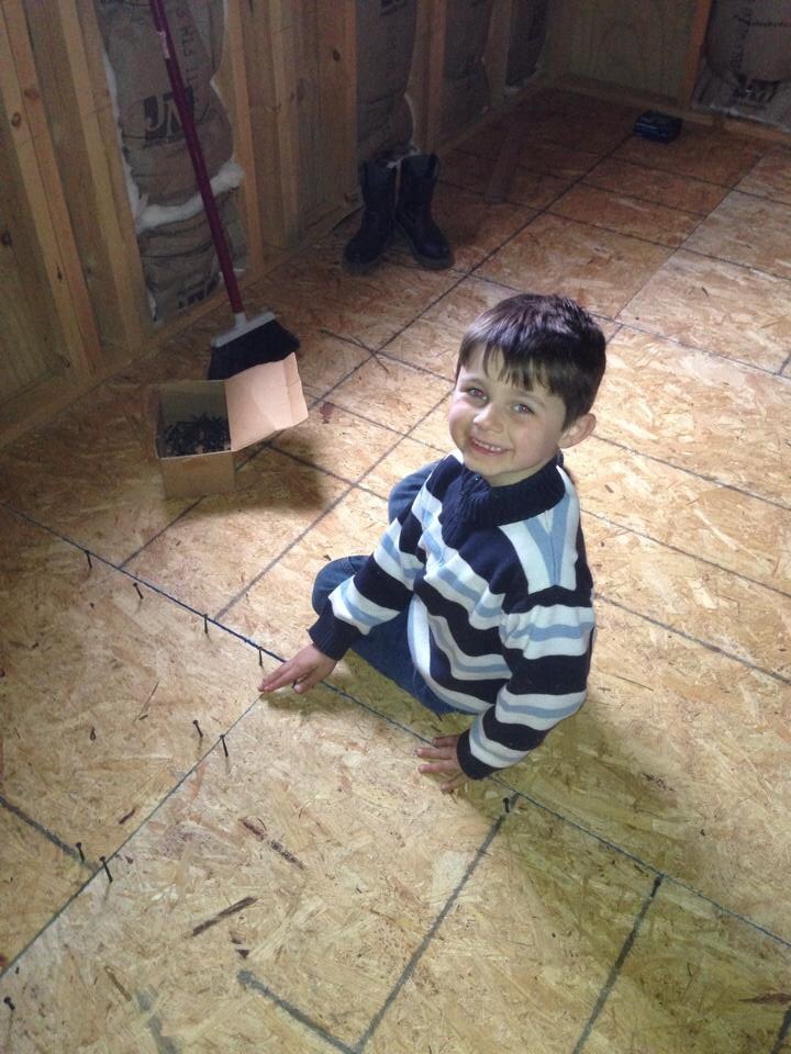

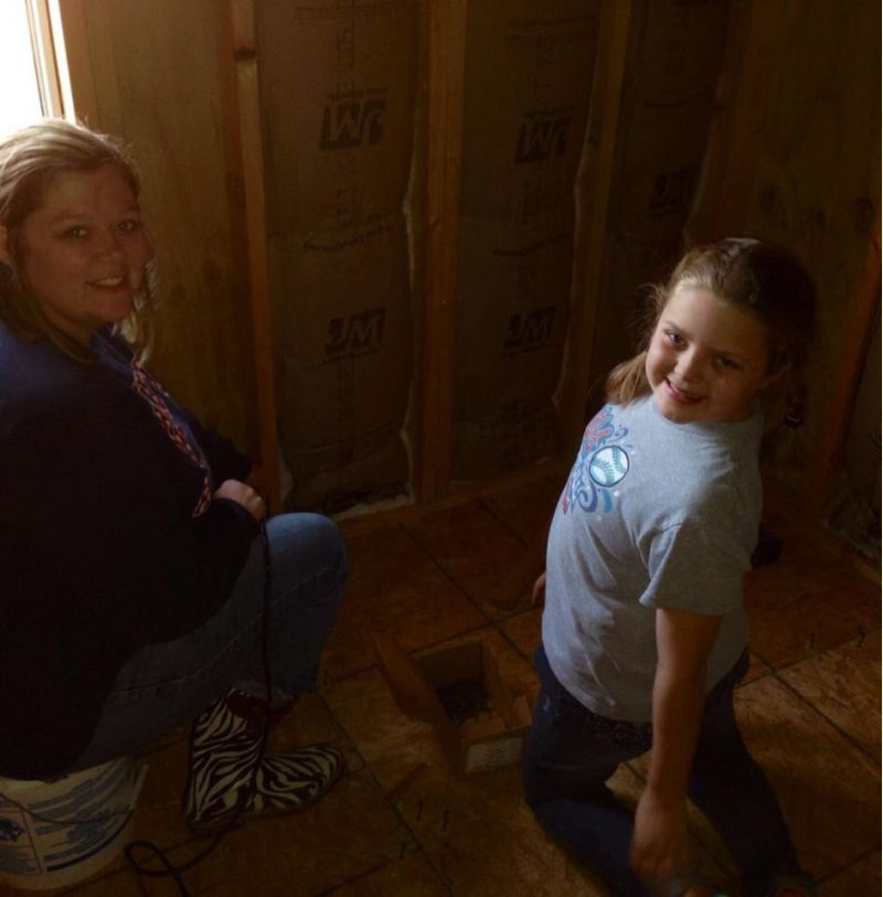

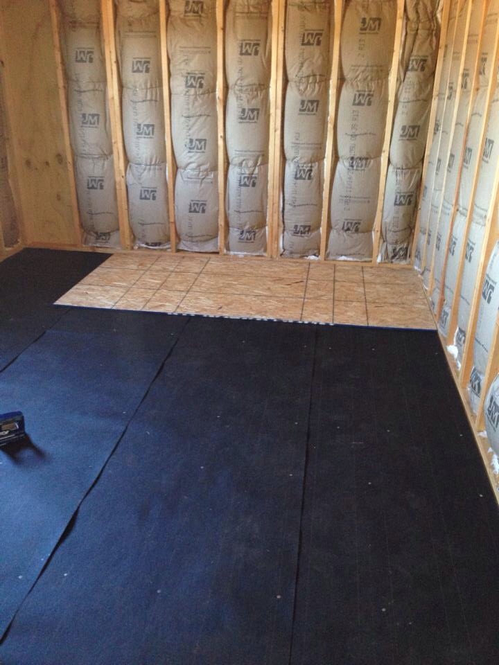

Lucky7matt
# Posted: 26 Jan 2014 02:15am

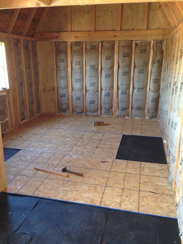

  We put down some roofing felt for a moisture barrier and some osb to strengthen up the floor.  Laying the floor
  |   My stepdad helping me out.
  |   Two heads are better than one.
  |   All in.
Lucky7matt
# Posted: 26 Jan 2014 02:17am
  The kids getting in on the action.
