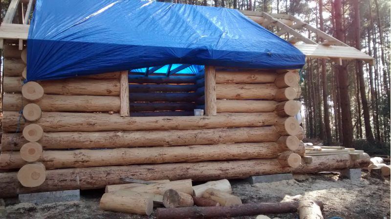

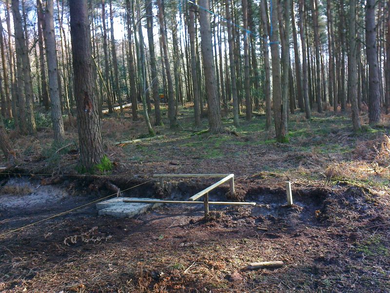

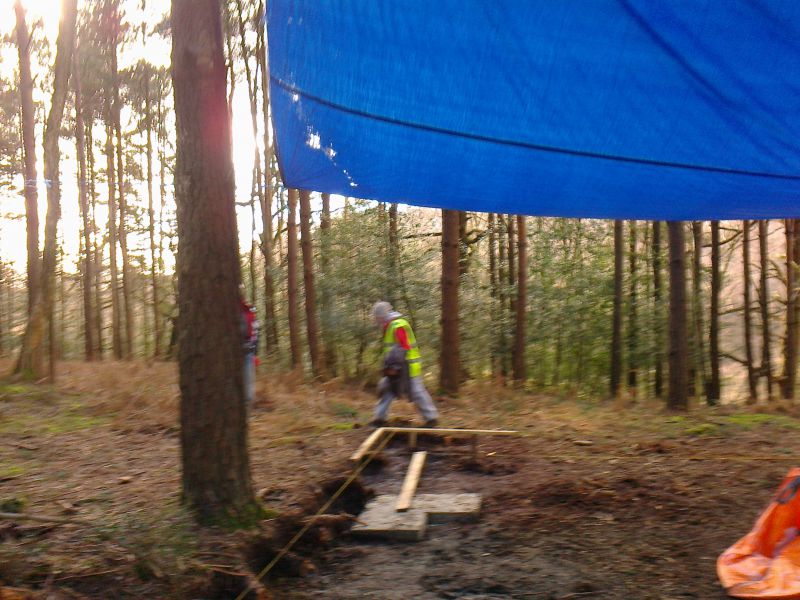

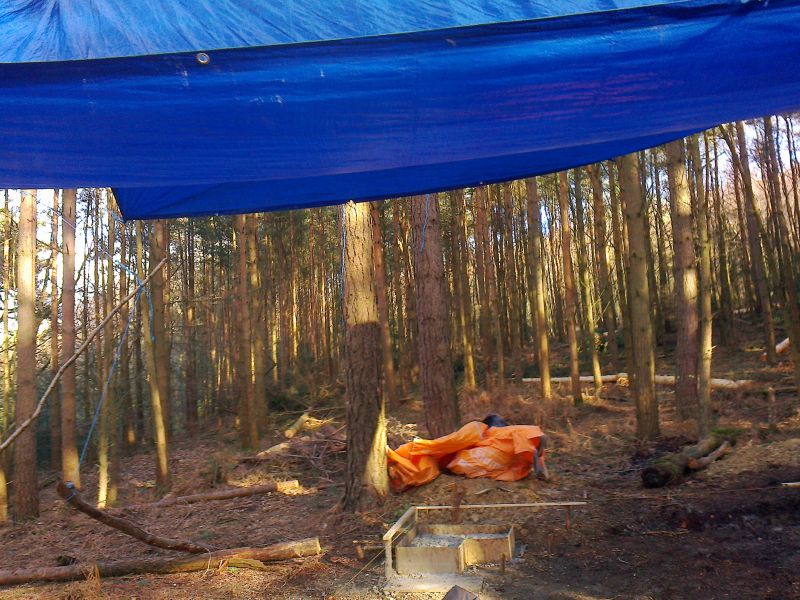

 Hi bldginsp, sill logs are on concrete. They dug four 1m square holes - one for each corner of the building and two additional smaller holes to support the end of each sill log and deck. They mixed concrete and used a form to ensure concrete was raised above ground and sill logs were level. I have attached a photo from earlier in the build where you can see the concrete but it doesn't do justice to how massive the sill logs are.
| Sarahax Member
 | # Posted: 25 Mar 2014 11:28am Reply
 Hi Bldginsp It's hard to tell from the photos because the cabin is on a slight slope. The sill logs are sitting on concrete. For the foundations they dug a 1m square hole at each of the four cabin corners, and smaller holes for foundations to support the ends of the sill logs and deck. They filled these with concrete and made forms so that the concrete didn't just fill the holes but stands proud of the surface. You can see the right-angled shaped blocks that they made by this process in these earlier photos from the build. Now you can just about make them out under the cabin.
 |  Foundations
 |  Foundations showing profile
 |  Foundations showing shape
 |  Concrete foundations under sill logs

 Looks very sturdy Sarahax. I'm no expert log builder, but I've read from several sources that its usually recommended to get sill logs up off the ground by at least a foot, more if possible, to avoid moisture. Wondering what your builder thought about that. Of course that increases the overall cost significantly, which may be hard to justify for a small project. What was your thought on that?
| Sarahax Member
 | # Posted: 25 Mar 2014 02:12pm Reply
 Hi it's about 9 ins off the ground on one side, but more on the other as it's on a slight slope. The ground has been cut out a bit but we know we have to make sure the sill logs remain clear of soil and debris especially on the side nearest the slope. I'll take some pictures when I'm there tomorrow. Hopefully that will give us enough clearance for the air to circulate around the sill logs
| bldginsp Member
 | # Posted: 25 Mar 2014 03:21pm Reply
 It's hard to see those clearances from the photos, but photos can be deceiving depending on perspective. Another question if I may- I see that the logs are not scribed, but stacked with slight gaps between. So obviously you'll be using chinking to seal it up. What does your Polish builder recommend to use for this?

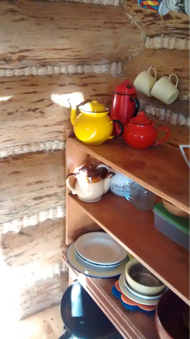

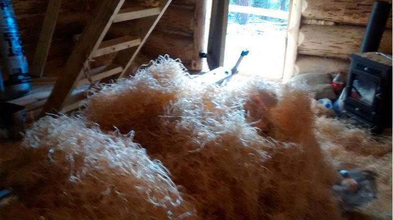

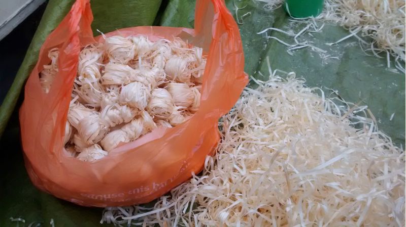

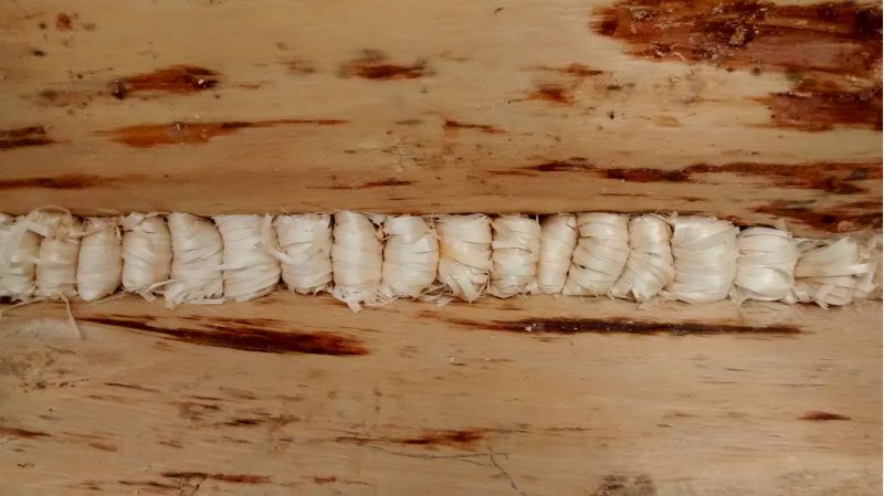

 Went to the cabin today to see progress. Slow. Each little bundle of bark strips has to be twisted by hand and then wedged in the gap between the logs, one from the outside and one from the inside. Team a bit despondent, taking longer than they thought and dreaming of chinking. We had a go and it's difficult and time consuming to get right. Each one chinks about an inch.
 Bldginsp - you know what you said about using pierogis for chinking? Bet they wish they could have taken up your suggestion. End result is beautiful, though.
 |  Pierogis? No, traditional Polish chinking.
 |  Bales of chinking material in the cabin.
 |  Front wall is partly done

 Yes, looks very good, and I'll wager that chinking does a good job of expanding to keep the gap filled as the logs shrink.
 Probably doesn't taste as good as a Polish pierogi, though.

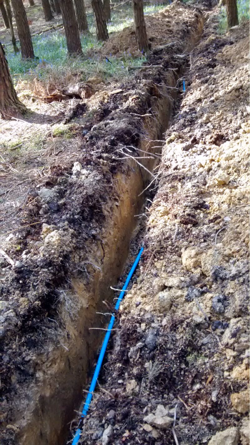

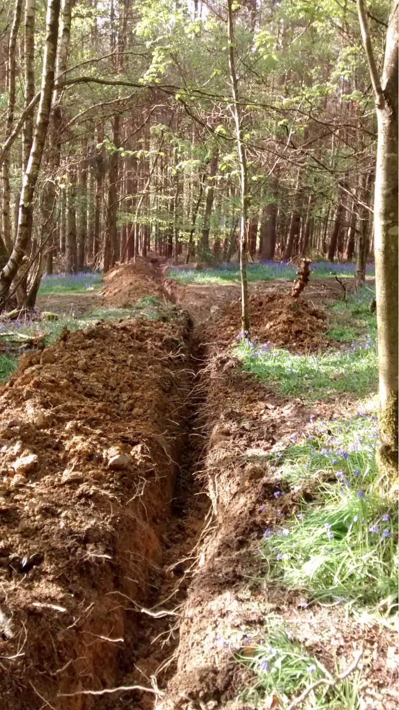

 Three walls chinked and only one more to go! We have been making chinking balls at home and taking them down to the wood for the guys to pack them into the gaps between the logs. Anything to speed this dull task along.  I can make 25 in an hour - but it takes 100 to chink a metre. Spent a lot of this weekend and seven hours on Tuesday making chinking balls. I worked out at one stage that we need more than 12,000... anyone for a chinking party?
 To try to prevent the cabin team from going completely chinking bonkers we hired a mini digger this week so they could have a change from chinking and dig a trench for the water pipe. Never seen a group of men so keen to dig a trench.
 Nearly there.
 |  Some of this weekend's work
 |  Here comes our water pipe
 |  The trench winds through the bluebells

 What's your water source?
 What are the regulations where you are regarding disposal of waste water, septic systems, etc?

 Water is mains. Am a bit hazy on regulations, as our structure is not a dwelling - our permission is for a forestry shelter for the purposes of managing our wood. More research needed! Officially we are allowed to stay overnight for 28 days a year. One of our next projects will be to decide on the whole toilet issue - but that's for another time, and doubtless we'll be coming back here for a lot of advice and guidance.

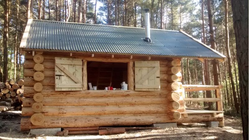

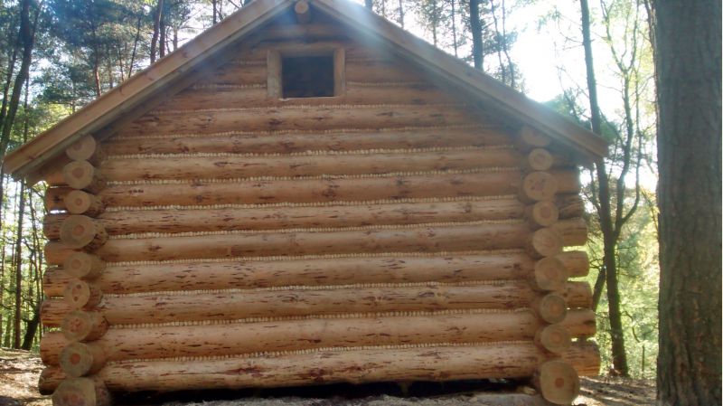

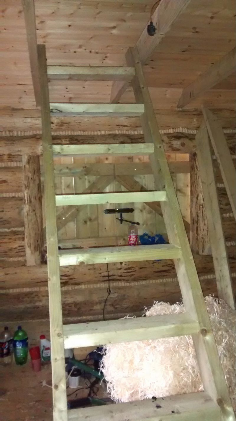

 Progress - the chinking was finished on Monday - hooray hooray! So the cabin is just about done. Kris has sprayed the whole structure with timber treatment - fire retardant and rot and insect repellent. This is a real relief as we were getting anxious that someone would come along with a box of matches over the bank holiday, particularly as the guys had left the spare chinking bales out on the deck. The woodstove is installed and sitting nicely on a ten quid sandstone slab from B & Q.
 We have given up on the French window retailer as the off the peg windows we wanted were never in stock.  Got a couple of quotes from English joiners - ouch! So Kris is making them as the final task and they will be fitted once he comes back from his god-daughter's first holy communion in Poland. Looking forward to furnishing and our first night there.
 |  Cabin shutters open
 |  Cabin interior
 |  The ladder to the platform will pull up with a rope and pulley
 |  The last wall chinked

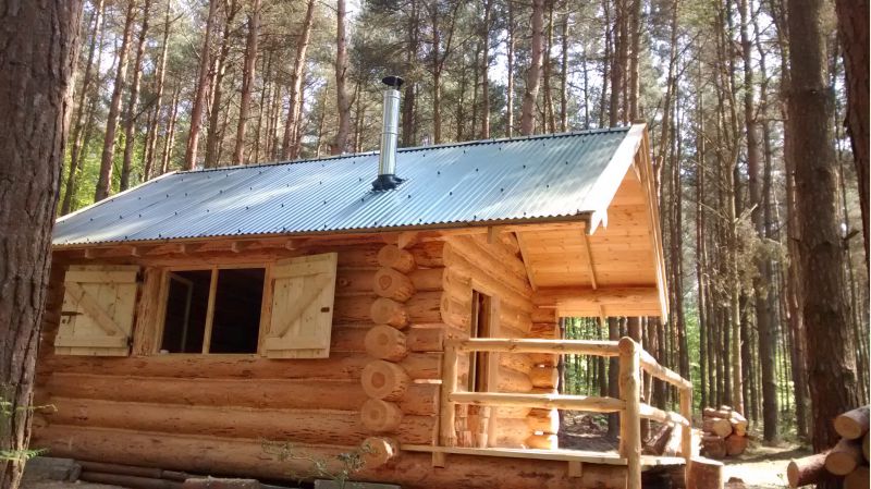

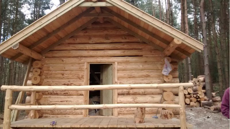

 On Friday afternoon Kris and Henry came striding through the wood with the windows which Kris had made in his garage. They are great! He had difficulty obtaining suitable fittings as English windows open outwards. With his usual ingenuity he used sash window fasteners, but fixed vertically. This amused us as we have exactly the same on our windows at home, except used more conventionally.
 And with the windows now fitted, our build phase has come to an end. We are so pleased with our cabin, but a bit sad too that this phase is finished. We have so enjoyed getting to know the Polish team and it has been a real pleasure working with craftsmen. As a thank you I'm building Kris a website to publicise his work as we can't be the only people around here who'd like a cabin. We'll have a ribbon cutting ceremony next month once it's all cleaned and spruced up and invite all the people who've helped for a drink.
 We were up at the cabin today as it was sunny. Didn't get much work done - too busy admiring it.

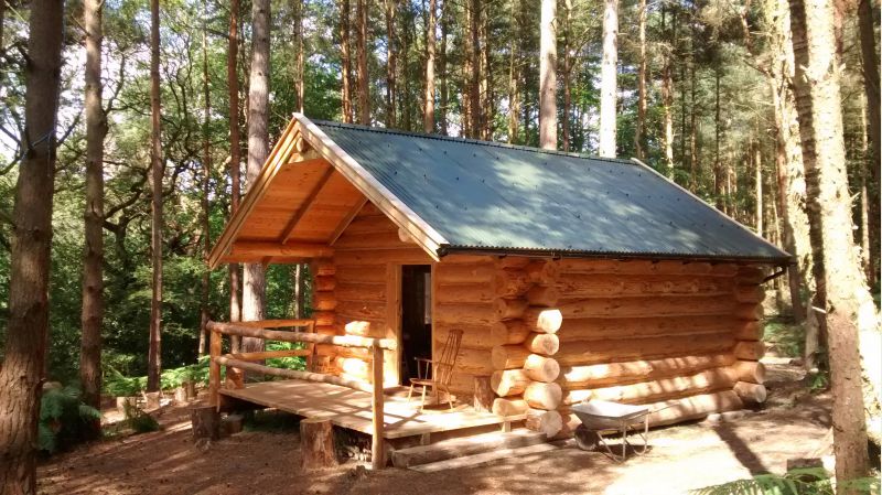

 Hi all - haven't posted in a while. We've been spending as much time as possible up at the cabin, then there's always that thing called work, not to mention the World Cup.
 Old buddy  - you are right - building a cabin is one of the most enjoyable things we have ever done. Time spent there just drifts away and we enjoy the wood so much more now we don't have to rush home as soon as it gets dark or looks like rain.

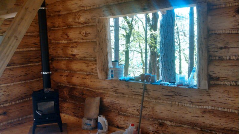

 Since I last posted we have been mainly tinkering- making it really comfortable. The biggest improvement is a long drop outhouse. Kris had already dug the hole the time I hired the digger. He built the structure over it in a morning out of four fence posts and some left over corrugated roofing. I did have to buy the timber for the door but the rest was made from odds and ends left over from the build.  The heart is apparently traditional in Eastern Europe. I just laughed when I saw it - looks so nutty in the wood.

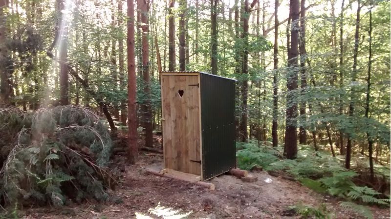

 We've furnished the cabin with all sorts of bits and pieces from home which were destined for the charity shop or freecycle. We have a bathroom area (washstand with jug and basin) kitchen area (wide shelf with camping gas stove, tap and washing up bowl), two sets of freestanding shelves for storage, a table and three chairs (one each and one for a visitor) and two comfy chairs for sitting on the deck or in front of the stove. It's great to feel that we have exactly what we need -and no more.

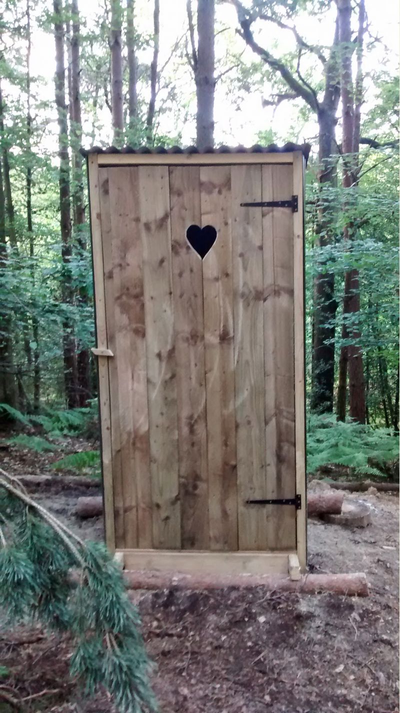

 On the day of our official opening it absolutely threw it down with rain, which was a bit disappointing. However, it did give us an excuse to light the woodburner, so everyone piled inside. It rained on the sausages but everyone loved the cabin, with much interest in the chinking. The builders were more than happy when they discovered someone had brought a case of Tyskie.
 Was up there again this afternoon - the sun shone, buzzards were calling and a green woodpecker flew across my path. Just great.
 |  Cabin interior
 |  Outhouse in the wood
 |  Heart in the door is traditional
 |  Cabin in July sunshine
