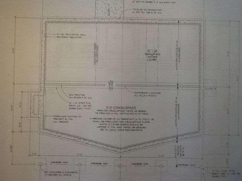

Here s the base floor plan I am going with for by place in central bc. Have power on site, collect rain water and putting in a septic this summer.

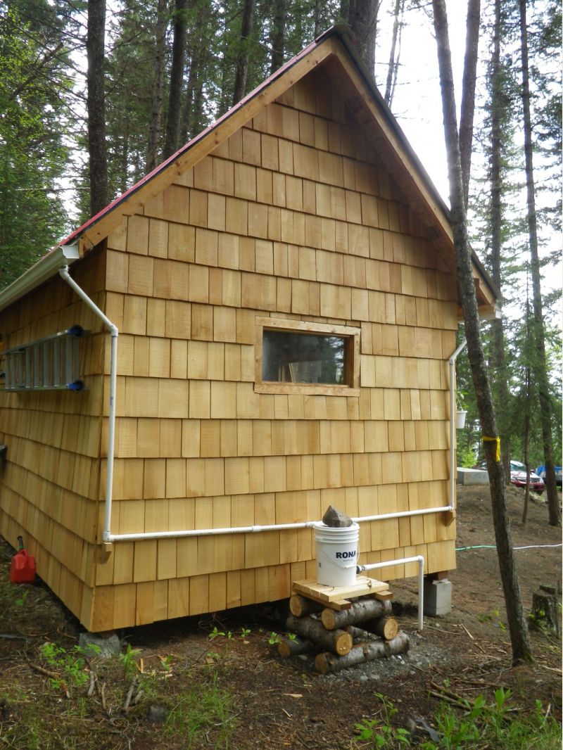

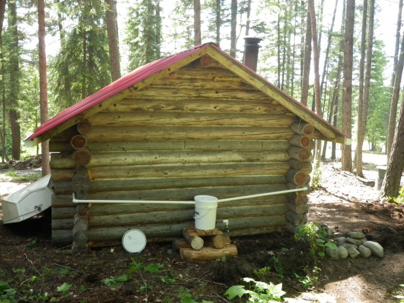

For our rainwater system we pipe from the gutters through an on ground filter we made using a 5gal bucket, with washed gravel and filter cloth on top. Easy to clean! The the water runs through underground pipes to a 1500 gal underground tank (Barr plastics) filtered at top of tank then stored. We pump up from the tank for mist uses. Use 5gal bottled water for drinking.
Dekagoldwingers
# Posted: 23 Jan 2014 11:19am
We use gutter filters too. I installed filters over the intake to down pipes but they were too hard to clean. The bucket filters seem to work great and they are easy to clean.
Bucket filter at back of cabin
Filter on shed
Filter on shed

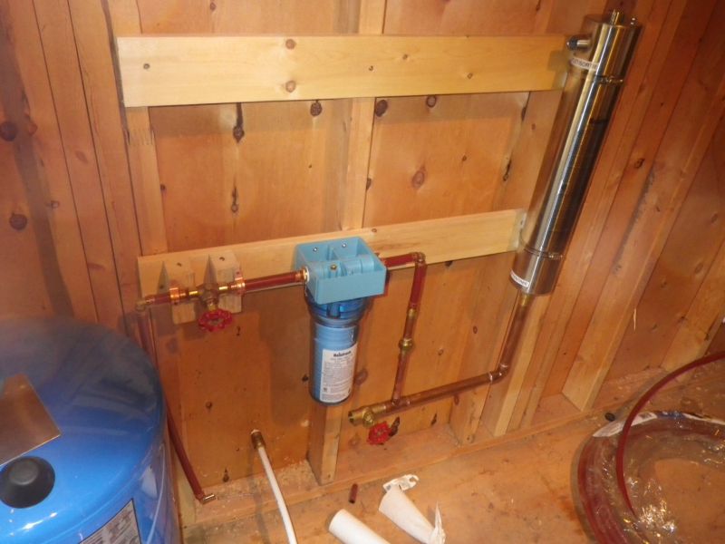

We installed n ultra violet water purification into the pressure side last summer to give us peace of mind.
Ultra violet system in shed
